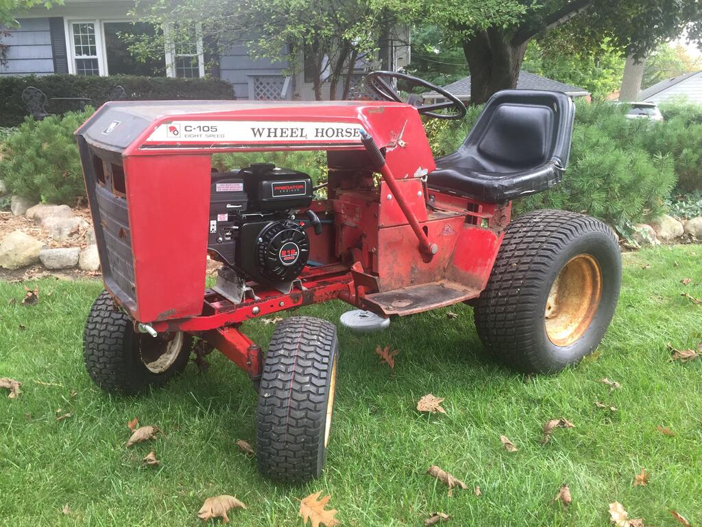

Snoopy11 5,731 #2 Posted June 5, 2022 Wheel Horse L-157. Duromax 457. Basically, drilled new holes in frame for engine mounting. Had to make custom belt guards. I also had to cut the hood, where the air filter is... although you pretty much can't tell. Aftermarket belt, 1/2 by 64. 2-1/2 inch pulley on transmission as well. Don 4 Share this post Link to post Share on other sites

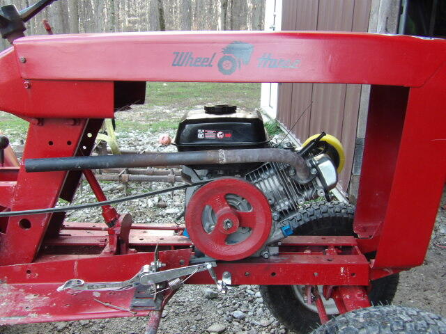

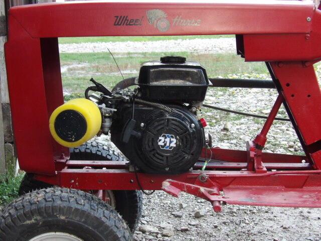

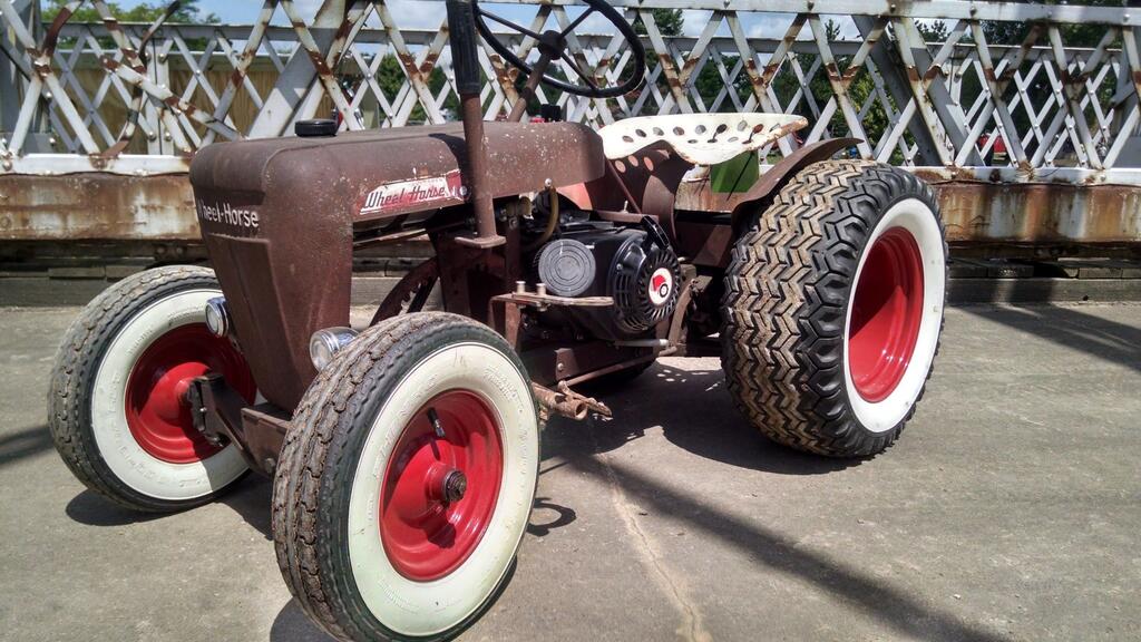

Snoopy11 5,731 #3 Posted June 5, 2022 Wheel Horse 800 Special with Tillotson 212R. Drilled holes in frame for engine mounting. Right side of engine bolted directly to center of frame, left side has custom brackets that clamp onto left frame. If you didn't want to make your own "clamp brackets" ...you would have to make or buy a mounting plate for 212 base engines. No other modifications other than custom belt guards, and 1/2 x 84 inch belt. Don 4 Share this post Link to post Share on other sites

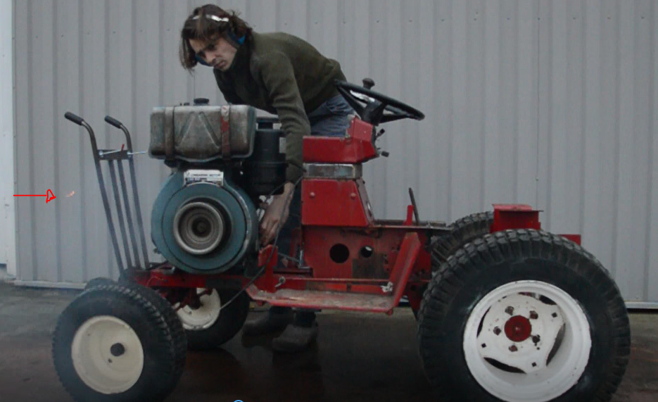

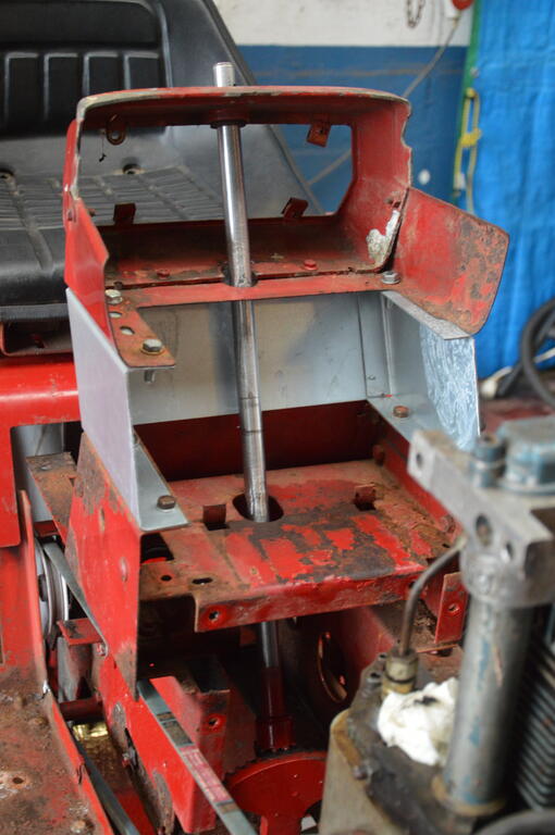

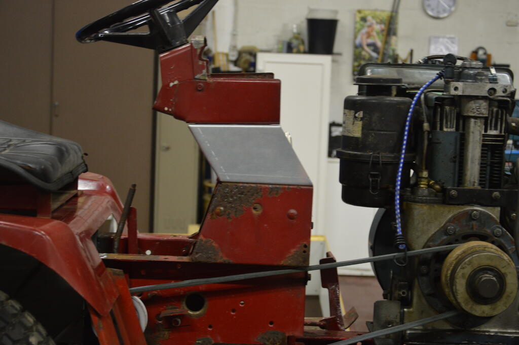

Maxwell-8 4,371 #4 Posted June 5, 2022 (edited) Fun idea, I will join. I made the diesel-swap. I bought this chassis without an engine and USA made engine are insanely hard to find, so I went European instead. An Italian Lombardini 14hp 1cyl (186lbs) A lot of modification were needed. The hood had to be raised 4": that meant raising the hood in the front (used a 12v winch to fill that gap. then the dash had to be raised as well moved back to keep the original steeringshaft angle, which that shaft had to be lengthen as well. Since I couldn't get the pulley off, I had to change belt sizes and pulleys to accommodate the pulley on the engine. What I still have to do is remake the fueltank supports. I will have to make a dash mount decompression valve as install a foot and hand throttle. Oh and the intake and exhaust will both have to be rerouted. Edited June 5, 2022 by Maxwell-8 6 4 Share this post Link to post Share on other sites

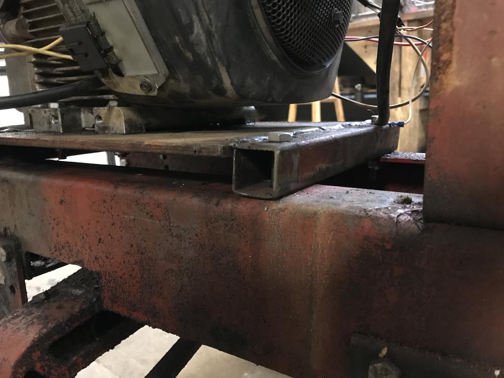

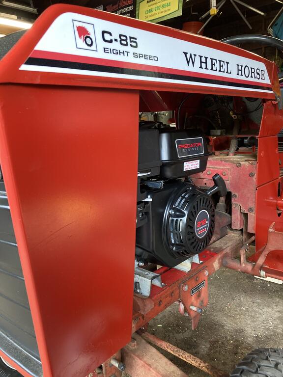

SylvanLakeWH 32,140 #5 Posted June 5, 2022 (edited) My two: “W” section sign post elevates engine shaft to almost exact spot needed for chain guard and guide to make clutch work perfectly with original belt. The C 105 WHrat WHrecker resides in @Pullstart stables… soon to be followed, post Big Show, by the C 85 (6.5)… Edited June 21, 2022 by SylvanLakeWH 5 1 Share this post Link to post Share on other sites

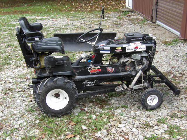

Achto 32,347 #7 Posted June 6, 2022 (edited) 1960 Suburban with a 6.5hp Predator swap. 1 - Throw the gas tank away that came with the engine. The tractor already has a gas tank so I used that one. 2 - Also removed the the supplied air cleaner and threw it away. Added a free flow pod filter in it's place. 3 - Threw the supplied engine exhaust away and made a custom exhaust. 4 - Drilled the main jet out on the carb to compensate for the free flow air cleaner & exhaust. NOTE : The above alterations to the engine kept me from having to alter the sheet metal on the tractor. 5 - Mounting holes for the engine to the frame were a direct fit. 6 - Made a new belt guard. 7 - Hooked the stock throttle cable from the tractor to the supplied mounts on the new engine. Edited June 6, 2022 by Achto 2 7 Share this post Link to post Share on other sites

Maxwell-8 4,371 #9 Posted June 6, 2022 (edited) Just for a reference how hard it is to get a smooth running Kohler in Belgium. I have the M16 that came of Amy, a dude wants to trade his "running and driving" commando 7 for just my engine. People are taking off Kohler's from perfectly working Wheel Horse, just to put it on the shelf, in case theirs blows. The tractor with a 14hp I recently bought and sold was planned to have the engine pulled, I got their in time to save it an is now with his new owners. Edited June 6, 2022 by Maxwell-8 7 2 Share this post Link to post Share on other sites

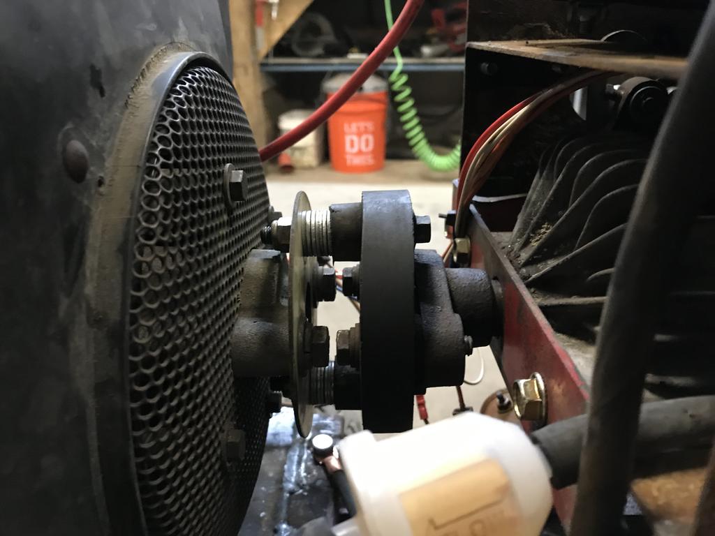

Bill D 3,100 #13 Posted June 7, 2022 (edited) 48 minutes ago, Maxwell-8 said: horizontal or vertical shaft? Some vertical shaft engine wheel horses came stock with Kawasaki engines. Horizontal shaft. Trying to figure out if they have ball bearing supported crankshafts, and are suitable for use with our PTO clutches. Edited June 7, 2022 by Bill D 2 Share this post Link to post Share on other sites

Maxwell-8 4,371 #15 Posted June 7, 2022 (edited) 9 hours ago, Bill D said: Horizontal shaft. Trying to figure out if they have ball bearing supported crankshafts, and are suitable for use with our PTO clutches. As far as I know no, very few engines can handle that side load. Ball bearings do not per say mean they can handle that side load. I was glad to see Lombardini having those specs in the manual, and I can say, it easily can handle those side loads. Although I will be most likely keep the centrifugal clutch on it for now. Edited June 7, 2022 by Maxwell-8 1 Share this post Link to post Share on other sites

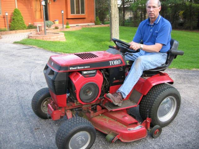

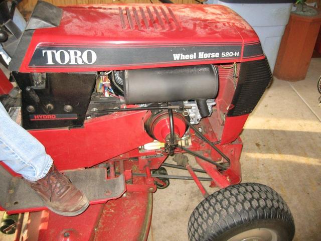

Snoopy11 5,731 #16 Posted June 7, 2022 @Red-Bovine ....520H with Honda GX630. On 5/15/2013 at 9:25 AM, Red-Bovine said: Don 4 Share this post Link to post Share on other sites
kpinnc 18,884 #17 Posted June 7, 2022 1 hour ago, tomshorse4keeps said: However, Small Engine Warehouse, states engines are "prewired" to plug right in, to existing 520H wiring, "who's right". Small Engine Warehouse also states, engine is as "close a match", as possible, but some "adapting", during installation, should be expected. The repower kits are pre-wired to function normally with a Vanguard, but the tractor's instrumentation will not work. The tractor will operate otherwise normally. No fuel guage, no rpms, no vacuum. No indicator lights. The Vanguard "can" use an oil pressure sender in place of the low oil pressure sender (not likely part of the kit), and can power a voltmeter. Nothing else without bolt-on sensors that are not likely part of the kit. No aftermarket kit that I am aware of supports all or even half of the guages on a 520-H. 1 Share this post Link to post Share on other sites

TJ5208 1,841 #21 Posted June 8, 2022 On 6/5/2022 at 3:24 PM, Snoopy11 said: Wheel Horse 800 Special with Tillotson 212R. Drilled holes in frame for engine mounting. Right side of engine bolted directly to center of frame, left side has custom brackets that clamp onto left frame. If you didn't want to make your own "clamp brackets" ...you would have to make or buy a mounting plate for 212 base engines. No other modifications other than custom belt guards, and 1/2 x 84 inch belt. Don Man I didn't realize how small that engine was compared to the stock engine you have plenty of room to do whatever. Share this post Link to post Share on other sites

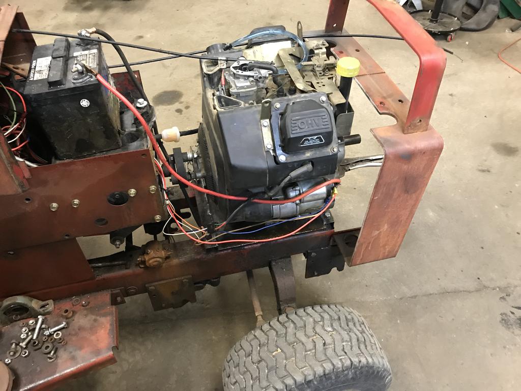

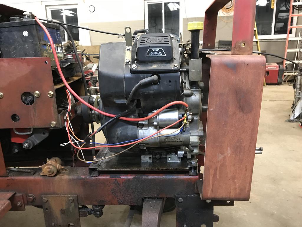

Snoopy11 5,731 #23 Posted June 8, 2022 @Sewman 418H with 21HP Kawasaki twin On 8/29/2021 at 2:25 PM, Sewman said: 5 Share this post Link to post Share on other sites

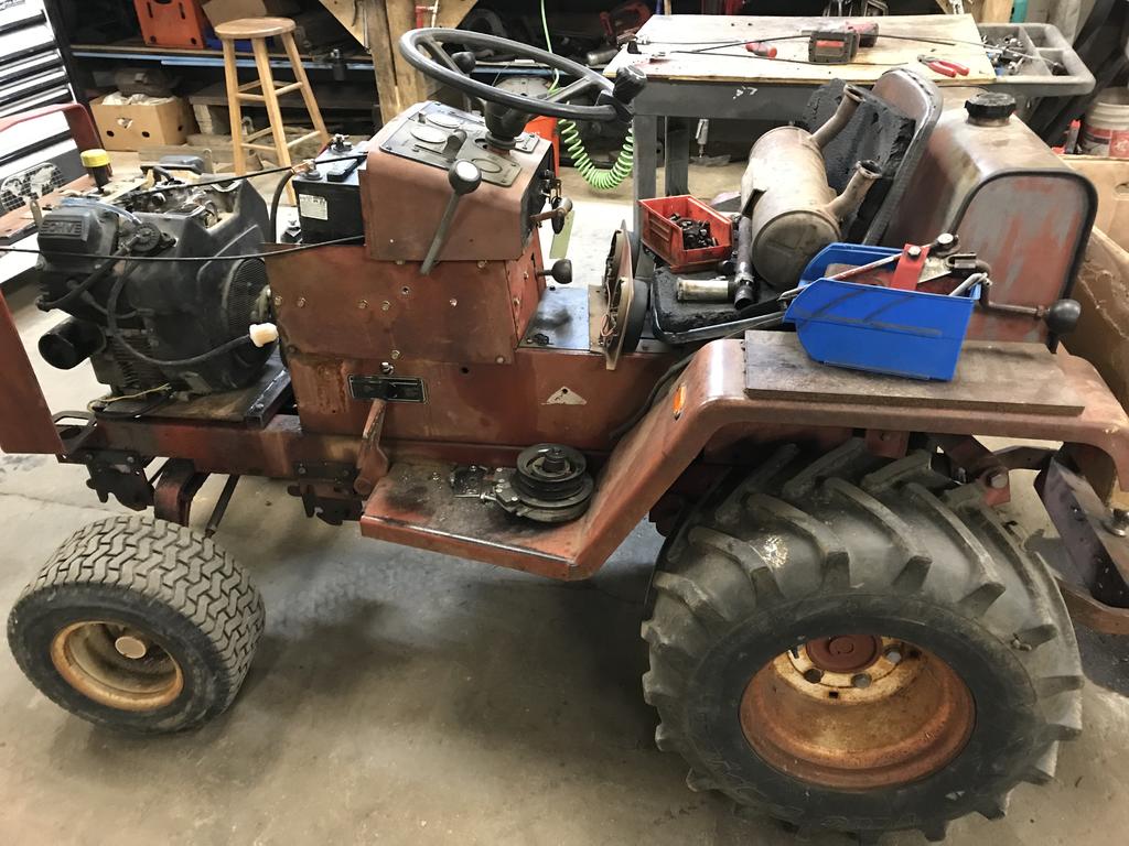

Snoopy11 5,731 #24 Posted June 8, 2022 @kpinnc... 520-H with a 23hp Vanguard On 12/5/2021 at 2:52 PM, kpinnc said: 5 1 Share this post Link to post Share on other sites

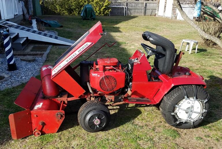

Snoopy11 5,731 #25 Posted June 8, 2022 (edited) @SpindleyEbersol... D200 with Kohler CH 20 On 7/17/2019 at 7:33 PM, SpindleyEbersol said: Edited June 8, 2022 by Snoopy11 3 Share this post Link to post Share on other sites
