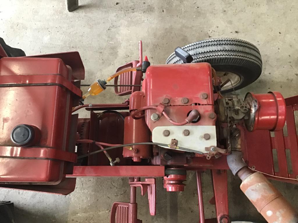

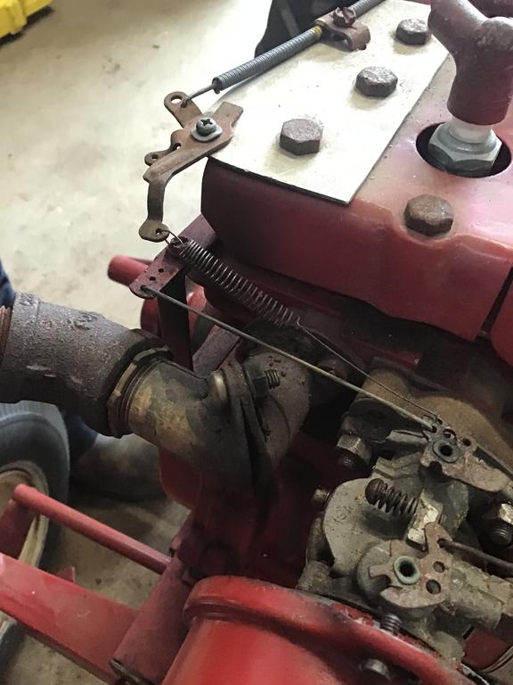

Creative throttle control for what I presume is an H60.
4 minutes ago, classiccat said:
Nice find Kevin!  A lot of potential there for sure!
But at least the governor is functional, right?
classiccat
It should.  I’ve worked on few h50-h70 Tecs on snowblowers and it’s usually a wire-spring that’s integrated into the throttle control bracket (secures to the intake “manifold”) that you bend open/closed to adjust the rpms.
definitely have a tach at-the-ready when you open the throttle to wot in case the spring tension is way off...tecs rods aren’t known for staying intact above 3600.
6 minutes ago, classiccat said:
Tecs rods aren’t known for staying intact above 3600.
Maybe that’s the “it was running and just stopped” problem!  I just happened to have bought another Tecky engine on the big show buy/sell thread, without any real purpose as to why.  I suppose I should pull the plug and check compression, eh?
