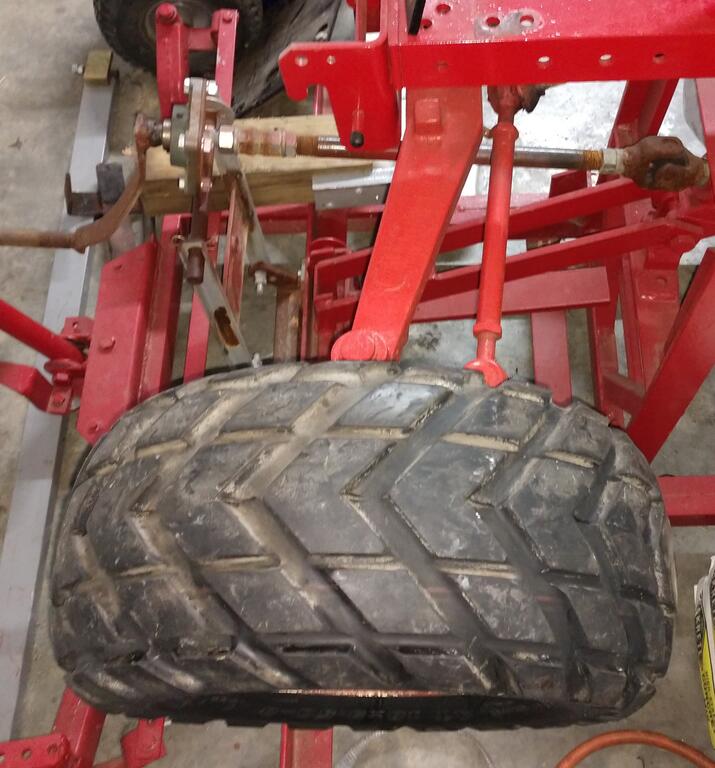

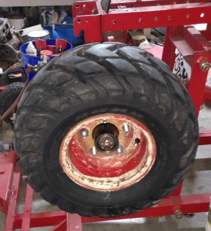

kpinnc 18,720 #1 Posted May 8, 2021 (edited) My second build along with the whatchamacallit is this one. It's a modified 520-H with a new built 23hp Vanguard. Not much to show yet, but here is the start of the build: The rear tires have already been moved to the whatchamacallit, and the new 25x10-12 tires will be here Saturday. The front tires are 18x8.50-8, on a 5 lug hub. I'm trying to gain an inch or two in height overall. The plan is to transfer that to a higher deck height of 3.5 inches with the 60SD deck. Obviously the deck will be modified as well for this to work. Edited May 8, 2021 by kpinnc 6 15 1 Share this post Link to post Share on other sites
ebinmaine 79,497 #2 Posted May 8, 2021 Very cool. The rear tires in the pic... Have you used this type before? Seems like a good compromise of turf and traction. 3 Share this post Link to post Share on other sites

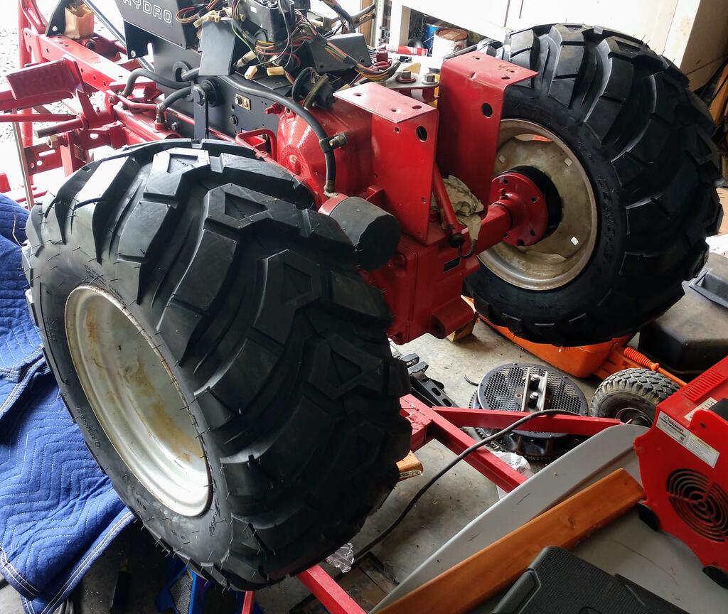

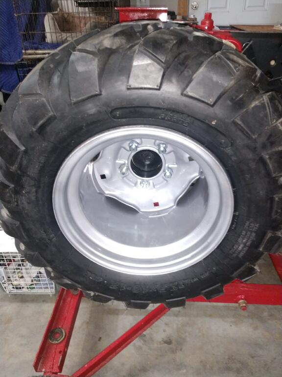

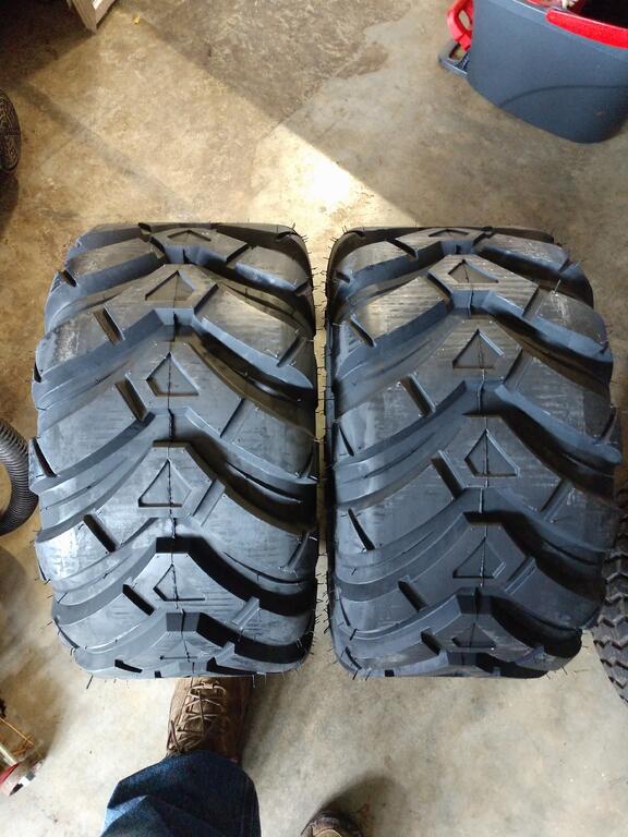

kpinnc 18,720 #4 Posted May 8, 2021 New 25x10-12 rear tires came today. Not sure if I'll get them mounted over the weekend or not being Mother's day and all, but here they are: 3 2 1 2 Share this post Link to post Share on other sites
kpinnc 18,720 #5 Posted May 8, 2021 (edited) 12 hours ago, ebinmaine said: The rear tires in the pic... Have you used this type before? Seems like a good compromise of turf and traction. Not yet, but I thought the same thing. Thats why they went to the whatchamacallit. Got them both at TSC clearance for $20 each so they will absolutely be worth the money either way! The tires in the pic above were a bit more, but they are meaty! Edited May 8, 2021 by kpinnc 4 Share this post Link to post Share on other sites
kpinnc 18,720 #6 Posted May 11, 2021 I had to get help from the tire shop, but the new rears are mounted. Sidewalls were so thick that I couldn't mount them by hand. 9 1 Share this post Link to post Share on other sites
Handy Don 16,910 #7 Posted May 11, 2021 3 hours ago, kpinnc said: I had to get help from the tire shop, but the new rears are mounted. Sidewalls were so thick that I couldn't mount them by hand. What do they weigh each? Those are seriously beefy tires! Share this post Link to post Share on other sites
kpinnc 18,720 #8 Posted May 12, 2021 5 hours ago, Handy Don said: What do they weigh each? Those are seriously beefy tires! I didn't actally weigh them, but the ones I took off (23x10.50-12) were about half the weight- maybe less. The new ones are very thick tires. I hope that translates to durability. They're inflated to 8 psi, and that is pretty firm. 4 Share this post Link to post Share on other sites

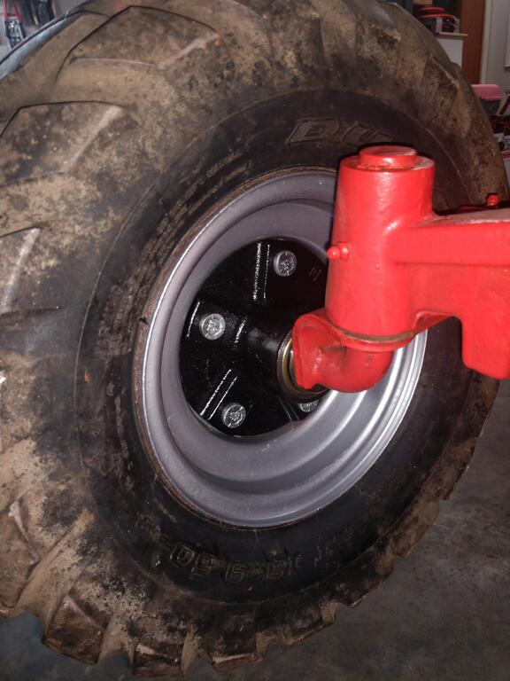

kpinnc 18,720 #9 Posted May 15, 2021 Added the front tires. Already had these, but they look almost new when clean. Most annoying bleeping tires I have ever mounted, but I like how they look. Should gain between 1.5 and 2 inches overall for the deck mods. 6 1 Share this post Link to post Share on other sites

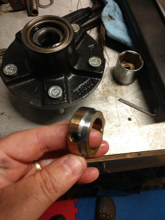

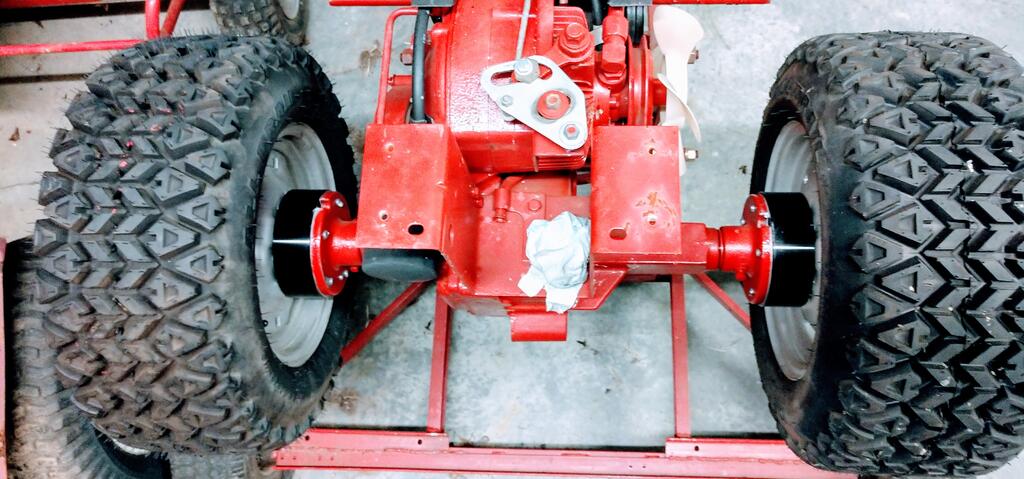

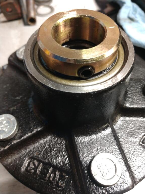

kpinnc 18,720 #10 Posted May 31, 2021 Had alot going on the last couple weeks, but I finally got a little tinker time today. Made some spacers to accomidate the 1.5" seals on the hub upgrade. Used the Harbor Freight lathe to cut some locking collars down. Ended up filing the setscrews down a little, but it works. 1 5 Share this post Link to post Share on other sites

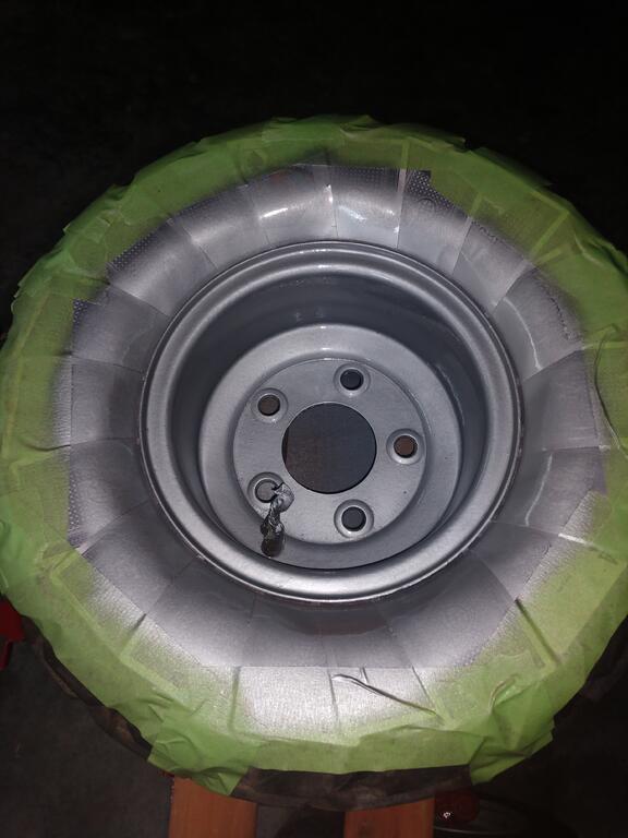

kpinnc 18,720 #11 Posted May 31, 2021 (edited) Also got some wheel painting done. Used the old card trick, and they turned out great. The front tires are really dirty, but they will clean up after the paint cures. Edited May 31, 2021 by kpinnc 5 4 Share this post Link to post Share on other sites

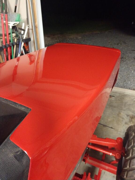

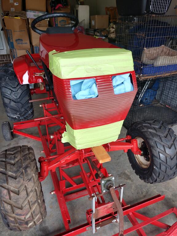

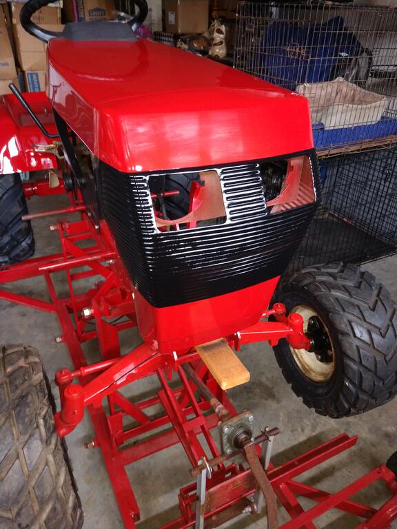

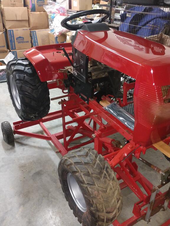

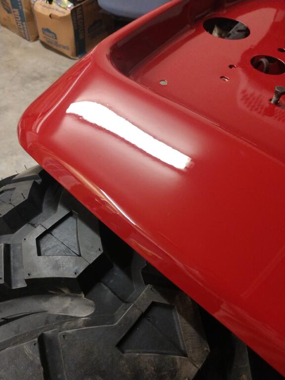

kpinnc 18,720 #14 Posted June 2, 2021 (edited) Well, I jave to admit it- I cheated on this one. I used a paint shop for the hood and fender. I am not a painter at all. I temp mounted the sheet metal just for a mock up: Edited June 2, 2021 by kpinnc 5 6 1 Share this post Link to post Share on other sites
Thor27 891 #15 Posted June 2, 2021 Wow! Looks really good. 1 Share this post Link to post Share on other sites
ebinmaine 79,497 #16 Posted June 2, 2021 2 hours ago, Thor27 said: Wow! Looks really good. I wouldn't consider that cheating. I'd consider that knowing your abilities and using proper available resources. Looks very good. 2 1 Share this post Link to post Share on other sites

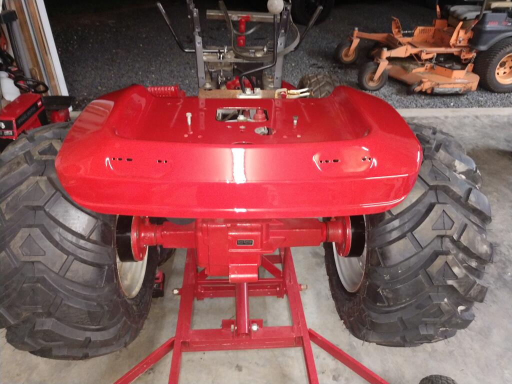

Pullstart 70,426 #17 Posted June 2, 2021 Nice work! That rear end pic should be in the Wide Rear Wednesday thread! 2 Share this post Link to post Share on other sites
Handy Don 16,910 #18 Posted June 2, 2021 8 hours ago, kpinnc said: Well, I jave to admit it- I cheated on this one. I used a paint shop for the hood and fender. I am not a painter at all. I temp mounted the sheet metal just for a mock up: Cheating? Not in my book. That would only be if you claimed it as your own work. You earned the money to pay the shop so fair and square by me. 5 Share this post Link to post Share on other sites
OldWorkHorse 3,153 #19 Posted June 2, 2021 Now that rear makes mine look small! Awesome work can't wait to see complete! 1 Share this post Link to post Share on other sites

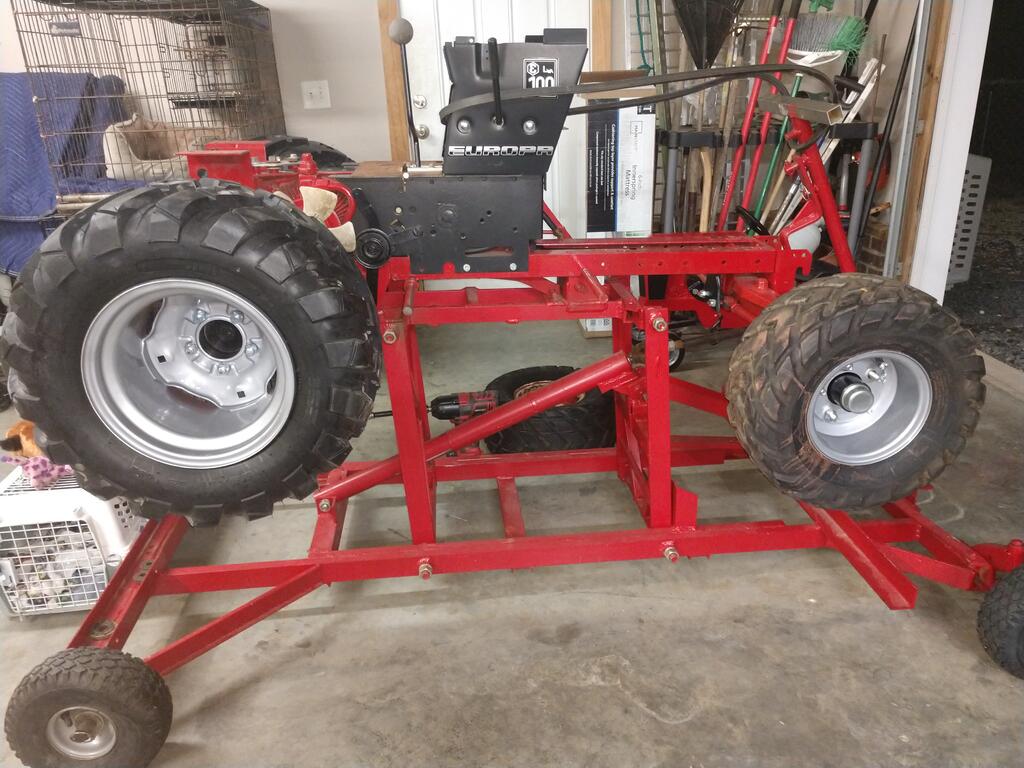

OldWorkHorse 3,153 #20 Posted June 2, 2021 Is that a custom made tractor lift or a wheeler lift? Looks like it could come in handy... 3 Share this post Link to post Share on other sites
kpinnc 18,720 #21 Posted June 2, 2021 (edited) 2 hours ago, OldWorkHorse said: Is that a custom made tractor lift or a wheeler lift? Looks like it could come in handy... I built it a few years ago for working on wheel horses. It will fit most any "typical" frame and allows you to start with just a frame and transmission, or take a tractor down to that point. The brackets clamp the first 3/4" cross brace common to most tractors and also the tranny plate. You can use ramps and drive a tractor on or off of it. My knees can't tolerate working on the floor anymore! Found a link to the build back in 2012: Edited June 2, 2021 by kpinnc 2 3 1 Share this post Link to post Share on other sites

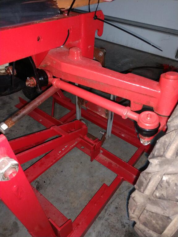

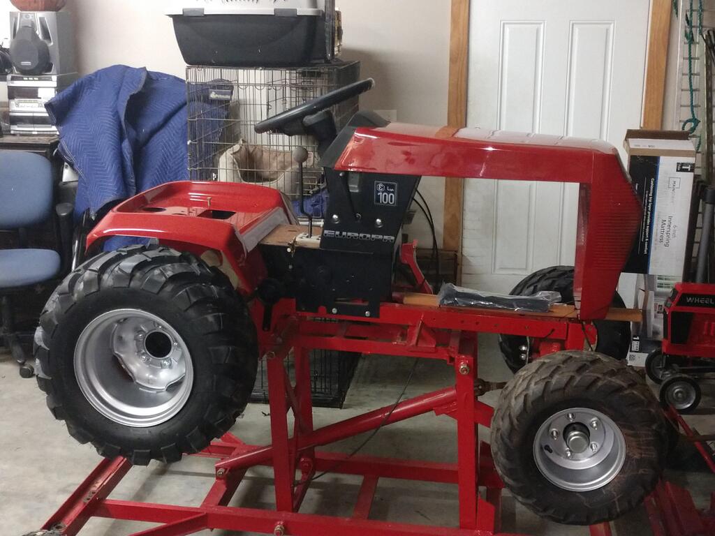

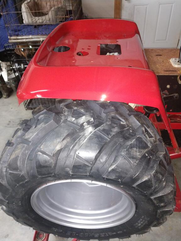

kpinnc 18,720 #22 Posted June 2, 2021 Played a little at lunch. Not much, but progress is progress... 2 5 Share this post Link to post Share on other sites

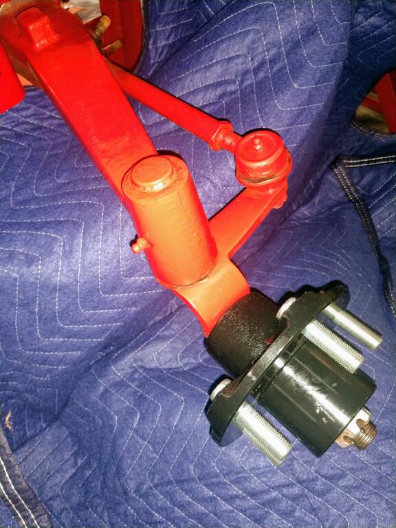

kpinnc 18,720 #25 Posted June 3, 2021 (edited) Found an old thread in here that mentioned these, and I'm glad it did. Mine were shot! About $6 a pair in Amazon. Well worth it! Edited June 3, 2021 by kpinnc 6 1 Share this post Link to post Share on other sites
