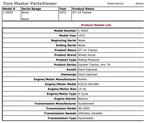

    Tractor 1972 GT-14 D&A TPL SN.pdf
    Parts list from Toro Master Parts Viewer does not appear to be correct. Use the 1971 IPL
    Illustration for transmission only
    7 pages 1.60MB
    5955 Sundstrand hydro pump gasket nla - 102759 gasket should work
    It appears Toro has used the 1970 GT-14 parts list for these 1972 models. Comparing the 1971 IPL to these the following 1970 differences were found.

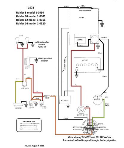

    Uses Kohler K321S-60149A Listed at Kohler as having 15 amp stator and battery ignition
    May have used 101876 or 101-876 ignition switch nla Guessing this may work - (101917 5-terminal 4-position S-R-B-I-A) replaced by 92-6785 5-terminal 4-position S-R-B-I-L ignition switch and 8658 replaced by 108544 solenoid
    Terminals on 101876 battery ignition switch may not be identified - This switch is no longer available from Toro and appears to be a heavy duty switch designed to take a heavy starter load. The ipl's @ Toro also list a 8658 solenoid so a cheaper alternative switch should be available.
    1 page 86.8KB
    Should be a suitable replacement ignition switch 92-6785
    2 pages 91KB

    1972 GT-14 model 1-0502

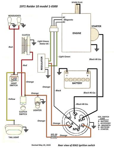

    Terminals on 8362 magneto ignition switch may not be identified
    1 page 126KB

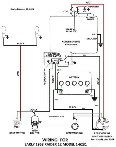

  20. Free
    Tractor 1968 Raider 12 Early production D&A TPL Wiring Rev SN.pdf
    PL from Toro Master Parts Viewer
    6 pages 348.66KB
    Do not know if PL is correct for early production
    Early production using Kohler K301S-4712B with starter/generator and battery ignition
    The 1967 wiring should be the same as the 1968 early production
    Wiring Color pdf
    1 page 350KB
    Uses 7263 (Threads 9/16"-24) 3-terminal 3-position BAT-IGN-ST ignition switch.
    Starter/generator belt
    Kohler 10hp, 12hp - 235262 (7345 Gates .410" x 35.09" 36 degree) (25-7345 Napa .410" x 35.09" 36 degree)
    Wheel Horse 1593 (3L x 34.4") - nla (Gates replacement 6735 3/8" x 35" 38 degree)
    Late production used Kohler K301S-47147B with Bendix starter, 10 amp alternator and magneto ignition with points and condenser
    Details & Attachments
    3 pages 116.88KB
    1968 Raider 12 model 1-6231 - Early production (Engine oil capacity 2-1/2 quarts)

    Tractor 1971 Raider 12 D&A Wiring Rev SN.pdf
    4 pages 118.62KB
    Wiring Color pdf
    1 page 401KB
    1 page 126KB
    1971 Raider 12 model 1-0310 - Uses breakerless magneto ignition

    Tractor 1972 Raider 8, 10, 12 & 14 D&A OM Wiring Rev SN.pdf
    Operator manual #A-5300
    6 pages 1.05MB
    Wiring Color pdf
    1 page 326KB
    Terminals on 101917 ignition switch may not be identified. This switch has been replaced by 92-6785.
    3 pages 269KB
    3 pages 117.21KB
    1972 Raider 8 model 1-0330
    1972 serial numbers that have shown up for the 1-0330
    846767 - Model 1-0330-7
