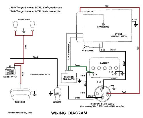

    Tractor 1968 Charger 9 Late production D&A TIPL Wiring Rev.pdf
    8 pages 912.26KB
    Wiring Color pdf
    1 page 311KB
    Long frame 45-1/2" wheelbase
    (Early production model 1-7931 uses 5054 transaxle with 2-pinion bevel gear differential and 1-1/8" axles)
    Late production uses 5062 transaxle with 10-pinion limited slip differential and 1-1/8" axles
    5955 hydro pump gasket nla - 102759 gasket should work
    Tractor drive belt # 7478 replaces # 4535 - (HB/5L x 84.22" or 5/8" x 84.22")
    Details & Attachments
    3 pages 116.55KB
    1968 Charger 9 model 1-7932

    Tractor 1968 Charger 9 Early production D&A OM IPL Wiring Rev SN.pdf
    Operator manual #396
    IPL
    16 pages 1.03MB
    Dated 8/14/67
    Wiring Color pdf
    1 page 311KB
    Early production uses 5054 transaxle with 2-pinion bevel gear differential and 1-1/8" axles
    (Late production uses 5062 transaxle with 10-pinion limited slip differential and 1-1/8" axles)
    3 pages 116.56KB
    1968 Charger 9 model 1-7931 - Earliest models may have used HH80 or HH90 engine

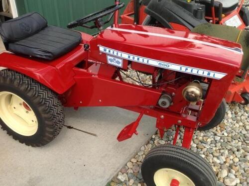

  9. Free
    Part number 8378 stripe found on 1968-1969 models
    Hood stripe
    Hood racing stripe
    Racing stripe
    Hood stripe jpg
    1 page 116KB
    1968 500 Special model 1-3631
    1969 WorkHorse 700 model 1-3741
    1969 WorkHorse 700 model 1-3745
    Work Horse

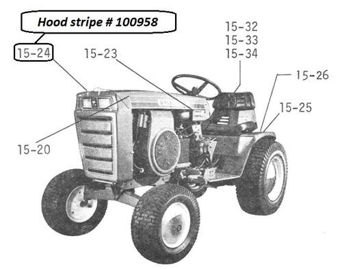

  10. Free
    Part number 100958 stripe found on 1971-1972 long frame models
    Hood stripe
    Hood racing stripe
    Racing stripe
    Hood stripe jpg
    1 page 87KB
    1971 Bronco 14 model 1-0420
    1971 Bronco 14 model 1-0421
    1971 Charger 12 model 1-0400
    1971 Raider 10 model 1-0300
    1971 Raider 12 model 1-0310
    1972 Bronco 14 model 1-0422
    1972 Bronco 14 model 1-0423
    1972 Charger 10 model 1-0410
    1972 Charger 12 model 1-0401
    1972 Charger 12 model 1-0402
    1972 Raider 10 model 1-0301
    1972 Raider 12 model 1-0311
    1972 Raider 14 model 1-0320
