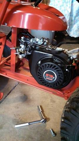

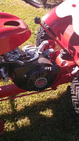

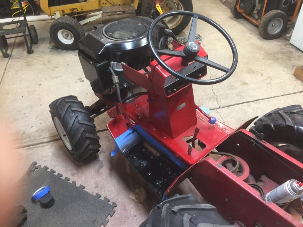

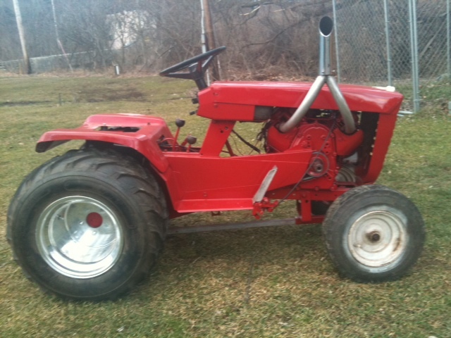

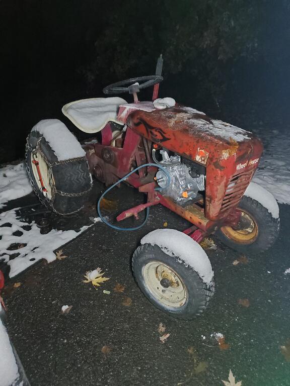

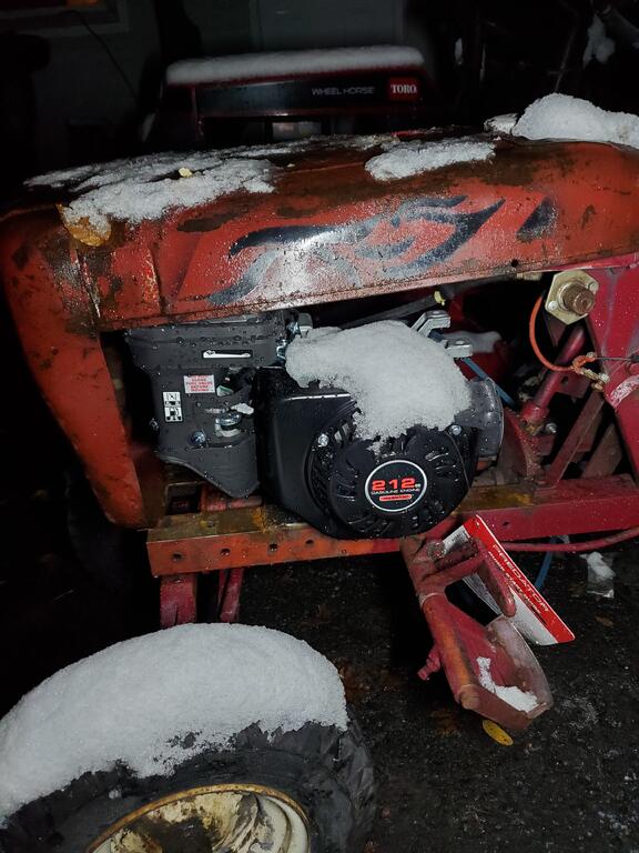

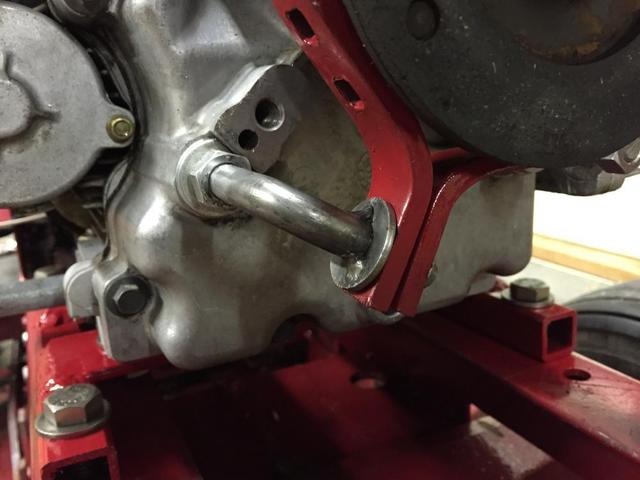

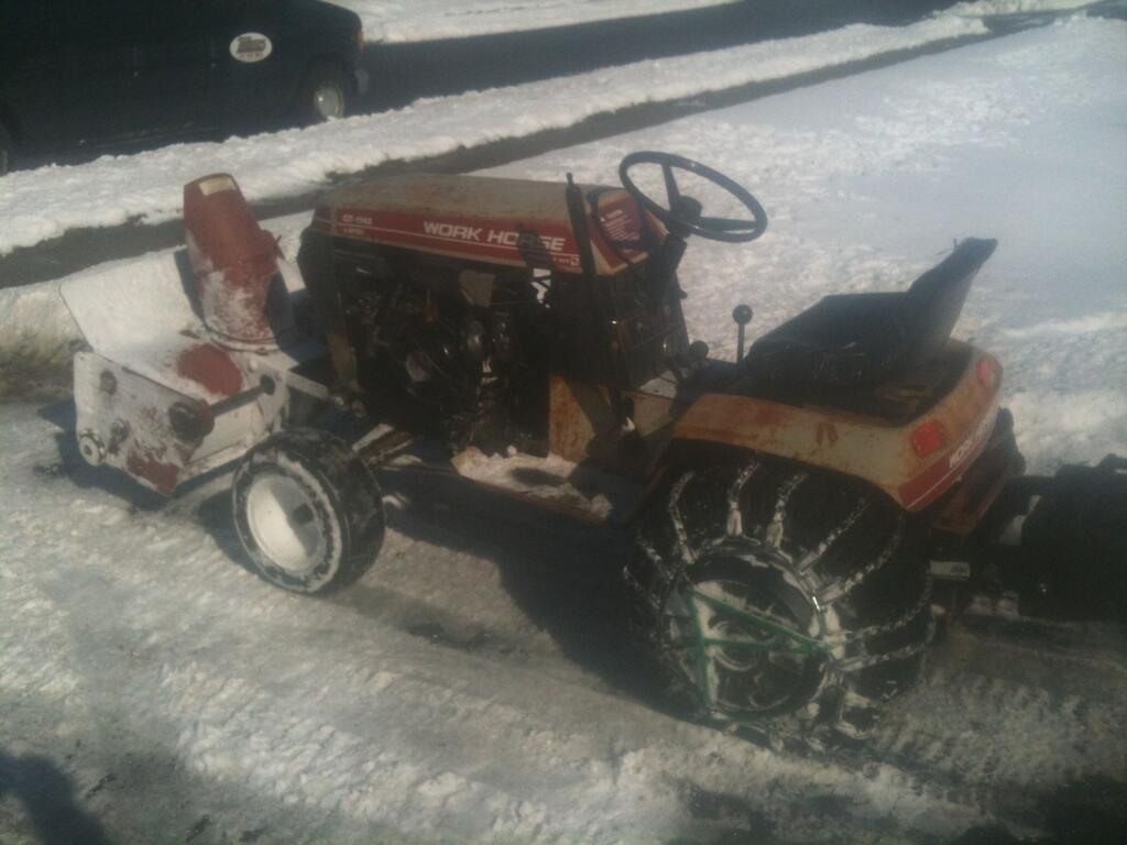

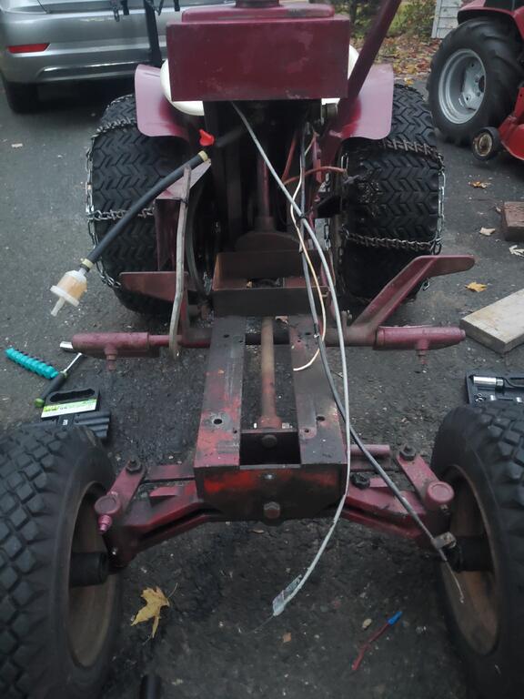

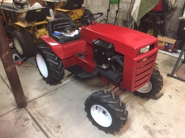

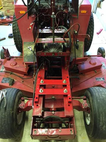

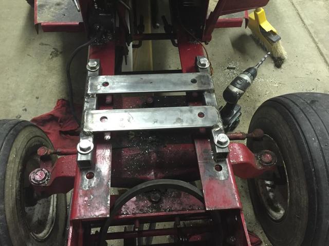

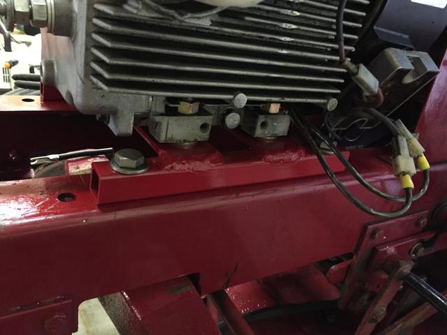

Snoopy11 5,731 #51 Posted June 10, 2022 @Jhook ...502 with Predator 212 On 10/28/2020 at 7:42 PM, Jhook said: Pulled the engine off and pressure washed the entire machine, removed the factory battery box and ground down the frame to weld in new motor mount plates: welded in 2 pieces of 3/16 inch flat stock to mount the new engine to and bolted On 10/30/2020 at 9:46 PM, Jhook said: I got an original hood today. Slight bend on one side but the mounting tab is original and unbroken. Happy it clears the motor fine as i had nothing to base it off of when choosing a mounting position 2 Share this post Link to post Share on other sites

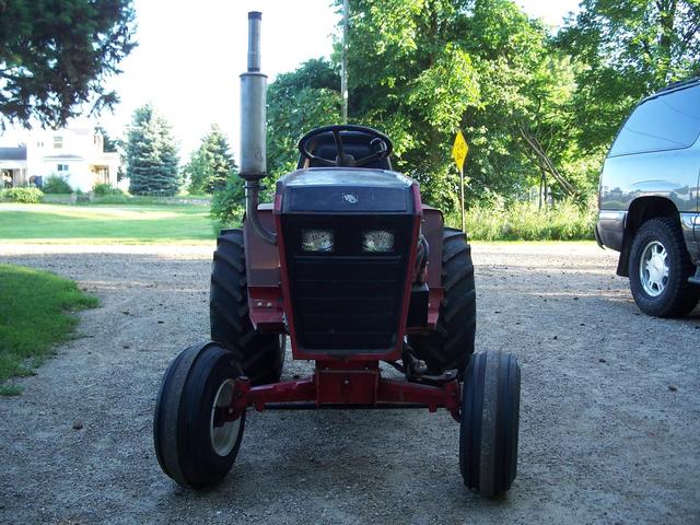

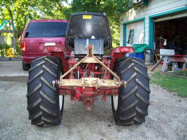

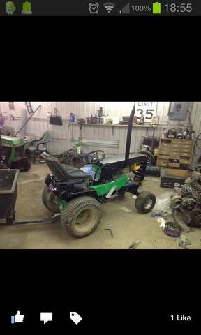

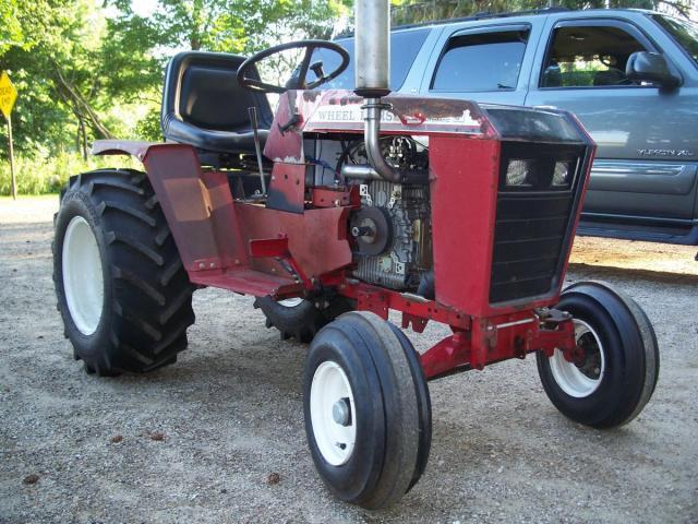

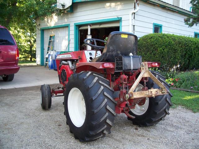

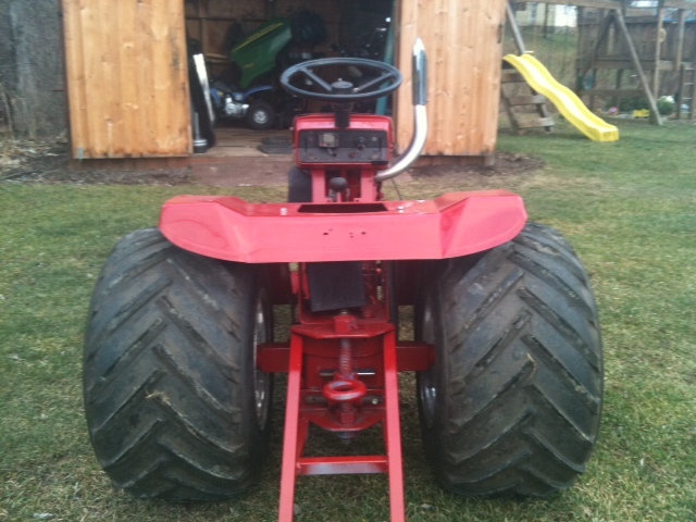

Snoopy11 5,731 #52 Posted June 10, 2022 (edited) @Don1977... C120 with 16 HP Briggs and Stratton Vanguard On 3/31/2009 at 12:19 AM, Don1977 said: I have made a few changes over the years. First I changed engines after the second overhaul gave up. B&S Vanguard 16 HP I put on in 1991. The muffler if you can call it that is 2 pieces 3/4" conduit and a section of 2" tail pipe. \ I got tired of hammering the tie rod back, and got these from Irvan - Smith a local race car supplier. They are 1/2" I turned the rod down and made bushings to 3/8" for the ends. The front wheels gave up and I put 3500 lbs spindle and hubs on with 6 ply tires. The rear tires are 23 10.5's. Here is a shot of the dash with a few extras. You didn't see the battery It usually is on the back but I have the lift hitch on it now and I can't have both. It starts very easy just turn it over a couple of time with the crank rope the set the choke turn on the switch make sure it's out of gear and it starts on the first or second pull. Edited June 10, 2022 by Snoopy11 3 Share this post Link to post Share on other sites

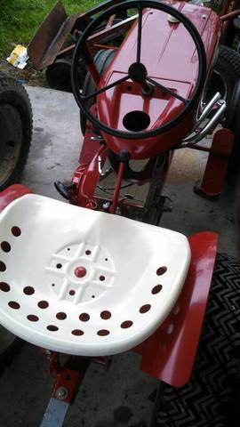

Snoopy11 5,731 #53 Posted June 10, 2022 @JTBondrew... C100 with 10hp Apollo CF 186F (E) Diesel Engine On 7/19/2014 at 2:50 AM, JTBondrew said: 2 Share this post Link to post Share on other sites

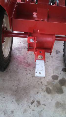

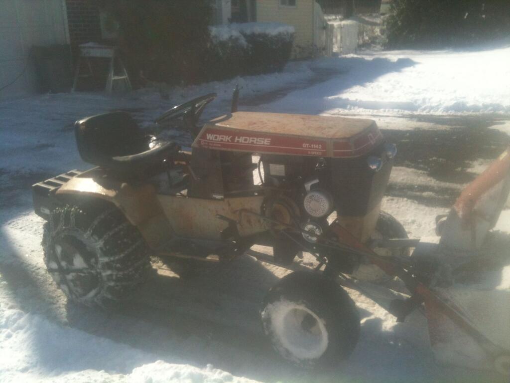

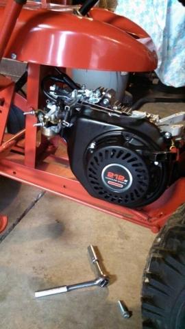

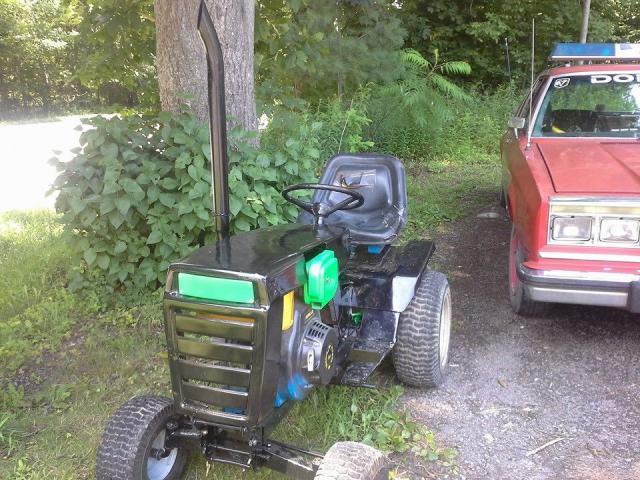

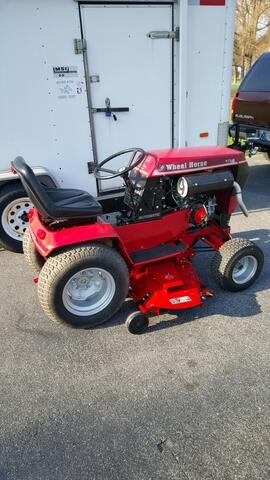

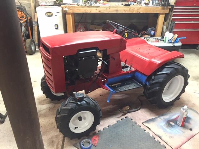

Snoopy11 5,731 #54 Posted June 10, 2022 (edited) @slammer302... Suburban with Predator 212 swap. On 10/14/2013 at 3:59 PM, slammer302 said: I have my suburban all painted up now I need a motor so I bought 212cc predator to put on On 10/21/2013 at 6:41 PM, slammer302 said: I got the motor on had to put header pipe on to clear the hood I painted the blower housing made a engine cover plate from stainless steel I used the stock air intake because it keeps every thing away from my feet but put a uni air filter on it and put the hitch on On 10/21/2013 at 8:32 PM, slammer302 said: On 12/7/2013 at 2:12 PM, slammer302 said: Edited June 10, 2022 by Snoopy11 2 Share this post Link to post Share on other sites

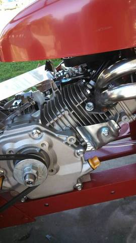

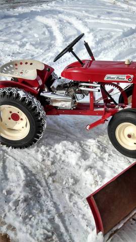

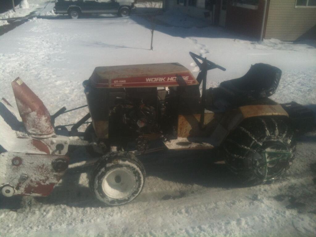

Snoopy11 5,731 #55 Posted June 10, 2022 @dwayneGT... GT1142 with Predator 420 swap. (sorry for the fuzzy photos, photobucket is holding the better photos hostage... so these are all I could get)... 1 Share this post Link to post Share on other sites

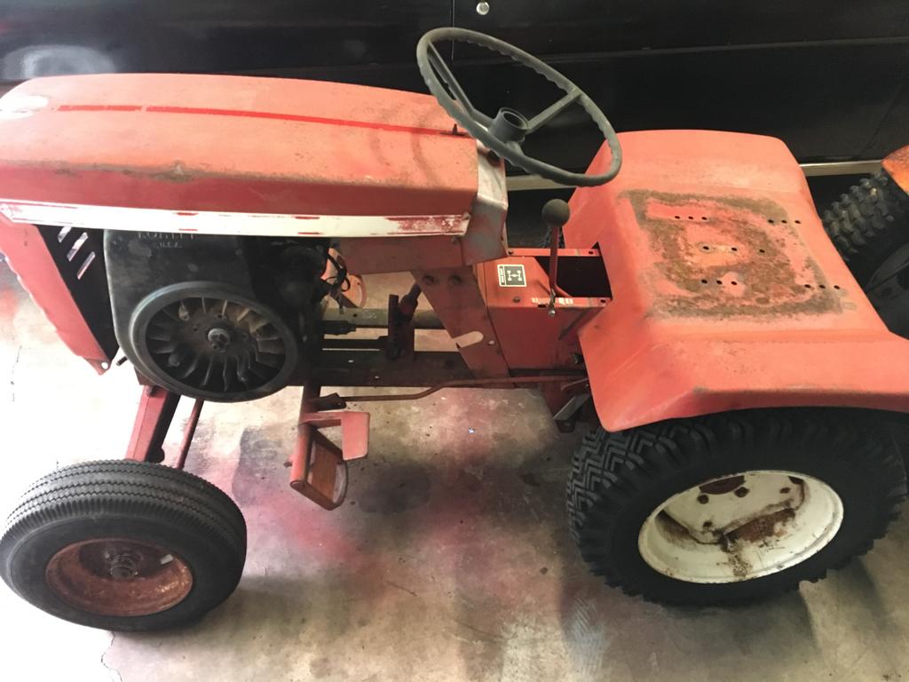

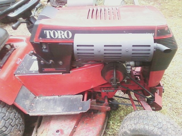

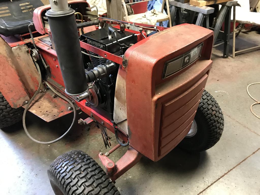

Snoopy11 5,731 #56 Posted June 10, 2022 (edited) @JoeM... 316-8 with Briggs V-twin repower On 2/29/2012 at 7:58 PM, JoeM said: Decided to throw together an old 16HP Briggs v-twin and a rolling chassis 312-8. Worked out pretty well. Runs the 48" deck with no problem. (my wife says I need adult supervison). Edited June 10, 2022 by Snoopy11 2 1 Share this post Link to post Share on other sites

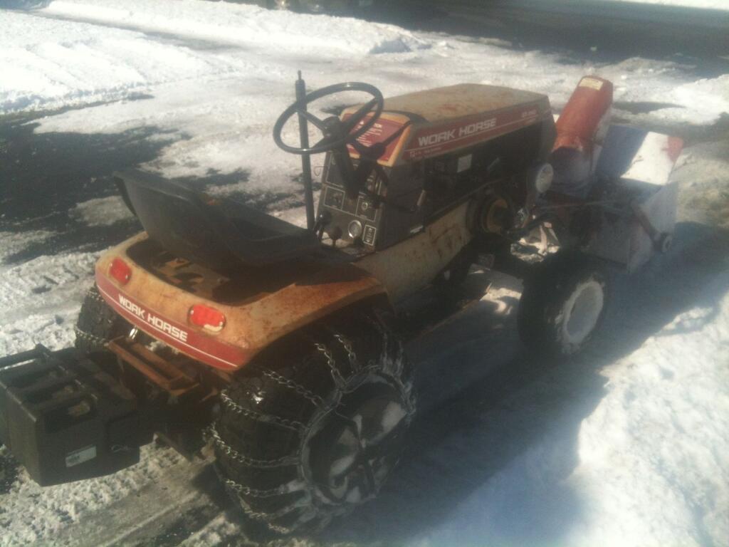

Snoopy11 5,731 #64 Posted June 12, 2022 @Machineguy... Workhorse 700 with K321 swap. On 8/2/2018 at 7:32 PM, Machineguy said: 2 Share this post Link to post Share on other sites

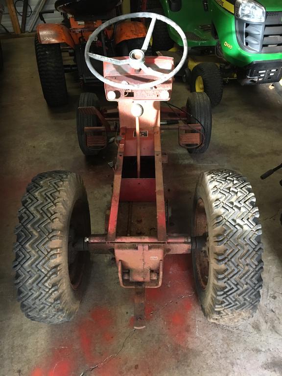

Snoopy11 5,731 #65 Posted June 12, 2022 @mrshaft696... Commando 8 with 18hp opposed twin Briggs and Stratton swap... On 10/11/2019 at 1:33 PM, mrshaft696 said: On 10/15/2019 at 9:40 AM, mrshaft696 said: On 10/21/2019 at 10:06 AM, mrshaft696 said: 2 Share this post Link to post Share on other sites

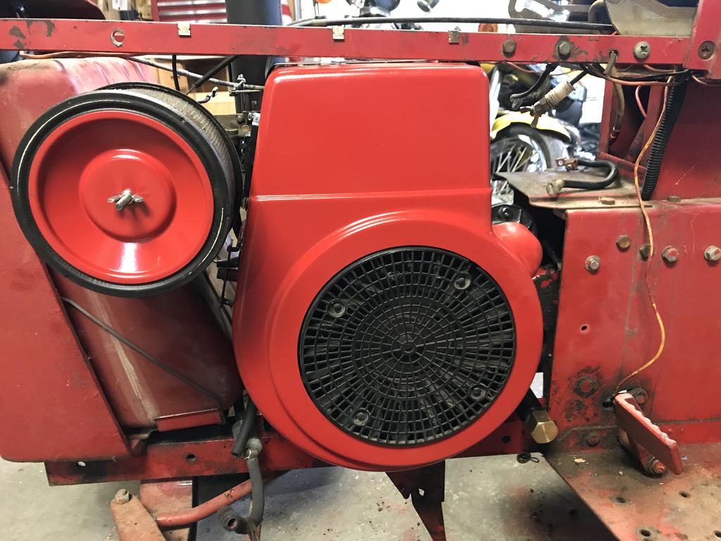

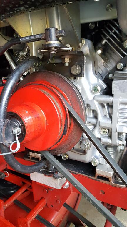

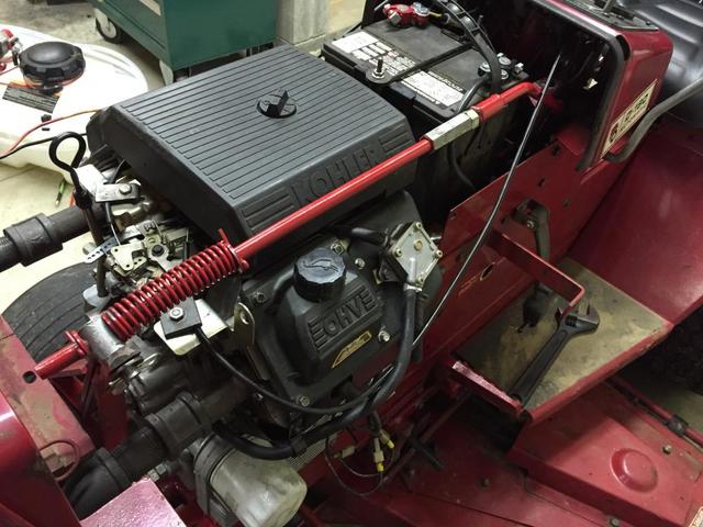

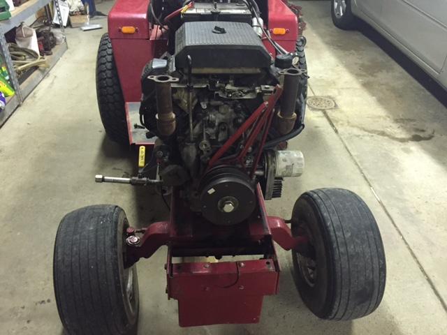

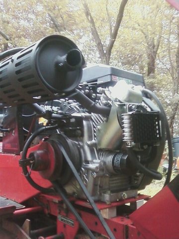

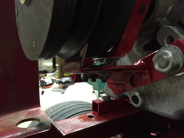

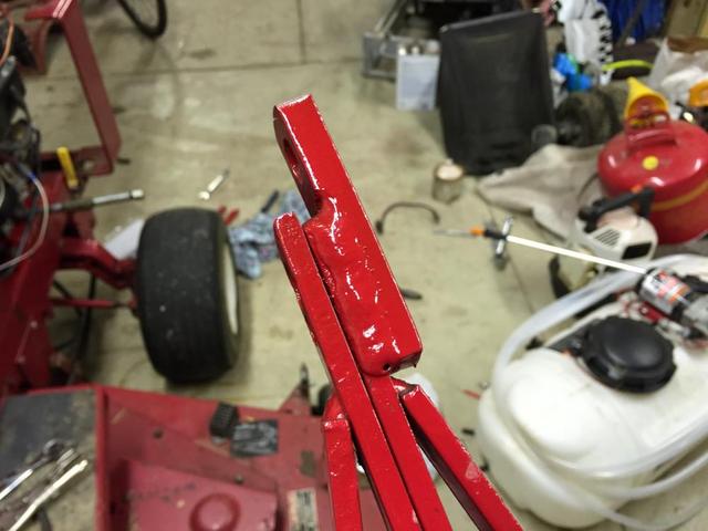

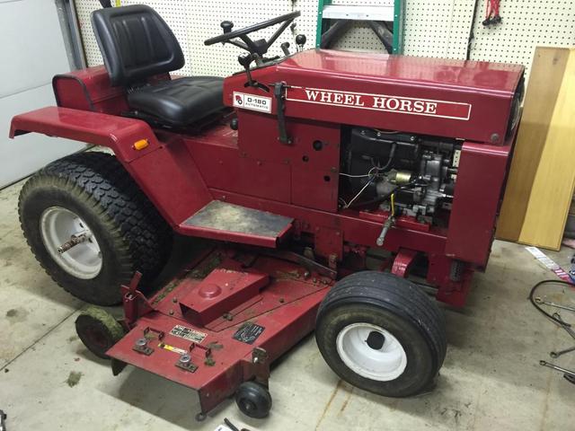

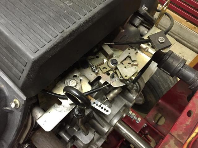

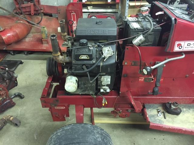

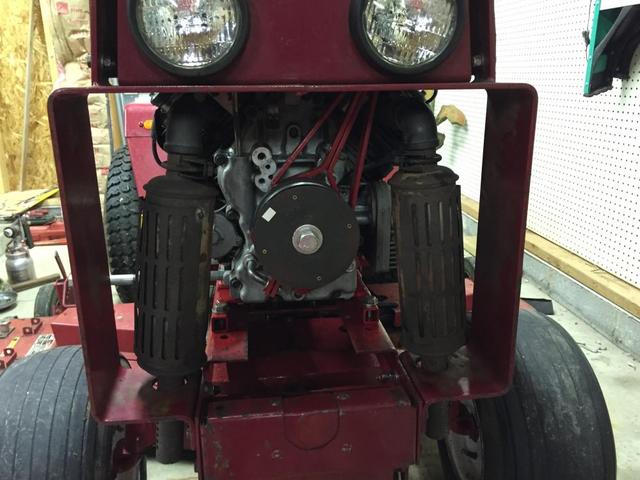

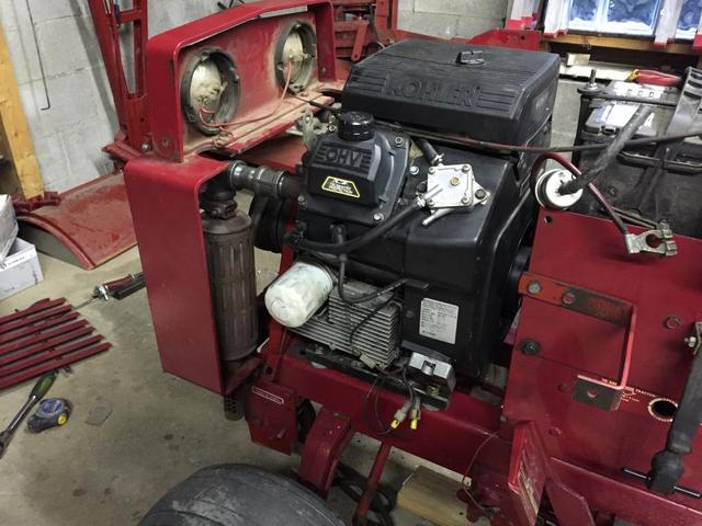

Snoopy11 5,731 #66 Posted June 13, 2022 @tommyg D-180 with 25 hp Kohler Command Pro... On 8/14/2015 at 11:10 PM, tommyg said: Just set it in for s & g's. Initial observations look promising. It will definitely have to be raised up a good 2.5". The long PTO shaft was necessary (about 4.5") since the overall width of the engine is narrower than my original K482. Big weight difference with the aluminum block vs cast iron. Probably 50 lbs! Might make turning this beast easier. The coupler will need spacers to bring it out far enough to mate with the hydro pump. Suggestions welcome. The hood fits with room to spare, but the engine is not raised up to its final position yet. Exhaust ports look like they'll be fairly easy to adapt. The clutch control linkage from the lever will definitely need to be modified. Might even need to extend the control arm to raise it up high enough to clear the shrouds. Anyway, I'm pretty excited and I think this is going to work. More as I progress! On 8/28/2015 at 10:33 AM, tommyg said: On 9/6/2015 at 10:22 PM, tommyg said: Well, it took a little time, but I pretty much have the re-power job complete for those of you interested. Here are some pics of the finished product and notes on what I did to get everything to work. I must say that it's not as hard as it might seem. Just some head scratching and a desire to make it as clean an install as possible. I can't stand cut rate options, so maybe I spent a little more $$ than someone else or time making it just right. But I will say that I'm pretty proud of the result. Cut the grass yesterday and plowed through 12" high grass with a 60" deck with hardly whimper from the 25 horse command. Let me know what you guys think! I have a couple more "tweaks" to accomplish, like re-configuring the oil drain tube to make oil changes convenient. And for those contemplating the switch, rest assured, it's possible! With the base in place, the engine was ready to mount. After 3 prototypes, I wound up with this design. It consists of 1" square stock with 1/4" X 2" stock welded together. Had to add a 1/16" washer under the engine to make sure the coupler lined up perfectly with the hydropump. I had to carefully measure the distance between where the PTO needed to be and the coupler to determine the final resting place for the engine. The dimension of the part I had machined to attach to the flywheel also depended on this. I placed the old engine in and took the necessary measurements. Had the crankshaft been a different size, I would have had to change the dimension of the spacer at the flywheel end. Looking back, I'm not sure a shorter crank would have worked. After getting the engine positioned, the next challenge was the pivot point for the clutch arm. Fabbed this "L" from 7/16" round stock and threaded one end to mate with the threaded hole on the engine block. I tried using "all thread" for the prototype because I could not locate any 7/16" stock. But I didn't like the way it ended up. Looked a little harder and found some at Tractor Supply. Welded a washer on the end to act as a stop, and drilled a hole for the cotter pin to make sure the arm stayed put. Next, the arm itself was too short. The original K series with its horizontally opposed cylinders had a lower profile above the cylinders compared to the V Twin design of the Command. That meant adding a little extension on to the end of the arm. I was a little concerned that the extra length would compromise the amount of pressure the clutch would provide when engaged, but it proved to be a non issue. The connecting rod from the PTO control from the driver's seat had to be lengthened and reshaped. The original straight rod would not clear the valve covers of the V-Twin design. I put the first bend nearest the control lever, then picked up some 1/2' round stock and threaded one end to fit into the adjustment "nut". Made another bend or two to that piece to end up with what you see here. It's still not the way I'd like it because it hits the air filter housing when engaged, but I spent so much time on getting it to this point, I'll save that project for another day. Spent an inordinate amount of time bending, re-bending and adjusting that dang thing to make sure there was enough pressure on the clutch pressure plate, but not so much that it didn't disengage. Cable connections ended up being pretty straight forward. I picked up a couple "Arnold" universal mower throttle cables, discarded the cheap plastic lever that came with it and modified the length to fit. Both the choke and throttle don't have the same "throw" as the original. Full on with the choke and full throttle and idle require much less distance. Just have to live with that. Found a happy medium and need to learn the new touch. The last piece of the puzzle to figure out was how to attach that little PTO brake. Using that same 7/16" all thread, I welded a piece of scrap bar stock to the original L shaped bracket that held the brake. Used a nut as an adjustment so that I could position the brake exactly where needed. Then, used the original adjustment means for exact positioning against the pulley. Had to make sure this piece ended up under the pulley so as not to interfere with the belt for the blower this winter. Here's what I ended up with! Would I do anything different? I don't know. The electric clutch option is still out there. But I really had no clue how it would attach to the PTO and finding a dual pulley arrangement was difficult. It also would have added at least a couple hundred bucks to the total. Out the door, I've got about $1200 invested. Yes, I know, that's what I paid for the tractor. Who cares. Those are the things you try not to think of. Engine was $800. Used, but low hours. Maybe 100. Machining the extension to the flywheel and labor was another $160. Turning the crankshaft from 1 7/16" to 1 1/8" was $200. Then just some miscellaneous supplies. The one thing I have to get used to is the lack of "jowls" the tractor seems to have compared to the old horizontal cylinders of the K. I kind of miss that look. Hope this helps someone else facing the same decision! 2 Share this post Link to post Share on other sites

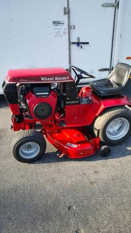

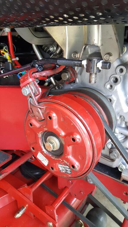

Snoopy11 5,731 #67 Posted June 13, 2022 @clem ...417A with Honda GX690 v-twin repower. (no repower thread that I could find) Manual clutch Electric clutch 1 1 Share this post Link to post Share on other sites

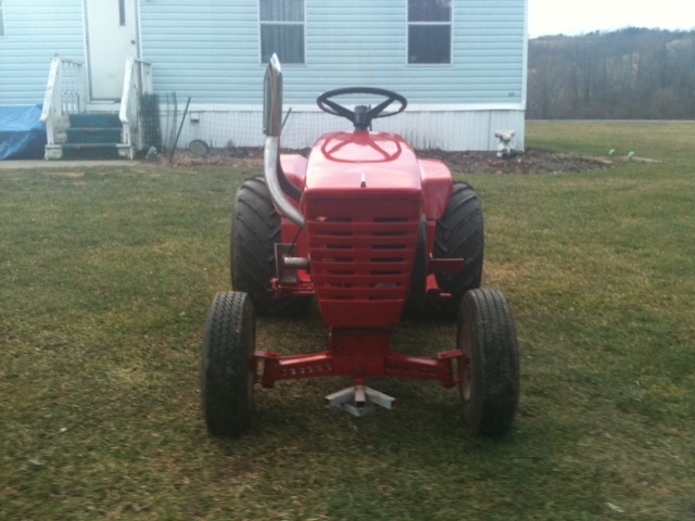

Snoopy11 5,731 #69 Posted June 13, 2022 @SALTYWRIGHT.... 417-8 with 10 Horsepower Diesel On 3/26/2011 at 6:32 PM, SALTYWRIGHT said: MY 417-8 THAT I PUT A 10 HORSEPOWER DIESEL AND CRANE ON THE BACK 2 Share this post Link to post Share on other sites

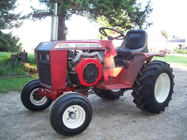

Snoopy11 5,731 #71 Posted June 13, 2022 @Kelly... C-195 with 25hp V twin diesel... On 7/22/2013 at 8:28 PM, Kelly said: 3 Share this post Link to post Share on other sites

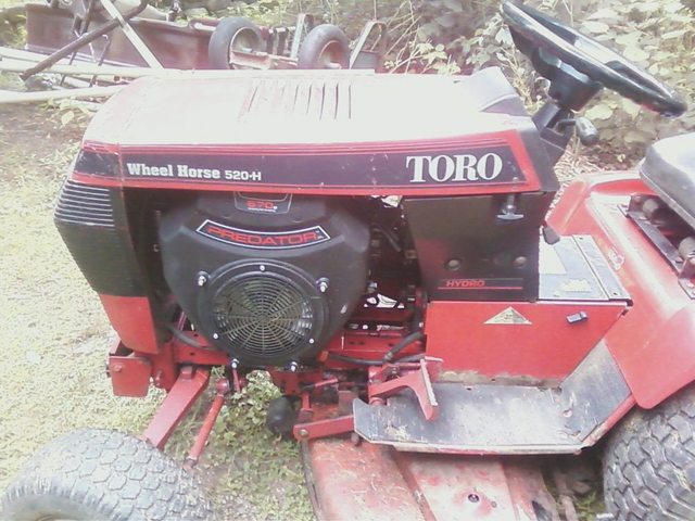

Snoopy11 5,731 #73 Posted June 13, 2022 @Jeff-C175... oh... well... in that case, here's one for ya! @Woodsie... 520H with Predator 670 V-twin... On 7/17/2015 at 2:42 PM, Woodsie said: 2 Share this post Link to post Share on other sites
