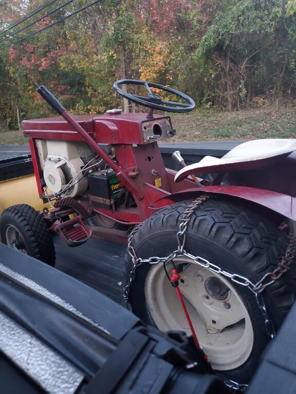

Jhook 849 #1 Posted October 28, 2020 Well this project is well under way but i figured id start a thread on it anyways. It started with a 1962 wheel horse i grabbed for 50 bucks. It came with a poorly running briggs and a home made hood. The engine i swapped in is a predator 212 from harbor freight. All said and done i should be into this tractor for less than 500 with a factory hood installed. This is the tractor as i bought it: Pulled the engine off and pressure washed the entire machine, removed the factory battery box and ground down the frame to weld in new motor mount plates: welded in 2 pieces of 3/16 inch flat stock to mount the new engine to and bolted down the 212as of right now the engine is installed and running. Next step is to get a belt stop/guard in place as the belt keeps spinning when clutch is pressed in and i cant drive the machine like that. It will be getting new tires all around, a paint job, and a factory hood in the next week or so. 5 1 Share this post Link to post Share on other sites

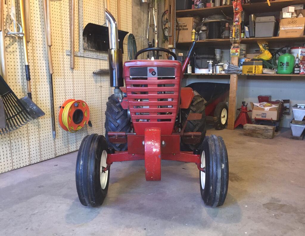

Jhook 849 #3 Posted October 28, 2020 (edited) 8 minutes ago, slim67 said: I put a 212 in my b80 and it does everything I need it to. cheap and easy conversion. The motor seems awesome! For 135 bucks out the door it should be good. No wiring, nice and compact and quiet. I havent worked mine yet or even driven it but im confident it'll push and pull what i need it to. I wouldnt run a big cutting deck or blower off one but im sure it would do it. I have an amr300 supercharger that ill be mounting on a predator. Not sure on this tractor but itll def go on a wheel horse! Did you make a custom belt guard to stop the belt? If so give some details please Edited October 28, 2020 by Jhook 1 1 Share this post Link to post Share on other sites
slim67 2,825 #4 Posted October 29, 2020 13 minutes ago, Jhook said: The motor seems awesome! For 135 bucks out the door it should be good. No wiring, nice and compact and quiet. I havent worked mine yet or even driven it but im confident it'll push and pull what i need it to. I wouldnt run a big cutting deck or blower off one but im sure it would do it. I have an amr300 supercharger that ill be mounting on a predator. Not sure on this tractor but itll def go on a wheel horse! Did you make a custom belt guard to stop the belt? If so give some details please I used the original belt guard and when I can get you a pic,I will. Long day and turning in soon. 1 Share this post Link to post Share on other sites

cschannuth 3,821 #6 Posted October 29, 2020 1 hour ago, Jhook said: Well this project is well under way but i figured id start a thread on it anyways. It started with a 1962 wheel horse i grabbed for 50 bucks. It came with a poorly running briggs and a home made hood. The engine i swapped in is a predator 212 from harbor freight. All said and done i should be into this tractor for less than 500 with a factory hood installed. This is the tractor as i bought it: Pulled the engine off and pressure washed the entire machine, removed the factory battery box and ground down the frame to weld in new motor mount plates: welded in 2 pieces of 3/16 inch flat stock to mount the new engine to and bolted down the 212as of right now the engine is installed and running. Next step is to get a belt stop/guard in place as the belt keeps spinning when clutch is pressed in and i cant drive the machine like that. It will be getting new tires all around, a paint job, and a factory hood in the next week or so. When I did my 606 I only had to slightly trim the belt guard. I also had to widen the sides of the grill to clear the air cleaner. With regard to performance, the little 212 Hemi is very strong and pushes my 42” snow blade like it’s not even there. And that’s with an upsized engine pulley for additional speed. Sorry I don’t have better pictures 5 3 Share this post Link to post Share on other sites

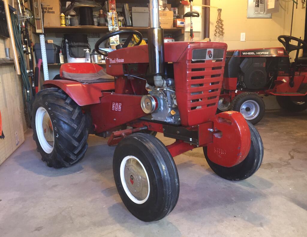

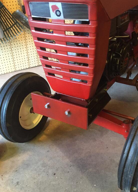

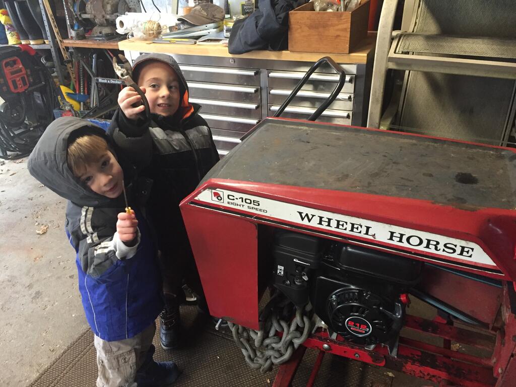

SylvanLakeWH 32,141 #7 Posted October 29, 2020 I did a build based on a C 105 frame. Only needed a very slight adjust of the end tab for the guard to accommodate the Predator... 4 1 1 Share this post Link to post Share on other sites

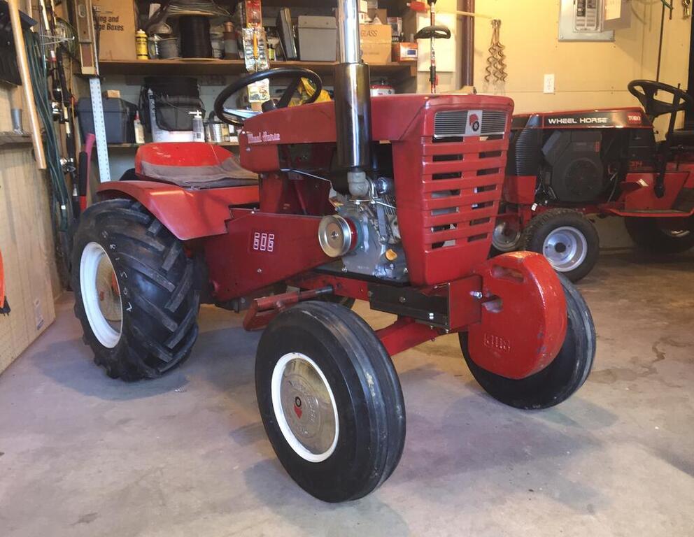

slim67 2,825 #8 Posted October 29, 2020 8 hours ago, cschannuth said: When I did my 606 I only had to slightly trim the belt guard. I also had to widen the sides of the grill to clear the air cleaner. With regard to performance, the little 212 Hemi is very strong and pushes my 42” snow blade like it’s not even there. And that’s with an upsized engine pulley for additional speed. Sorry I don’t have better pictures Very nice machine 2 1 Share this post Link to post Share on other sites
slim67 2,825 #9 Posted October 29, 2020 16 minutes ago, SylvanLakeWH said: I did a build based on a C 105 frame. Only needed a very slight adjust of the end tab for the guard to accommodate the Predator... Thats what im thinking of doing with the 165 roller I just got. You inspired me! 1 1 Share this post Link to post Share on other sites
ebinmaine 80,294 #10 Posted October 29, 2020 1 hour ago, slim67 said: Thats what im thinking of doing with the 165 roller I just got. You inspired me! Don't forget the hunk o giant chain!! 4 Share this post Link to post Share on other sites

Pullstart 71,101 #12 Posted October 29, 2020 3 hours ago, SylvanLakeWH said: I did a build based on a C 105 frame. Only needed a very slight adjust of the end tab for the guard to accommodate the Predator... 2 hours ago, slim67 said: Thats what im thinking of doing with the 165 roller I just got. You inspired me! If you need any information, just ask... Jim. If you need more pictures or measurements, I know the guy that has it now 4 Share this post Link to post Share on other sites
slim67 2,825 #13 Posted October 29, 2020 26 minutes ago, pullstart said: If you need any information, just ask... Jim. If you need more pictures or measurements, I know the guy that has it now Thanks pullstart. I did a 212 in my b80 but I mounted the engine further back . Congratulations on your Senior by the way. 1 1 Share this post Link to post Share on other sites
SylvanLakeWH 32,141 #14 Posted October 29, 2020 (edited) 2 hours ago, pullstart said: If you need any information, just ask... Jim. If you need more pictures or measurements, I know the guy that has it now Easy - Big hammer, duct tape, baling wire, pile of mis-matched parts and some "NOS" (NOT original stuff) etc... Oh..and the help of some outstanding junior wrenches that are just learning the trade... Edited October 29, 2020 by SylvanLakeWH 1 2 2 Share this post Link to post Share on other sites

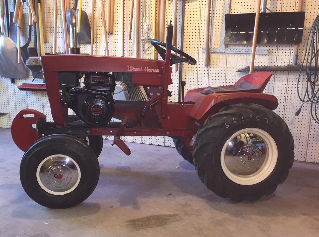

Jhook 849 #15 Posted October 31, 2020 I got an original hood today. Slight bend on one side but the mounting tab is original and unbroken. Happy it clears the motor fine as i had nothing to base it off of when choosing a mounting position 2 Share this post Link to post Share on other sites
