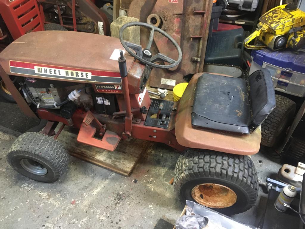

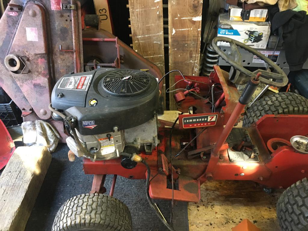

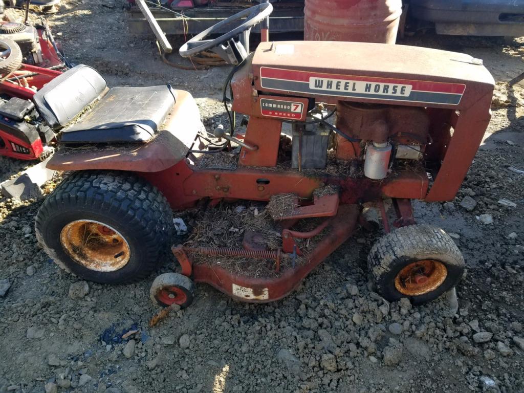

Burnerman 759 #1 Posted November 27, 2019 So against my better judgement my son brings home a Commando V7 home from the scrapyard. We found out all the idlers in the drivebelt system are shot and that parts for this tractor are near impossible to get. He has the idlers and drive belt ordered from a local shop that found some info. In the meantime we got the original 7 hp Tecumseh running. It runs like crap and has a nasty knock. Need to repower. I know where to get a 24hp v twin B&S for free. Well we’re modifying it as little as possible and it’s going to be a cool little obnoxious thing to play with😂😁😁 IMG_6498.MOV IMG_6498.MOV 8 1 Share this post Link to post Share on other sites
Burnerman 759 #3 Posted November 27, 2019 I figured I’d start a new thread for him. He forgot his login.😂 We’re going to foot throttle it and leave it loud. I can’t wait to see it move. IMG_6490.MOV 2 1 Share this post Link to post Share on other sites

Burnerman 759 #6 Posted November 27, 2019 (edited) It’s very ridiculous. It really is a Binfordized WH. Lol. The throttle system is getting tricky. For what this is getting used for it needs a foot throttle. It’s just going to be a fun loud thing to ride around. Thing is, the choke is integrated with the throttle. WOT and the choke gets “tripped” on. To get the choke off you need to push on the linkage cable, hard. Both the choke and throttle have return springs on the carb shaft in addition to the heavy spring tension spring against the governor. The way the throttle cable links into the choke it’s the same principe as a weak chain binder. It kinda locks the choke on and puts a lil less tension on governor. We don’t want to bypass the governor so We have to separate the choke and put a stop at WOT that I can set the top end RPM at. Edited November 28, 2019 by Burnerman 2 Share this post Link to post Share on other sites
Burnerman 759 #7 Posted December 1, 2019 He got the new pulleys and belt. Driveline is back together and adjusted. He also picked up a key switch and rewired the tractor. I was able to tweak the throttle linkage and by bending the choke tab back the other way it becomes a stop at WOT. I connected a cable to actuate the choke separately. Just have to get a foot throttle connected and he can take it for a test drive. 3 Share this post Link to post Share on other sites

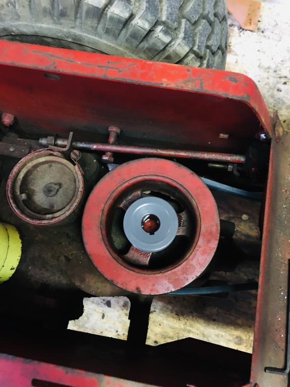

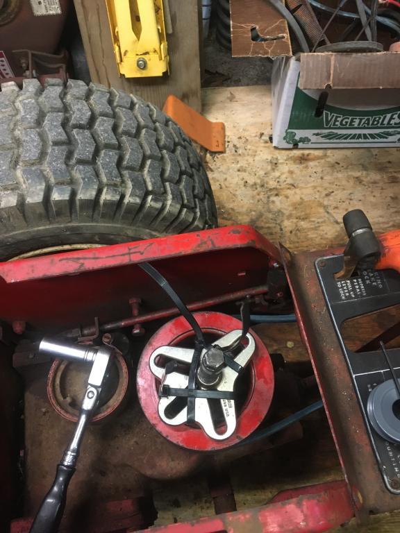

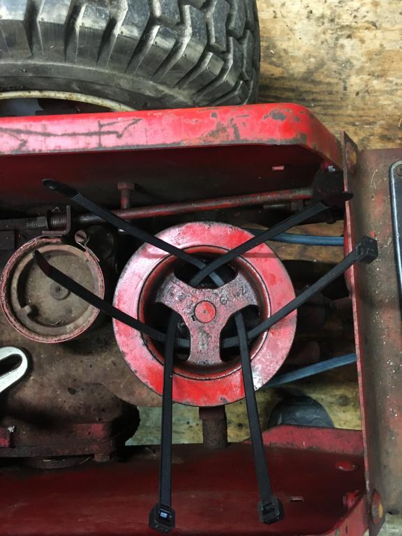

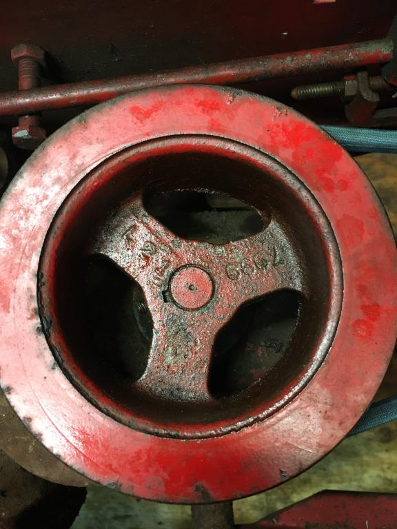

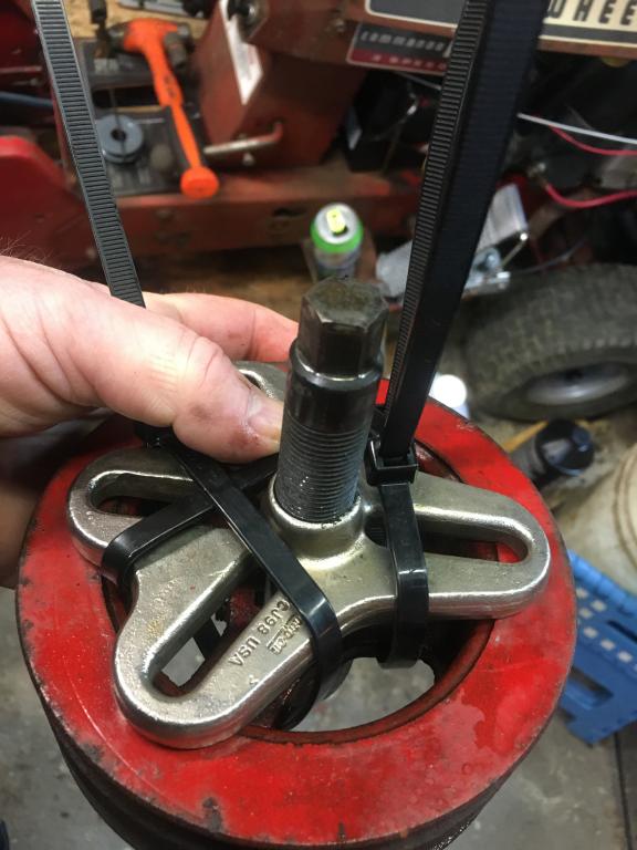

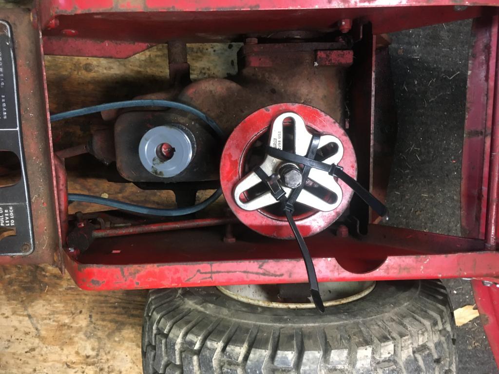

Burnerman 759 #15 Posted January 8, 2020 Been busy with all kinds of stuff. Haven’t posted in a while so figured I’d update. The road speed just didn’t match the sound of this thing. So we need to speed it up. You can’t put a bigger engine pulley on it due to the steering. So we are shrinking the transmission pulley. It may be too small but they’re fairly cheap. Lol The old trans pulley didn’t want to come off, and there’s no way to get a normal puller on it. So I got inventive. Big Zip ties worked perfect! 3 1 Share this post Link to post Share on other sites
ebinmaine 81,036 #16 Posted January 8, 2020 7 minutes ago, Burnerman said: I got inventive. Big Zip ties worked perfect Nice thinking!!!! Share this post Link to post Share on other sites
Pullstart 71,481 #17 Posted January 9, 2020 Yep. Genius move right there! Share this post Link to post Share on other sites
Burnerman 759 #18 Posted January 14, 2020 Got a 3” pulley on it and now it’ll go 8mph according to Waze. IMG_7078.MOV We’re trying to get the 2” trans pulley to work. Gotta pickup a 68” belt. 3 Share this post Link to post Share on other sites
Burnerman 759 #19 Posted January 14, 2020 3” Trans pulley on WH vertical. Share this post Link to post Share on other sites
