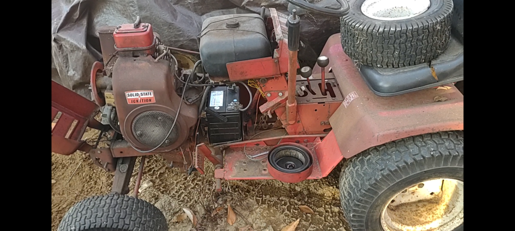

ebinmaine 80,191 #1 Posted November 10, 2021 (edited) The idea for this comes up because I have a new to me '74 C160 that I want to do a full check over and service, then start using it. ********* EDIT: The list is at the bottom of this post. EDIT #2. See post that contains printable ☑️ check list. The links are also at the bottom of this post #1. I'm fairly sure I've read multiple threads about what you folks do to a tractor as a baseline when it first comes to your possession. I've searched some and couldn't find much. Would you all please take a minute or three and list out what you do to most or all of the new herd members? It would be a great reference for all of us, especially new members or those like me that need a list. @oliver2-44 You had a nice list. @Oldskool @AHS @JCM @Stepney @WheelhorseBob @Chestnut @Bens vintage tractors @Raposo @953 nut @squonk @AMC RULES @Handy Don @formariz @Sparky @stevasaurus @wallfish@peter lena @Pullstart @Achto @WHX?? Whoever you all think has a good list please do "mention" them as well. Thanks!! HERE'S THE LIST: A#1. Join Red Square, post pictures and ask questions! The list is compiled in 4 basic categories at the suggestion of @Handy Don. All listed items below are to the credit of individuals in the following posts. 1. BEFORE MONEY CHANGES HANDS (i.e. things that might make you regret the purchase) Ask the current owner(s) if there are ANY condition issues or "things they meant to get to". Note general cleanliness. A well maintained machine is more valuable. Is it stored inside or out? Ask if ~NON E~ gas is used. Look carefully for fuel leaks. Attempt to turn engine by hand. Check for hay/straw/debris sticking out of engine tins/covers. Look for cracks or metal fatigue. All years, check trans to frame connection. Early models, look at steering tower base. Later models, check under seat frame if possible. Shake the rear end and observe to see how worn the rear hubs/axle might be. Check for engine and transmission oil leaks, tire condition, frayed or broken wires. Check oil and transmission fluid color, level, and smell, for a sense of maintenance history. Check all steering components. Look for broken/loose tie rod ends, pillow block, gear teeth, proper grease. Check throttle & choke operation. Check seat for rips tears gaping holes and softness of covering. (Seats are a bit pricey to replace.) Does it run and drive? If Yes, test manual transmission by driving around in ALL gears including high and low range. Test Hydro by driving around enough to get it hot. (15 minutes). Strap to tree or something solid and attempt forward motion. Rear wheel(s) should spin on gravel with tractor held in place. Switch around and repeat for reverse gear. Note unusual shakes, rattles, looseness in steering. Verify Hour meter operation. If not working true usage and wear may not be obvious. If Not running, value is much lower because engine and (transmission in particular) become unknowns. 2. BEFORE TRYING TO START IT (i.e. things that can make a bad thing worse) Check condition and quantity of engine oil. Check condition of wiring especially at pass through points to verify no chafing or short circuits. Verify that transmission is in neutral and park brake engaged or remove drive belt. 3. ONCE IT RUNS OR SHOWS SIGNS OF LIFE (i.e. things that make it run right and last) CLEAN EVERYTHING. This will help you see what needs to be fixed. Then go from there. Blow out the engine tins to see if it has been a rodent hotel - if so, remove tins and clean out thoroughly. Thoroughly clean around hydro if equipped. Check and adjust brake. If shoe is oily, replace brake shaft seal AND brake shoe. Check and/or replace drive belt. Find or make an electrical schematic diagram. Remove, clean and reinstall ALL electric connections. Remember these are DC systems. Bad ground will cause erratic everything behavior. Use dielectric grease. Replace battery cables, if original, with modern larger cables. Color code + - unless an original look is desired. Move negative cable to engine block. (I use a starter bolt). Run extra grounds to individual components or at minimum, to steering tower. Check charging status. Clean or replace points as needed and check setting. Replace spark plug(s). Change engine oil (and filter?). Change transmission fluid (and filter?). Be sure to raise front of tractor as much as safely possible to get fluid past internal center hump of transmission. Replace drain plug with magnetic type. Replace shift boot. Remove, clean, and reinstall fuel tank. Replace fuel tank outlet valve (which is a filter) and valve grommet (if equipped). Replace ALL fuel line and filters. Disassemble the mechanical fuel pump - clean and reassemble with a new diaphragm if needed.(You were changing the fuel lines anyway). Remove, clean and reinstall carburetor. While carb is off remove, clean and reinstall breather. Replace air filter. Tighten ALL nuts and bolts. Grease/lube ALL Zerk fittings and ALL pivot points. Note: The front end must be hanging free to get the grease where it needs to be. Remove, clean, grease and reinstall PTO and bearing. Remove, clean, grease and reinstall front wheel bearings or switch to sealed bearings. Remove, clean, reinstall cylinder head. Hand or machine mill to true flat. Decarbon the chamber. Spin it over to check the condition of the valves and guides. New head gasket - torque cold. Remember to re-torque after appropriate run time. 4. COSMETICS Everything should already be clean at this point. Fresh paint or patina is to the preference of the owner. There are several threads containing information about paint preservation. This link is for Word File https://www.wheelhorseforum.com/applications/core/interface/file/attachment.php?id=319951 This link is a PDF. https://www.wheelhorseforum.com/applications/core/interface/file/attachment.php?id=319952 Search keywords: Baseline maintenance base line check over checkover restoration new herd member members checklist acquisition mechanical tractor tractors prospective possible purchase Edited November 27, 2021 by ebinmaine Added list. Added more search keywords. 1 12 Share this post Link to post Share on other sites

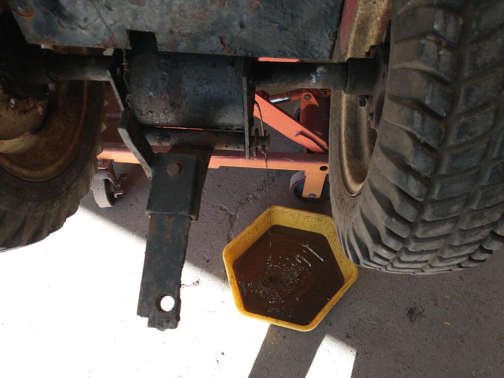

squonk 47,840 #20 Posted November 10, 2021 Make sure there's no water in the Trans -a- Mission! 7 Share this post Link to post Share on other sites
