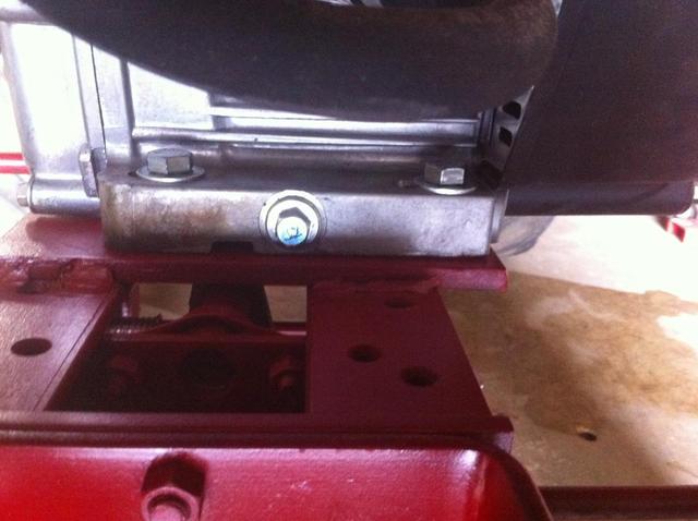

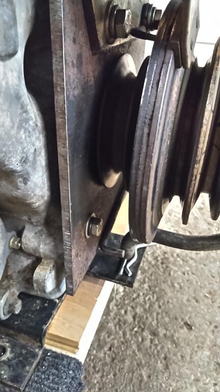

Bill D 2,990 #78 Posted June 13, 2022 I picked up a GT1142 with a Kohler command swapped in. I made a plate to mount to the block and used the original GT1142 drive pulley with a new thrust bearing from NAPA to mimic the original Briggs thrust bearing setup. Worked great. If someone had the ability to machine the backside of the drive pulleys for a thrust bearing, it would be easy to copy. The GT1800/1848 pulley and clutch setup would be the ideal starting point for hydro tractors. 1 1 Share this post Link to post Share on other sites
Snoopy11 5,731 #79 Posted June 13, 2022 1 minute ago, Bill D said: I picked up a GT1142 with a Kohler command swapped in. I made a plate to mount to the block and used the original GT1142 drive pulley with a new thrust bearing from NAPA to mimic the original Briggs thrust bearing setup. Worked great. If someone had the ability to machine the backside of the drive pulleys for a thrust bearing, it would be easy to copy. The GT1800/1848 pulley and clutch setup would be the ideal starting point for hydro tractors. Got some pics? Don Share this post Link to post Share on other sites
Bill D 2,990 #80 Posted June 13, 2022 Only picture I could find. 2 Share this post Link to post Share on other sites

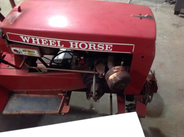

Snoopy11 5,731 #84 Posted June 14, 2022 @Crabtreeb... B80 with a 13 hp Honda knockoff On 4/25/2015 at 5:19 PM, Crabtreeb said: 1 Share this post Link to post Share on other sites

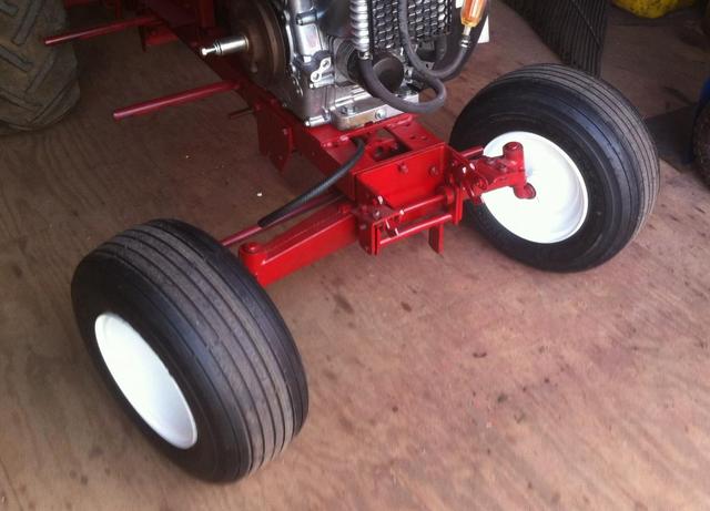

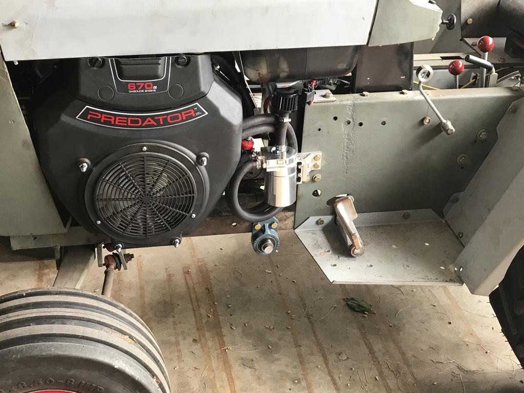

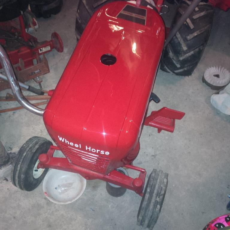

Snoopy11 5,731 #85 Posted June 14, 2022 This one is a really special part of Redsquare history. It appears to be the first "known" Predator v-twin swap on a Wheel Horse. @GT 14... C-175 with Predator 670 v-twin. On 5/1/2015 at 5:33 AM, GT14 said: Went with solid mounts for now, offset is about 1.5 inch. the engine shaft has a step down which doesn't allow drive to be close to the engine case. On 5/6/2015 at 6:08 PM, GT14 said: On 6/3/2015 at 10:05 AM, GT14 said: On 4/27/2016 at 11:24 AM, GT14 said: Finally installed the PTO 1 3 Share this post Link to post Share on other sites

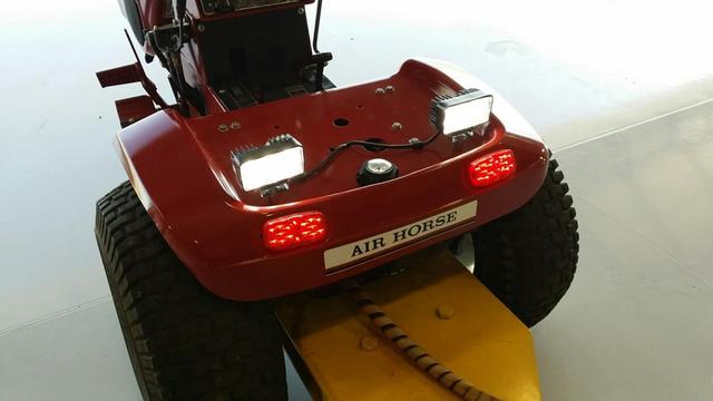

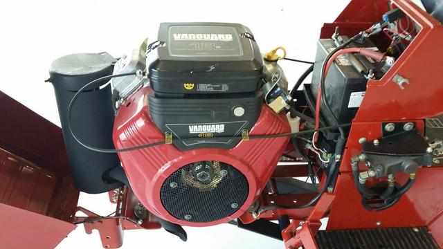

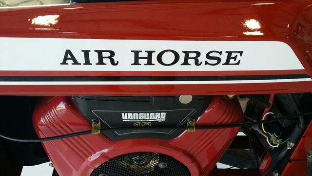

Snoopy11 5,731 #86 Posted June 14, 2022 My commentary isn't what this thread is about... but... I have to say... this is absolutely incredible. @toddsanderson... C-175 air horse with Briggs and Stratton Vanguard 18 hp v-twin repower. On 6/26/2014 at 11:22 AM, toddsanderson said: 1 Share this post Link to post Share on other sites

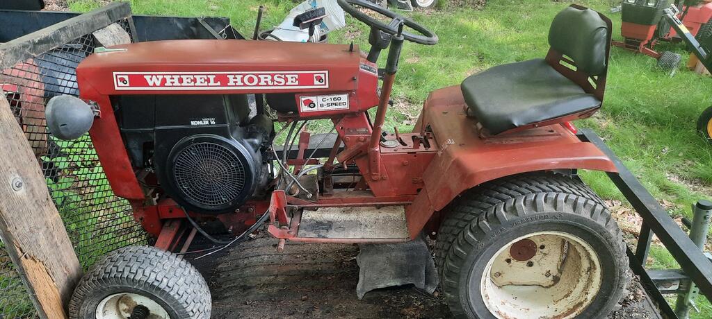

Snoopy11 5,731 #92 Posted June 15, 2022 @Docwheelhorse... C160-8 with Kohler Magnum 16... 17 hours ago, Docwheelhorse said: Share this post Link to post Share on other sites

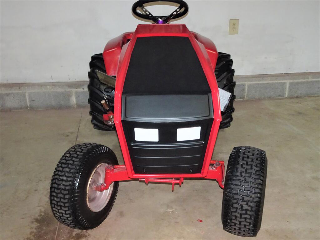

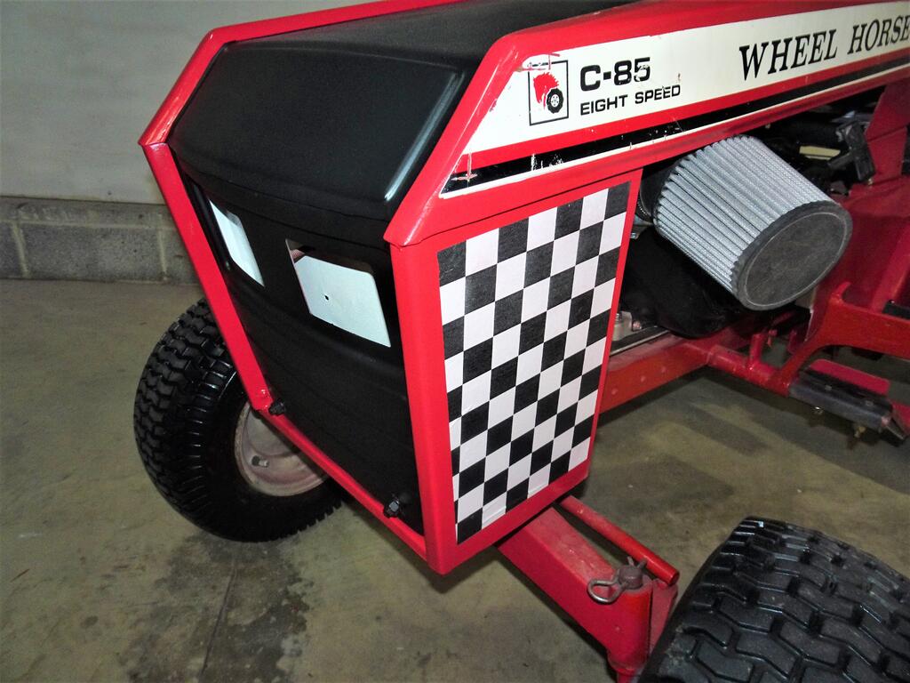

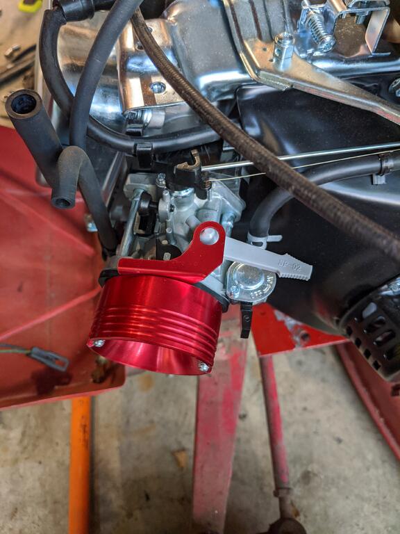

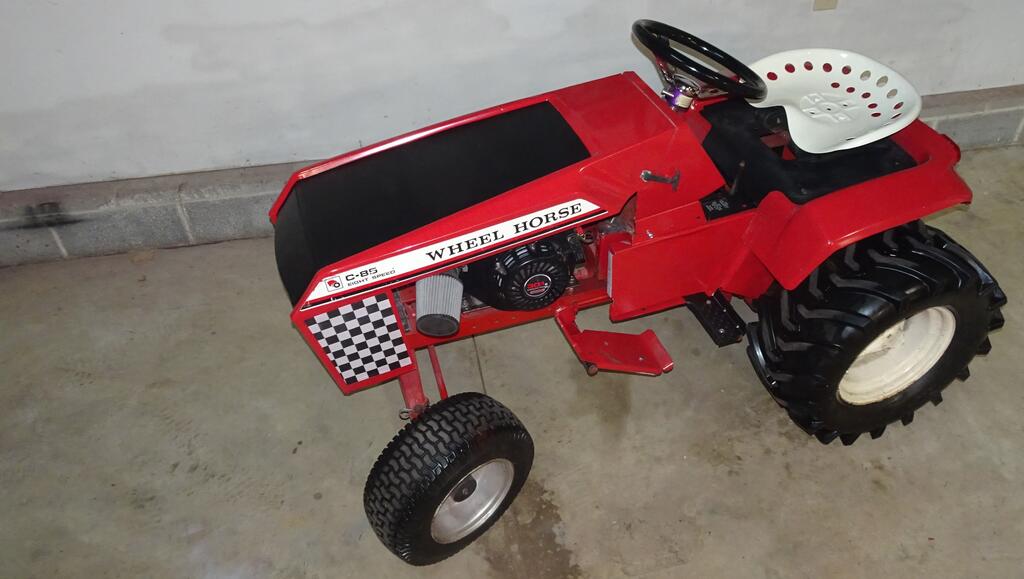

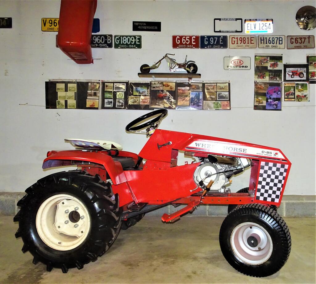

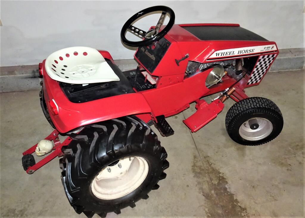

Snoopy11 5,731 #94 Posted June 15, 2022 @giddyap... C85 with Predator 301... On 5/18/2022 at 8:55 PM, giddyap said: 1 Share this post Link to post Share on other sites

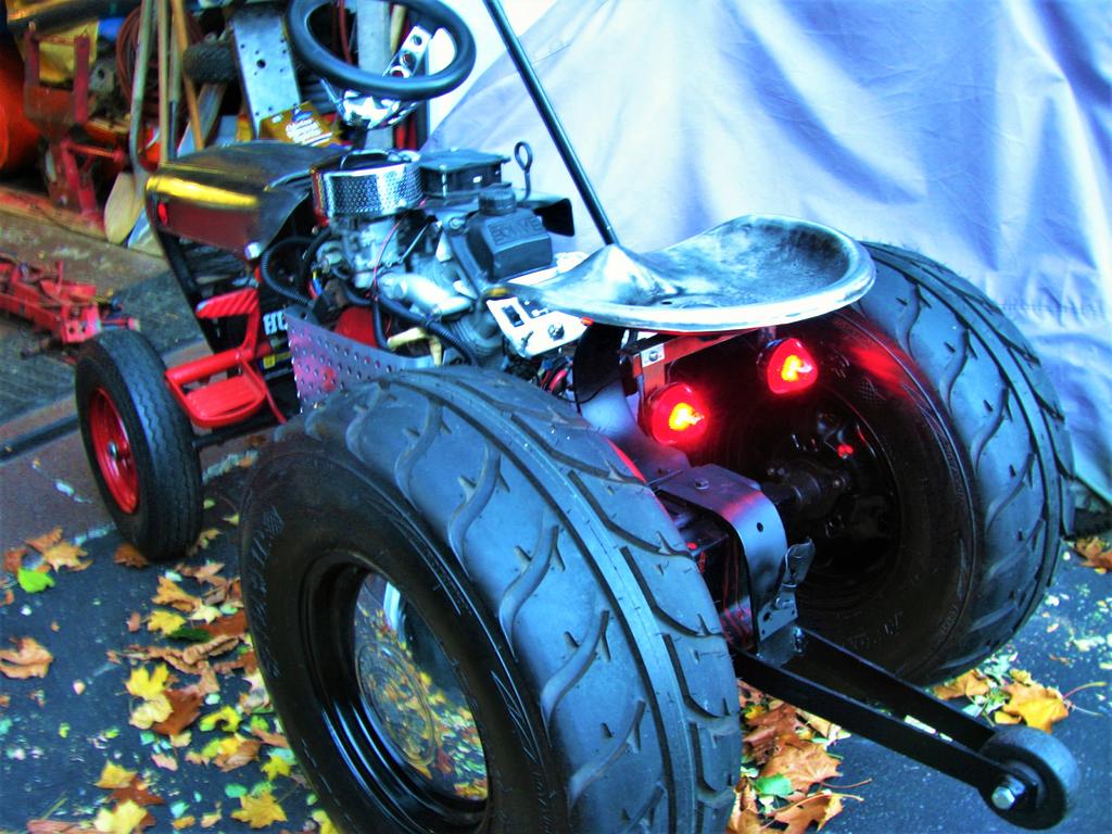

Snoopy11 5,731 #100 Posted June 15, 2022 @MAD MARK... 310-8 with Predator 212... On 8/27/2017 at 3:26 AM, MAD MARK said: On 8/27/2017 at 9:35 PM, MAD MARK said: 1 Share this post Link to post Share on other sites
