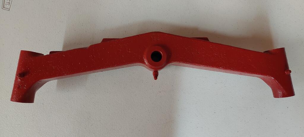

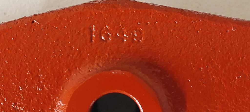

dmoore   1,042 #16 Posted June 2, 2022 Front axle came out beautiful today 1 Share this post Link to post Share on other sites

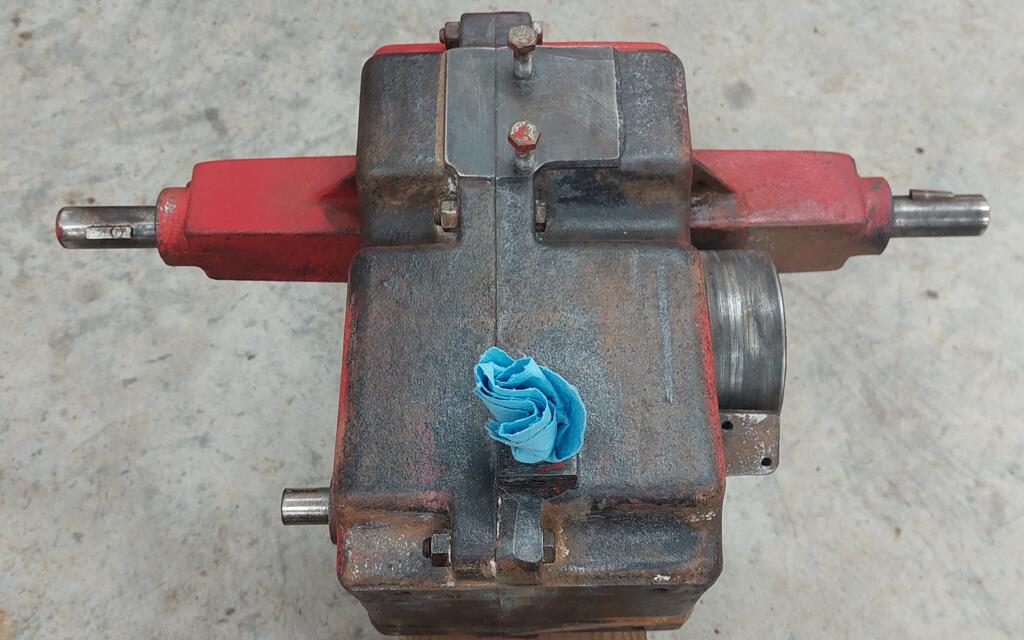

dmoore   1,042 #17 Posted June 2, 2022 #3900 UniDrive has been cleaned & ospho'd and ready for primer tomorrow. Share this post Link to post Share on other sites

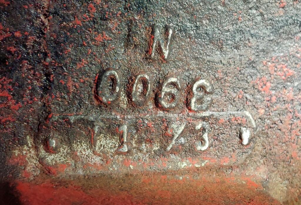

dmoore   1,042 #18 Posted June 2, 2022 Cast Nov 63 Share this post Link to post Share on other sites
ri702bill   13,085 #19 Posted June 2, 2022 11 minutes ago, dmoore said: Front axle came out beautiful today You may wish to install new Zerk fittings - with the check ball. They are 1/4-28 thread .... Bill 2 Share this post Link to post Share on other sites
dmoore   1,042 #20 Posted June 2, 2022 All in Bill! 1 Share this post Link to post Share on other sites
