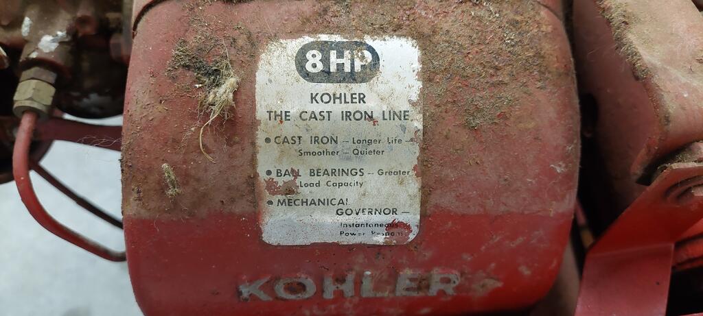

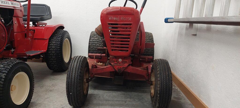

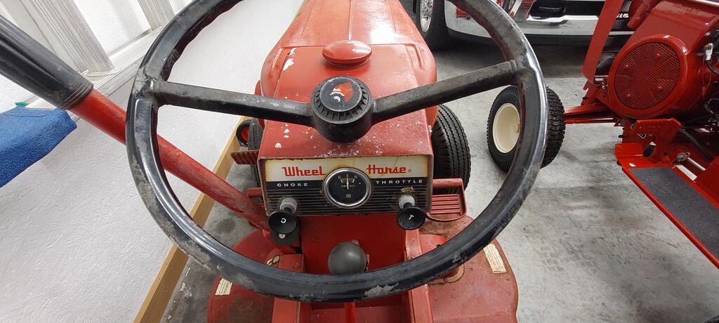

dmoore   1,042 #1 Posted May 17, 2022 Well I guess this is the beginning of an addiction without end Having only owned 1 Wheel Horse tractor these last 26 years and coming here and lusting after the vast array of various models throughout this fine site it is was only natural for me to expand my horizons 😃 A very good & long time friend of mine in P.A. knew of my NEED and brought me down this intact and virtually undesterbed 854. Save for a paint touch up here and there it's interestingly original and solid as a rock! What a great candidate to bring back to life😃 I initially was just going to start disassembly without attempting to see if she will start after many years of hibernation but my curiosity has got the best of me (whose doesn't?) and I have to see if she in fact will do so. I will no doubt be asking questions of you 854 specialist here from time to time so bear with me as I learn about this fantastic little big machine. Dave 2 9 4 Share this post Link to post Share on other sites

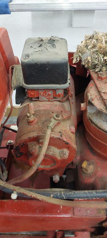

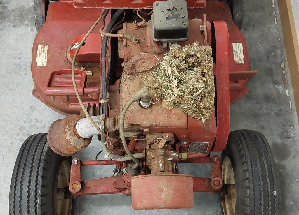

oliver2-44   11,735 #2 Posted May 17, 2022 Truly original, looks like it even came with the factory mouse nest. 3 6 Share this post Link to post Share on other sites

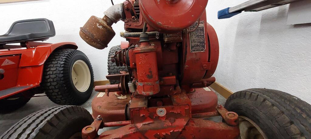

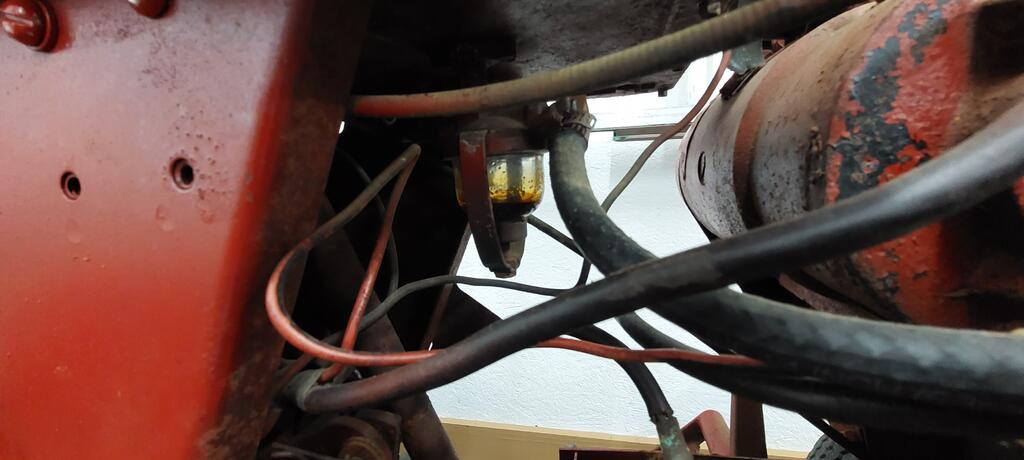

ri702bill   12,987 #4 Posted May 17, 2022 Excellent potential there! A couple of items before you try to start it. You may wish to remove the engine shroud to see if the mouse set up residence inside too. Judging by the debris in the sediment bowl, your fuel system most likely need a thorough cleaning first. 854 has a 2-piece gas tank and the gasket becomes a problem over time and will leak. Verify that it is not seized and that it has clean oil. You might consider bypassing the entire fuel system if you want to see if it will run FOR JUST A FEW SECONDS remove the air cleaner and with the choke and throttle wide open, give a short blast of carb cleaner (some use starting fluid - not the best choice), partially close the choke and try to start it. @ebinmaine started a thread a while ago about a check list of what to do with a new to you horse to get it going - all good advise in it. IF you do plan on putting gas in it, do it outside - too many chances of fuel leaks.... Bill 6 1 Share this post Link to post Share on other sites

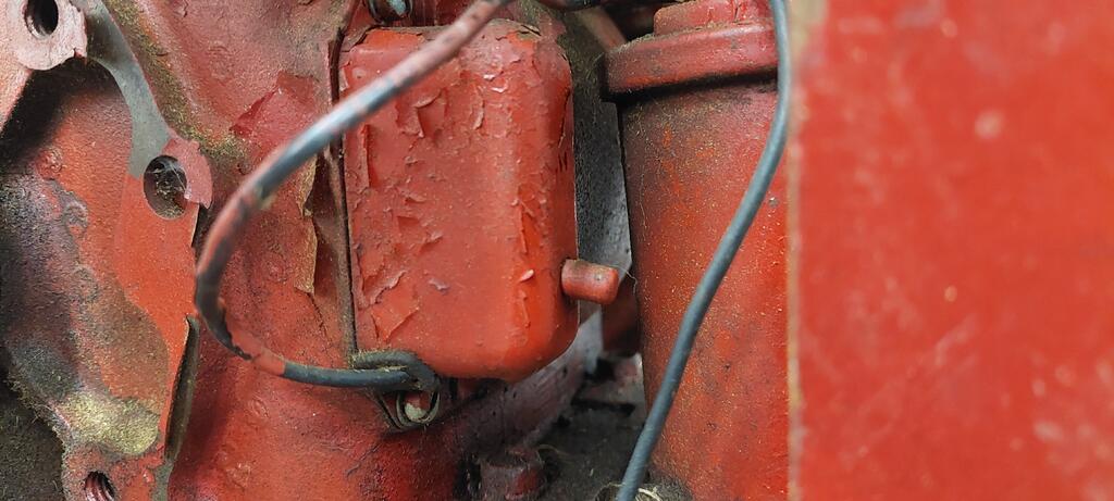

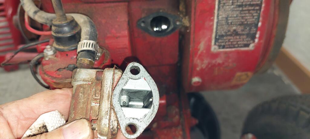

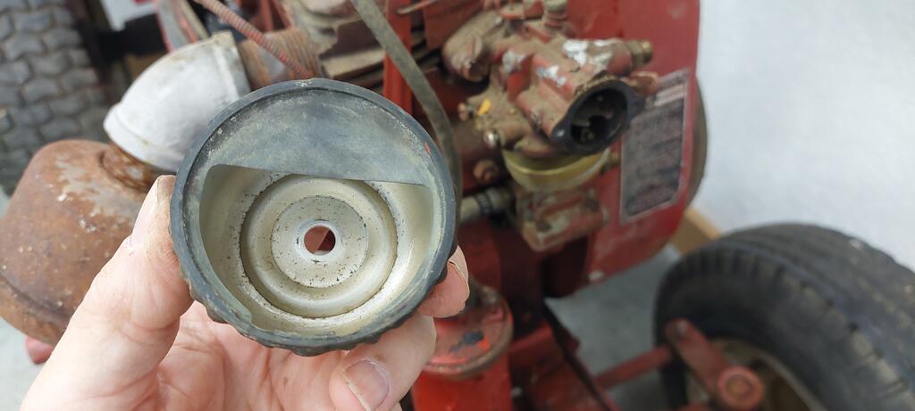

dmoore   1,042 #9 Posted May 17, 2022 Thanks for replying everyone! Appreciate the input....The tractor was put away correctly. The only fuel left in the tractor was that little amount in the bottom of the bowl. I took it apart last night and got it clean as a whistle. The screen was pristine and the gasket still in great condition.   The fuel tank is pristine, the carb float bowl is pristine, float is not stuck. I installed a battery last night and it turns over perfectly. It was a little weird hearing hitting the key and not hearing the click of a starter engaging!   No fire to plug but that may be the points which I have not looked at yet. I will pull the cover tonight and inspect, adjust etc. I am just about positive the fuel pump check valves are stuck. Why wouldn't they be? Good to know the rebuild kits are still out there. Question, How do you check the trans level? I see the drain plug lower left. Also are the exact factory tires still available for this tractor? Thanks!    4 Share this post Link to post Share on other sites

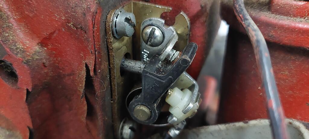

dmoore   1,042 #23 Posted May 17, 2022 Points were little corroded clean them up and we now have good spark 4 Share this post Link to post Share on other sites

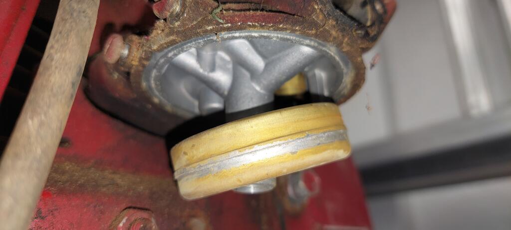

dmoore   1,042 #24 Posted May 17, 2022 If I can get this fuel pump to work I think we will have light off 4 Share this post Link to post Share on other sites
dmoore   1,042 #25 Posted May 17, 2022 So now we know why it was parked 1 3 Share this post Link to post Share on other sites
