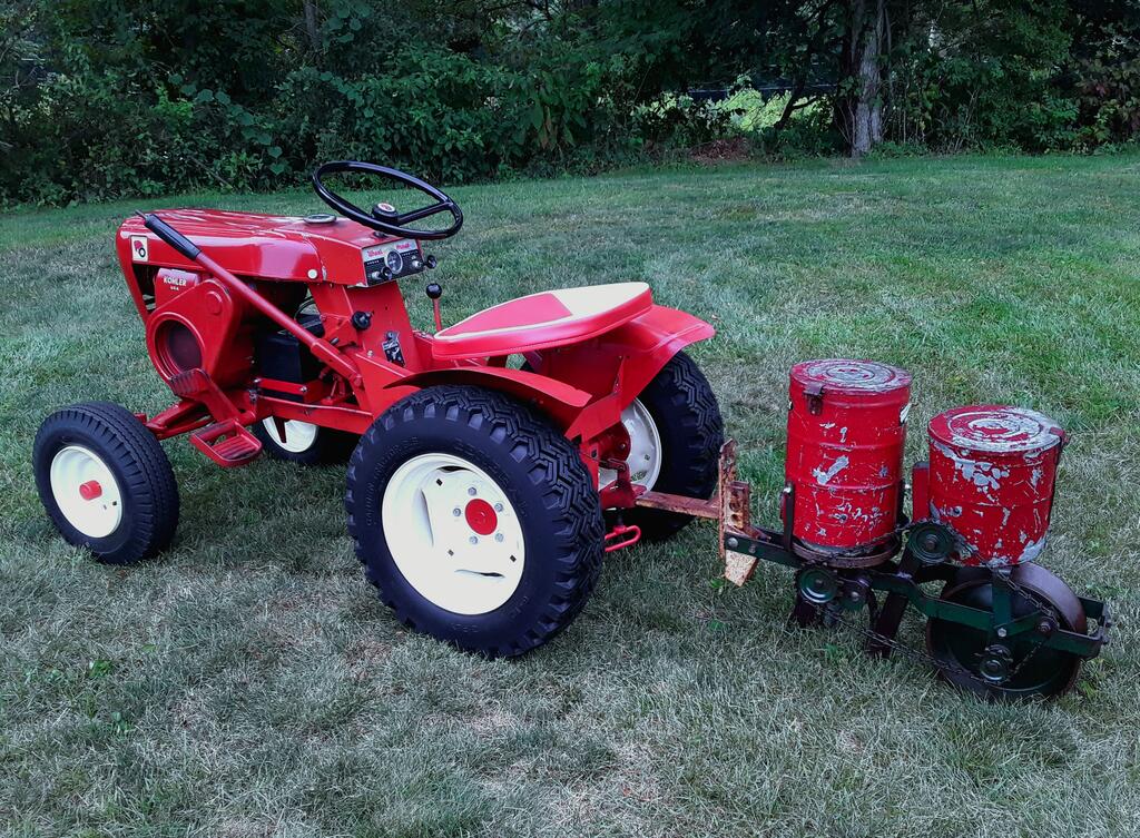

Lane Ranger 12,094 #51 Posted May 18, 2022 1 hour ago, dmoore said: Okay that's your tractor Lane Ranger wow! She is sure sharp I'd like the cleat tires on the back but I don't think I could do clean on the front as well I don't know maybe just me the tri ribs are a good alternative also. You can use 4.000 x 8. Or 3.50 x 8 tri ribs and they both will look good. I put a pair of 3.50 on one of my RJs as they look better to scale smaller! 1 Share this post Link to post Share on other sites

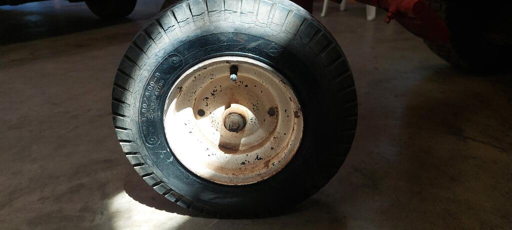

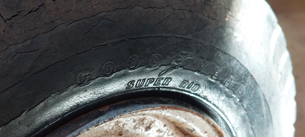

dmoore 1,042 #58 Posted May 18, 2022 Front tires are Goodyear 4.80 /4.00-8 Super Rib. 3 Share this post Link to post Share on other sites
dmoore 1,042 #59 Posted May 18, 2022 What do you guys think? Could these front tires be original? 1 Share this post Link to post Share on other sites
dmoore 1,042 #60 Posted May 18, 2022 (edited) I know the rear tires are not original. They are Carlisle Turf Savers 23 x 8.50 -12 Edited May 18, 2022 by dmoore 2 Share this post Link to post Share on other sites

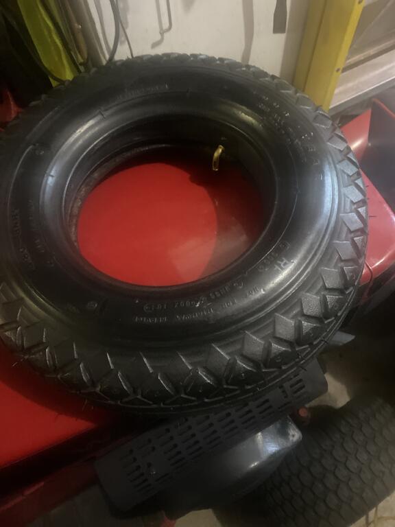

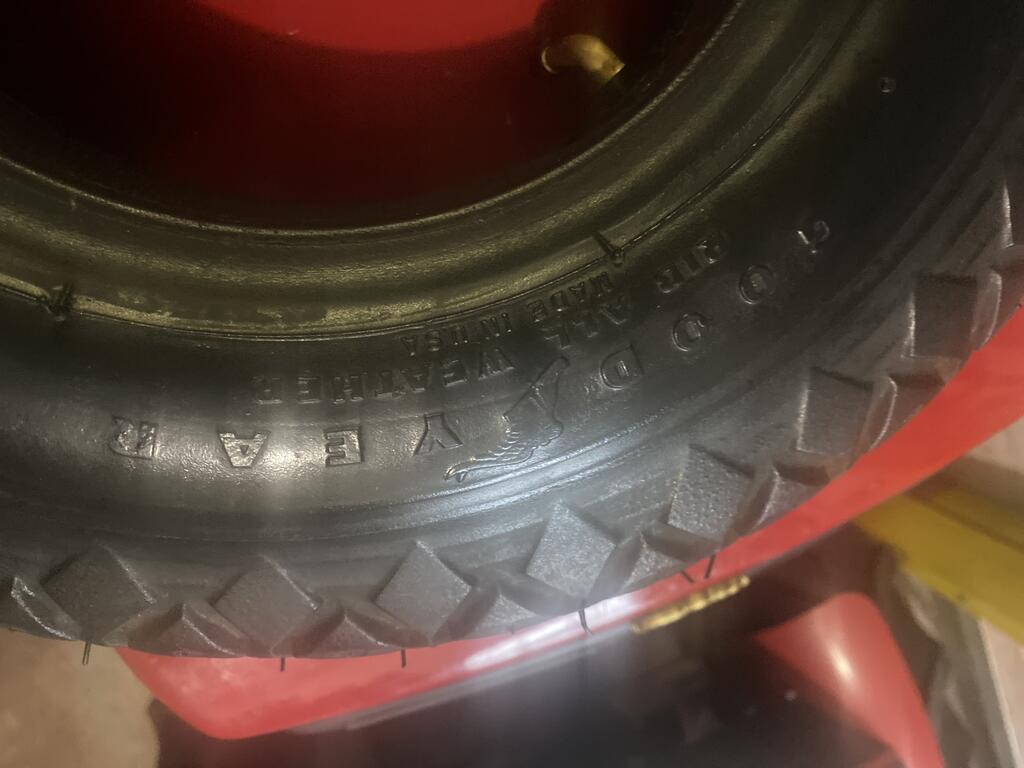

Lane Ranger 12,094 #61 Posted May 19, 2022 2 hours ago, dmoore said: What do you guys think? Could these front tires be original? Yes most likely original. These Goodyears were used on the earlier Wheel Horses. I bought this new old stock set this year. 2 2 1 Share this post Link to post Share on other sites
ebinmaine 80,649 #62 Posted May 19, 2022 2 minutes ago, Lane Ranger said: earlier Wheel Horses Do you know what year they started printing "Wheel Horse" on the tires? 1 Share this post Link to post Share on other sites
dmoore 1,042 #63 Posted May 19, 2022 19 minutes ago, Lane Ranger said: Yes most likely original. These Goodyears were used on the earlier Wheel Horses. I bought this new old stock set this year. Are there more? 1 Share this post Link to post Share on other sites
Lane Ranger 12,094 #64 Posted May 19, 2022 Not many out there that I know of still for sale. Share this post Link to post Share on other sites
76c12091520h 4,284 #65 Posted May 19, 2022 Fronts are the originals, mine has 'em too 2 Share this post Link to post Share on other sites

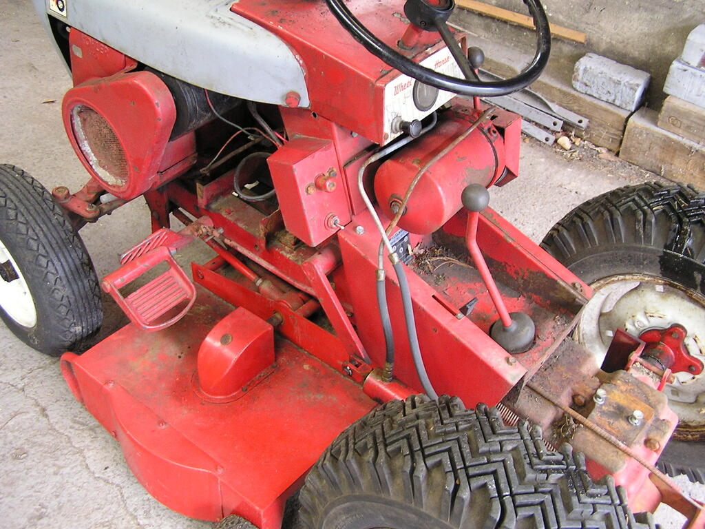

dmoore 1,042 #68 Posted May 19, 2022 And I am dying to know, what are the two holes in hood stand just above key switch? Share this post Link to post Share on other sites
Handy Don 17,463 #69 Posted May 19, 2022 11 hours ago, dmoore said: And I am dying to know, what are the two holes in hood stand just above key switch? I'd guess that at one time that unit had he HY-1, -2, or -3 hydraulic accessory. Mine did and has the same holes. With that installed, it was impossible to reach the key, so that got relocated to a small box added to the left side of the hoodstand. On this unit, and mine, the key is back in the operator-facing part of the hoodstand. Share this post Link to post Share on other sites
dmoore 1,042 #70 Posted May 19, 2022 Don I bet you are correct. I keep forgetting about the hydraulics because of the tractor size! I believe there are a couple 854's here with that option. Thank you! Share this post Link to post Share on other sites
Handy Don 17,463 #71 Posted May 19, 2022 1 minute ago, dmoore said: Don I bet you are correct. I keep forgetting about the hydraulics because of the tractor size! I believe there are a couple 854's here with that option. Thank you! I'm almost positive that the guy I got mine from removed one just before offering the unit for sale. Ok with me as it was easily worth more by itself than I paid for the rest of the tractor and it was not something I wanted anyway. Share this post Link to post Share on other sites
dmoore 1,042 #72 Posted May 19, 2022 Gotcha, Yes, I have seen just the 2 smaller holes side by side and then I have seen the same two holes with a larger hole in between. Share this post Link to post Share on other sites
ri702bill 12,987 #73 Posted May 19, 2022 Here is a plcture of a HY-2 unit I have that was mounted on a 702. The 854 would have used a HY-3, but the pump mount and starter key relocation are the same. The pivot shaft is not the same. 1 1 Share this post Link to post Share on other sites
