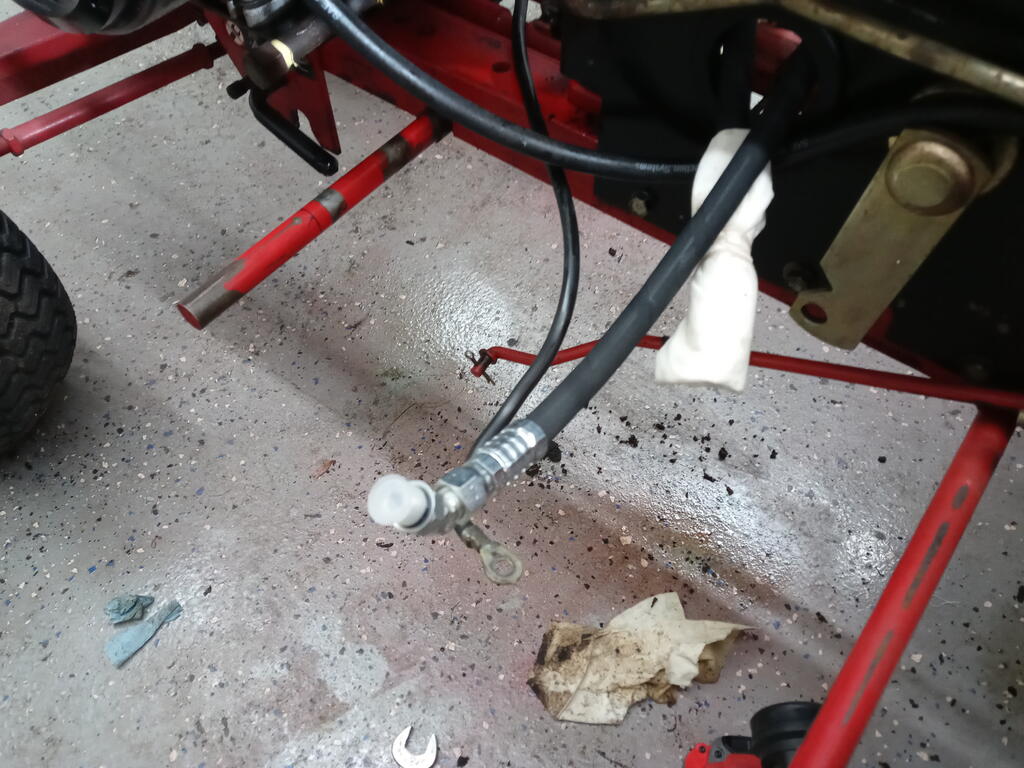

JohnD 145 #26 Posted January 25, 2021 I stumbled across this blog from Misumi recently. It has a good guide to torque for o-rings near the bottom: https://blog.misumiusa.com/5-things-you-should-know-about-o-ring-face-seal-fittings/ Share this post Link to post Share on other sites

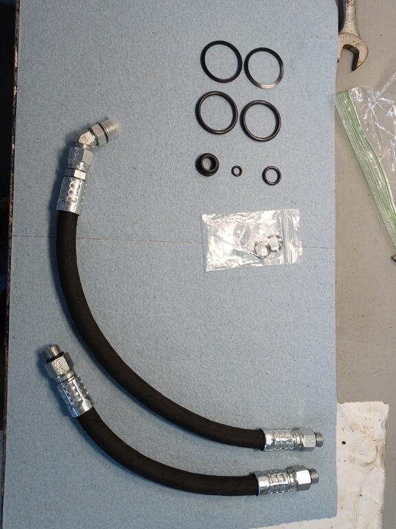

Horse Newbie 7,405 #27 Posted January 25, 2021 (edited) 54 minutes ago, lynnmor said: It sounds like the folks are giving you the information you need. Now page up and review the photos posted to see what I meant about keeping the old hoses if possible, Zeek used new hoses from Surplus Center and did a nice job, but he had an acre of room to work with, you will be very cramped for space. @lynnmor Read you loud and clear on keeping the original hoses...what is your experience with the originals leaking between the brass and zinc as @pfrederi stated above? I do plan on having a chat with @wheelhorseman to see if his hose kits are like the original, or close on size...or what advice he has to give...and you are dead on...space IS limited ! Edited January 25, 2021 by Horse Newbie Share this post Link to post Share on other sites
Horse Newbie 7,405 #28 Posted January 25, 2021 1 hour ago, WVHillbilly520H said: Sorry I can't be of more help @WVHillbilly520H...Hey man, I appreciate the response..still learning more and more about my 520H. It feels good to have support from all of you fellows. Lets just say the last few months with all the issues I've corrected so far, 4 hours of "shakedown" time inspecting the neighborhood curb and gutters, and then tearing back in to fix this hydraulic leak(s)- I knew I had at least one, I have come to know the 520H very intimately ! 2 Share this post Link to post Share on other sites
Zeek 2,299 #29 Posted January 26, 2021 On 1/24/2021 at 3:33 PM, David414 said: @Zeek beautiful job. Just trying to understand hydraulics, you used JIC hose fittings which are metal to metal sealing. According to the parts diagram for my 312-h, the sealing is by o-ring boss. Are we talking two different systems? I don't think this will work with my Eaton 1100? Thanks Looks like you got your questions answered already. Mine was a Sunstand 1966 1276. Share this post Link to post Share on other sites
Damien Walker 297 #30 Posted January 27, 2021 Hi David, As Lynnmor above says, it looks like you're getting very good support, so there's little constructive I can add. Having just disturbed my 518H hoses to splice the power steering in, I'm ashamed to say I cannot identify the type of fittings. I have an excellent hydraulic fittings shop here and they identified the required threads and supplied new hoses and fittings to fit! Stupidly I should have recorded the details for occasions such as this but sorry I didn't! In practice, I doubt you will need much other than new o-rings....I think there's a lot of oil around and so the fittings don't usually seize, at least mine hadn't, despite the machine having been very badly looked after (stored outside with no cover - bad rust everywhere)...the hydraulic lines unscrewed easily. I took so long over my project, I didn't really have a clue as to where each hose fitted, but a quick look at the parts diagram and a look at the length and set in the hoses proved it rather easy to reassemble despite my power steering mod..it couldn't go together any other way. As mentioned though, the whole system remains untested so it remains to be seen what disasters await me! Any decent hydraulic shop should be able sell you (or hopefully even give you) suitable blanking plugs which should screw onto the fittings. You can bung the ends of the pipes with paper or wrap in a plastic bag with an elastic band round *(that's what I did) but in practice, they are easily dislodged and then you have the added hassle of making sure they are clean when you reassemble. Plastic screw in plugs are by far the best. I can only therefore recommend that you do a full strip down. I did and I m very pleased I did....new paint everywhere, no rusty bits, clean hoses etc. I'd say that if you have the courage and capability to get as far as you already have, you'll have no difficulty with the hydraulics. Not sure if anyone has mentioned this but the fittings, particularly on the ram are self aligning. I hadn't seen such things before in the UK and at first glance they appear broken or loose. They aren't, they are very clever design. When you tighten the nut down hard, the hose still flops about - I also have a C175 which is near identical in set up...never had a leak despite that also being an uncared for wreck when I bought it and it is still using the hoses WH fitted it with when it was new. The shaft seal on the valve is a different matter so I would recommend changing that when you have the system in pieces (unless there's no sign of a leak now, in which case it might better to leave well alone!). I'm just sorting the front wheels and seat for my 518H and then I should be able to spend some time on the engine (it's sound as far as I am aware, but just needs the interlock wiring checking) and then get the pump running and test my new installation. I'll post when I know it all works! Have you considered powder coat for any of your metal work? I started with 2-pack paint (good stuff but you need breathing equipment) but have recently started powder coating. It wasn't too expensive to get set up and with proper prep, it works well and gives a very durable finish. 1 Share this post Link to post Share on other sites

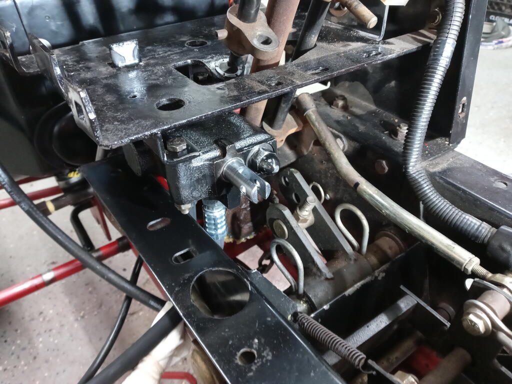

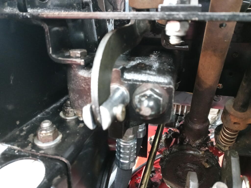

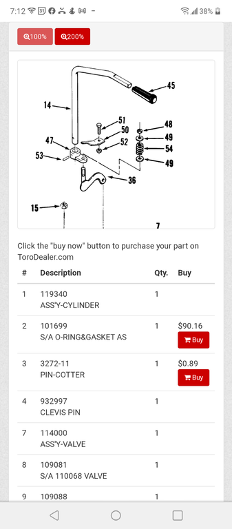

Horse Newbie 7,405 #34 Posted January 31, 2021 (edited) I'll try to get this thread back on topic...since 520H hydraulics is what I'm working on right now. If you will take a look at pic 1, notice the spring between the washer and the retaining cap on the left end of the shaft that runs through the valve body...is this the spring that returns the valve to neutral, or is it part # 54 on pic 2 ? Which of these springs work to return the valve to neutral, or do they both work together to keep the lift lever in neutral position ? I know some of you guys that I tagged have said that you have never had your 520H hydraulic lift control valve apart, but I thought you might have knowledge of someone on Red Square that you could tag for me that may have some experience with this. I have o- rings and other parts on the way from one of our vendors... @WVHillbilly520H , @lynnmor , @wheelhorseman , @953 nut Thanks, Horse Newbie (Tim) OK...FOR SOME REASON THE PICS FLIPPED...1 IS 2 AND 2 IS 1 Edited January 31, 2021 by Horse Newbie Share this post Link to post Share on other sites
Handy Don 17,590 #35 Posted January 31, 2021 (edited) Part 54's job is to keep a flexible tension on the linkage since it's length varies slightly when actuating the valve. The valve body itself contains the springs to return the valves to center. (There is no neutral on the lift control) Remember that there is no float in the 520 lift. The lift stays where stopped by centering the valves. Edited January 31, 2021 by Handy Don Share this post Link to post Share on other sites
Damien Walker 297 #36 Posted January 31, 2021 As far as I am aware, part 54 is just an anti rattle spring. (The 'make sure it's in neutral spring' is on the motion control lever, not the lift lever). The valve is self biased to the middle position so the return springs are internal to the valve...I'm surprised there aren't two in the picture. (Apologies, powder coat was way off topic!) 1 Share this post Link to post Share on other sites

Horse Newbie 7,405 #40 Posted January 31, 2021 1 hour ago, Handy Don said: Remember that there is no float in the 520 lift. The lift stays where stopped by centering the valves. Thanks @Handy Don that is exactly the information that I was looking for...I don't always know the correct terminology for these mechanical systems, but I can usually get my point across and helpful people on Red Square like you and others can usually decipher what I say and give me an answer...the lift stays where it stops... 1 Share this post Link to post Share on other sites

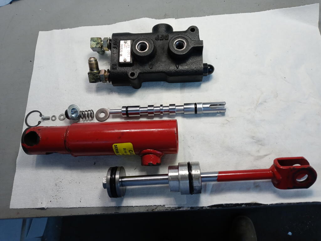

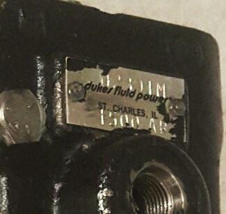

lynnmor 9,051 #43 Posted January 31, 2021 Just for reference, here is the Dukes version: 1 Share this post Link to post Share on other sites
Horse Newbie 7,405 #44 Posted January 31, 2021 Thanks @lynnmor...seem to be fairly simple. Glad I read up on the valve body before I messed with things much (Kept me from turning that allen head adjustment screw under the acorn nut) I was able to determine that I was indeed missing the small screw and washer that holds the retainer cap on the spool...that's why the spool traveled too far forward allowing the o- ring to come past the end of the bore in the valve body. Share this post Link to post Share on other sites

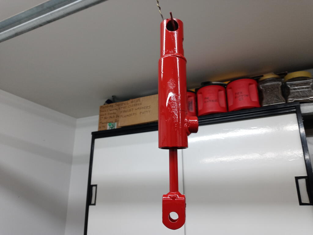

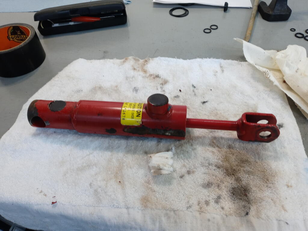

Horse Newbie 7,405 #46 Posted February 3, 2021 (edited) So last night I rebuilt my hydraulic lift valve body and my cylinder on the 1994 520H...got most of the tractor put back together... Just need to paint the cylinder before I reinstall it. Edited February 3, 2021 by Horse Newbie 1 2 Share this post Link to post Share on other sites
Horse Newbie 7,405 #47 Posted February 5, 2021 (edited) So this evening after work I went out to my shop and painted my 520H hydraulic lift cylinder Rustoleum Regal Red...that's what color my tractor is as far as I'm concerned. And I put a few more parts back on... Got a question if anybody can answer... @WVHillbilly520H @lynnmor @953 nut @ebinmaine @DennisThornton @squonk The lift bar ( I'll call it ) has a chain that goes up to what may be called the rock shaft ( not sure of name ). Well if that is what it is, then how do you guys get "down pressure" like I hear you all talking about with a chain there ? Is that where I would replace the chain with a 1/4 inch flat bar ( the long one ) ? Oh, and I moved my lift control lever back and forth and since putting the small screw in the end of the spool shaft that holds the retainer cup on/ in place, my lever and lift valve does " return to neutral" even though technically these valves supposedly doesn't do the "return to neutral" thing. Between the spring in the valve body on the end of the spool shaft and the spring on the linkage, that causes the spool shaft to return to neutral...did not act this way until I replaced the small screw that holds the retainer cup. Edited February 5, 2021 by Horse Newbie Share this post Link to post Share on other sites
Handy Don 17,590 #48 Posted February 5, 2021 Yes, this is the time! Share this post Link to post Share on other sites
ebinmaine 80,998 #49 Posted February 5, 2021 7 minutes ago, Horse Newbie said: how do you guys get "down pressure" like I hear you all talking about with a chain there ? Is that where I would replace the chain with a 1/4 inch flat bar ( the long one ) ? That's the one. Be careful how you handle that though. Most of us only use the solid link on manual lift tractors. If you out one on a hydro IMHO it May be a good improvement. .... BUT!!! You'll need to learn to be very aware of your surface and constantly raise/lower the plow a hair or three. That's why I stayed with the big log splitter controller for the Charger hydro project. It should offer better control. 2 Share this post Link to post Share on other sites
Horse Newbie 7,405 #50 Posted February 5, 2021 2 minutes ago, ebinmaine said: That's the one. Be careful how you handle that though. Most of us only use the solid link on manual lift tractors. If you out one on a hydro IMHO it May be a good improvement. .... BUT!!! You'll need to learn to be very aware of your surface and constantly raise/lower the plow a hair or three. That's why I stayed with the big log splitter controller for the Charger hydro project. It should offer better control. I'll definitely get more opinions off the Square before I replace that chain with a solid bar. Down here in NC if it ever snows... I prolly wouldn't even need down pressure...the weight of the dozer/ snow blade would probably be heavy enough to keep the blade against the concrete with 2 inches of Old Man Winter's fury ( I like those laughing smiley faces ) Share this post Link to post Share on other sites
