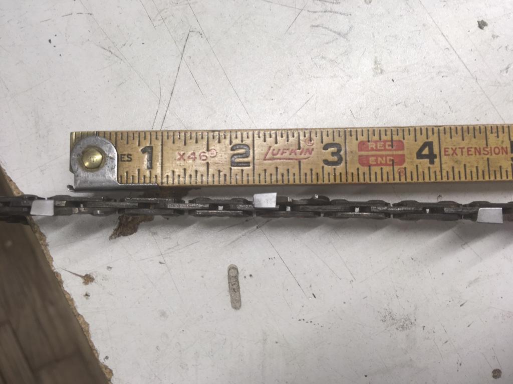

formariz 12,381 #4 Posted April 28, 2020 The chain for a chainsaw mill is a "rip" chain. Ill check mine, but I believe it has no angle on teeth at all. Compare it to a ripping handsaw vs a crosscut. Same principle. The angle at which the teeth edge is ground is also different. It all has to do on the direction teeth are contacting wood fibers. Going right into the end of fibers rather than across.If it is not right it will wonder not making a straight cut and overheat immediately dulling the chain. Let me look at the instructions for mine. It may have all you need to know in there .If so I will post it for you. I also have a sharpening jig which uses a 12 volt battery for it. It uses very fine diamond burrs in it to touch up chain. You want to touch up chain frequently before it dulls. Its not the same as cutting across the grain, but much harder to do. 3 1 Share this post Link to post Share on other sites
posifour11 723 #5 Posted April 28, 2020 Definitely get a purpose made ripping chain. It causes less strain on the saw and moves along faster than a crosscut that was ground into a ripper. I use Archer brand from Amazon. 2 Share this post Link to post Share on other sites

formariz 12,381 #7 Posted April 28, 2020 Looks like a 10 yes. Looking for paper work it’s been a while. Frequency of teeth very important I remember. 1 1 Share this post Link to post Share on other sites

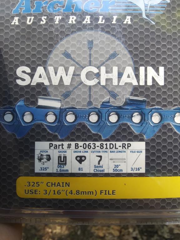

posifour11 723 #8 Posted April 28, 2020 (edited) This is the package mine come in. Maybe the specs will help, maybe not. This is for a Stihl MS290. Edited April 28, 2020 by posifour11 1 Share this post Link to post Share on other sites
formariz 12,381 #9 Posted April 28, 2020 Here is what I use 2 1 1 Share this post Link to post Share on other sites

formariz 12,381 #13 Posted April 28, 2020 Found literature but having issues with my scanner now. Anyway tooth angle on mine is Zero. I know from experience that that is critical along with number of teeth. Ripping creates dust not chips and you need to allow dust to escape efficiently so it does not overheat chain therefor the very few teeth compared to a regular chain. If I cant eventually scan it if you want I can copy the whole thing and send it to you. Lots of great insight into the whole process of chainsaw milling. 2 1 Share this post Link to post Share on other sites

formariz 12,381 #17 Posted April 28, 2020 (edited) @pullstart Here you go. Just pick what applies to your unit. You don't have the sharpener listed here. I numbered pages on top corner to make it easier. I can tell you that the chain I have sharpened to those specs would cut really well leaving a very smooth finish without any deep gouges. Don't let what I said before discourage you. Its a lot of fun and useful. One of the greatest things about it is that you can mill logs where ever they fall and don't have to move them, which for me would have been impossible. Keep extra chains on hand. Inevitably you are going to find some presents inside logs that are not too kind to the chain. You would be surprised as to what also. For me incredibly regardless of how much I cursed when that happened, some of those slabs were awesome pieces with the objects inside sometimes remaining on the finished work becoming what clients loved about it.. Some of the metal objects also created a lot of character by the stains they left in the wood. Eventually you may also have to upgrade that planer to a stationary one with larger capacity. You can have these chains made for you. I used to do that. I even have some here somewhere that are carbide tipped. Keep in mind also a very important thing in chainsaw milling. Power and more power. Use the biggest chainsaw available to you. It’s not the same as cross cutting a log. Ripping chain information.pdf Edited April 28, 2020 by formariz 1 Share this post Link to post Share on other sites

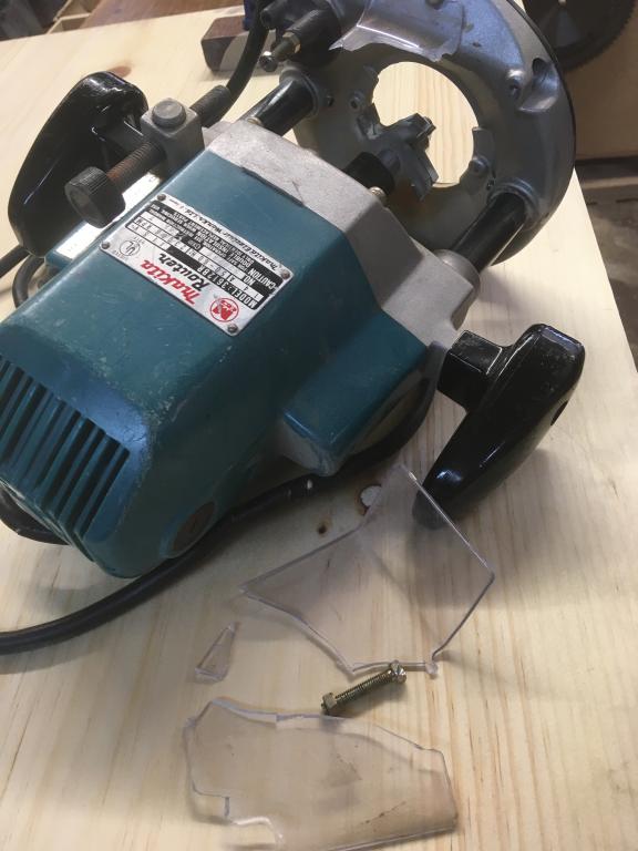

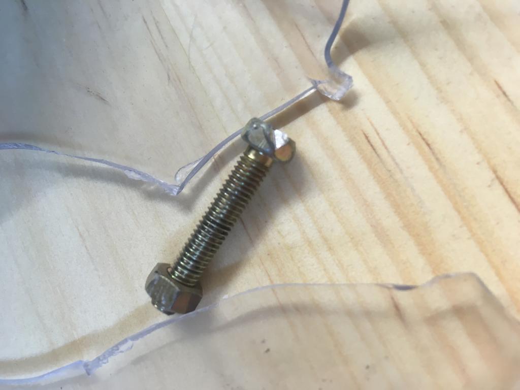

formariz 12,381 #21 Posted April 28, 2020 Ironically shortly after our last posts warning you about shrapnel while using a 3HP router one of the depth set screws walked itself out from vibration came out hit cutter and smacked against dust guard breaking it into pieces. No injuries except a fast heart beat. We can not only tell what to do but more importantly what not to do even by example. 3 Share this post Link to post Share on other sites
