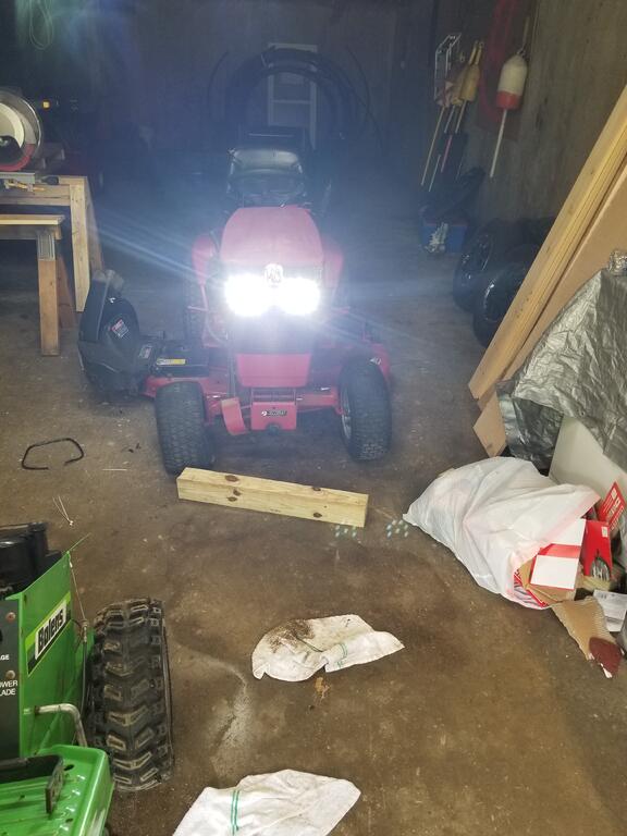

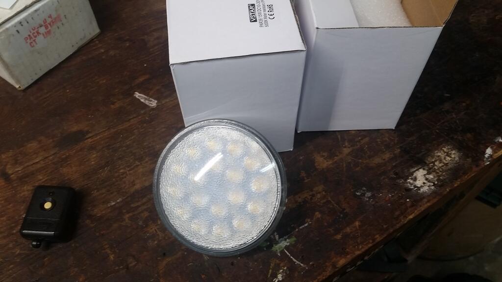

I had to pull the deuce, the one eyed bandit,  in for a quick skid adjust and threw one of new PAR 36's in the one that was blown. I got tired of the missus saying hey...you got a headlight out... even tho ther are aircraft landing lights on it.
Heck of a difference, a much more brighter 5k light.  Pic no good but will get some more when I do the garage door & road test.  These are real close to what you used Denny... maybe even brighter. Specs, amp draw and more pics forthcoming.

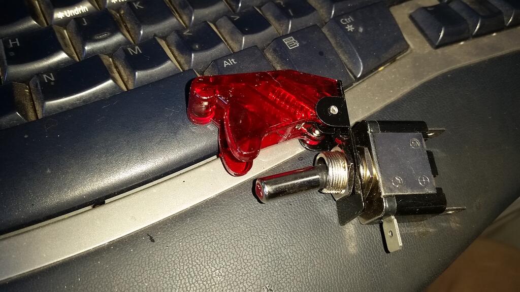

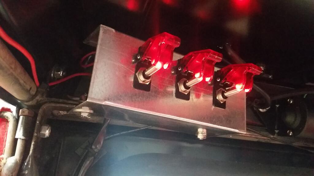

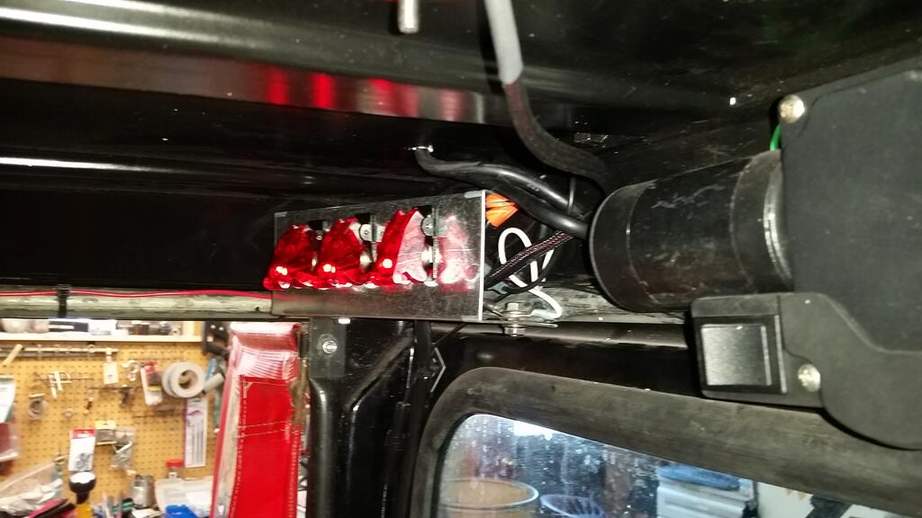

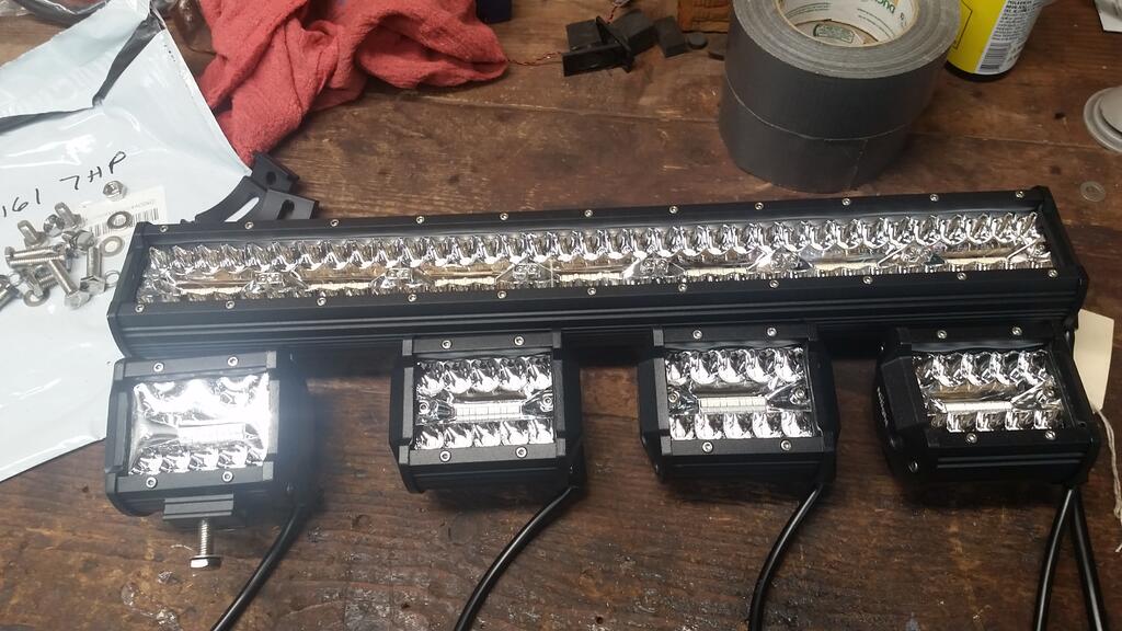

Ok back to lights.... I put some cab lights on Denny, 520H # 4, Didn't quite like the way @dclarke had it wired, was worried about too much draw. So made some improvements.
Made a custom switch panel and mounted it up in the cab corner like 520 # 1. Three switches for front, rear & flasher.  Don't ask me why I used lighted guarded switches ... cool factor I guess and easier to operate with gloved hands? Nawww... cool factor! Did I mention I'm an idiot for idiot lights!?!?
:) They was really cheap on fleabay 15 clams for five or so. Chinese made I'm sure but was surprised by the quality.

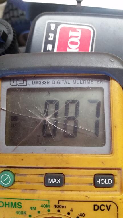

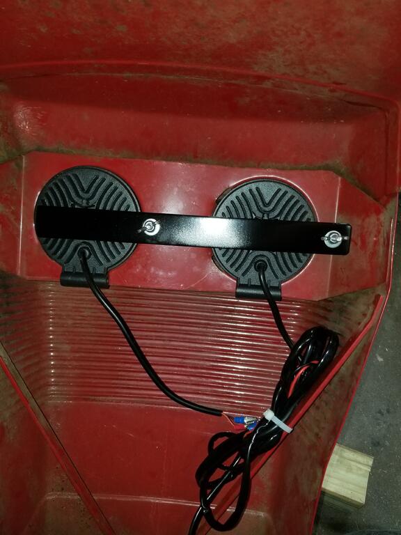

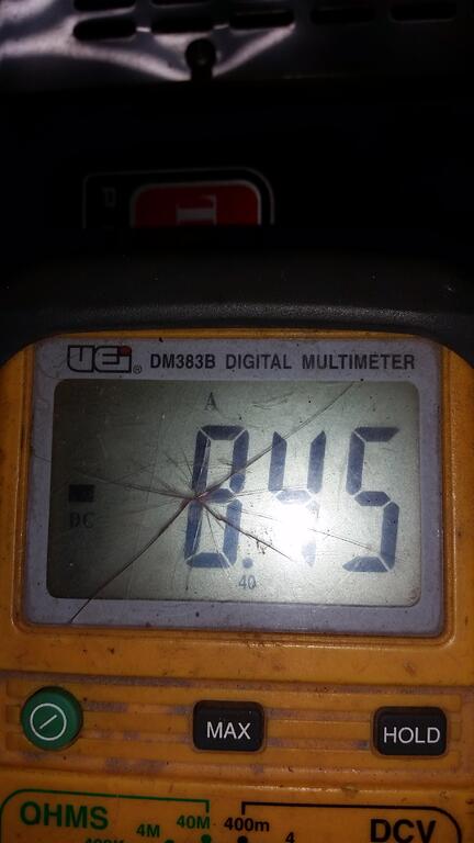

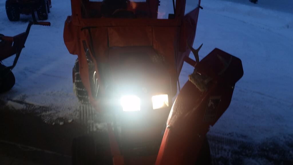

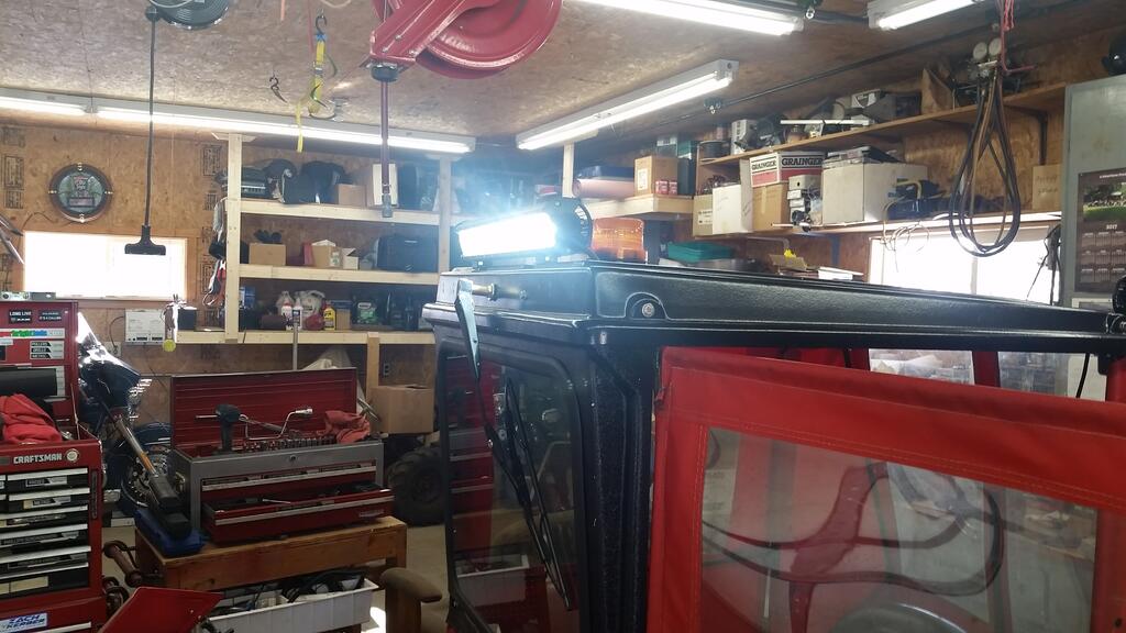

Here's the proof of the pudding .... @lynnmor obviously did some number crunching with Mr. Ohm and advised at 420 watts for the fronts and 60w a piece for the rears it would exceed the 20 amps of a 520 charging system. DMM told the truth. With all cab lights running. The flasher was hard to measure because of the intermittent draw of the flashing but was well under an amp. The first pic is just the lights of the switches. 2nd pic every thing on at full power. A paltry  8.5 amps.
You eagle eyes might notice something odd about pics 3 and 4 my last post ... double dog ya to see what's going on.
Don't mind the cracked DMM..... Squonk dropped it off a 10 ft. ladder when he was sticking his head somewhere where it didn't belong...:lol:
