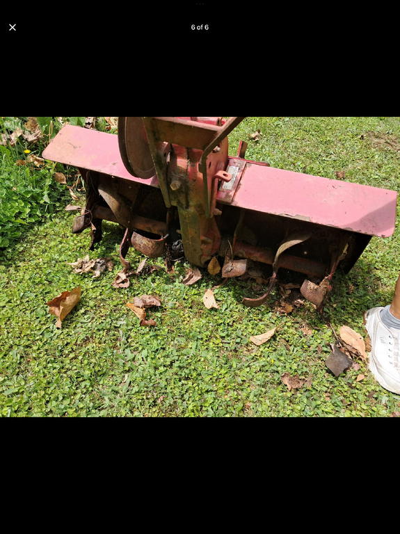

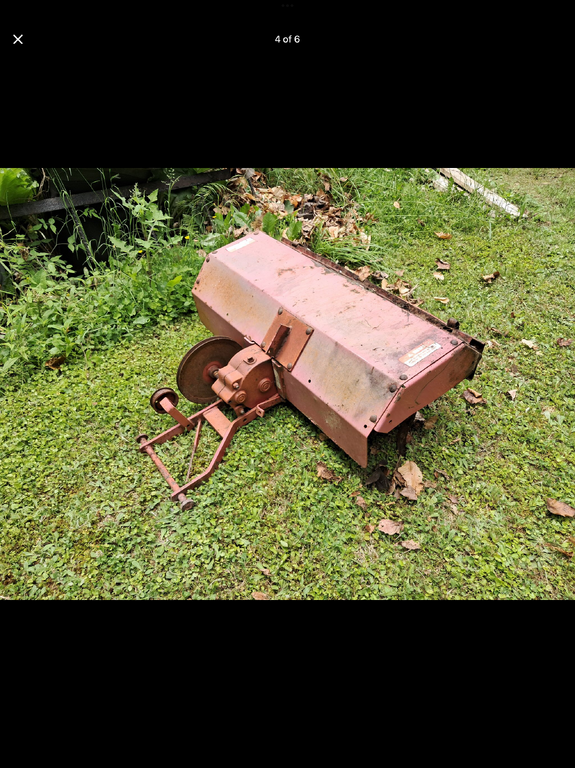

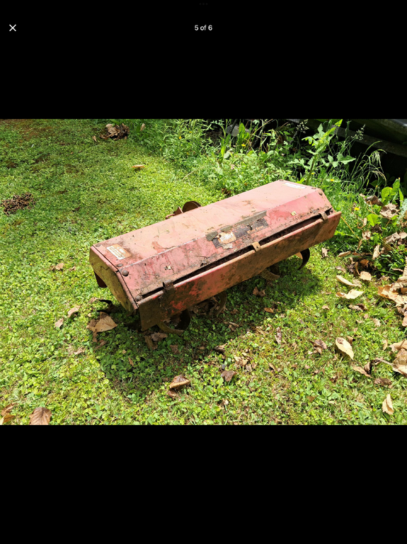

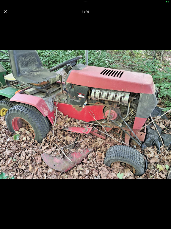

MainelyWheelhorse 3,208 #1 Posted June 17 (edited) This 90’s 520 tractor is on FB marketplace for $600 about 10 minutes from my house. I’m pretty interested in it as this tractor in remotely nice condition in my area with the same implements is 1000+ and an 4 hour trip to either end of the state. It seems to look pretty solid. Most of my tractors I have now started out in close to the same condition with the exception being the C-141. This comes with a rototiller, and what looks to be a decent sized mowing deck. From the description the seller said the tiller was not locked up and worked great when it was used last. It also “ran great when parked”. I asked about if it has the desirable parts for 520’s and the seller referred me to her husband. I have his cell and I figured I’d call him soon. I figure that worst case scenario I have some more heavier duty parts and more implements to use or sell if I need to. Is it worth the $600 or should I haggle or let it pass? Thanks! Edited June 17 by MainelyWheelhorse 1 Share this post Link to post Share on other sites
TonyToro Jr. 2,560 #2 Posted June 17 Looks to be the same age as my 520 as it doesn’t have a swept front axle. So I believe it’s a 1988. Price seems a bit steep for me but depending on the condition of the rototiller id at least look at it and see if the guy is open to offers? 1 Share this post Link to post Share on other sites
MainelyWheelhorse 3,208 #3 Posted June 17 (edited) @TonyToro Jr. The tiller looks solid and not rusted badly too and not beat into the ground. Supposedly it spins free and isn’t locked up. It looks more dirty than any thing else. I’ll have to check it out closer though to know for sure. What do you think would be a good price for the tractor? I thought about starting around $500 as I don’t know if it runs now. The attachments are nice but I don’t necessarily need them. I’ve got other attachments I could use on it. Edited June 17 by MainelyWheelhorse 1 Share this post Link to post Share on other sites

TonyToro Jr. 2,560 #5 Posted June 17 10 minutes ago, MainelyWheelhorse said: @TonyToro Jr. The tiller looks solid and not rusted badly too and not beat into the ground. Supposedly it spins free and isn’t locked up. It looks more dirty than any thing else. I’ll have to check it out closer though to know for sure. What do you think would be a good price for the tractor? I thought about starting around $500 as I don’t know if it runs now. The attachments are nice but I don’t necessarily need them. I’ve got other attachments I could use on it. That tiller looks to be in pretty good shape! Defintely go and look at it and do what @kpinnc says Haggle! 2 Share this post Link to post Share on other sites

oliver2-44 11,850 #8 Posted June 17 (edited) The tiller tines do not look too worn, they are not significantly rounded on the ends. Edited June 17 by oliver2-44 1 Share this post Link to post Share on other sites

Sparky-(Admin) 26,898 #12 Posted June 17 Doesnt have the swept axle or the gear reduction steering. The wide/deep rear wheels appear to be missing. Looks like a 48” deck. Being unable to test or hear the Onan engine, hydro trans, deck or tiller it’s all one big gamble. If ya feel you still want it I would shoot lower..like $400 (have your trailer hooked to the truck and cash in hand) and let the seller bring the price up to the 500 number. Good luck! 2 Share this post Link to post Share on other sites
Ed Kennell 47,958 #13 Posted June 17 Yep, '88 or '89 model. I never believe the "it ran fine when I parked it outside and never moved it for five years". The Onan could be a simple fix or a money pit. I consider it a $150 roller and if the tiller and the 48"deck turn free add $300. I would start at $400. 4 Share this post Link to post Share on other sites
953 nut 70,663 #14 Posted June 17 (edited) 11 hours ago, MainelyWheelhorse said: “ran great when parked”. Those four words are a warning that something ain't right now but you won't know until you get it home. If you need a tiller and a deck they have value. If you plan on reselling them they are a bit less valuable because time will tell how good a deal it was. The fact that it is setting in an open field and they didn't even clean it up makes me think a realistic seller will take whatever they can get for it. Unless you have an overwhelming desire to have this 520 I would start at $ 200.00 and walk away at $ 400.00. Just too many unknowns and the seller is obviously not motivated enough to seek a higher price by having it "run great when sold." Edited June 17 by 953 nut fat finger 6 Share this post Link to post Share on other sites
pfrederi 21,345 #15 Posted June 17 Looks like not the only "Ran when parked" tractor he has rusting away (John Deere in the back ground) To me you are buying a tiller (with out all the pulleys) and a parts tractor.... The deck buried in wet leaves probably not in good shape 2 Share this post Link to post Share on other sites
lynnmor 9,081 #16 Posted June 17 I'll never work on another Onan that was left in the weather, too many fasteners rusted fast. Folks that abuse tractors like that one do not deserve more than a token amount for their careless style. 6 Share this post Link to post Share on other sites

Lee1977 7,813 #24 Posted June 17 As has already been said a nonrunning 88 520 is nothing special.. Onans can be a problem even well cared for. 1100 Eaton untested and not stored in side That deck buired in crap may not be worth much. 100 for the parts tractor and 200 for the tiller. 2 Share this post Link to post Share on other sites
