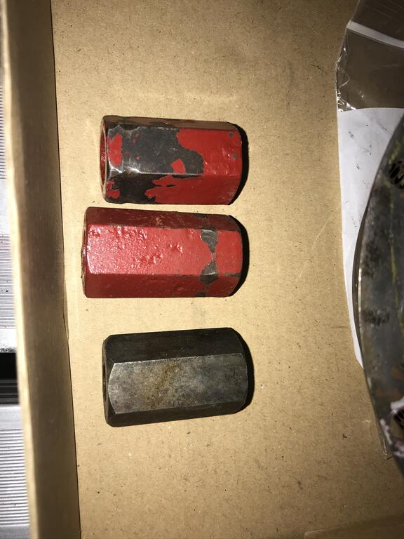

ACman 7,722 #5 Posted September 27, 2021 (edited) Ok fellas I’ve been stumped looking at my S/G pulley on my RJ engine and it has a bolt . The blue one is one I gave to @pullstart and it had a nut which seems to be the norm . I have a Schnake recoil I bought from @Jake Kuhn I want to install on the red engine but that bolt has me confused . I do know this engine had a full rebuild with paperwork from machine shop if I could find it . Possible threads machined off and taped because of messed up threads ? @AMC RULES @Shynon @Lane Ranger @wallfish @squonk Thoughts or answers . I haven’t had the pulley remote yet. You guys know my situation. Heck I couldn’t even get to the tractor show 2 miles away from me this last weekend . Edited September 27, 2021 by ACman 2 Share this post Link to post Share on other sites
wallfish 20,031 #6 Posted September 27, 2021 7 hours ago, ACman said: Possible threads machined off and taped because of messed up threads ? Think you're right. That should be the threaded end of the crankshaft for a nut 2 1 Share this post Link to post Share on other sites
Lane Ranger 11,976 #7 Posted September 27, 2021 (edited) 8 hours ago, ACman said: Ok fellas I’ve been stumped looking at my S/G pulley on my RJ engine and it has a bolt . The blue one is one I gave to @pullstart and it had a nut which seems to be the norm . I have a Schnake recoil I bought from @Jake Kuhn I want to install on the red engine but that bolt has me confused . I do know this engine had a full rebuild with paperwork from machine shop if I could find it . Possible threads machined off and taped because of messed up threads ? @AMC RULES @Shynon @Lane Ranger @wallfish @squonk Thoughts or answers . I haven’t had the pulley remote yet. You guys know my situation. Heck I couldn’t even get to the tractor show 2 miles away from me this last weekend . All you can say is the crankshaft is shorter than you need ! Maybe a hex threaded bolt with no head and two flat sides on your red 4 hp Kohler could accommodate the Schnacke hex head nut? The hex head nut will hold. Something was changed for sure from normal. Edited September 27, 2021 by Lane Ranger 4 Share this post Link to post Share on other sites

Shynon 7,594 #11 Posted September 27, 2021 21 hours ago, ACman said: Possible threads machined off and taped because of messed up threads someone used impact to put the nut on and broke off the nose. I would pull the bolt and if the crank is threaded install a threaded stud and then install the schnacke nut. 1 Share this post Link to post Share on other sites
