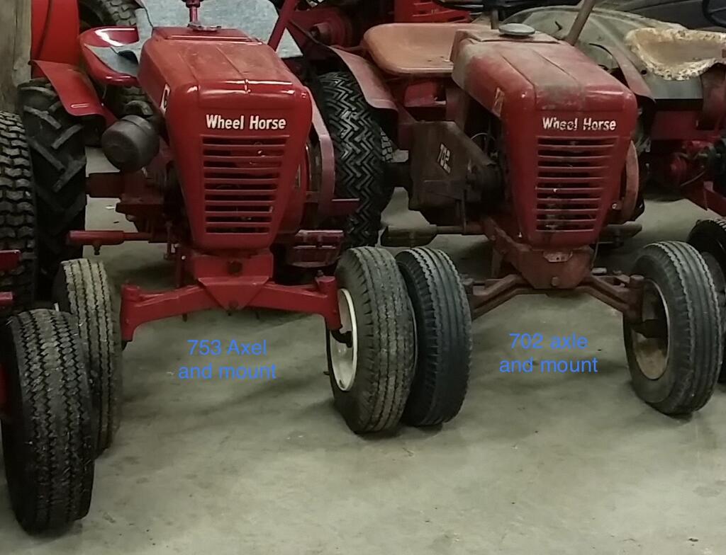

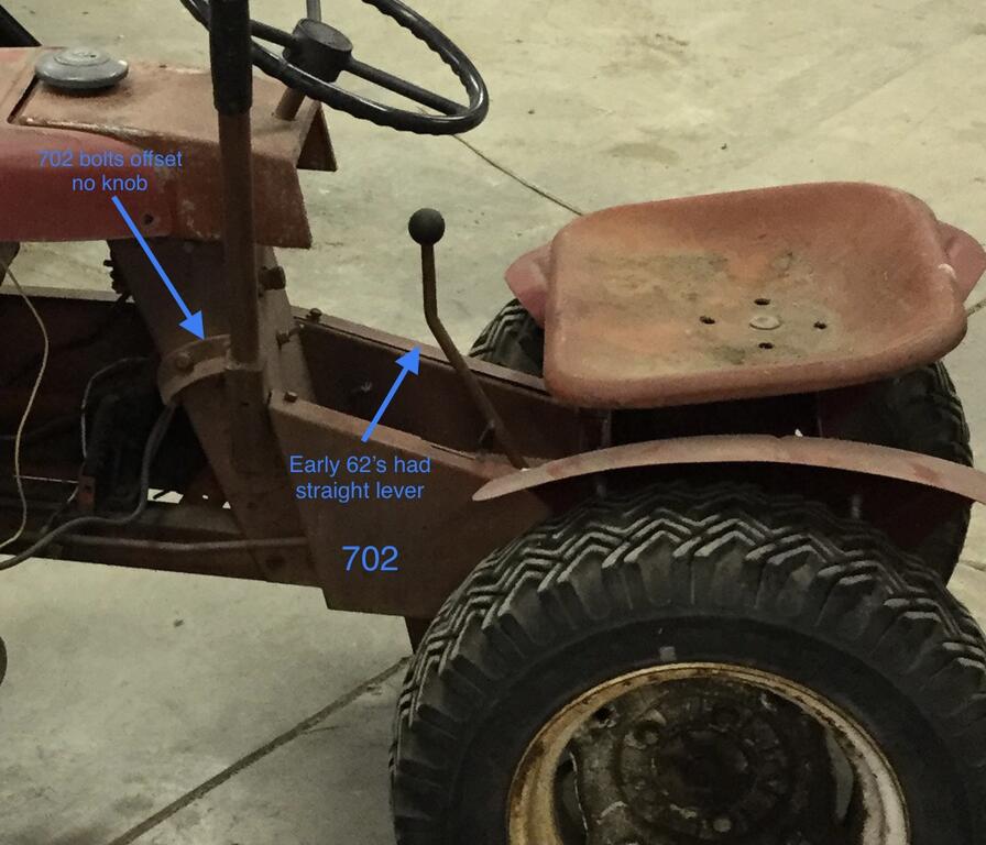

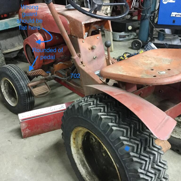

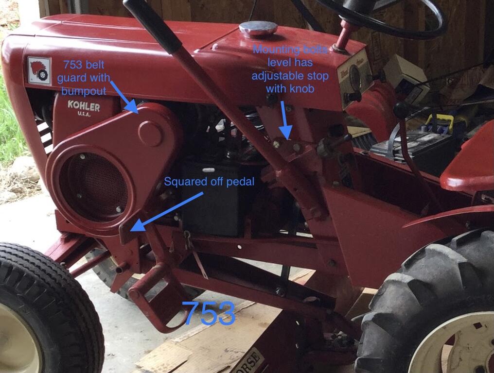

ACman 7,715 #30 Posted May 9, 2021 (edited) On 5/8/2021 at 1:14 AM, Bhomberger said: It’s a 753 all day long view spec number So the engine may be specked for 63 but your tractor’s serial number 62 1187 says it’s a 62 thanks @gwest_ca . Besides the front axle, starter/generator belt guard you also have the clutch/brake pedal, and early 62 straight shift lever of a 1961/62 . If you look at the hood stand where your lift lever should be the holes to mount the stop are offset . In 63 they were level with each other for the adjustable stop . All these are adding up that it’s a 702 and not a 753 . I’m not trying to be a jerk here I’m following all the clues to what the tractor really is . This is all knowledge that I learned from the members of this great forum . You probably already know that the seat is wrong and have the replacement steering wheel that many wheel horses got put on throughout the years. 753 or 702 both great tractors to have. The casting date on the trans could be another clue. Fellas a little help here as to what I’m seeing is correct .... @Achto @WHX24 @Shynon @AMC RULES @Racinbob @ri702bill @stevasaurus @squonk @pullstart Edited May 24, 2021 by ACman 6 Share this post Link to post Share on other sites
stevasaurus 23,662 #31 Posted May 9, 2021 Yep, it's a 702 with a 753 engine. @ACman I take it Gerry verified the serial number as a 1962 number. The seat is wrong for both the 702 & 753 and if it has more then 13 holes around the outside edge it is not even from Wheel Horse.. Good eye Jeff. 3 Share this post Link to post Share on other sites
Shynon 7,545 #32 Posted May 9, 2021 @ACman @stevasaurus are correct 702. Lift arm and rockshaft for this are only on 701,702,552. 4 Share this post Link to post Share on other sites
Pullstart 69,552 #33 Posted May 9, 2021 Jeff @ACman you pulled me in for advice or confirmation, but you just learned me way more than I knew about the 62 and 63 differences! Bravo! 2 Share this post Link to post Share on other sites
Racinbob 12,878 #34 Posted May 9, 2021 You nailed it Jeff. Several dead giveaways. The only 63's that used that front axle were the Lawn Rangers and the 603. Nice write up. 4 1 Share this post Link to post Share on other sites
