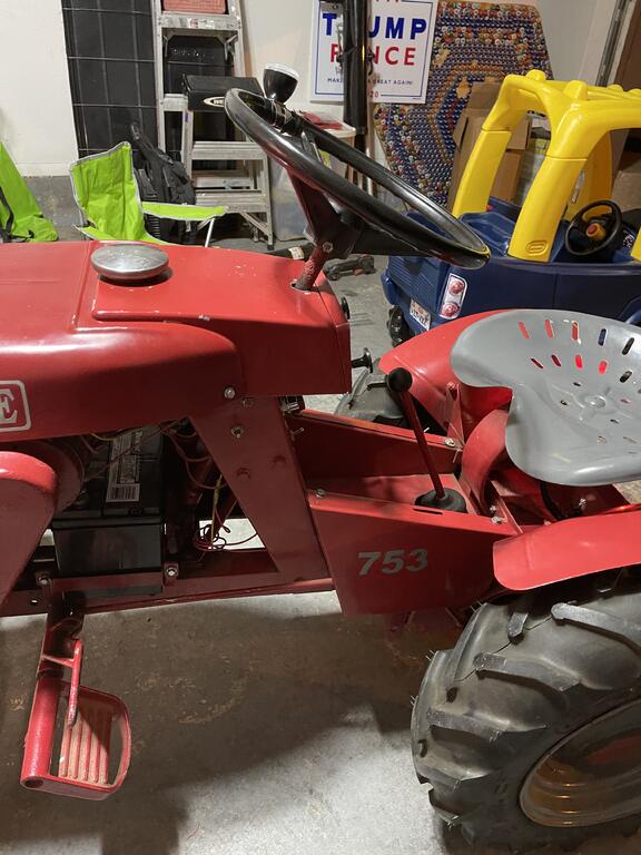

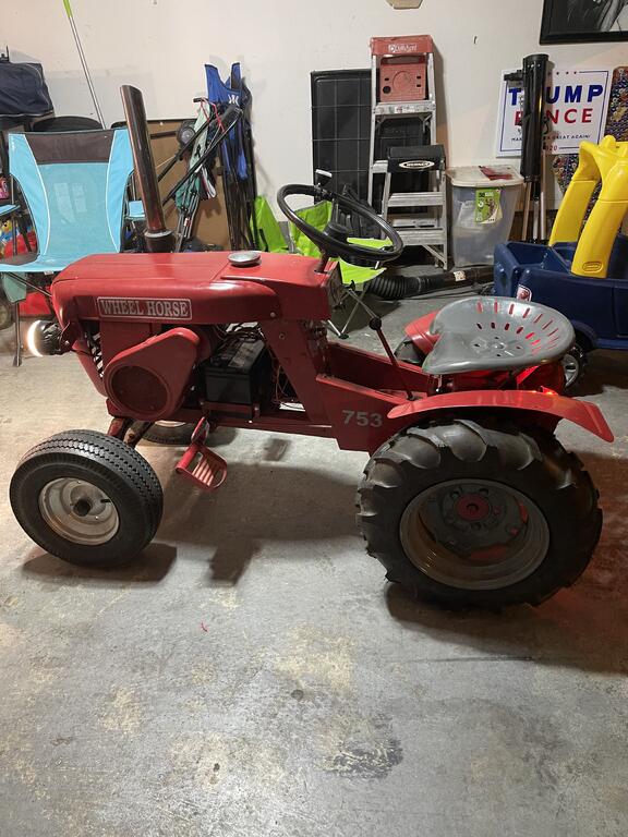

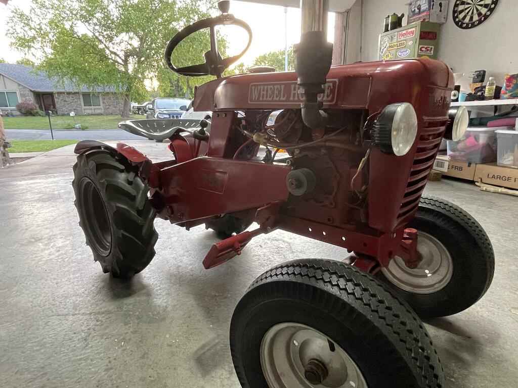

I picked up a 753, needing general knowledge of this machine. It has something wrong with the transmission, gear pattern is wonky, no neutral to be found. And what accessories will fit it? And what general Maintenance should be done? Thanks!

:text-coolphotos:              That is a sweet looking 753 you have there, even has the headlights.            :woohoo:

WHX??
:WRS:
753 is a fav around here ain't that right Dan? :)
Yours looks to be in better shape than most we see come through here.
Gotta like the big ole industrial start button!
Lots of 753 experts here so you came to the right place!

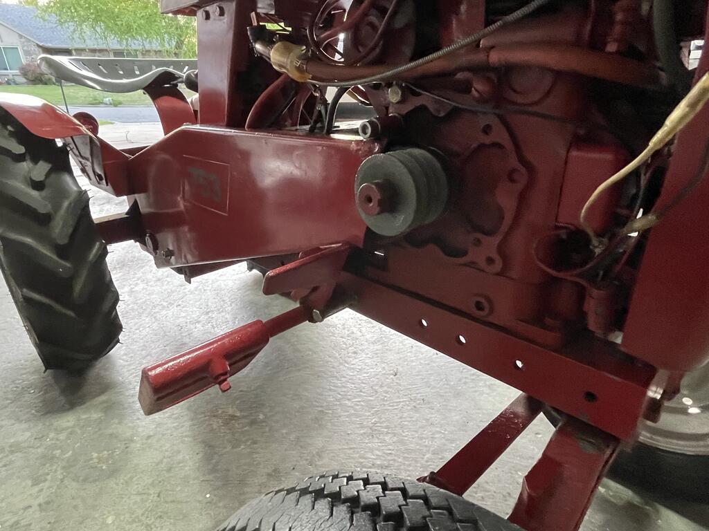

ACman

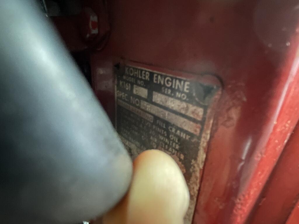

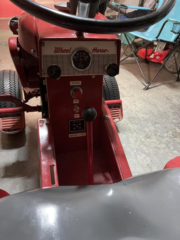

One problem I see with it right off the bat is that it’s a 702 and not a 753 . Just going from the clues of the front axle and starter/generator belt guard . @BhombergerCan you get a good picture of the serial number off the shift pattern decal and the data plate on the engine . It’s missing the lift arm and rocker shaft and that would be another clue as the 702 would just have a detent and a 753 would have the adjustable stop with a knob .Nice tractor either way :handgestures-thumbupright: .
Edited by ACman
  • Like 3
  • Confused 1
squonk
Even the serial starts with 62
  • Like 2
It’s a 753 all day long view spec number
  • Confused 1
