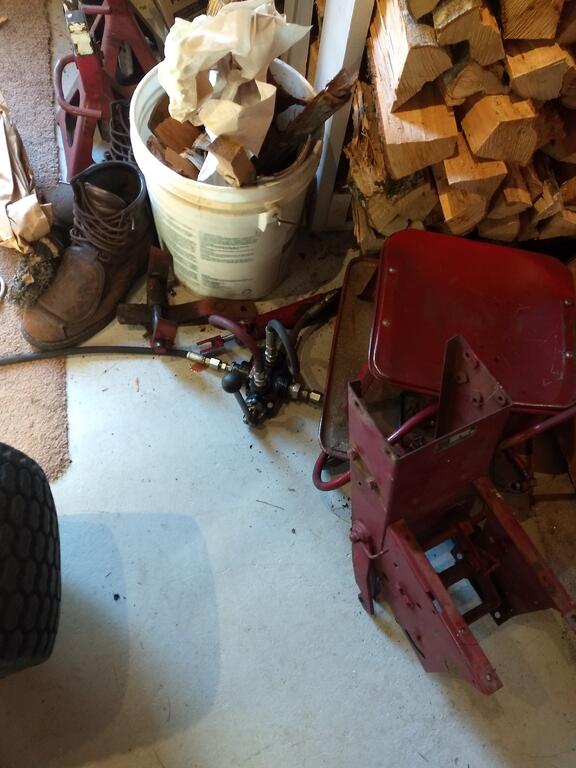

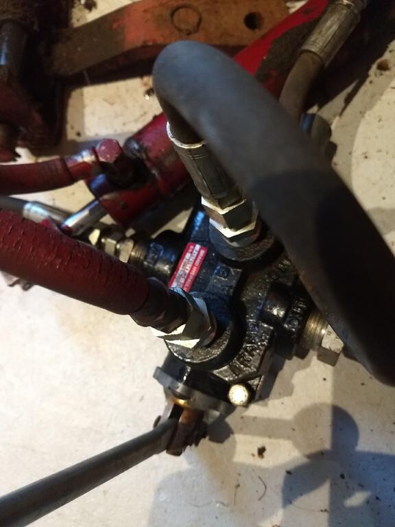

ebinmaine 81,156 #5 Posted October 21, 2020 These are the only two pictures I have of the control itself. It's quite large in comparison to a stock standard control. Share this post Link to post Share on other sites

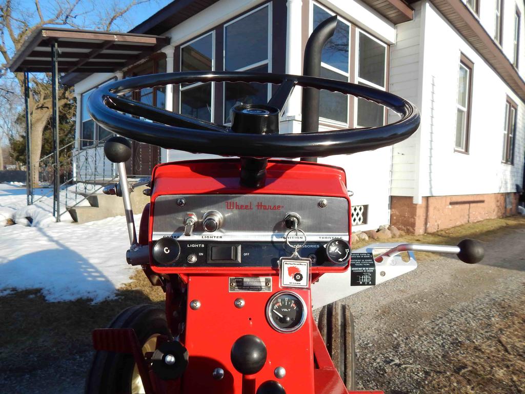

953 nut 70,354 #13 Posted October 21, 2020 No doubt I am the oldest Hydro owner on the list of people you called on. For me the side of the tower with up is up and down is down seems best. probably add a couple of 90s to the hoses that come off the face of the controle. Older hydro owners... I need some advice 1 2 Share this post Link to post Share on other sites

PeacemakerJack 11,080 #20 Posted October 22, 2020 Sorry I’m late to this party EB but I’ve been having fun today with the family. I like the idea of having it in a place where you can manipulate it with your steering wheel left hand. I have plowed with Dan’s Raider and his levee placement works really well. Kelli’s Dxi has the factory position on the dash (up is up and down is down. That works well too. I love the idea of the fender cause it is like the 1984 Super C but it would mean extra plumbing... 1 Share this post Link to post Share on other sites

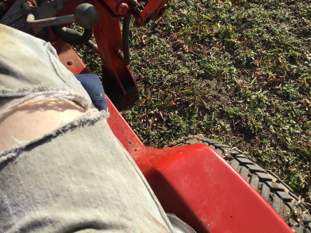

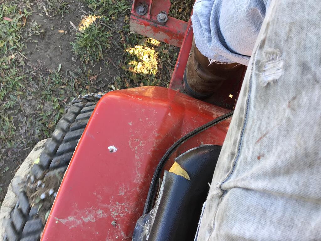

ebinmaine 81,156 #22 Posted December 24, 2020 Just wanted to throw a post in on this thread to tell you what looks like is going to be happening.. I found a shop local to me that builds hoses for a very reasonable rate. Looks like his prices are actually going to come out LESS than online. @pullstart @Stepney @Achto Your suggestion of using the seat pan or fender looks like it's going to be the winner. I've tried as much as I can to watch my habits with Cinnamon Horse and figure what is the most ergonomically correct for me and the way that I operate. I've also done this to some extent with the lifts at work but they are controlled with the opposite hands and feet so this one is just going to be another learning curve. I've I've taken a couple of moments of Trina's time on two different occasions to show her what it is that I'm trying to accomplish and take recommendations or corrections from a separate set of eyes that see things from the angle of "not on the tractor." @Ed KennellKennell and @PeacemakerJack (others?) Some of you had mentioned really liking the idea of having the control near the steering wheel. Keeping in mind this is my first Hydro but also keeping in mind that the right hand fore & aft control of the tractor is right below the steering wheel, I'm fine as far as that goes. I've also noted while operating Cinnamon that when I get to the end of a plow row and I go to reverse my left hand is on the up and down lever and my right hand is on the shifter and it stays that way for at least a foot or two before I even grab the steering wheel. I'll try to remember to update this post with further thoughts or results. 3 Share this post Link to post Share on other sites
WVHillbilly520H 10,379 #23 Posted December 24, 2020 6 minutes ago, ebinmaine said: Just wanted to throw a post in on this thread to tell you what looks like is going to be happening.. I found a shop local to me that builds hoses for a very reasonable rate. Looks like his prices are actually going to come out LESS than online. @pullstart @Stepney @Achto Your suggestion of using the seat pan or fender looks like it's going to be the winner. I've tried as much as I can to watch my habits with Cinnamon Horse and figure what is the most ergonomically correct for me and the way that I operate. I've also done this to some extent with the lifts at work but they are controlled with the opposite hands and feet so this one is just going to be another learning curve. I've I've taken a couple of moments of Trina's time on two different occasions to show her what it is that I'm trying to accomplish and take recommendations or corrections from a separate set of eyes that see things from the angle of "not on the tractor." @Ed KennellKennell and @PeacemakerJack (others?) Some of you had mentioned really liking the idea of having the control near the steering wheel. Keeping in mind this is my first Hydro but also keeping in mind that the right hand fore & aft control of the tractor is right below the steering wheel, I'm fine as far as that goes. I've also noted while operating Cinnamon that when I get to the end of a plow row and I go to reverse my left hand is on the up and down lever and my right hand is on the shifter and it stays that way for at least a foot or two before I even grab the steering wheel. I'll try to remember to update this post with further thoughts or results. On my 520s the column mounted controls are lift lever on the left (just like the manual lever) and motion control on the right... Hhhmmm you see a theme here? and unless I'm in a tight spot next buildings or vehicles I hardly ever use the foot brake. You may actually get used to this style set-up quite easily ... Just my . 1 Share this post Link to post Share on other sites
ebinmaine 81,156 #24 Posted December 24, 2020 1 minute ago, WVHillbilly520H said: You may actually get used to this style set-up quite easily Yes sir I believe that to be true. Just a matter of seat time and practice. I'm self-taught on every other machine I've ever learned to run so hopefully this one goes smoothly. 1 Share this post Link to post Share on other sites
WVHillbilly520H 10,379 #25 Posted December 24, 2020 Just now, ebinmaine said: Yes sir I believe that to be true. Just a matter of seat time and practice. I'm self-taught on every other machine I've ever learned to run so hopefully this one goes smoothly. Goes back to @JCM, Jim's confusion thread, the closer something is to what's "comfortable" the easier it is learn, those mid 70s-90s CC had the motion control and lift lever both on the right side. 1 Share this post Link to post Share on other sites
