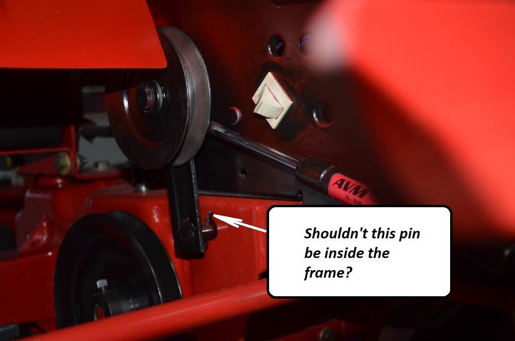

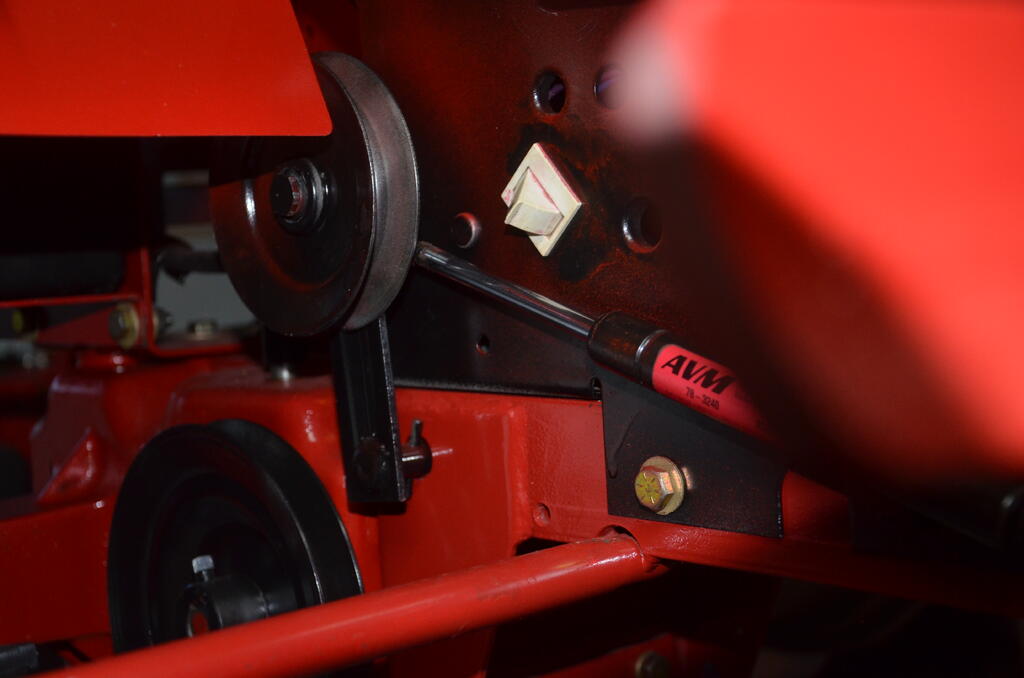

okay guys what am I missing here on the left left side control peddle arm that you work with your left foot to stop and go. The pedal just stays down and no way of stopping by just lifting your foot so the peddle can raise up and down
