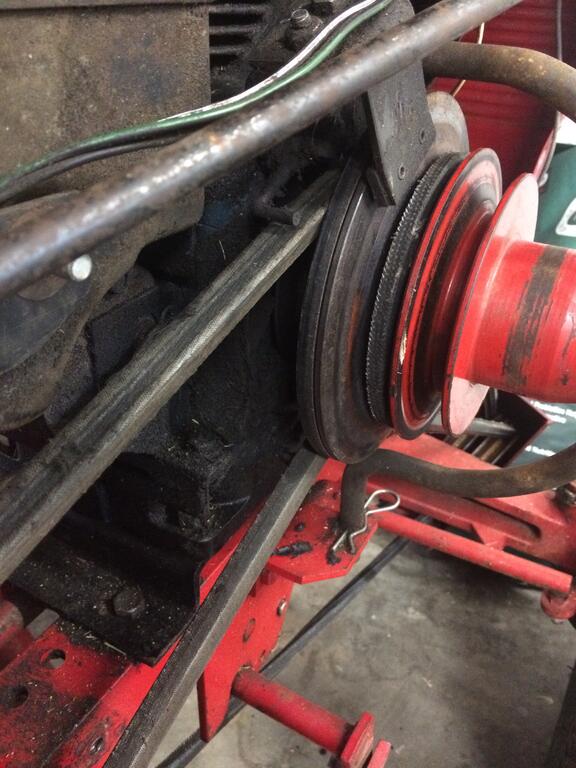

By the jeep driver
My daughter was using the Wheel Horse rider to mow, I was push mowing. She drives over to me and says, "Dad, the blades aren't turning." I look at the mower, she's got the blades engaged (lever forward) but nothing is moving. I disengage the blades, and re-engage... nothing. No movement from the belt nor clutch. Then I notice the smell, and look closer, the belt is so hot is melting on the clutch. Or rather, the clutch is so hot it's melting the belt. Melting occurred.
While the clutch is disengaged, I can spin the clutch freely; and whilst it's engaged, it won't move.
So, what did I do now? Peter told me to lube that needle bearing, but I couldn't find a write up/how to anywhere, so I was putting it off until after the leaves were done falling in the Fall. I haven't taken anything off yet, other than the pins that hold the pinion and such, and the little brake pad. I see there are two snap rings, assume they come off, and then the assembly slides out as a whole?
Some pictures of the clutch, can anyone tell if it's usable from them?

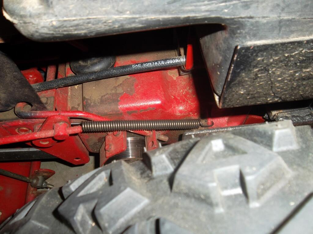

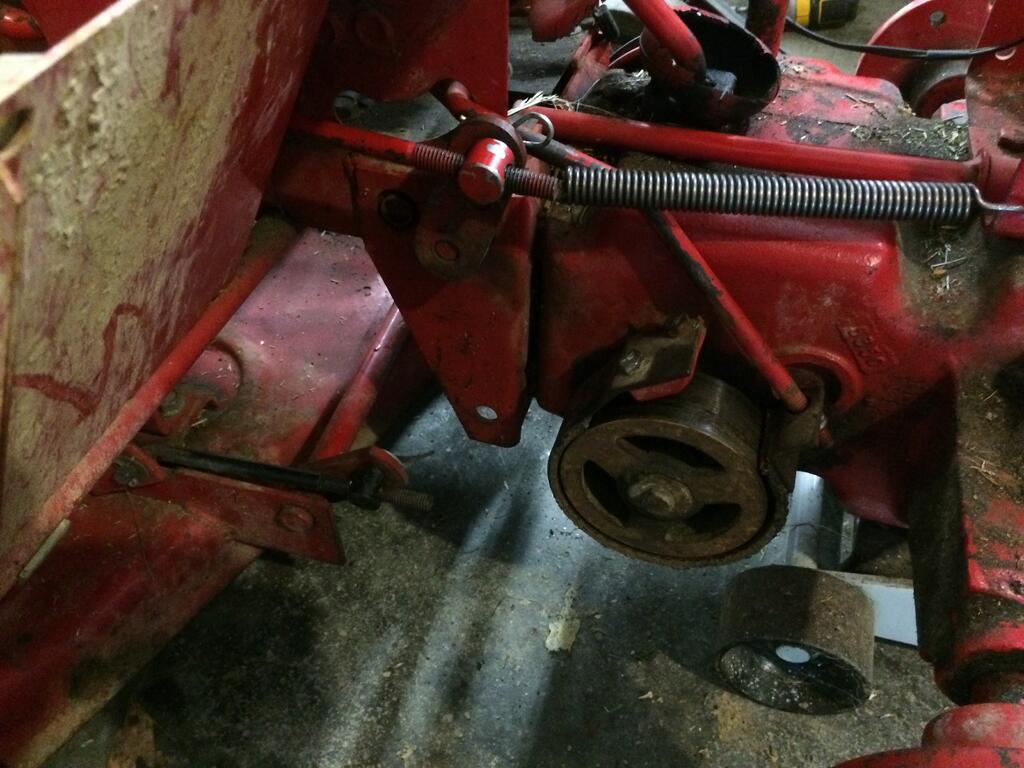

By snrohio2288
Hi Guys, new here. About a year ago I bought a house which came with a nice 208-4. The tractor was abandoned by the owners of the house in the shed as it "wouldn't start anymore".
Turns out mice had made a nest in the engine shroud and chewed through the spark plug wire. A new coil and battery later and she has been serving me well for a year.
The other day though, after stepping on the clutch and letting go, the tractor didn't move anymore. Came to find out my clutch spring had broke (found part of it in the yard).
I ordered a new OEM spring and it arrived. The problem I am having is I can't seem to find where the other end of the spring attaches to the frame.
I have a diagram I found online but it simply says "hole in frame opening".
Does anyone know or have a similar model they can look at and guide me where this spring goes?
See attached diagram.
