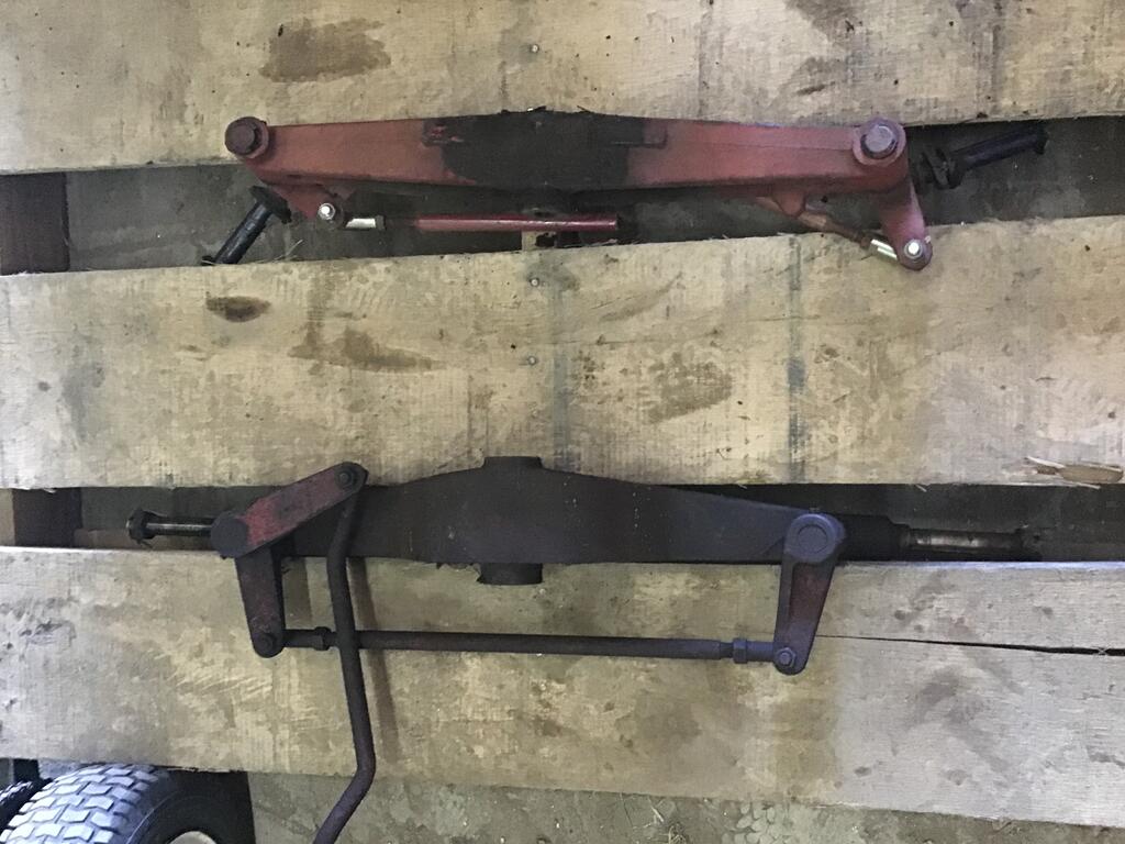

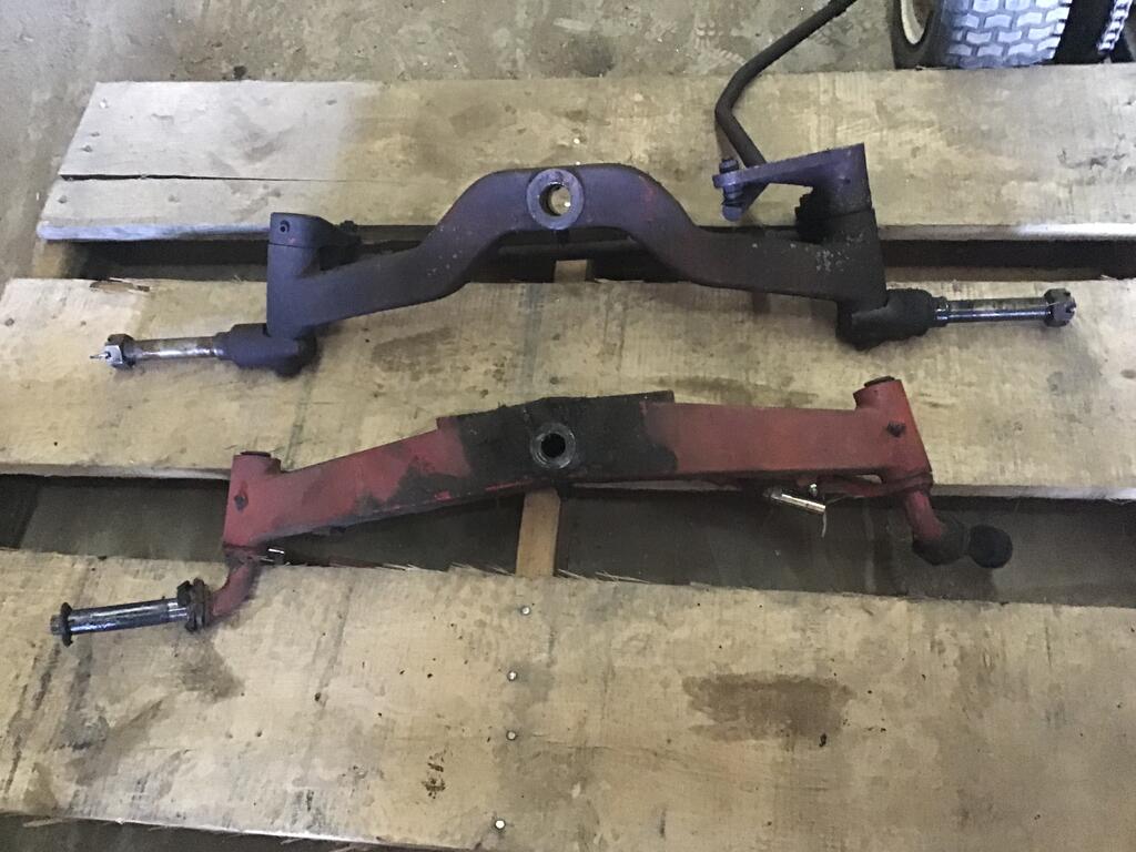

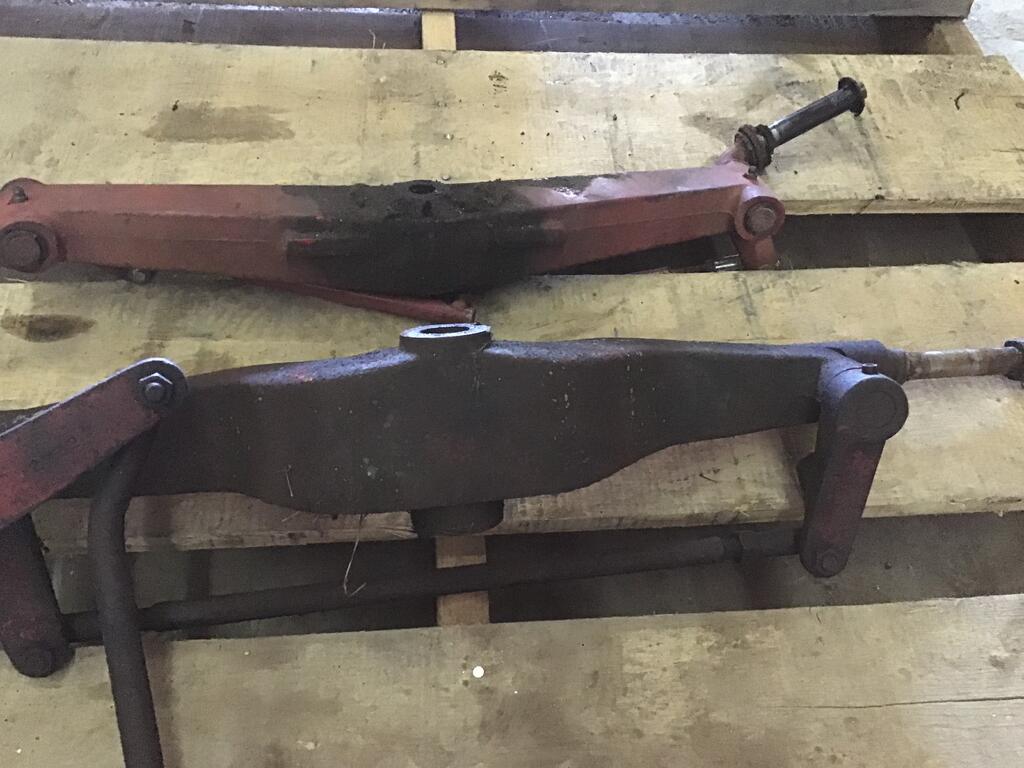

Pullstart 71,207 #160 Posted May 3, 2020 GT14 has much stronger frame and front axle than the 312! It is night and day difference how much tougher the parts are! Here is an axle off a GT14 and an axle off a Commando 800, like the 300 series front ends. 1 1 Share this post Link to post Share on other sites
Oldskool 6,678 #161 Posted May 3, 2020 (edited) @pullstart I see what you mean. Alot more meat to the GT. I think that answers my question quite nicely. Thanks Edited May 3, 2020 by Oldskool 1 Share this post Link to post Share on other sites

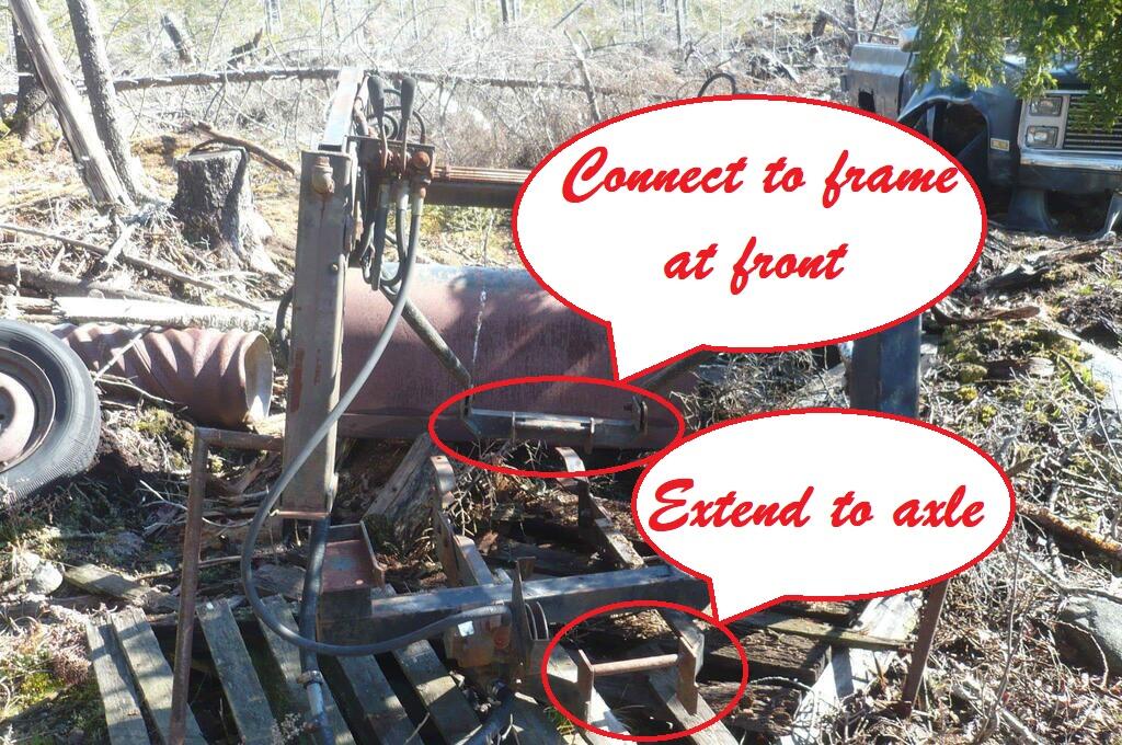

953 nut 69,143 #162 Posted May 3, 2020 13 hours ago, Oldskool said: @ebinmaine any idea if the FEL mounts will fit the Gt14? The sub frame will bolt to the rear axle and a couple of tabs will bolt to the frame where the mower hanger (Attach-A-Matic) bolts on. The sub-frame you have pictured is not from a wheel horse but can be made to work. You will need to lengthen the rear portion to bolt up to the rear axle and modify the front braces to bolt to your frame. 1 1 Share this post Link to post Share on other sites
wallfish 20,576 #163 Posted May 3, 2020 It appears to me like the direction of the sub-frame sitting on the ground in the pic is backwards to the the loader. The small cross bar is the front and the pump would end up on the front right side after it's mounted on the tractor. 2 Share this post Link to post Share on other sites
953 nut 69,143 #164 Posted May 3, 2020 15 minutes ago, wallfish said: It appears to me like the direction of the sub-frame sitting on the ground in the pic is backwards to the the loader. The small cross bar is the front and the pump would end up on the front right side after it's mounted on the tractor. Good eye John, Bolting to the frame would be a lot stronger than having the sub frame clip into the Attach-A-Matic. The idea is to have all of the load and forces of the loader transferred to the axles rather than the frame of the tractor. Share this post Link to post Share on other sites

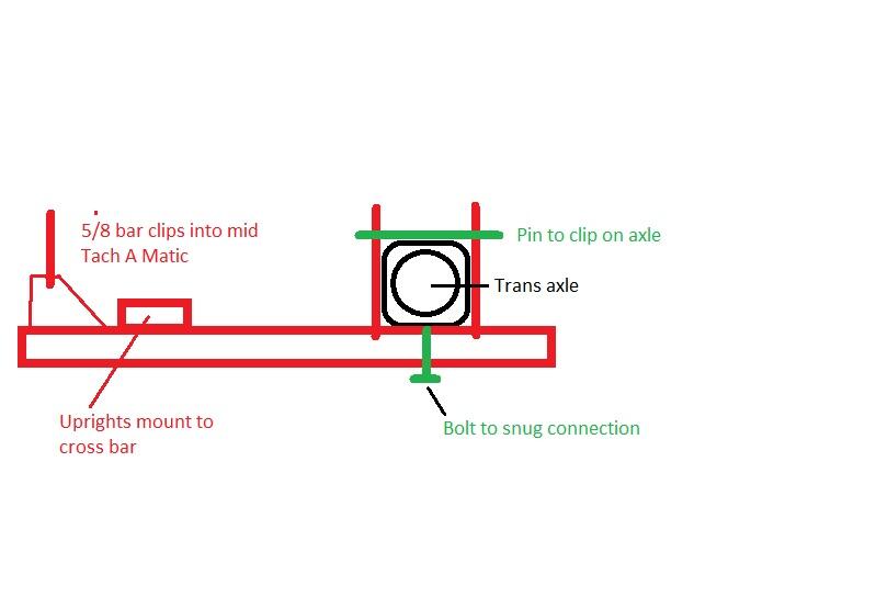

wallfish 20,576 #167 Posted May 3, 2020 Yes The factory Ark loader sub-frame just attaches into the mid Tach A Matic in the front and clips to the rear axle. The mounting points aren't as solid as one might think. It's been used and abused over the years and haven't had any issues with mounting points at all. The mid Tach A Matic is already bolted to frame and the mounted brackets of it beef up that connection to the frame so it doesn't bend it. It's designed for quicker easier removal and installation but typically they stay mounted as a dedicated machine. It appears that sub-frame is basically designed the same way. 1 Share this post Link to post Share on other sites
wallfish 20,576 #168 Posted May 3, 2020 Basic mounting of Ark sub-frame 1 2 Share this post Link to post Share on other sites

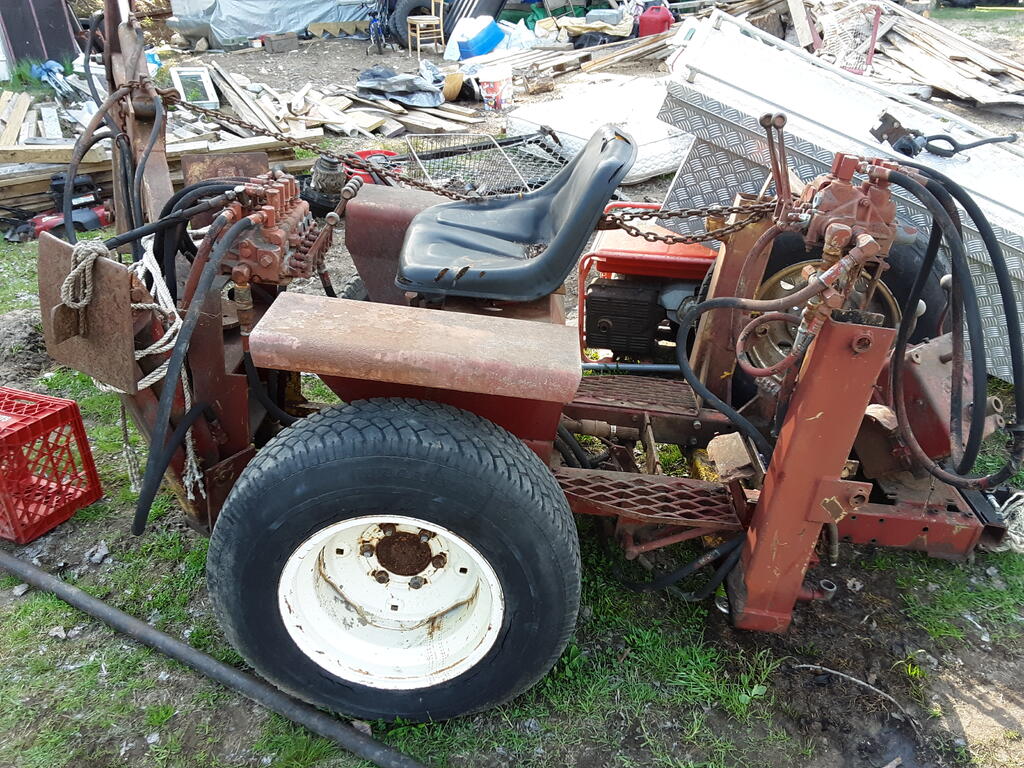

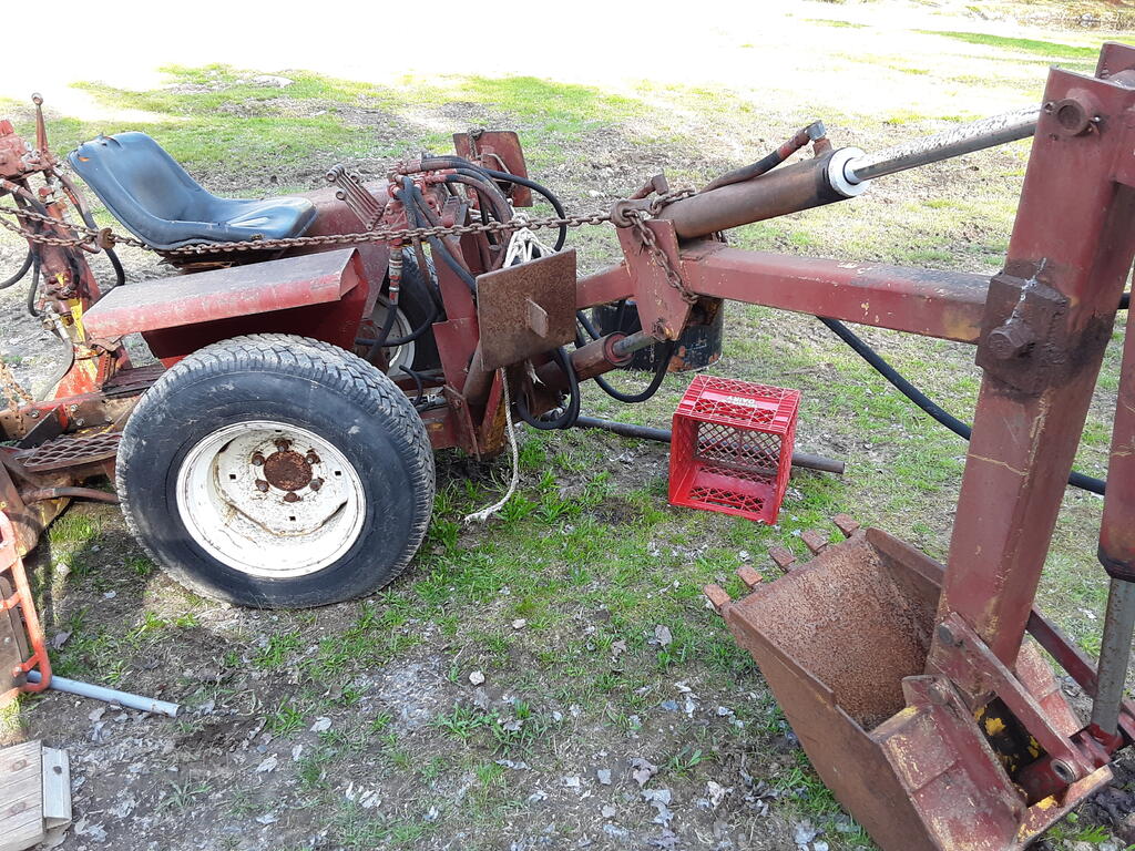

Oldskool 6,678 #169 Posted May 23, 2020 It's been a busy spring. Just starting to get back too the GT14. Although this is gonna follow me home. Would the GT be enough tractor to have this attached to it? Those tires are on 15in rims just so you have a size comparison 1 2 Share this post Link to post Share on other sites
953 nut 69,143 #170 Posted May 23, 2020 39 minutes ago, Oldskool said: Would the GT be enough tractor to have this attached to it? @wallfish and @roadapples both have backhoes and their tractors are not as hefty as the GT-14, should work. 2 Share this post Link to post Share on other sites
Oldskool 6,678 #171 Posted May 23, 2020 Jeez that would be nice. Not really sure what make tractor it used to be bu for 300 I'll take it 1 1 Share this post Link to post Share on other sites
ebinmaine 80,614 #172 Posted May 23, 2020 38 minutes ago, 953 nut said: @wallfish and @roadapples both have backhoes and their tractors are not as hefty as the GT-14, should work. Good find!!! 1 Share this post Link to post Share on other sites

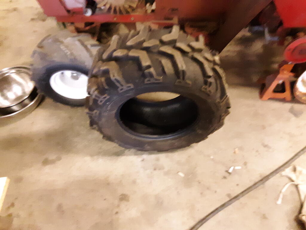

Oldskool 6,678 #173 Posted May 23, 2020 Just scored these half hour ago. Finally scored some hind shoes for this horse, 27x11.00 1 2 Share this post Link to post Share on other sites

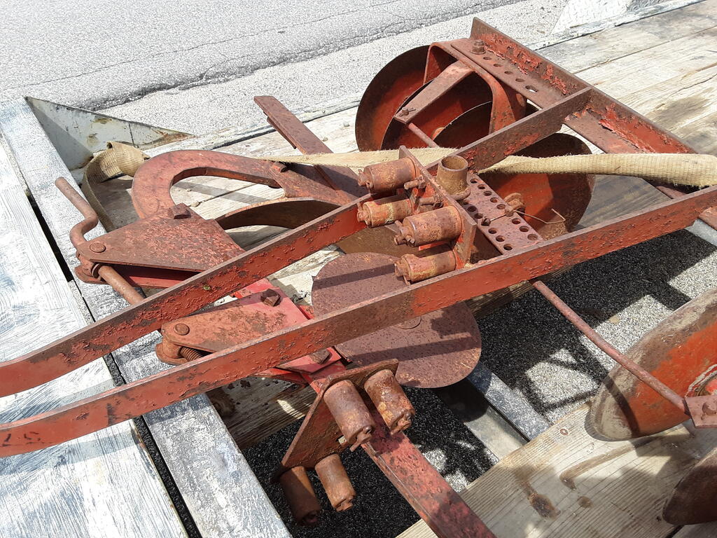

Oldskool 6,678 #175 Posted May 24, 2020 (edited) 15 minutes ago, 12 hp Kohler said: You sure are finding some cool stuff. Loader and backhoe ! Snagged these today too. 50 bucks, disc harrow and plow. I have several people keeping there eyes open for me Edited May 24, 2020 by Oldskool 3 Share this post Link to post Share on other sites
