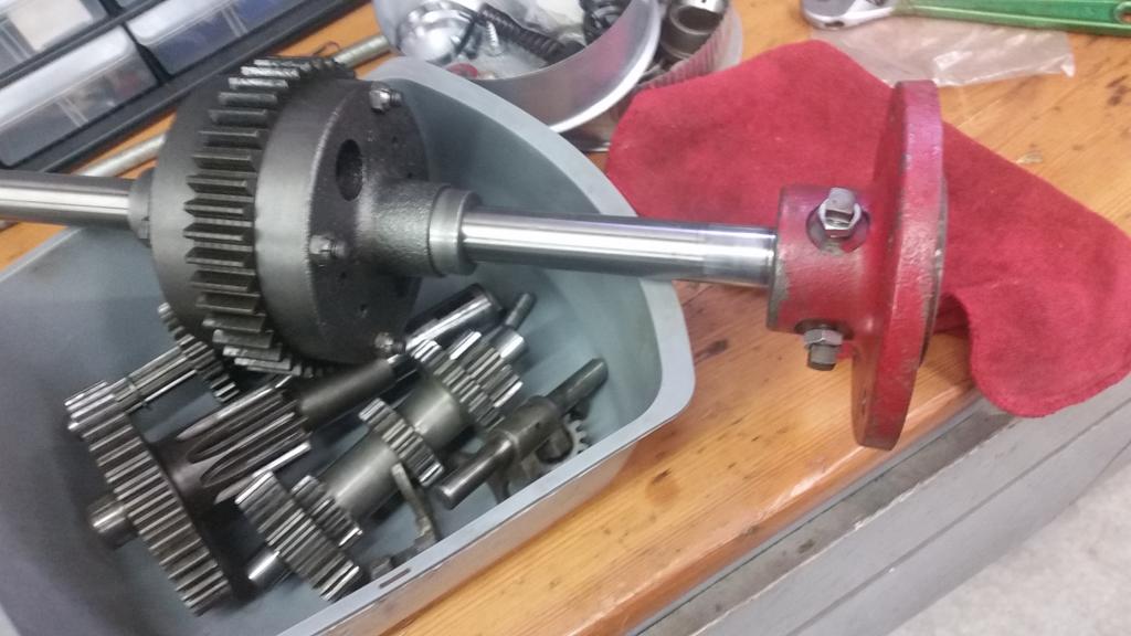

Lagersolut 802 #27 Posted January 2, 2020 @stevasaurus This whole thing has me thinking - doing a swap this summer - the 1 1/8 axle 8 pinion trans in the C-101 to the 416-8 > the 416 trans to the C -101 Share this post Link to post Share on other sites

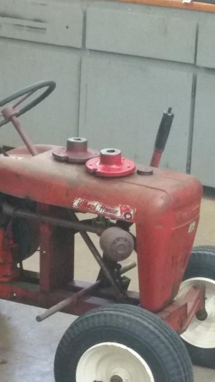

WHX?? 57,334 #28 Posted January 2, 2020 26 minutes ago, stevasaurus said: Not sure what you are showing me above here Jim. I Guess what I was getting at Steve was correct part numbers. In my world everything goes by part numbers. Heck even scratching yerself has a part number and was trying to make sure I had the right searchable ones. Then WH has to confuse me, doesn't take much, by showing two different assemblies in the IPL. They I found that thread about @Racinbob having PN troubles and if he gets confused we're all in trouble! 1 1 Share this post Link to post Share on other sites
stevasaurus 23,739 #29 Posted January 2, 2020 Want the truth?? It should be a simple bolt right up...the linkage, the tin around the shifter, everything. Take a few distance measurements to be sure, but I think you could throw it all up in the air...flick your wand or click your heals and say "There is no place like home." or "Wisconsin makes the best cheese." and it could all fall down exactly like you are talking. Remember, your horse came with those transmissions also. 2 2 Share this post Link to post Share on other sites

WHX?? 57,334 #34 Posted January 2, 2020 Who you kidding Bob you forgot more than what I'll ever know about . I dunno about fixing his axles Steve... he says he had to grind on them... mushroomed and would not go thru the needle bearings. Just hoping the hubs are not wallowed too bad and I can save them. Find out in a couple days they is on their way to me. Talk to Dan @Achto about it he's got access to a mill for new keyways Lager. Worse is you have to send them to him and he says Ney Ney. Never did answer my question Steve will the roll pin type work? Or would you have to machine the snap ring groove in? 2 Share this post Link to post Share on other sites

WHX?? 57,334 #36 Posted January 3, 2020 Not to run off with your thread Lager but has anybody know of anyone who took wallowed 1" hubs and reamed them to 118 and bushed them back down or used as 118? I have such a pair. Yer gonna be poed at me @ebinmaine but I found a 118 I never knew I had ....hey ain't you the one who found a complete 6 speed you didn't know??? I guess we both gotta start barcoding and computerizing crap in our parts sheds! 4 Share this post Link to post Share on other sites

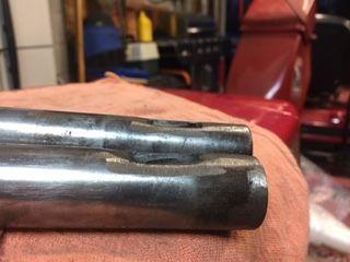

Lagersolut 802 #40 Posted January 3, 2020 I’m open to any and all solutions - these one inch axels are proving hard to find . I have a USPS long box on the bench ready to go ... @stevasaurus I only ground mushrooming at the key way to get them past the bearings and differential ... a little at a time . Share this post Link to post Share on other sites
stevasaurus 23,739 #41 Posted January 3, 2020 If where the outer bearing and seal sits is OK, I would go with it. I have always had to grind a little it seems to clean up burrs and mushrooming and have not had a problem. If you are going to re-do the keyways, I would call it good. Put it together, and keep an eye out at shows and such for 1" axles for spares. I'd bet they rust on the shelves before you used them. It is a different story if the area where the bearing and seal goes is rough and worn. You can then do what they call "spray welding" and then get them turned again. Do a search for spray welding...we had a thread some years ago about it. I think @rmaynard had it done...or knew someone. Share this post Link to post Share on other sites

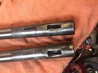

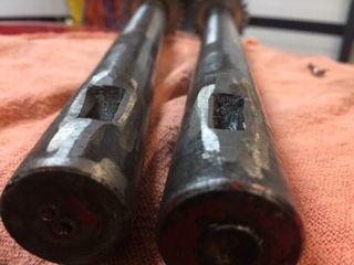

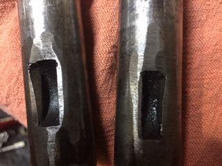

Lagersolut 802 #42 Posted January 3, 2020 Okay, here is a closer look at these axles Share this post Link to post Share on other sites
rmaynard 17,416 #43 Posted January 4, 2020 18 hours ago, stevasaurus said: If where the outer bearing and seal sits is OK, I would go with it. I have always had to grind a little it seems to clean up burrs and mushrooming and have not had a problem. If you are going to re-do the keyways, I would call it good. Put it together, and keep an eye out at shows and such for 1" axles for spares. I'd bet they rust on the shelves before you used them. It is a different story if the area where the bearing and seal goes is rough and worn. You can then do what they call "spray welding" and then get them turned again. Do a search for spray welding...we had a thread some years ago about it. I think @rmaynard had it done...or knew someone. Sorry Steve, it was not me. 1 Share this post Link to post Share on other sites

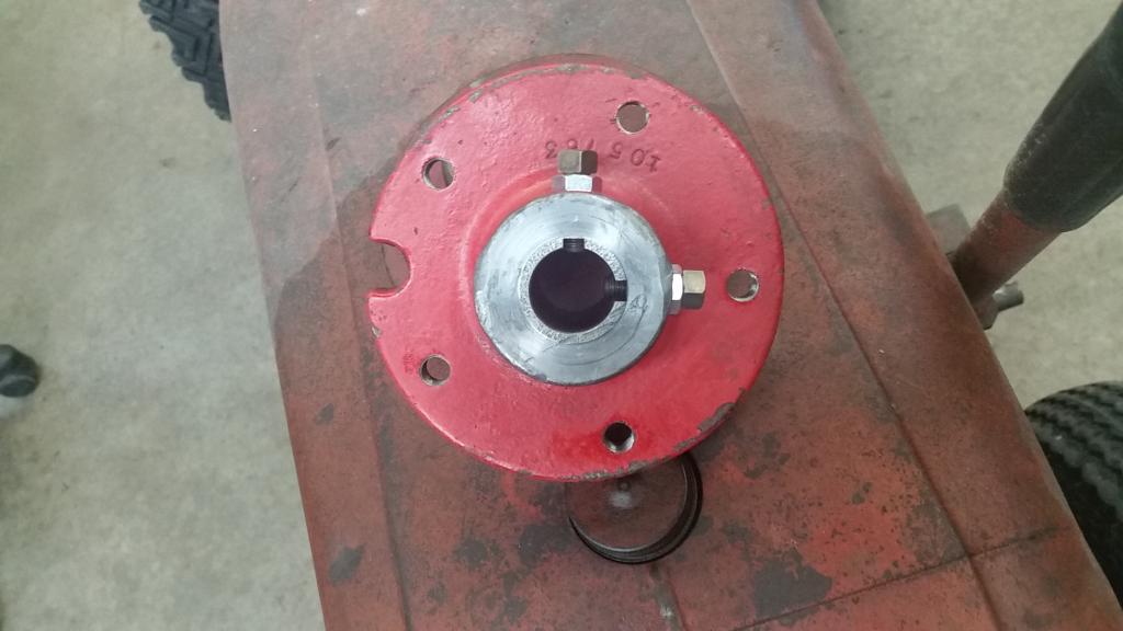

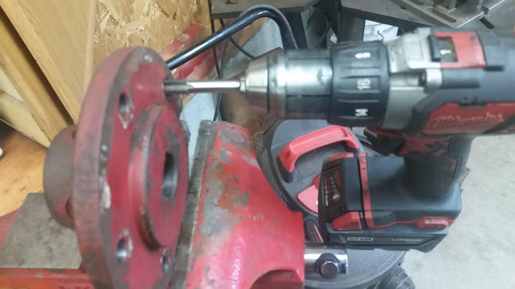

WHX?? 57,334 #44 Posted January 4, 2020 (edited) Lookin at those pics now Lager those may be savable. That one doesn't look real bad and may fly just the way it is. Couple of options I see. Weld them shut and new full length keyways cut in. Any machine shop can do that and's that's the way I would go especially if you going to really work this girl. Do Ed K's keyway fix. Since you are going to have two set screws maybe some filler metal aside of the keys and keep an eye on them??? See how things shake once I get your hubs broached and back to you. I just got a smoking deal on a quantity of some #15 woodruffs I'll throw in the box if you need. Update Bryan....Look what just walked in...will be back out 1st of next week. These are easy ones, they already have a factory 2nd set screw! Edited January 4, 2020 by WHX24 2 Share this post Link to post Share on other sites
WHX?? 57,334 #45 Posted January 4, 2020 (edited) Done deal & ready to ship back... they fit real nice on a clean axle. Hope you don't mind ... while in the shop took the liberty of chasing the lug threads.... Edited January 4, 2020 by WHX24 2 1 Share this post Link to post Share on other sites
Lagersolut 802 #46 Posted January 4, 2020 Not gonna turn down the woodruffs - the ones that came off of this thing are done ... I’m working an angle or two to see if I can get key cut locally ... we don’t have the machine shops around we did years ago .... use to be a nice one 2 miles from the house . Share this post Link to post Share on other sites

stevasaurus 23,739 #48 Posted January 5, 2020 The wood ruff keys are soft. Take the axle with you and buy one that is close. Place in a vise and file for good fit. A 4" grinder makes fast work of the filing. Share this post Link to post Share on other sites
