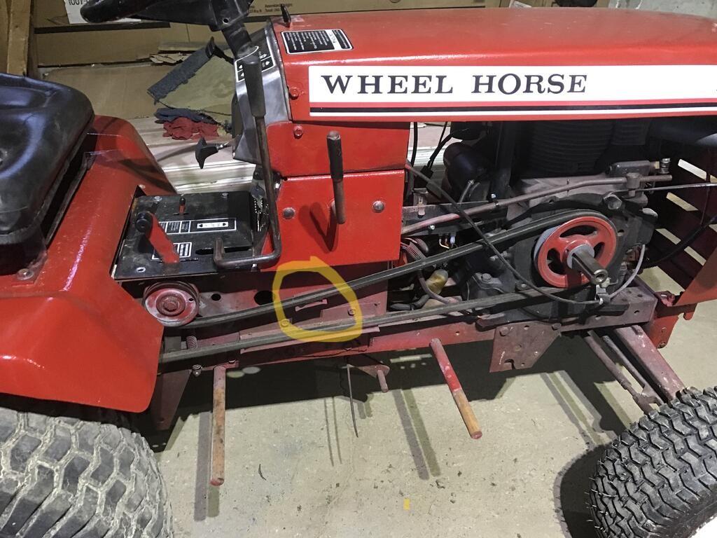

MainelyWheelhorse 3,133 #1 Posted April 10 I’ve been working on the Frankenstein C-141 and getting my tractors ready for spring. Since I installed the engine in it, and it’s also my first and only hydro. I wanted to double check if the belt routing was right. I can put 3 fingers vertically on the upper belt guide between it and the belt before it has noticeable tension. I’m aware it’s disengaged in the photo but I thought the play was excessive. I’ve talked to @ebinmaine but we both agreed checking here about that would be a good idea.TIA 1 Share this post Link to post Share on other sites
pfrederi 21,146 #2 Posted April 10 (edited) How much tension when you engage it is more important but are sure about the belt size??? Edited April 10 by pfrederi 1 1 Share this post Link to post Share on other sites
squonk 48,118 #3 Posted April 10 Not the correct engine pulley either. 1 Share this post Link to post Share on other sites
Bar Nuthin 3,205 #4 Posted April 10 (edited) The routing looks correct, but matching the belt size to that pulley is what you want to look at. You should only be able to deflect it about 1/2" to 3/4" with moderate finger pressure midway between pulleys (with the tensioner engaged). And (obviously) it shouldn't slip when in use. Edited April 10 by Bar Nuthin 1 Share this post Link to post Share on other sites
pfrederi 21,146 #5 Posted April 10 (edited) Is that a gear drive hood stand??? A hydro will not have that tab on the hoodstand that is used by the gear drives to stop the belt. You will never be able engage you belt with that there. THere would not be the long support section below it that is part of the hydro Belt guard i think. Edited April 10 by pfrederi 3 Share this post Link to post Share on other sites
peter lena 10,064 #6 Posted April 10 @MainelyWheelhorse glairing to me ? that flat idler pulley , next to consol , is known for bearing lubrication failure , very easy to change that out , also belt fraying is directly related to , incremental , bearing lubrication failure , causing belts to , bounce . donn,t have a hydro , but if it were me , would be , thinking about calming down those long unsupported areas . added that to all my mower decks , no belt bounce , also lubrication upgrade , problem eliminated . you also have a pto lever , gold mine , for functional improvement , staring right at me , mine was finished with a heim joint lever end swing point , starts at battery tray , lever sloppy start , pete 1 Share this post Link to post Share on other sites
JoeM 10,267 #7 Posted April 10 1 hour ago, pfrederi said: A hydro will not have that tab on the hoodstand that is used by the gear drives to stop the belt. Those bolt on it can come off, My last 520H tower had it on 1 1 Share this post Link to post Share on other sites

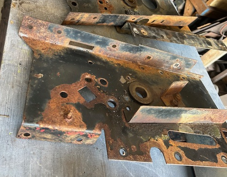

953 nut 69,262 #8 Posted April 10 I pulled this photo from @cleat's restoration of a GT-1600 to show how it should look. 3 3 Share this post Link to post Share on other sites
MainelyWheelhorse 3,133 #9 Posted April 10 @squonk It should be correct. It is an Amazon pulley that is the supposedly correct 5.25 diameter for the hydro transmission. I have a 8 speed engine pulley if needed. The 5.25 diameter was info I got from the forum. The belt seems to fit in the groove fine and hasn’t been popping off like the pulley is too shallow yet. @pfrederi The hood stand is what was on it when I got it. I assume it’s original as it looks like it’s been on there a very long time. Since I brought it back from a dead parts tractor I wasn’t sure what was still there and gone. That’s why I figured I’d check here. @Bar Nuthin Ok, I’ll engage it and see what changes. I might need a belt as it was on it when I got it and seemed in good condition. That’s why I figured I’d check things out before mowing season. It doesn’t seem to slip just bounces and makes noise. @peter lena I greased the idler pulley that’s what spurred me to check the belt routing, the PTO isn’t hooked up to the engine I still need to drill the holes in the engine pulley for the bolts for it. The goal was to get it running and moving for @JCM’s event last September then go back and fix the small stuff later. @953 nut thanks for the pic. I was closer than I thought. Luckily it’s only two guides that have to come off. Thanks for the help! 1 Share this post Link to post Share on other sites
Bill D 3,156 #10 Posted April 10 5 hours ago, 953 nut said: I pulled this photo from @cleat's restoration of a GT-1600 to show how it should look. If you have a drive belt release you need a lower belt guide. My GT1800 has one. 1 Share this post Link to post Share on other sites

ebinmaine 80,692 #12 Posted April 10 23 minutes ago, Bill D said: If you have a drive belt release you need a lower belt guide. My GT1800 has one. 49 minutes ago, MainelyWheelhorse said: two guides that have to come off. As Bill states. Those stay on. @cleat 's is a different transmission. 1 Share this post Link to post Share on other sites
MainelyWheelhorse 3,133 #13 Posted April 10 31 minutes ago, ebinmaine said: As Bill states. Those stay on. @cleat 's is a different transmission. Ok, I thought it looked a bit different. At least I know the belt routing is right. 1 Share this post Link to post Share on other sites
pfrederi 21,146 #14 Posted April 10 Is yours a sunstrand or an eaton Information like that can help get better responses you indicated it was a frankenstien which means we cannot be sure that the hydro is original or not and makes a difference in the engagement mechanism. . 2 Share this post Link to post Share on other sites
953 nut 69,262 #15 Posted April 10 4 minutes ago, pfrederi said: sunstrand or an eaton Paul, little FYI, I changed my GT-14 from Sundstrand to Eaton 1100 and didn't have to change a thing in the belt tensioning area. Share this post Link to post Share on other sites
MainelyWheelhorse 3,133 #16 Posted April 10 36 minutes ago, pfrederi said: Is yours a sunstrand or an eaton Information like that can help get better responses you indicated it was a frankenstien which means we cannot be sure that the hydro is original or not and makes a difference in the engagement mechanism. . @pfrederi I believe it’s a late 70’s era Sundstrand. it looks like it’s original to the tractor. I got it from @ebinmaine where it was a parts tractor. It seemed to be mostly complete in all the important areas. 1 Share this post Link to post Share on other sites
