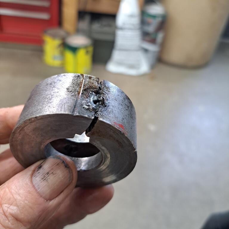

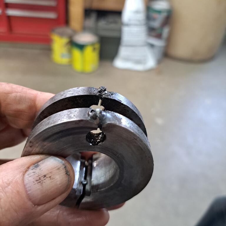

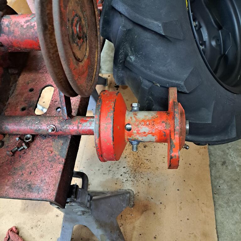

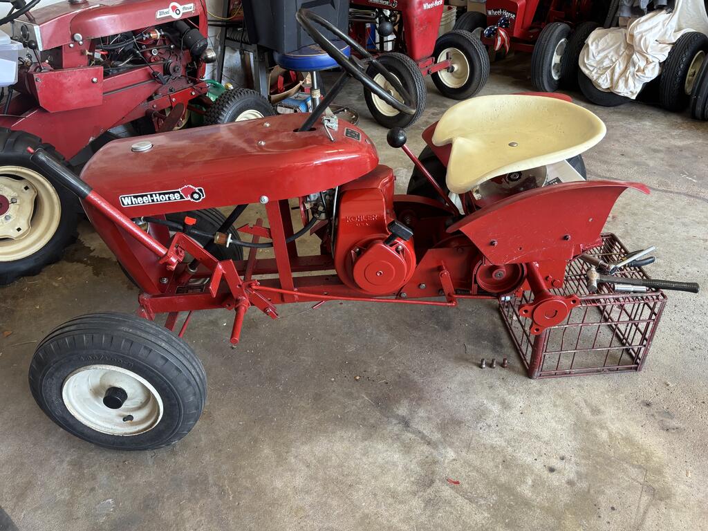

WHX?? 58,125 #26 Posted March 19 (edited) On to the rear ... yep gonna need help on this. The pawls are missing on both sides and one pawl hub is boogered up royally. It's not a hard thing to reproduce on a lathe but I have no idea what the pawls or springs or pins even look like. I'll be down in the basement researching old threads anybody needs me ... Edited March 19 by WHX?? 4 Share this post Link to post Share on other sites

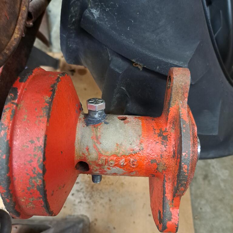

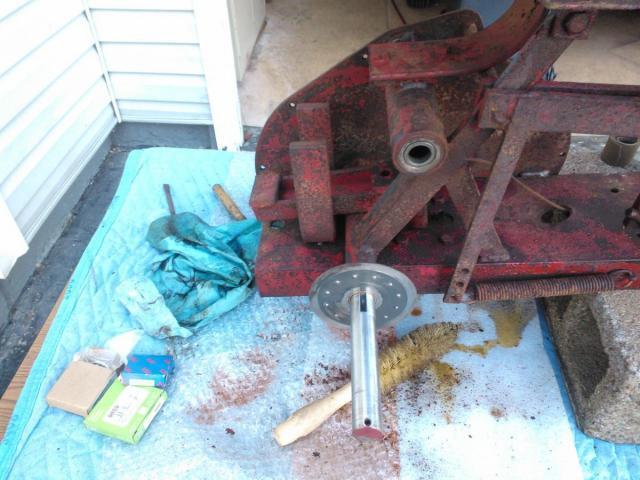

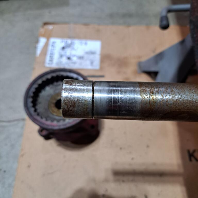

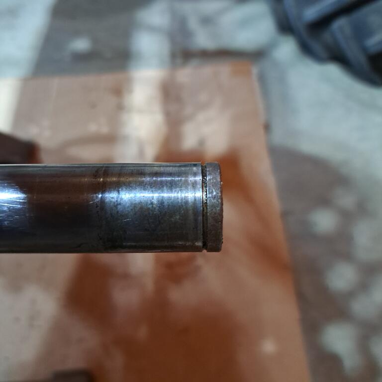

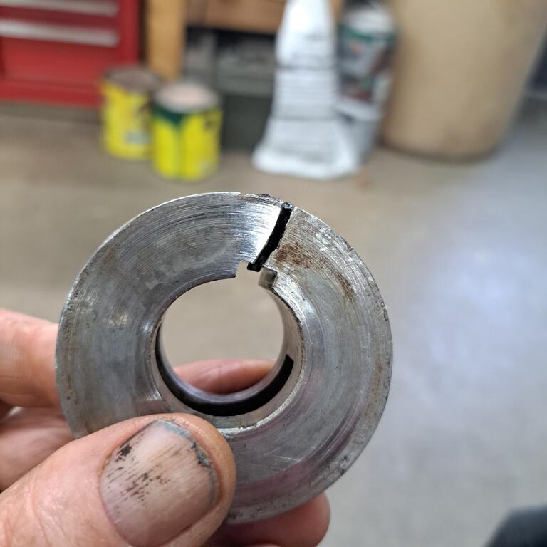

WHX?? 58,125 #27 Posted March 19 (edited) Yup I'm screwed ... somebody must have replaced the axle at one time. Digging in the basement I found pics of the axle where there are keyways cut in the axle to secure the pawl hub to the axle using a #15 woodruff. I do not have those keyways and was wondering why there are keyways cut in the pawl hub. There is a hole in the right side where I believe the hub was PO through bolted. The other side just free wheeled. I also noticed the snap ring grooves that hold the hub on are spaced at different lengths & no idea if that is correct. Not sure how to proceed here gonna have to burn a shout out. @rj35hunter Lots of questions here Clay. Edited March 19 by WHX?? 2 2 Share this post Link to post Share on other sites

WHX?? 58,125 #30 Posted March 19 (edited) While rummaging around in the basement found this. Everything about this one points to a very early or early 55 so may have to reclassify? Early 1955 RJ-35 things Later 1955 RJ-35 Very Early 1955 RJ-35 Gas tank On tank stand Strapped to hood On tank stand Front axle pivot stop Solid steel across axle 2 square blocks at each end No Axle pivot stop Lift lever Solid 3/4 “ round Push button release Solid 3/4 “ round Motion lever No stop Stop welded on end No stop Engine stop Brass push knob Toggle switch Missing Belt tension spring 3 hole in rear to attach 3 hole in rear to attach 1 hole in rear to attach Steering wheel column hole in hood Oval Oval Round and tight Lift cable hole to hitch Oval Oval Round Primary pivot bar assembly Is wider than other early RJ’s Drive pawl in hubs Machined Machined One of them is sawed not machined (The other might have been replace with new wheel hub casting in 1971) Variable speed pulley 3 roll pins /3 holes for slide 1 key way for slide 1 roll pin / hole for slide From what I see in the Pic's The Steering wheel column hole in the hood is round and just big enough space for the wheel column to go through C. Pond must have changed it to a oval to make it easier to remove the hood. I do not see any Front axle pivot stop - axle stops were added later for safety. ​As for the Steering wheel - the aluminum wheel Broke easily and replaced with a cast iron steering wheel Edited March 19 by WHX?? 5 Share this post Link to post Share on other sites

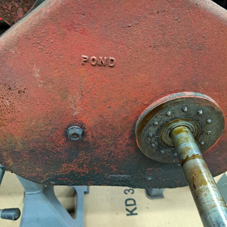

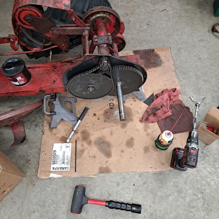

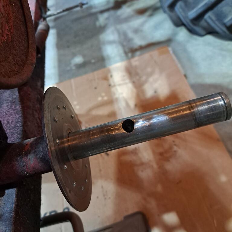

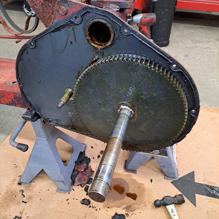

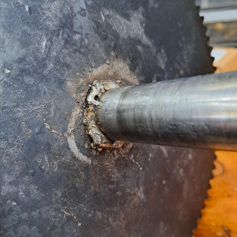

WHX?? 58,125 #31 Posted March 20 (edited) Chain case apart today & unmounted tires. Rears are shot but rims really need cleaning up and I have some ags that were on the flame that should work good. . Wasn't gonna take the case apart cause the oil came out pretty clean. Glad I did jack shaft & bearings was plugged solid with old crappy grease. Will take longer to clean everything up. There is no case gasket listed but someone tried to seal it up ... PO or Ponds??? Not sure what do do about the hubs and sure is a mystery why no keyways. The sprocket doesn't look like it was taken off and put on a different axle. The axle and the sprocket are listed as one part in the IPL. Kinda crappy lookin welds if still factory. @jeremi3210 suggest cutting some keys in with a dremel but that might be beyond my skill level. Need to talk with @Shynon yet he's been in a few of these. Edited March 20 by WHX?? 6 1 Share this post Link to post Share on other sites

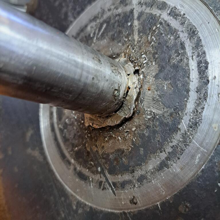

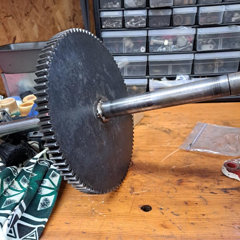

WHX?? 58,125 #32 Posted March 21 (edited) After further review the gear was welded on a replacement axle. PO neglected to put in keyways. Brings up another question. What could the PO possibly down to damage the original axle? Gotta remember this is just a 3.5 HP tractor that would have been have to be abused in a odd way to damage the original. After talking with Tom current plan, which may change, is to turn off the inside weld which wasn't much anyway and use machine bushings to space it from the inside of the casing. Last pic show where the weld & gear was mashing on the inside of the case. Maybe replace the axle bushings which are the same 1503 ones as on a three piece RJ/Burb tranny. Slap it back together and pin the right hub to the axle and let the left side free wheel. The way the PO did. Just not worth the time and effort to put back as orginal ... at this time anyway. This girl is just going to be a show piece and probably the only time driven is on and off the trailer. Edited March 21 by WHX?? 5 2 Share this post Link to post Share on other sites

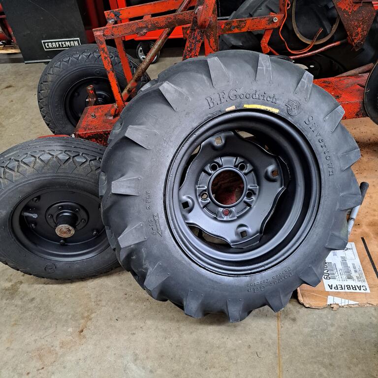

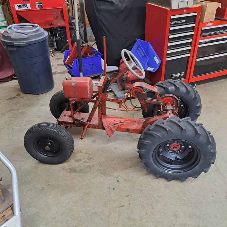

WHX?? 58,125 #33 Posted March 26 (edited) Not much to do on it while waiting on the axle work. Not gonna sit around an suck old fashions all day... ahem @wallfish Found some nice vintage Silvertowns in the tire pile. Getting mounted, rims cleaned up & painted. Edited March 26 by WHX?? 3 3 2 1 Share this post Link to post Share on other sites

wallfish 20,618 #35 Posted March 26 26 minutes ago, WHX?? said: Found some nice vintage Silvertowns in the tire pile Your "tire pile" skins look better than my tractor tires. 3 2 Share this post Link to post Share on other sites
WHX?? 58,125 #36 Posted March 27 Just guessing with all the holes in the hub from bolting through that the axle broke. They were the orginals off the 702 flame. Lot of scrubbing with this. 4 Share this post Link to post Share on other sites

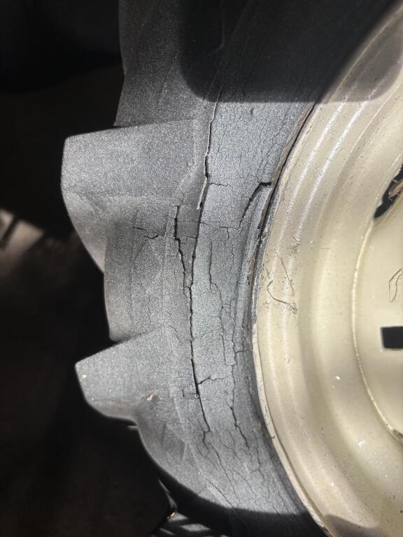

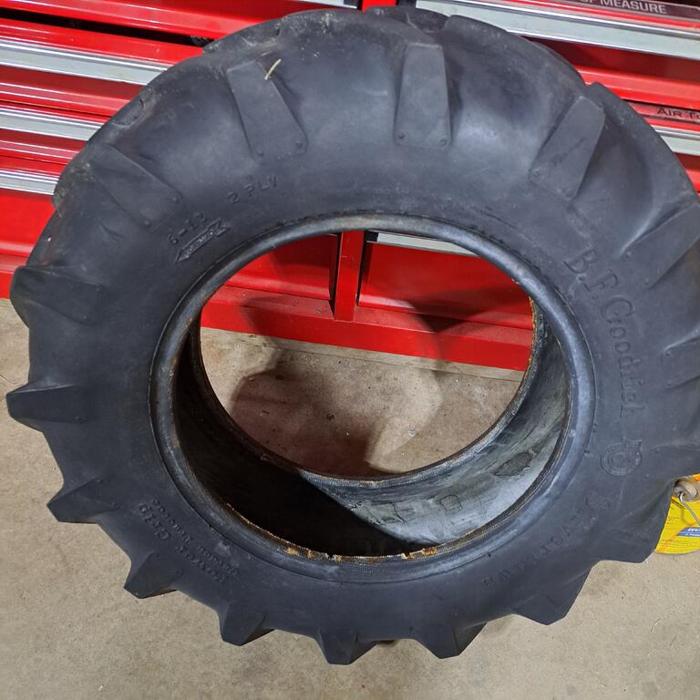

Lane Ranger 12,105 #38 Posted March 27 (edited) 9 hours ago, WHX?? said: Just guessing with all the holes in the hub from bolting through that the axle broke. They were the orginals off the 702 flame. Lot of scrubbing with this. Get some Miller Tire Paint Jim and paint those tires twice with it. You will be real surprised how much better they look. I had to but two new tire for an RJ rear set I had of old Goodyears. One of the tires has thin skin in one spot that was cracked. Nothing really left worth saving. Miller Tire paint could not take care of that problem! Edited March 27 by Lane Ranger 1 1 Share this post Link to post Share on other sites

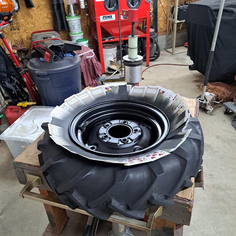

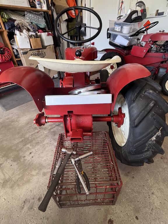

WHX?? 58,125 #42 Posted April 19 Crappy day out so got to work on her abit. The three piece RJ axle bushings from @wheelhorseman are always a little tight so got them honed down and the gearcase back together. Made the high level decision not to replace the axle and re-make the the pawl carriers. Bushed the wallowed out hole in the existing axle and calling it a day. This whole resto is going against my character of doing it right ... but I don't think what I am doing will take away from the value of the tractor. I'm not doing anything that is not reversible or made impossible to be done right. If this was a full blown paint might be a different story. To me that would be sacrilege tho. The plan is for this girl to get sold after this year's show circuit so let the next guy do it if he wants. Strictly a trailer queen anyway and will never get run around. I still get the joy of working on a tractor that the Ponds had their hands on. Rear wheels did come out nice with rear tear offs from the flame and the flat black . @Lane Ranger the originals were way beyond tire paint. Tubes bulging out thru side walls. 2 5 Share this post Link to post Share on other sites
kpinnc 18,963 #44 Posted April 22 1 hour ago, WHX?? said: Roller I always like when they get to this point! 3 Share this post Link to post Share on other sites
