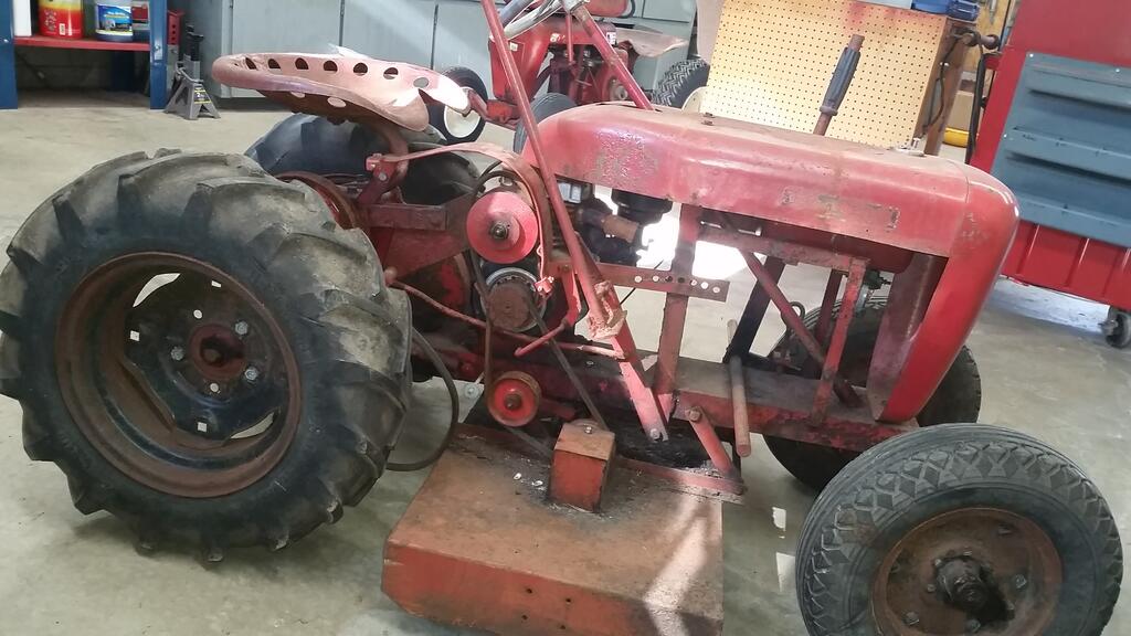

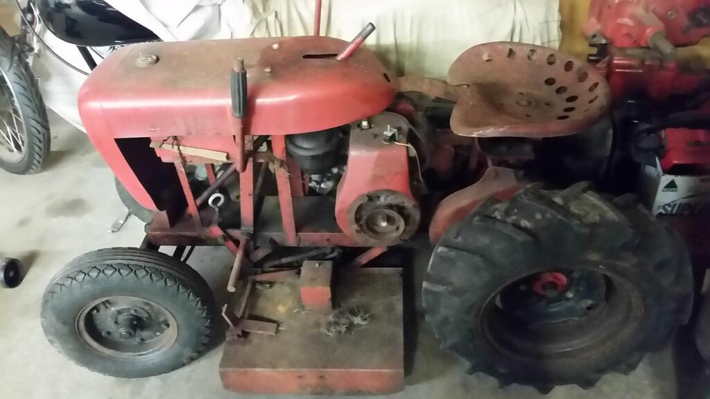

WHX?? 58,125 #1 Posted January 2, 2025 (edited) A project long time coming. First you must endure a little history. My main man @Rp.wh scored this bounty quite a few years ago now and I (may) have since taken custody. He's pretty much worthless but has this uncanny knack for finding desirable tractors so we keep him around. Since Ryan came from her fruit of the looms Cindaaddyy assumed illegal ownership and pyrated it as her tractor. Yah guess who gets to rehab it tho. Although I had several lucrative offers for it including @Shynon flashing obscene amounts of cash. Since it was so called "marital property" I would just sell my half. I did not cherish the thought of bringing it back to life given the amount of labor & pieces of eight it would take just for a show piece. That did not go over well so after threats with the frying pan AND rolling pin would she not let me sell it so buried back in the corner of the warehouse it went... until now ... after threats of a lashing with the cat-o-nine tails and walking the plank it came in the shop. I been into pirate things lately can you tell?? I have no idea why ... too many episodes of Black Sails me thinks ... but can't wait for @rmaynard 's talk like a Pirate day... Nearest we can figure is it started out life as cable steer. For those not knowing early RJs were built with a cable and spool steering of sorts similar to a short chute snow blower and vintage steam engines that used a chain type steering system. The Ponds quickly realized that there was a better mousetrap and offered a drag link type of steering as a dealer fix for the troublesome cable. This one was converted. There are threads here where guys contemplated, or accomplished, converting back to a cable steer for factory for as factory purposes. This one sat evidently out side for many years and the front end was brown welded solid as well as the cast AL steering wheel wobbled out. I managed to free it up and bush the steering for ease in moving stalls over the years. The before pics. She was highly POed but mostly there. The hood & gas tank was lifted on wood blocks and the hood cut. That will not get repaired as this is a mechanical resto. Adds character is my only offer. Ok 'nuff sitting around in my knickers typeing ... time to get to the shop get the TV out there fired up... Lordy it's great to be retired ... Edited January 2, 2025 by WHX?? 5 9 Share this post Link to post Share on other sites

rjg854 13,359 #6 Posted January 2, 2025 You say it sat outside, that sheet metal looks mighty nice 👍 if that's the case. Where has the hood been cut? The only thing that jumped out at me was around the steering shaft Share this post Link to post Share on other sites
WHX?? 58,125 #7 Posted January 6, 2025 (edited) On 1/2/2025 at 4:50 PM, rjg854 said: around the steering shaft Luckily that's all Randy .. also a nice sized dent right in the front. On 1/2/2025 at 3:55 PM, bassJAM said: So thank you for the memories! Your more than Jam ... I haven't had time to work on it lately between honey do, those stupid 702s and teaching that recliner a lesson... Edited January 6, 2025 by WHX?? 1 4 Share this post Link to post Share on other sites

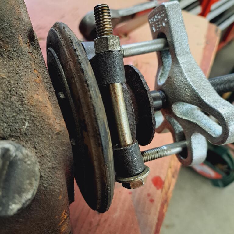

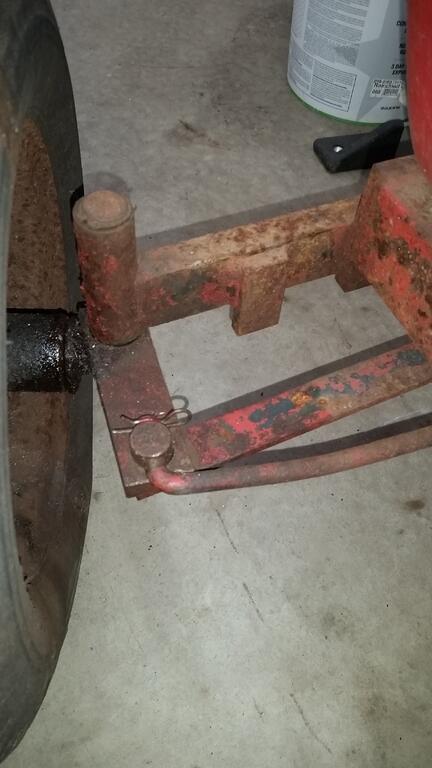

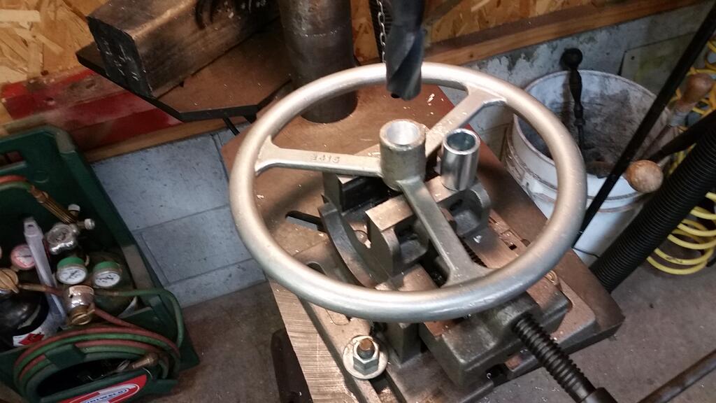

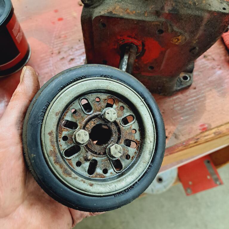

WHX?? 58,125 #10 Posted February 11, 2025 (edited) Finally felt well enough to work on it today. PTO was coming off come hell or high water. @Shynon says the reverse drive friction wheel was made out of brass and we wondered if early ones weren't made of rubber this one was. Finished taking the motor apart. and on the hunt for parts. Guy's gotta wonder if these were old school snowmobile bogie wheels & used by the Ponds. Sure do look like them. Edited February 11, 2025 by WHX?? 3 3 Share this post Link to post Share on other sites
953 nut 69,303 #11 Posted February 11, 2025 13 hours ago, WHX?? said: Shynon says the reverse drive friction wheel was made out of brass and we wondered if early ones weren't made of rubber this one was. I know the Baird Beaver predated the Wheel Horse and used a rubber friction wheel for reversing. Could be someone replaced the Wheel Horse one. 4 Share this post Link to post Share on other sites
Pullstart 71,238 #12 Posted February 12, 2025 You need any good reference pictures (other than cable steer stuff) I’ll climb the ladder, walk the plank, whatever you need cap’m! 1 2 3 Share this post Link to post Share on other sites
WHX?? 58,125 #13 Posted February 12, 2025 On 2/11/2025 at 8:24 AM, 953 nut said: Could be someone replaced the Wheel Horse one Very possible ... Tom says the brass ones made a heck of grinding noise when you slap it in reverse. 1 2 Share this post Link to post Share on other sites

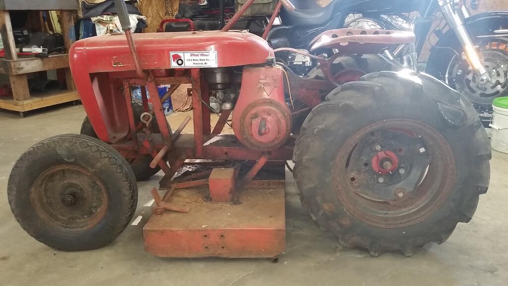

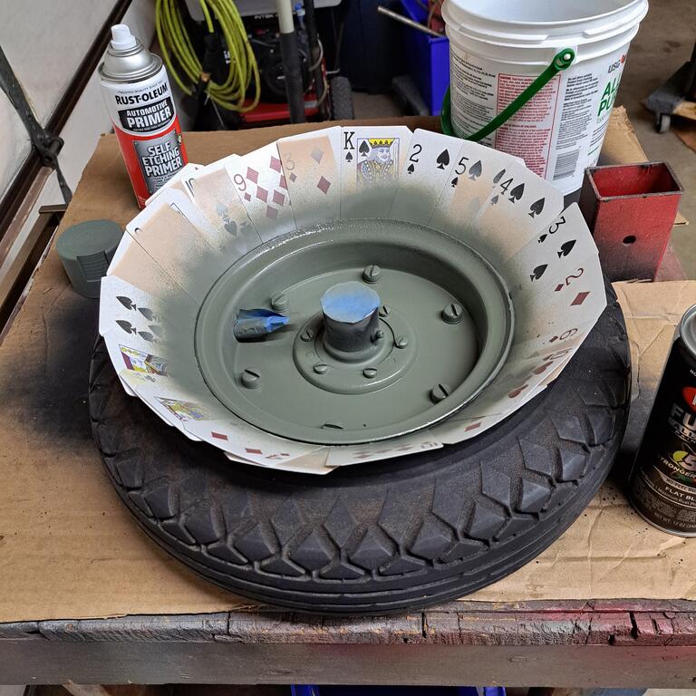

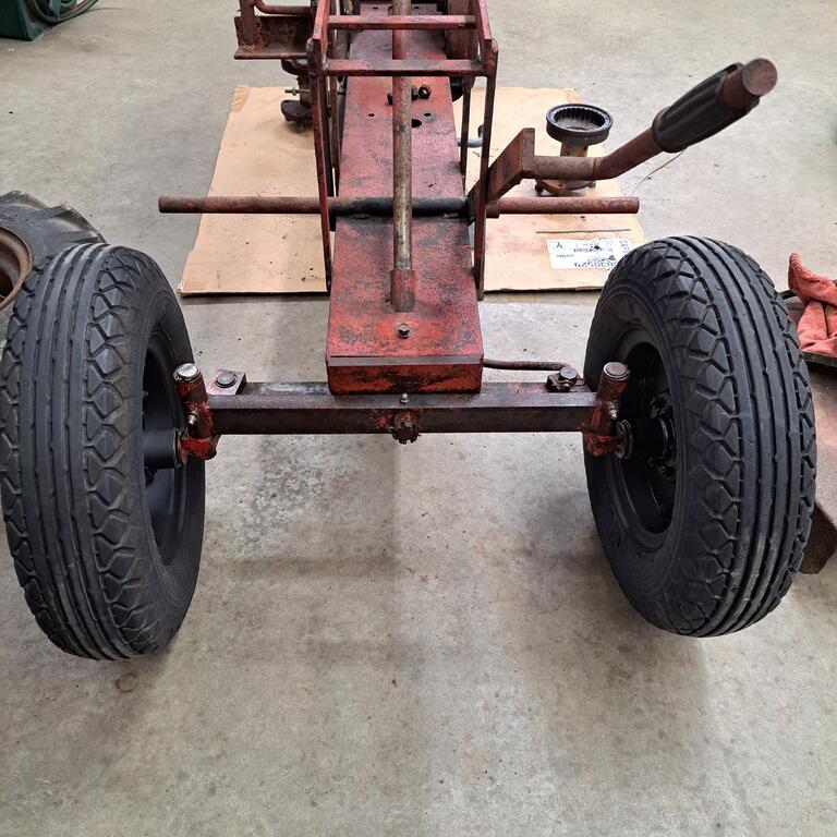

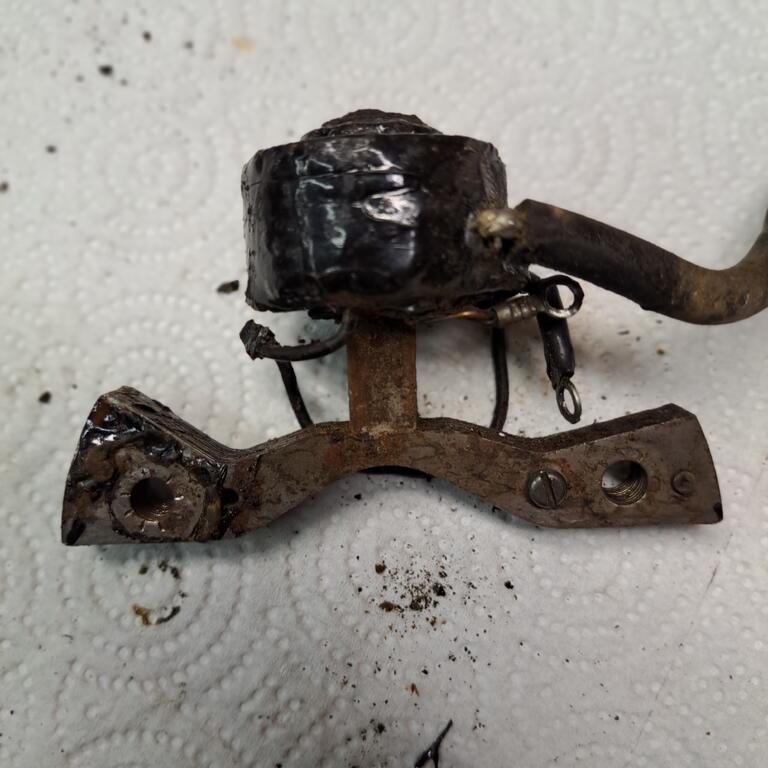

WHX?? 58,125 #14 Posted March 8 Slowly but surely getting at this. Motor is being real fun since parts are hard to find. Magneto coil was toast so it seemed a Briggs one would work with some slight mods. Fit the laminations pretty well but not much room to route the spark plug lead. Front end apart for deep cleaning and paint rims. Sure is different working on three piece rims. 8 Share this post Link to post Share on other sites

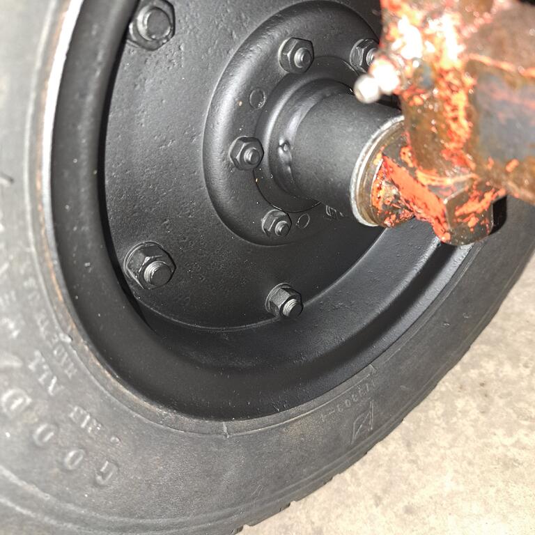

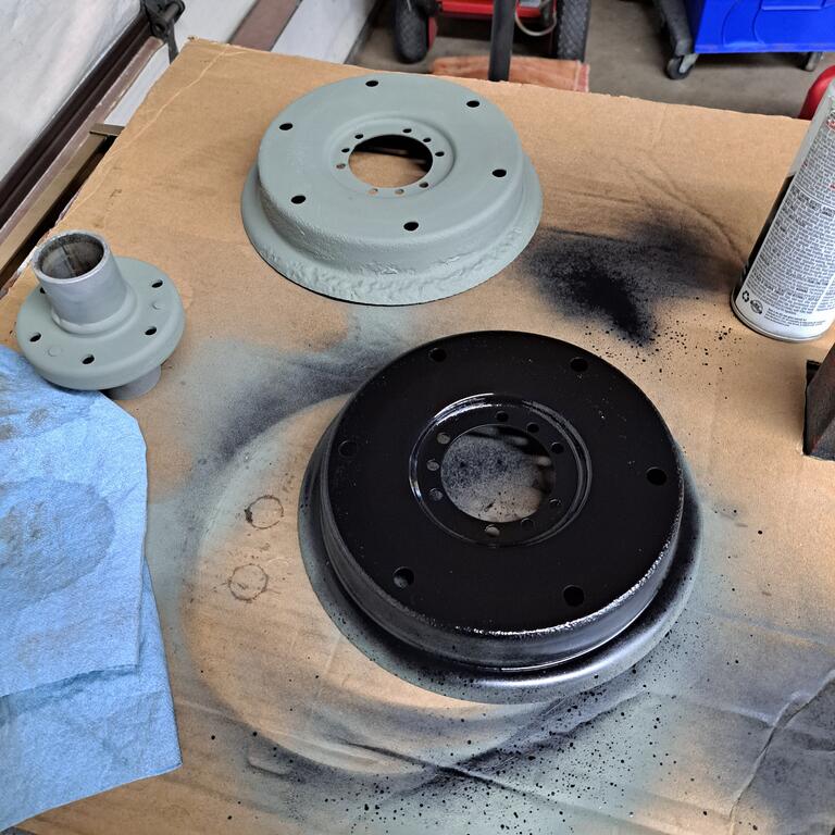

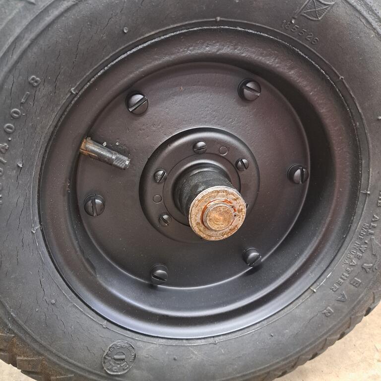

WHX?? 58,125 #25 Posted March 19 Front end & wheels done. Wheels came out nice but were a real pain getting them apart as the bolts holding the halves together were rusted tight. the heads are slotted and even with a well fitting very large screw driver tried not to mangle them to use them over. Make matters worse they are fine thread fillisters. Finally got them all out. Lots of time in the blast cab. Most guys would have went with a gloss black but I went with flat. Goes better with the final patina. Also was able to use the original tubes as they were very heavy rubber not like what's out there today. Tried a finnish of MMO on the frame but just didn't like it so went back to linseed oil. 3 3 2 Share this post Link to post Share on other sites
