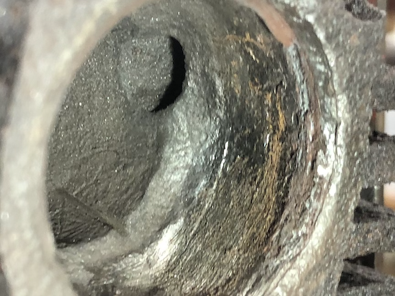

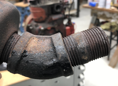

Handy Don 17,380 #40 Posted March 19, 2022 (edited) I'm kinda working along on the 854 in between other projects. Slowish going but there really isn't a deadline. Anyway, it rained Thursday so I transferred the engine to a work table and went to start in on the broken (so I thought) exhaust pipe that had been knocked off while moving in in the basement. I assumed that there was a stub of the nipple in there so I started to lightly wire wheel and then grind a bit with a Dremel looking for the tops of the block threads to emerge so I could poke out the rest. After a few minutes, I sensed something was wrong. No threads only clean metal under a lot of rust. Went back to the "broken" muffler, hit the end of the nipple with a wire brush for a couple minutes and found this: Yeah, not broken, as far as I can tell. Back to the exhaust port, which now looks like this: So now I'm thinking that the port threads had rusted away because the nipple wasn't all the way in (and my light grinding didn't help). Probably the muffler was only threaded in at most one or two threads. And that when it got knocked out, it broke off a thread from the block at the edge of the port. I can see the "seat" at the back of the port where the nipple should reach (or come close at least) and what looks like a chip at the rim of the port (second picture, top left of the port) So I tried threading the nipple in and it does start for about ¼ turn and then hangs up. Haven't tried wrenching it in any further. At this point I'm gun-shy. I'm discouraged by this. I know I didn't do much "extra" damage, but I'm not sure at all how to fix this. I'd appreciate thoughts from folks who've maybe seen this before and what course they took to salvage the engine like: @WHX??, @richmondred01 , @Oldskool, @wallfish, @squonk, @Shynon, @pfrederi, @kpinnc, @JPWH, @Achto (and anyone I forgot to mention Edited March 19, 2022 by Handy Don 2 1 Share this post Link to post Share on other sites
wallfish 20,553 #41 Posted March 19, 2022 Hmmm, never seen that before. Usually there's something left of the threads If it doesn't just slide right into that hole then that tells me there's probably enough metal to tap new threads. I would just go with a cheap 1 inch NPT tap off Amazon. Not like you're going to use that every day Other option would be to make a flange, drill and tap holes into the head to attach that way 2 2 Share this post Link to post Share on other sites
Achto 32,470 #42 Posted March 19, 2022 I'm with John on this. Try running a 1" pipe tap in there or drill & tap the 2 ear spaces for a mounting flange to mount the exhaust, 1 Share this post Link to post Share on other sites
squonk 47,990 #43 Posted March 19, 2022 You would think there would be some trace of threads in there. Are you sure there isn't a bunch of carbon filling the threads in? 1 1 Share this post Link to post Share on other sites
oliver2-44 11,710 #44 Posted March 19, 2022 13 minutes ago, squonk said: You would think there would be some trace of threads in there. Are you sure there isn't a bunch of carbon filling the threads in? Well @WHX?? but I’m with @squonk on this one. I had one that looked smooth and there were worn but enough threads there to tap a little deeper and make it work. 2 Share this post Link to post Share on other sites
kpinnc 18,916 #45 Posted March 19, 2022 (edited) I agree with the others here: Get or make a flange and drill and tap the area around the exhaust to support it. Many old Kohlers used a flange anyway, and there should be enough material already cast for one. You shouldn't have to go very deep to get enough threads to hold it. Edited March 19, 2022 by kpinnc 3 Share this post Link to post Share on other sites
JPWH 6,544 #46 Posted March 19, 2022 I would try tapping with a 1" pipe tap first and if it does not work then you could proceed with mounting a flange. 4 Share this post Link to post Share on other sites
richmondred01 2,389 #47 Posted March 19, 2022 27 minutes ago, JPWH said: I would try tapping with a 1" pipe tap first and if it does not work then you could proceed with mounting a flange. i agree. If you mess it up give me a call, I’ve got several wheel horse spec k181 blocks. 3 Share this post Link to post Share on other sites
sjoemie himself 3,178 #48 Posted March 19, 2022 what they said. Try a tap first and if that doesn't work go the flange route 1 Share this post Link to post Share on other sites
Oldskool 6,678 #49 Posted March 19, 2022 I agree with the guys. Try retapping it. Maybe take it to a plumber to get it retapped if you don't have the tools? I can send you this if it will help you out. 3 1 Share this post Link to post Share on other sites
