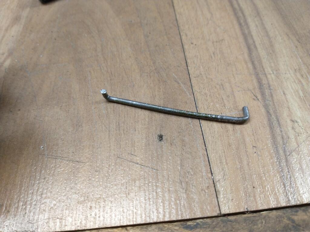

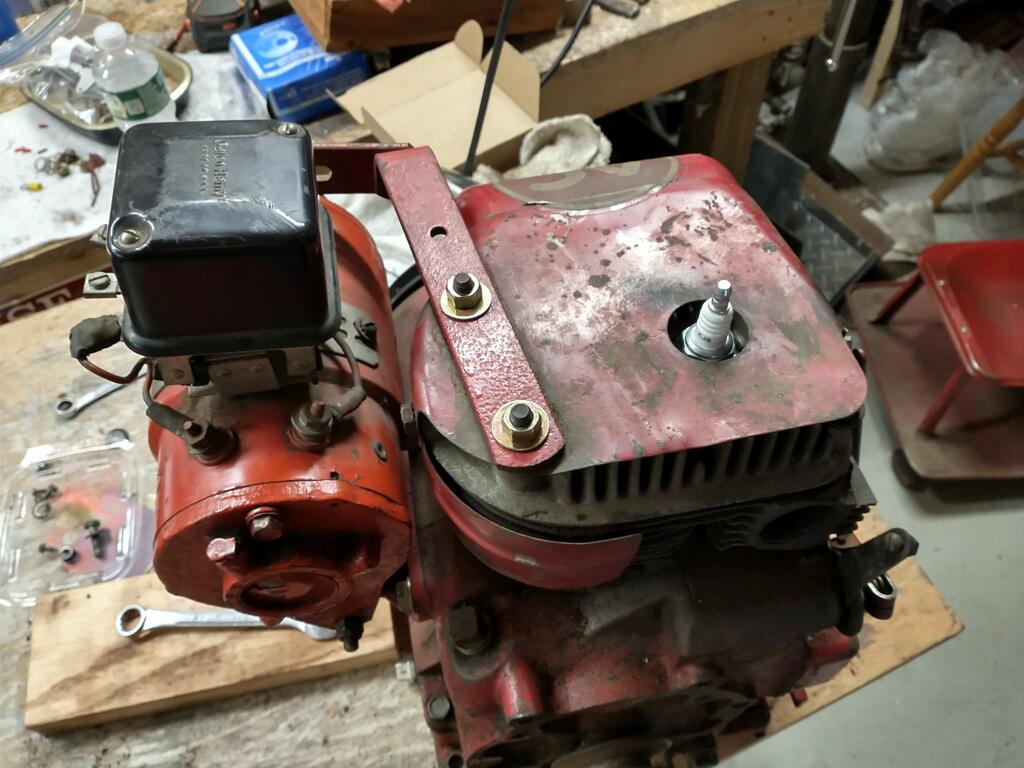

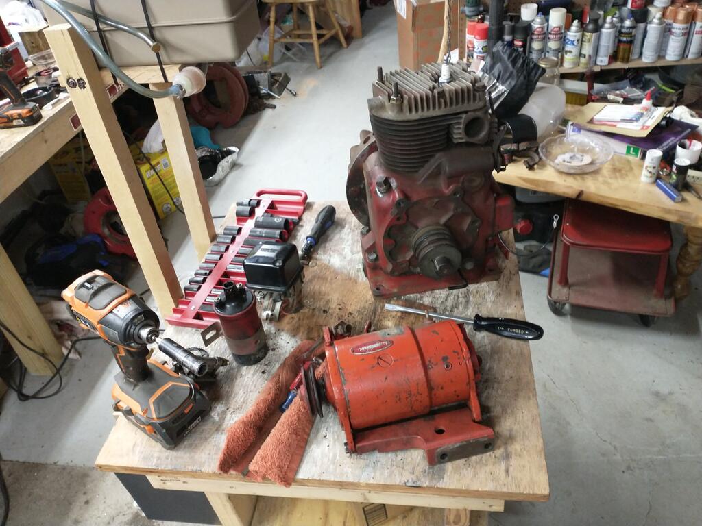

ebinmaine 77,539 #226 Posted February 28, 2023 The BBT engine mechanic has the starter generator on. She made up a linkage rod for the carb to governor. Installed the carb. Need to find a belt for the SG.. 3 Share this post Link to post Share on other sites

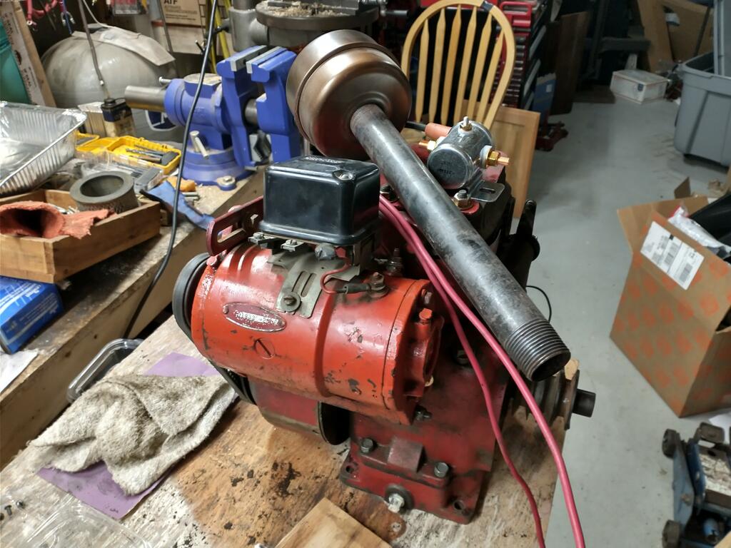

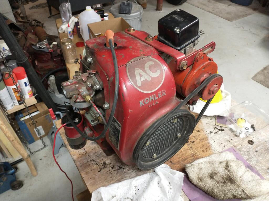

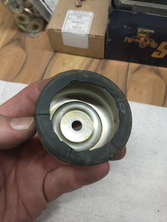

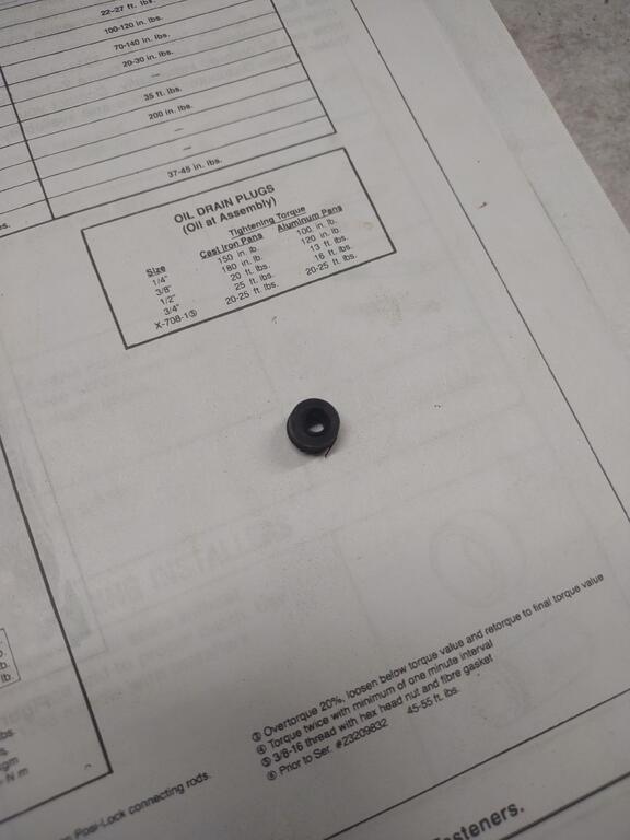

ebinmaine 77,539 #227 Posted March 1, 2023 5 hours ago, ebinmaine said: Need to find a belt for the SG I'll be durned if'n we didn't have one hangin' on the wall.... Hey how do I find these rubber grommets for inside the fuel pipe from pump to carb? We bench tested the starter generator. It's good. I built a couple wires and Trina installed them. Confirmed the points setting at .020. Found a plug wire on the wall that desperately needed the @peter lena dielectric treatment. Freed up the stuck boot, de-bent the terminal and put that on. Use what ya have! We found a 5 terminal 103990 ignition switch, muffler, solenoid. Next time we get a minute we'll finish the wiring and try to put fire in the hole!! 4 Share this post Link to post Share on other sites
Moparfanforever 925 #228 Posted March 1, 2023 I think Lowell has the fuel line grommets. 1 Share this post Link to post Share on other sites
Moparfanforever 925 #229 Posted March 1, 2023 https://wheelhorsepartsandmore.com/product/kohler-fuel-line-rubber-grommets-qty-2/ 1 Share this post Link to post Share on other sites
ebinmaine 77,539 #230 Posted March 1, 2023 4 minutes ago, Moparfanforever said: https://wheelhorsepartsandmore.com/product/kohler-fuel-line-rubber-grommets-qty-2/ @Handy Don Share this post Link to post Share on other sites

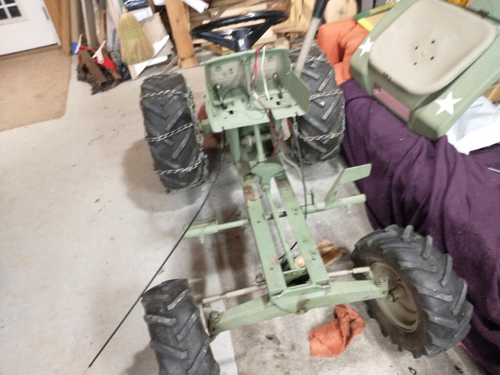

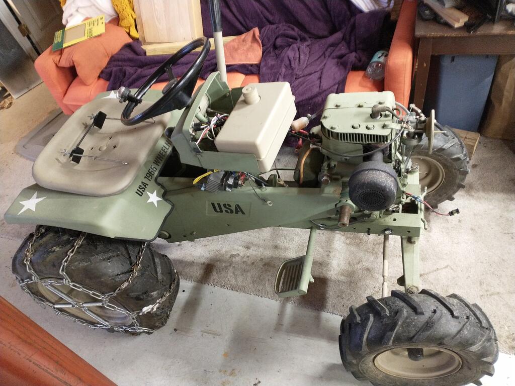

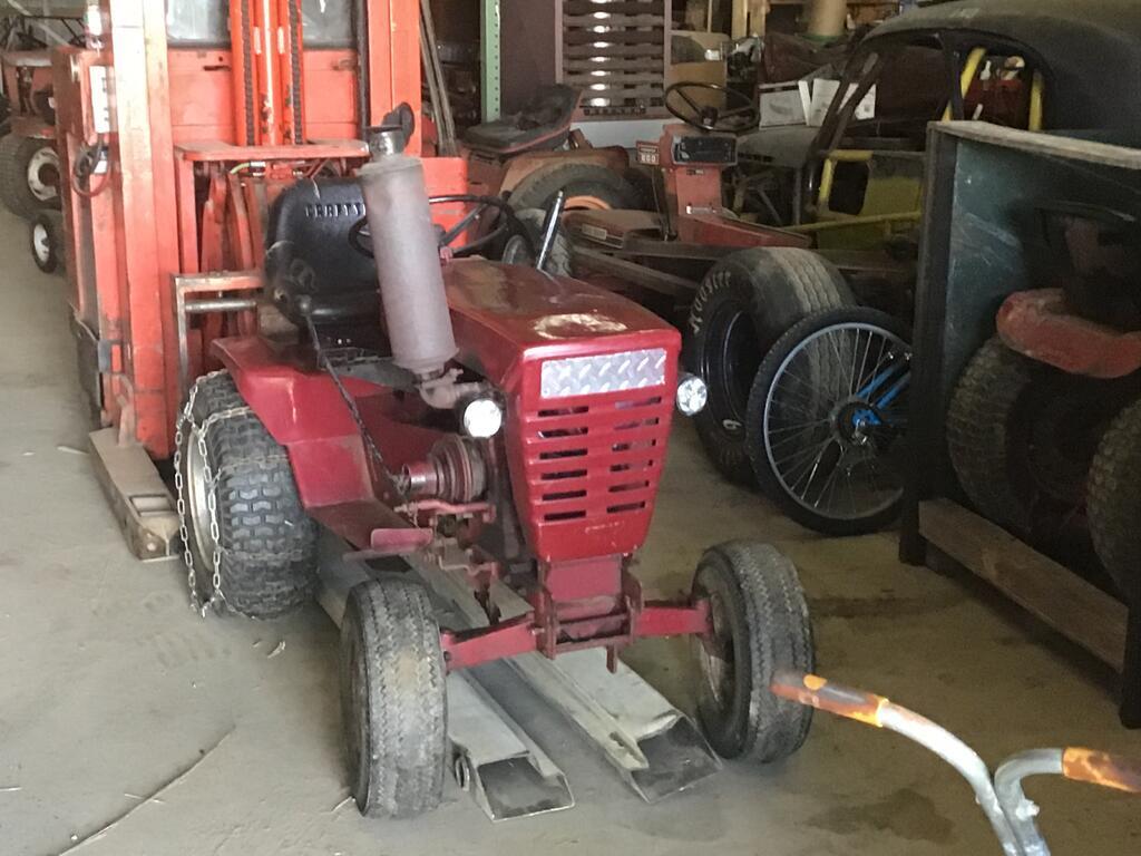

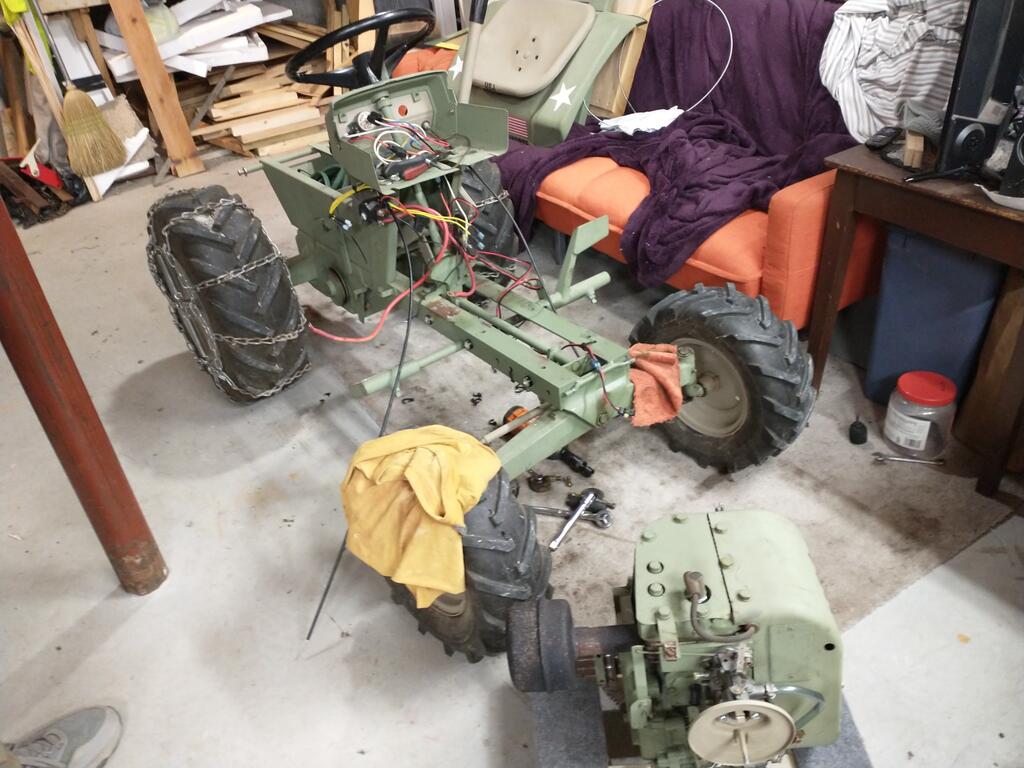

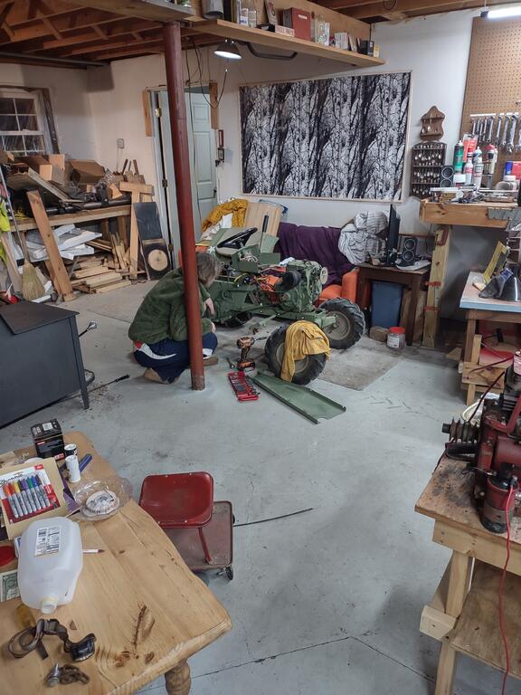

ebinmaine 77,539 #232 Posted March 8, 2023 Well folks we dragged the Millie into the basement workshop last night... The 10 HP Tecumseh engine was always meant to be temporary so now we're going to swap in the correct 8 HP Kohler engine. Also, Trina wants to put a 6-speed with Limited Slip Differential in this Beast so it's much more work capable. Here's the list as it stands: Steering shaft replacement. Fluid fill ALL tires. Engine swap to Kohler 8 HP. Ignition SWITCH and wiring changeover to accommodate the difference in ignitions. Transmission swap from 3 speed to 6 speed. Fix sticking seat latch. Add or repair hood holder at hinge and forward max. 3 4 Share this post Link to post Share on other sites

Achto 31,132 #236 Posted March 8, 2023 On 2/28/2023 at 7:32 PM, ebinmaine said: Hey how do I find these rubber grommets for inside the fuel pipe from pump to carb? You might have this covered already but this is what I use. This is a pack of 25. https://www.walmart.com/ip/James-Gasket-Oil-Line-Seal-JGI-63529-57/159564941 If you have a Harley dealer around, they may be able to set you up as well. These gaskets were used for the rocker box oil lines on Shovel Head & Pan Head engines. ( make sure they give you black ones, gas eats the orange ones ) 1 Share this post Link to post Share on other sites
ebinmaine 77,539 #237 Posted March 8, 2023 2 hours ago, Achto said: this is what I use. Thanks for that Dan. I ordered up a bag. @Handy Don I'll send you a few when these come in. 1 1 Share this post Link to post Share on other sites

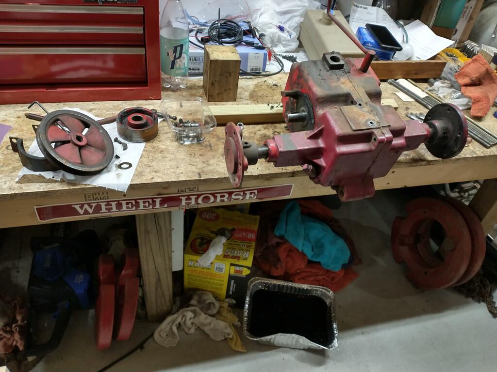

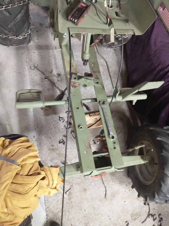

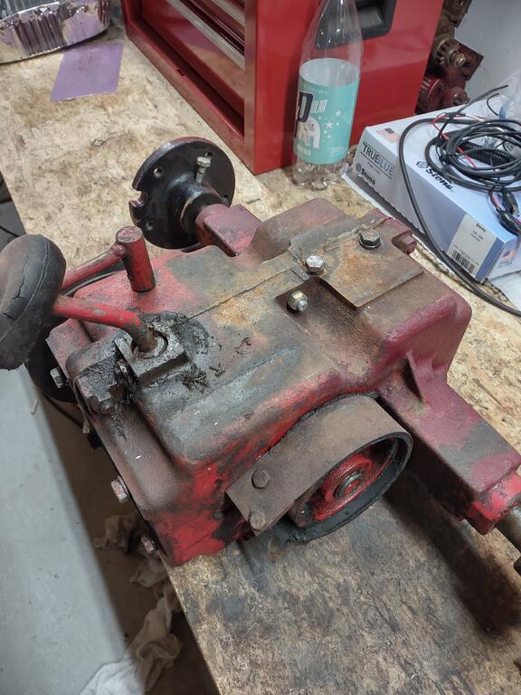

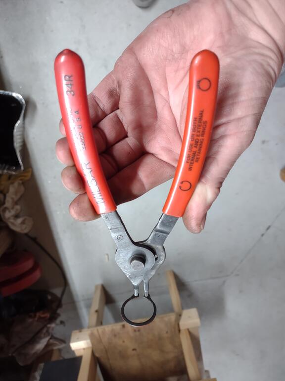

ebinmaine 77,539 #238 Posted March 10, 2023 The BBT and I spent a couple hours on disassembly. I got the new ish 6 speed transmission out from under the bench and draining. Pulled a few bolts. The input pulley and brake drum are off. Shifter is out. I'd asked about a GOOD set of usable lock ring pliers a few weeks ago. Put one of the pairs I got to use this evening. That was a very good way to spend $15. While I was at that Trina attacked the tractor. Sheet metal. Off. Belt. Off. Some of the wiring. Disconnected. Engine. Off! She'll be taking this one down a bit more so the paint can be freshened up. 2 3 Share this post Link to post Share on other sites

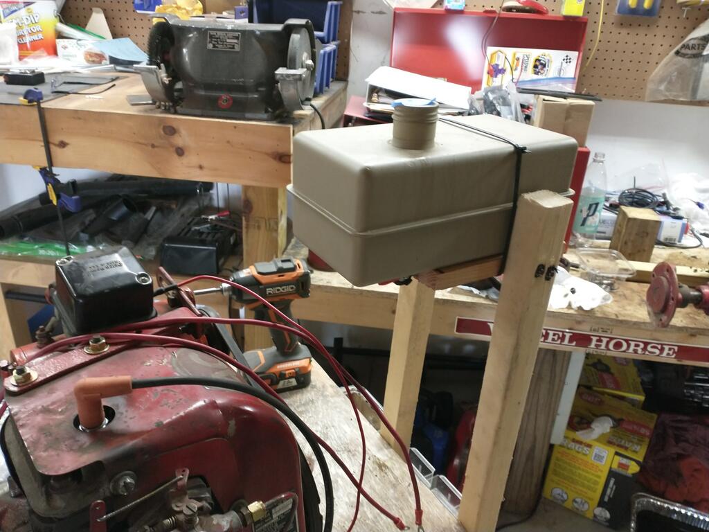

ebinmaine 77,539 #241 Posted March 12, 2023 Trina made up a gas tank holder for her self made work table. Instant engine test station. 3 3 Share this post Link to post Share on other sites

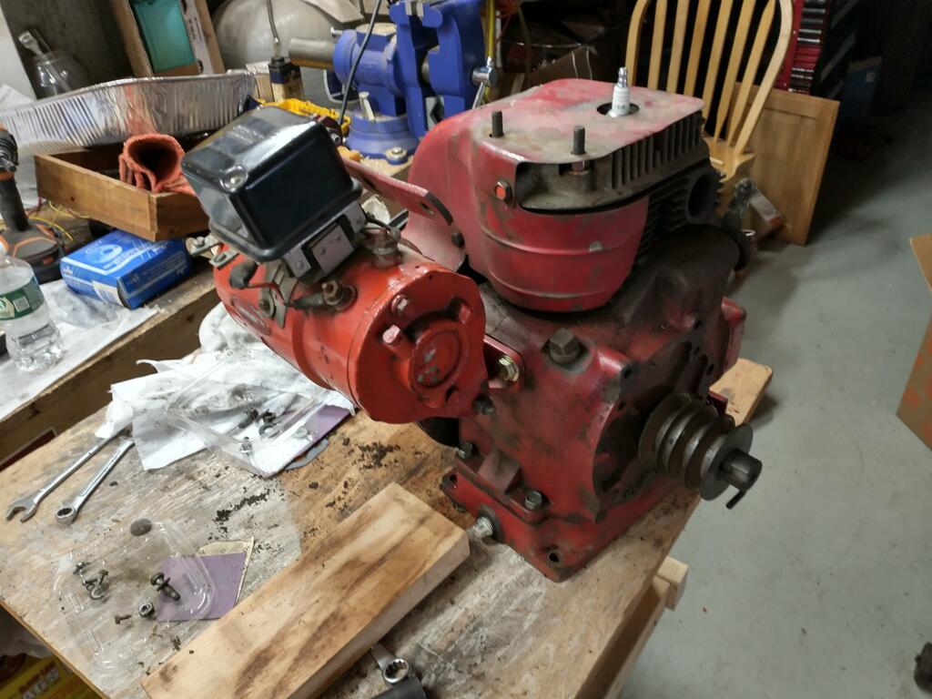

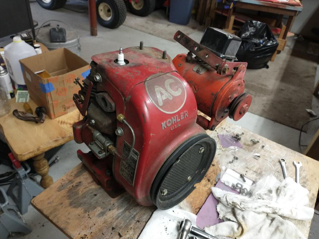

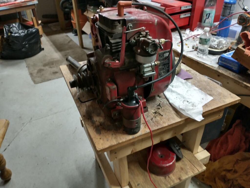

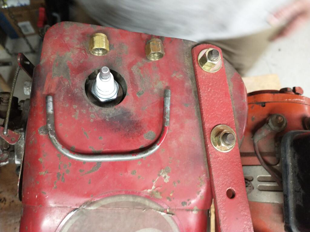

ebinmaine 77,539 #242 Posted March 12, 2023 The Old Kohler 8 HP engine runs great!! @Herder 1 6 1 Share this post Link to post Share on other sites

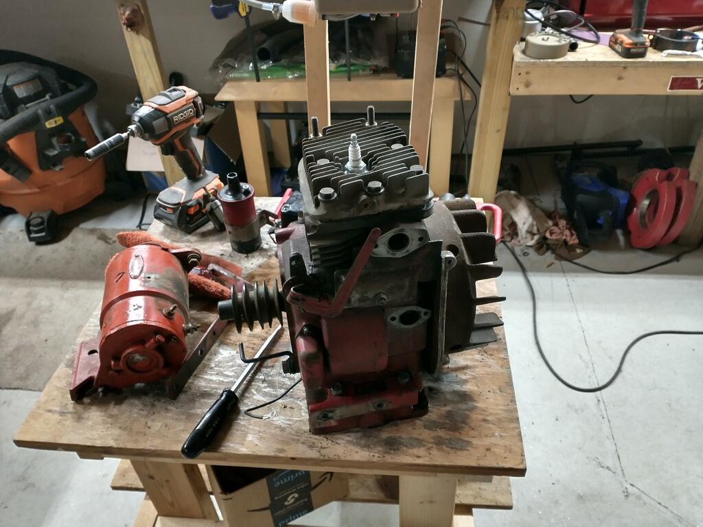

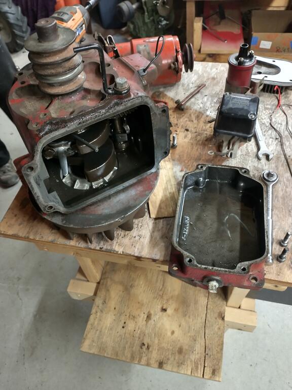

ebinmaine 77,539 #243 Posted March 12, 2023 Engine is back down to bare bones again. Trina will keep on with disassembly and cleaning then paint in a couple days, after the upcoming snow storm. We finished removing the wiring from the chassis with the exception of the harness for the lights. 2 Share this post Link to post Share on other sites

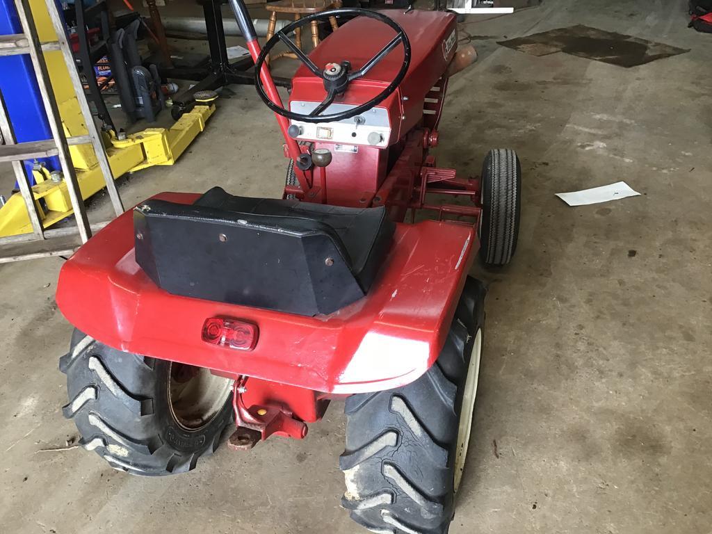

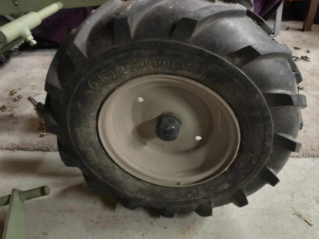

Pullstart 68,981 #244 Posted March 13, 2023 Random question, what are the specs on those front tires? I love the rears on Jane and they happen to be a match on the pattern. 1 Share this post Link to post Share on other sites
ebinmaine 77,539 #245 Posted March 13, 2023 5 hours ago, Pullstart said: Random question, what are the specs on those front tires? I love the rears on Jane and they happen to be a match on the pattern. I'll check em out for ya later and post a pic or 3 1 Share this post Link to post Share on other sites
ebinmaine 77,539 #246 Posted March 14, 2023 On 3/12/2023 at 11:09 PM, Pullstart said: Random question, what are the specs on those front tires? I love the rears on Jane and they happen to be a match on the pattern. Looks like they're a standard issue Deestone brand my friend. 1 Share this post Link to post Share on other sites

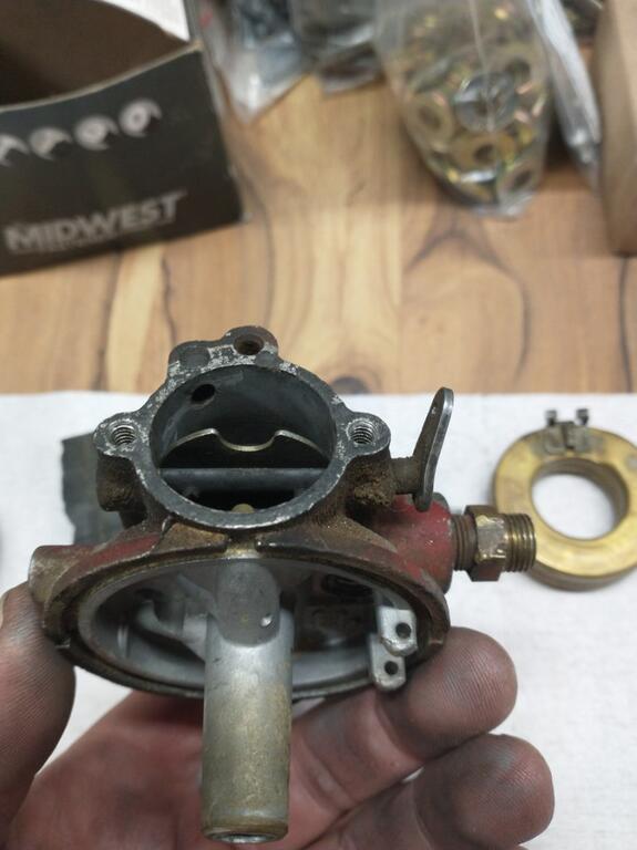

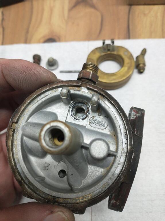

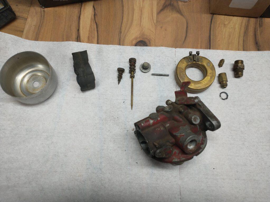

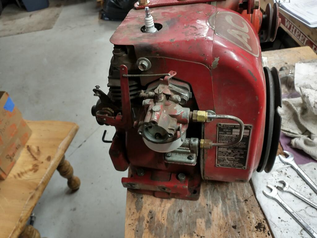

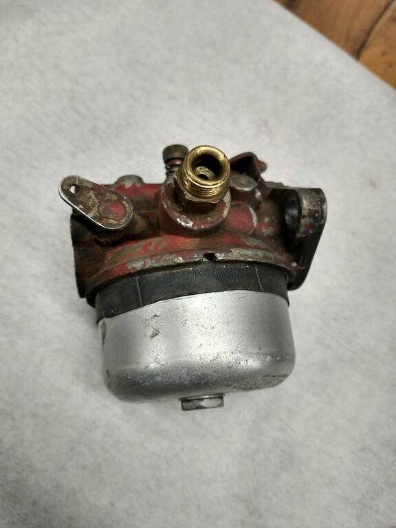

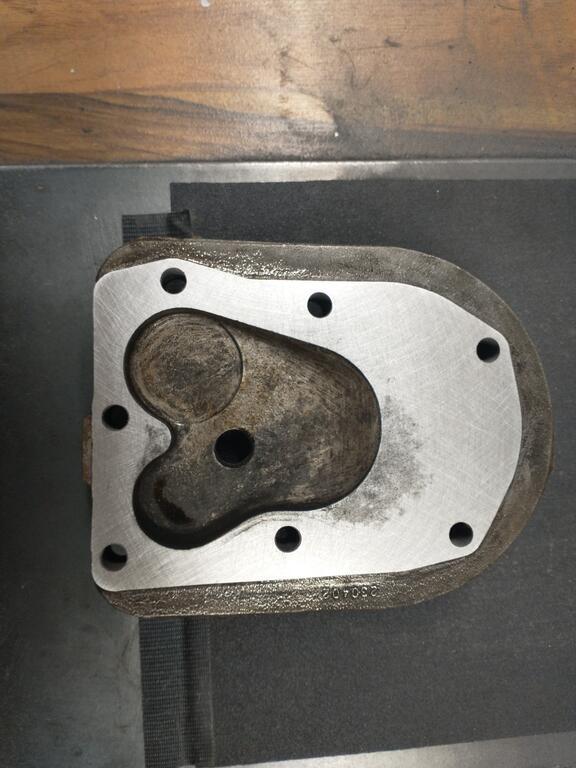

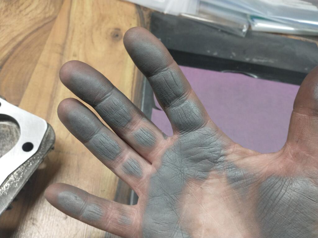

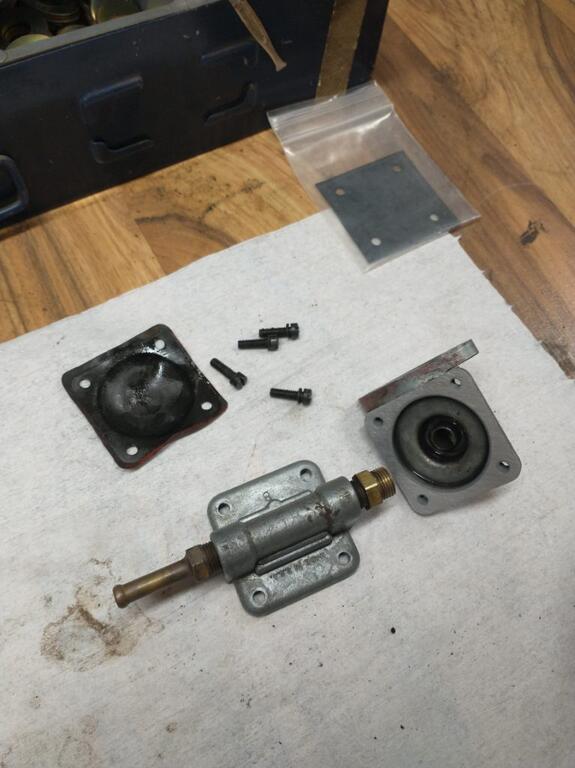

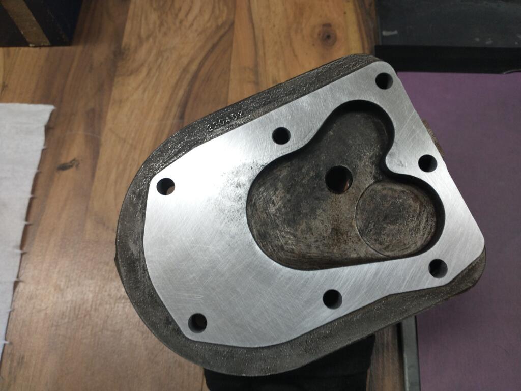

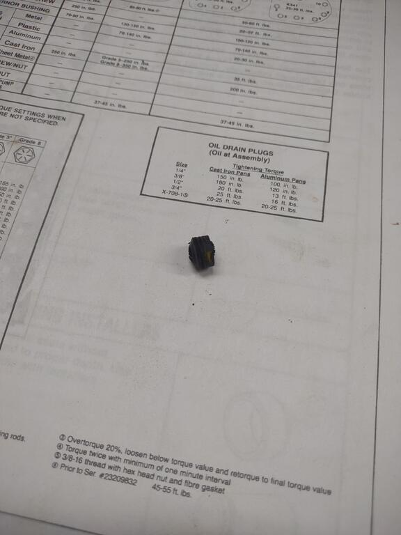

ebinmaine 77,539 #247 Posted March 14, 2023 Fair amount of work done in a short time this evening. Trina the engine mechanic continued with disassembly and cleaning. Oil drained. Cylinder head is off. Oil pan is off. Before attempting to start the engine I had done a very quick hand planing on the cylinder head to check for straightness. She finished that process. 180 grit. 220 grit. Then ended at 400 grit. Fuel pump is disassembled and hand planed. Steering fan gear has been removed. Waiting patiently for a replacement from @Racinbob. Carb disassembly complete. Check out the bowl gasket !! 3 Share this post Link to post Share on other sites

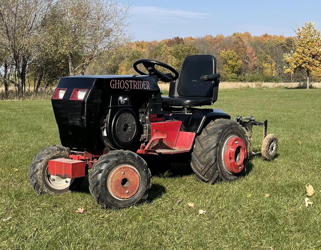

PeacemakerJack 10,873 #248 Posted March 16, 2023 On 3/12/2023 at 10:09 PM, Pullstart said: Random question, what are the specs on those front tires? On 3/14/2023 at 6:22 PM, ebinmaine said: Looks like they're a standard issue Deestone brand my friend. Those look REALLY familiar…where have I seen those before…🤔… Same size, brand, but @ebinmaine’s are in better shape. I don’t even remember the tractor that mine originally came on but they are a permanent fixture on GhostRider. A great little tire🙌🏻 Eric—you guys are making great progress so far👍🏻 2 1 Share this post Link to post Share on other sites

WHX?? 55,228 #250 Posted March 16, 2023 (edited) 3 hours ago, ebinmaine said: Also a very special extremely heavy duty hub pulling tool from one of our awesome members!! What who when where? Why does the head appear to be weird shaped? Edited March 16, 2023 by WHX?? 1 Share this post Link to post Share on other sites
