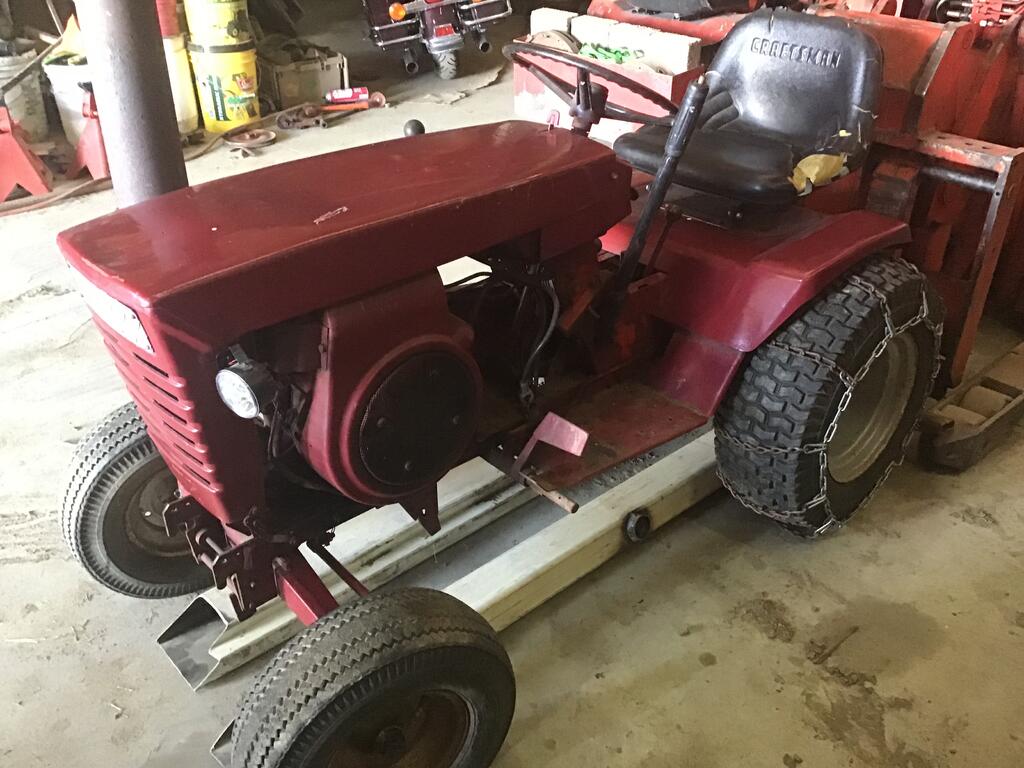

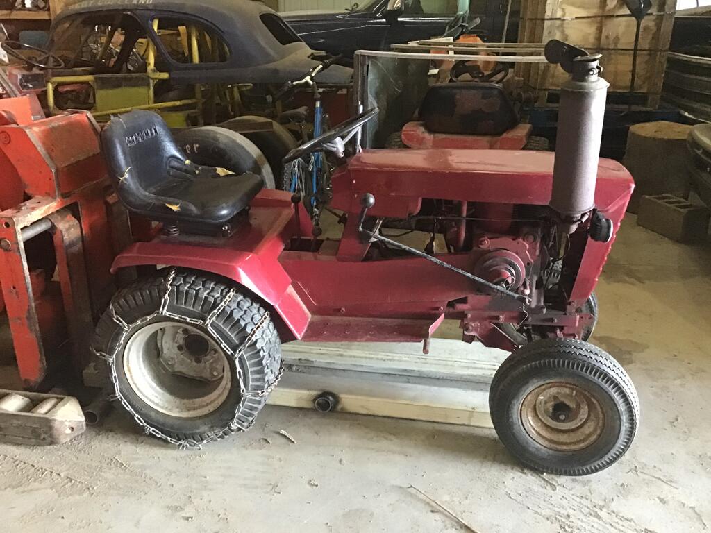

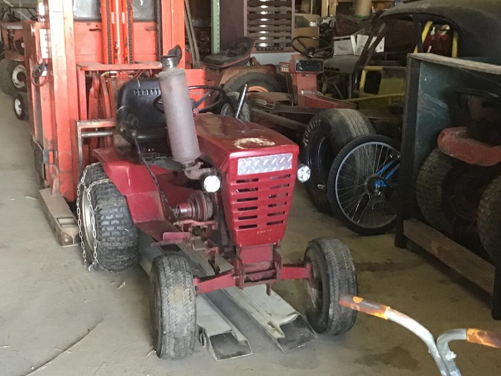

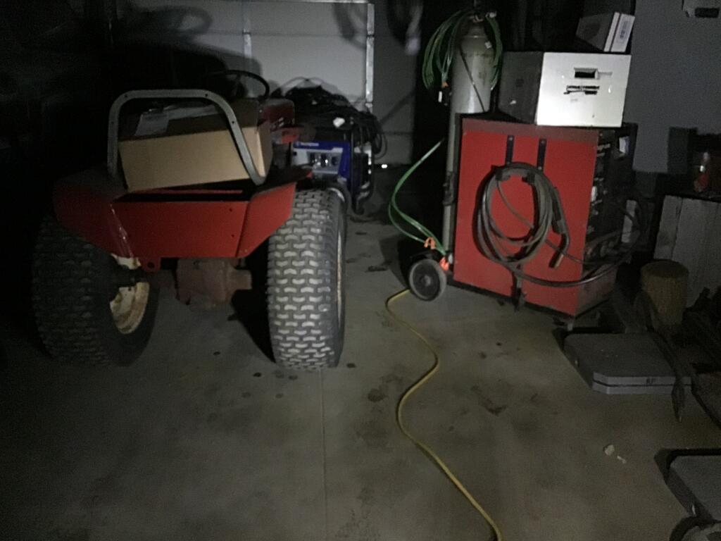

Pullstart 71,387 #1 Posted June 7, 2020 Wife’s boss sent a Marketplace ad to her for a for cheap. A message and a trip ‘cross town... here we have a Raider 10 with a custom paint job and some extra character on the hood! Three or four flip flop equipped helpers and it was in the truck Better yet, I figured it was her new toy. Get home and “Happy Father’s Day” I hear! 4 14 Share this post Link to post Share on other sites

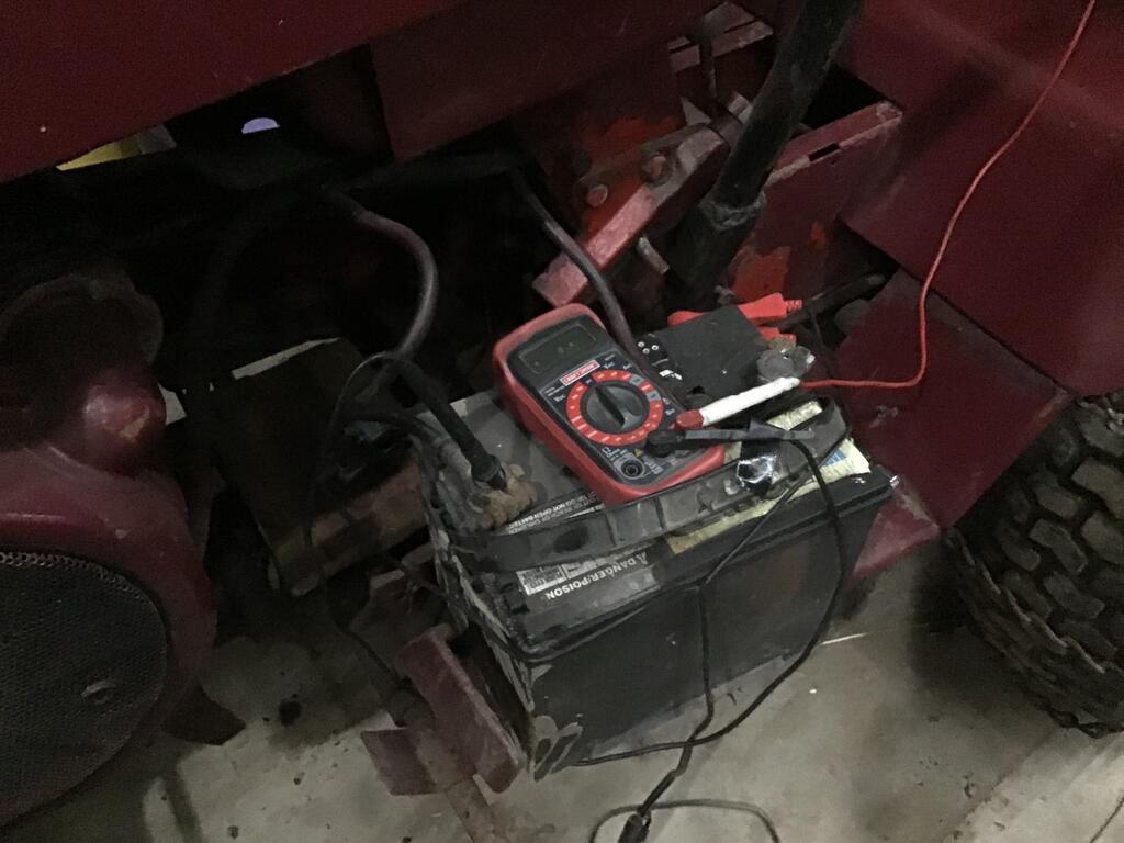

Pullstart 71,387 #13 Posted June 10, 2020 There were top post connections on this tractor, so I grabbed a car battery and got to work. With a full charge, it wouldn’t roll over. I felt the starter and it was hot hot hot! I had voltage to the starter too, so I pulled it off. It’s stuck. I grabbed a spare and tossed it on. With a quick spray, it fired right off! No smoke or anything, though it’s been sitting over a year and a half. Time to pull the carb and dip it in the Berryman’s for a while. I’ll check operation of the fuel pump and drain the fuel system too , it’s quite stanky! 1 Share this post Link to post Share on other sites
