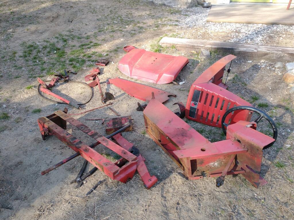

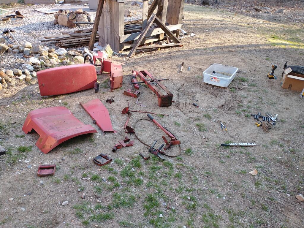

ebinmaine 80,978 #1 Posted April 4, 2021 BBT started her Military Tribute Tractor build this afternoon. The chassis was/is a gift from @Herder Adam maybe 3 years(?) ago. We'll be using the mid 70s Chrysler mil-spec single cylinder engine from @Stepney Spenser. The wheels to be installed are a nice set we picked up from @Sparky last fall at @JCM Jim's North Berwick Maine meet n greet. The Dismantling Department went right to work this afternoon and spent less then 2 hours to get to where she is in the pics. The cleanup crew will be taking over soon. Here's what we'll call the Before section: And here's the current progress: 10 8 3 Share this post Link to post Share on other sites

Achto 32,844 #10 Posted April 4, 2021 2 hours ago, ebinmaine said: I'll be watching the progress on this one. It could be me, but in the picture above the front rims look like they are from a round hood tractor. Say '60 - '62. 1 Share this post Link to post Share on other sites

ebinmaine 80,978 #12 Posted April 5, 2021 2 hours ago, Herder said: I looks like you may need to stop in and pick out your next project!! Careful what ya wish for mister. I told the BBT what you said... "Alright!" Says she... 2 hours ago, pfrederi said: What does the pup have in its back back...a refreshing malted beverage of just some brandy??? Whatever we're in the mood for.... 28 minutes ago, OldWorkHorse said: Might be a little water in there Really. Might be alot of water there too... 58 minutes ago, SylvanLakeWH said: UHM... Trina's spending time on her own stuff? Who's gonna finish building Colossus? Looking forward to this QUICK build!!! She wants you to know she worked on both. 2 1 1 Share this post Link to post Share on other sites
ebinmaine 80,978 #13 Posted April 5, 2021 40 minutes ago, Achto said: the front rims look like they are from a round hood tractor Not being familiar with the older horses.... These rims have bearings in them. Is that a Wheelhorse thing?? 2 Share this post Link to post Share on other sites

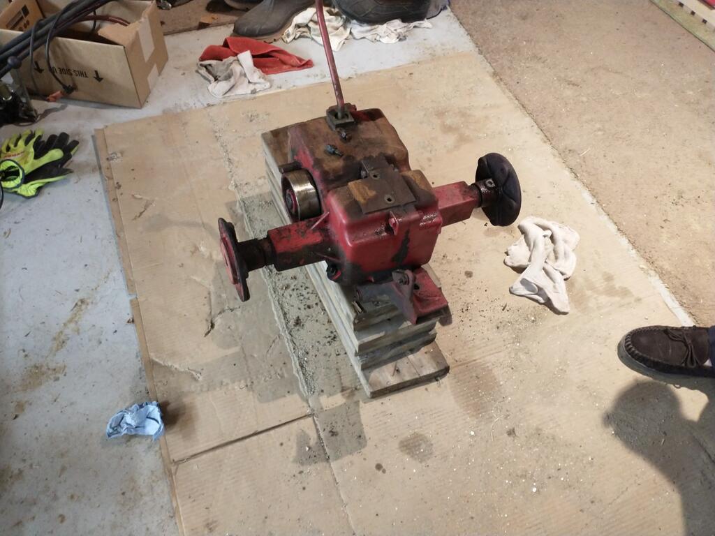

ebinmaine 80,978 #14 Posted April 5, 2021 She's all apaht!! The transmission is in the basement workshop soaking up some penetrating oil. All the rest is setting outside waiting to be scrubbed up.. 4 4 Share this post Link to post Share on other sites
Achto 32,844 #15 Posted April 5, 2021 12 minutes ago, ebinmaine said: Not being familiar with the older horses.... These rims have bearings in them. Is that a Wheelhorse thing?? I was looking at the rolled edge on the bead as an ID for an older rim. I have not seen Timken style bearings in any older Horse. My '60 and '61 both had bushings instead of bearings. 1 Share this post Link to post Share on other sites
ebinmaine 80,978 #16 Posted April 5, 2021 1 minute ago, Achto said: I was looking at the rolled edge on the bead as an ID for an older rim. I have not seen Timken style bearings in any older Horse. My '60 and '61 both had bushings instead of bearings. We were wondering what these were off of. We'll likely transplant them to Trina's lead worker Pigpen tractor. That's due for some new sneakers very soon. 2 Share this post Link to post Share on other sites
Stepney 2,356 #17 Posted April 5, 2021 Never seen a WH with taper bearings, have however seen some real old campers and boat trailers with rims like that. Had to adapt hubs and bolt on wheeels to my 1958 Chris Craft trailer because I couldn't find a good set like that. Also the Jim Dandy round hoods had taper bearing hub-less wheels like that. Could be anything I suppose. Any WH I've ever seen had bushings or the insert ball bearings. 2 1 Share this post Link to post Share on other sites
Herder 2,356 #18 Posted April 5, 2021 12 hours ago, Achto said: I'll be watching the progress on this one. It could be me, but in the picture above the front rims look like they are from a round hood tractor. Say '60 - '62. The front's came off of a 1964 1054, if I remember correctly that tractor didn't come with wheels. 1 2 Share this post Link to post Share on other sites

peter lena 10,091 #20 Posted April 5, 2021 @OldWorkHorse, noting your trans drain , that's actually the best state to dump it at, the smooth easy release of existing used to be oil will make a fuel oil / kerosene flush follow up most effective cleaning. naturally a new shift boot , and a regular look at the new oil for any other cleaning going on, pete 2 Share this post Link to post Share on other sites

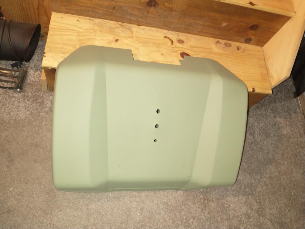

ebinmaine 80,978 #22 Posted April 12, 2021 The Paint Department started in today. 3 4 Share this post Link to post Share on other sites
Pullstart 71,387 #23 Posted April 12, 2021 Awesome! Is that primer, or the final color drab? If it hasn’t been mentioned, is there a certain branch she is honoring? 1 Share this post Link to post Share on other sites
ebinmaine 80,978 #24 Posted April 12, 2021 4 minutes ago, pullstart said: Awesome! Is that primer, or the final color drab? If it hasn’t been mentioned, is there a certain branch she is honoring? Primer is our standard Rust-Oleum 2x Red Oxide. That's OD Green. It appears a tad light because it was taken at night with a flash. I don't think she is specifically going for any particular branch but it works out that her friend is fascinated with the US Army and those are the camo colors BBT is using. 1 1 Share this post Link to post Share on other sites
