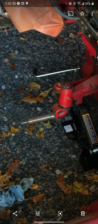

David414 289 #1 Posted February 9, 2021 Guys, doing a front trailer hub conversion on a 312-h using the Northern Tool 4 bolt hub and 1" spindle. I plan on drilling a .750" hole down the 1" spindle and inserting on the current (long) spindles that the tractor came with. My tractor has the original 6" front tires with long spindles. (not the short spindles that came with 8" tires). I am not changing to short spindles, but will use the long spindles. My question is on the trailer wheel. It will be 8" but I have a choice of either no offset, or a -.75 offset. What advice can you share on wheel offset selection? Thanks 2 Share this post Link to post Share on other sites

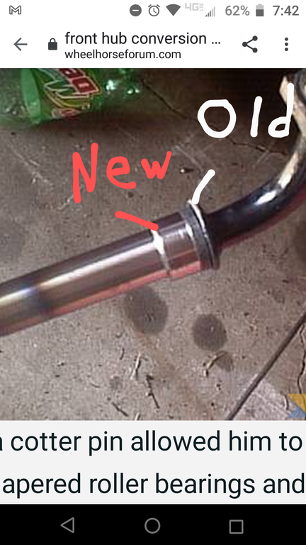

David414 289 #5 Posted February 9, 2021 1 hour ago, ebinmaine said: That's going to depend completely on the offset of the particular hub you're using. Do you have any pics of the hub and a drawing of the cuts/welds you're doing? Ultra-Tow High-Speed Trailer Hub — 4 on 4in., 1250-Lb. Capacity, Single Item# 57204 Northern Tool Ultra-Tow Axle Spindle — 1 1/2in. Square, 8in. Long, Single Item# 5712453 Northern Tool What if you have L-shaped spindles? From PF engineering website Doug kept his existing 3/4-inch L-shaped spindles and bored out the new spindles. A bored out spindle slips over one of his existing spindles and is held in place by cotter pin at the end, that runs through both spindles. Using a cotter pin allowed him to upgrade to the tapered roller bearings and a 4-bolt hub without changing his current L-shaped spindle configuration. 3 Share this post Link to post Share on other sites

David414 289 #14 Posted February 10, 2021 @ebinmaine @WVHillbilly520H @roadapples @JAinVA @RandyLittrell Thanks for the insights and suggestions. The front spindles on the hub side are deeply grooved but the axle spindle is in very good shape. The 6" tires need replacement, so its best to upgrade to 8" wheels and tires. This tractor rebuild is a gift to my grandson and I want everything in excellent working order. No short cuts, no junk. It will not have a FEL. So, what does it cost to change over to 8" wheels from 6" wheels? To replace the long spindles with new short spindles, used 8" wheels and new bearings is $196. To replace with used front short spindles, used rims and new bearings is $155. To replace with a used 520h axle and related steering components and used 8" wheels is over $350. I belong to Northern Tool club and they offer free shipping, discounts on list price and have a $20 discount on orders over $100. The price of new trailer hubs and 1" spindles delivered is $98. Add another $43 for new wheels delivered so for $141, I can get all new trailer hubs, new spindles, tapered bearings , heavier components, warranty, and no grinding of rusty parts. I understand the need for buying used parts, but sometimes, new and improved components can be far cheaper and better built. I plan on welding gussets to the existing spindles to improve strength. My two cents! @peter lena Thanks to @ebinmaine about scrub radius and @RandyLittrell and @JAinVA about bearing issues and wheel offset. I will purchase wheels with zero offset rather than negative offset. This is a great forum for the exchange of ideas, information and practices. Many thanks to all!😊 1 5 Share this post Link to post Share on other sites
