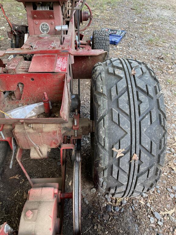

55reasons 171 #102 Posted June 5, 2020 These are the bearings: Share this post Link to post Share on other sites
55reasons 171 #103 Posted June 5, 2020 2 minutes ago, ebinmaine said: I've not tried to change those. Are they not "driving in" all the way? They seat properly at the flanges, yes. But the center sleeve (the part in contact with the axle) sticks out 1/8” and I’m head scratching. Share this post Link to post Share on other sites
ebinmaine 81,048 #104 Posted June 5, 2020 2 minutes ago, 55reasons said: They seat properly at the flanges, yes. But the center sleeve (the part in contact with the axle) sticks out 1/8” and I’m head scratching. Design change perhaps? Share this post Link to post Share on other sites

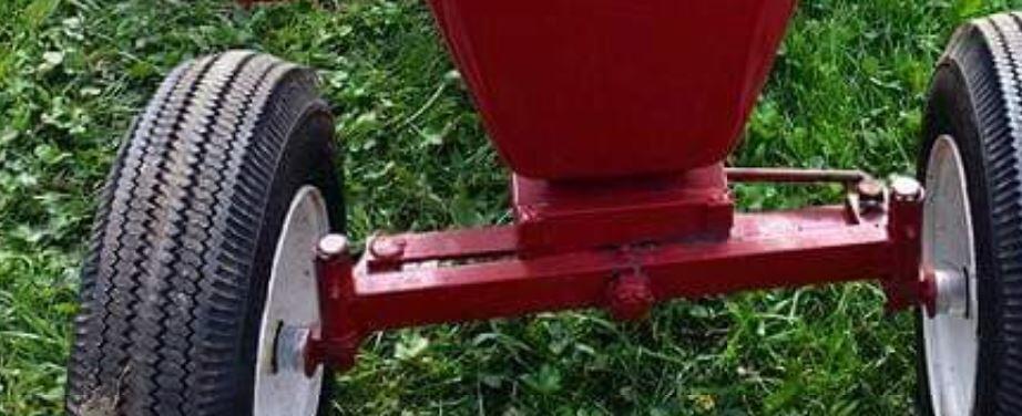

bottjernat1 2,197 #105 Posted June 5, 2020 Time for some washers! I did this to my restored rj58 because at the time i couldnt find the original front rims to save my life. Some day I will get some original front rims. Its all painted and perdy and works so i have left it alone. This is the only thing i wished was better on the restored rj58. I went threw this whole machine inside and out. 2 Share this post Link to post Share on other sites
55reasons 171 #106 Posted June 5, 2020 39 minutes ago, bottjernat1 said: Time for some washers! I did this to my restored rj58 because at the time i couldnt find the original front rims to save my life. Some day I will get some original front rims. Its all painted and perdy and works so i have left it alone. This is the only thing i wished was better on the restored rj58. I went threw this whole machine inside and out. I’m already out of axle length. I can’t add more washers. Share this post Link to post Share on other sites
55reasons 171 #107 Posted June 5, 2020 The thing is, someone told me to switch to sealed bearings to make it easier and less maintenance heavy (no grease). But I didn’t expect to run into this shenanigan. Nobody mentioned this. Share this post Link to post Share on other sites
ebinmaine 81,048 #108 Posted June 5, 2020 Perhaps a spacer that measures 3/4 OD to match the axle shaft and (3/8??) ID to match the bolt? McMaster Carr would likely have something... 1 Share this post Link to post Share on other sites

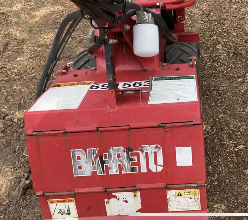

55reasons 171 #110 Posted June 7, 2020 Meanwhile, I need a rototiller, like, immediately. Anyone that has one of these things; can you tell me if this will work on this 74 C160 Auto? 1 Share this post Link to post Share on other sites

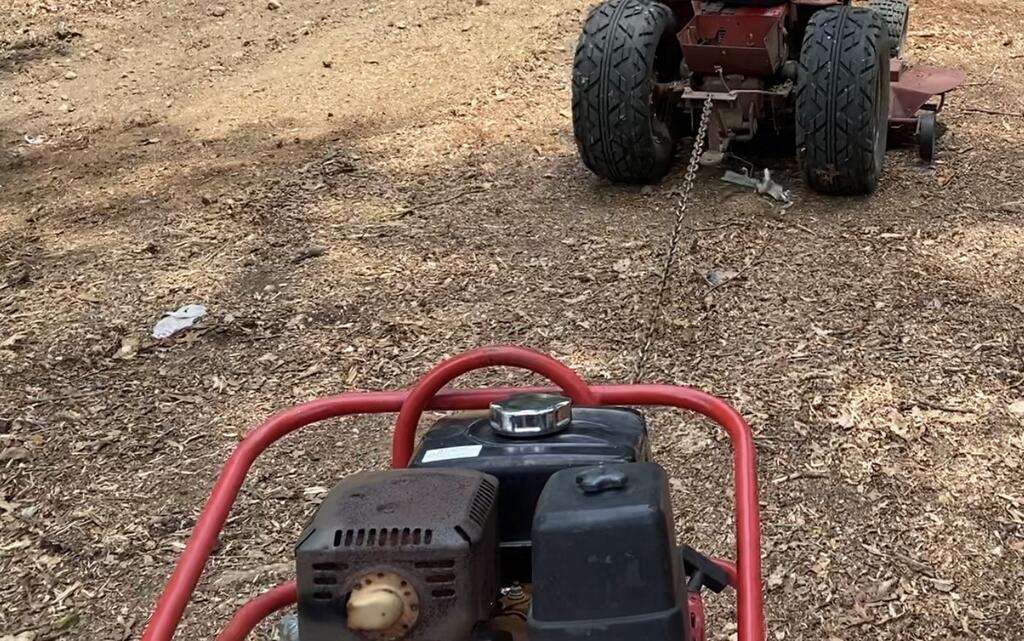

55reasons 171 #111 Posted June 7, 2020 I couldn’t find one locally, so I went out and rented a full hydraulic unit. 15 mins into the job, the Honda motor blows and the Horse has to pull it back to the trailer. Share this post Link to post Share on other sites

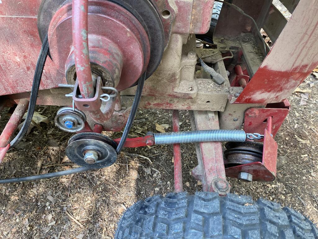

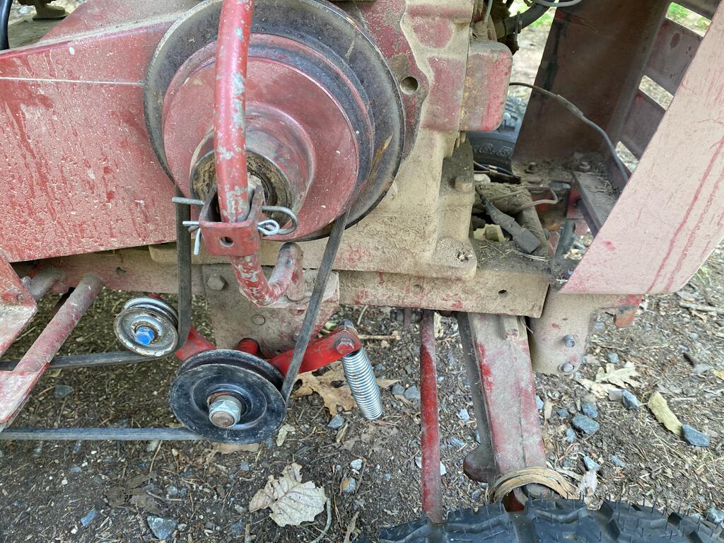

55reasons 171 #114 Posted June 10, 2020 (edited) I went up to Ohio and back (17 hours on the road) to get this tiller. Question, where does this spring connect to for pulley tension? That spring will NOT reach the hole in the frame, and if it’s supposed to connect to the front mule drive it’s a full 6 1/2 inches short. Edited June 10, 2020 by 55reasons Share this post Link to post Share on other sites
55reasons 171 #115 Posted June 10, 2020 This is what I came up with and it works for 10ft at a time. If I hit a rock bigger than a lime, it throws the belt though. Share this post Link to post Share on other sites

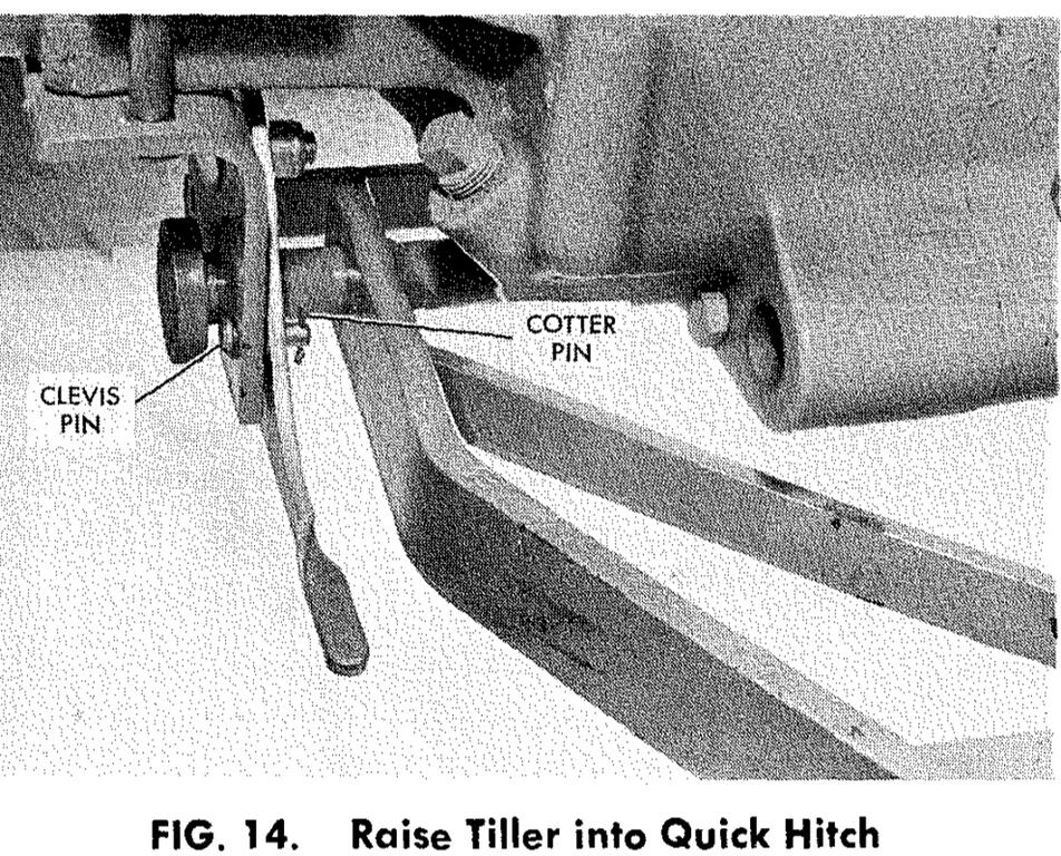

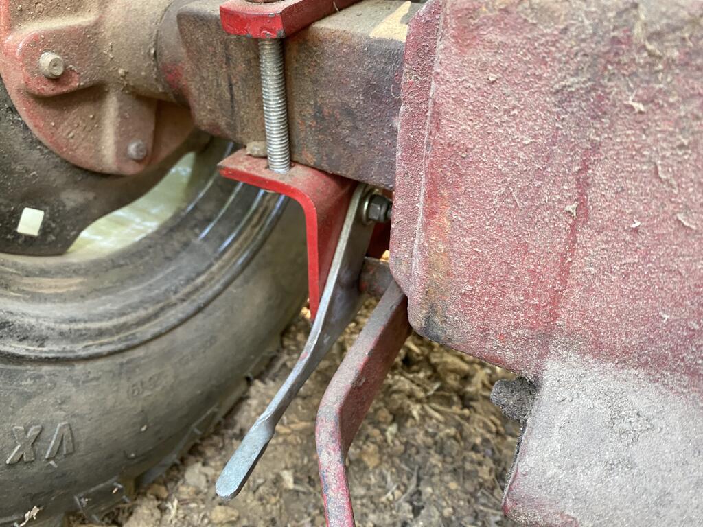

55reasons 171 #116 Posted June 10, 2020 Everything is lined up but there are some issues: 1. It keeps falling off. The “quick hitch” arms in the manual have holes for pins to keep them closed, and this quick hitch does not have them. I don’t know why I have to drill them myself.? I’ve tightened the bolts holding the hitch arms onto the hitch as tight as they will go and they still swing open with one jerk of the tiller. 2. I don’t know why it’s throwing belts so easily, but there enough tension that I can BARELY get the belt on the idler at full stretch. When it’s turning, it’s burning though! Share this post Link to post Share on other sites

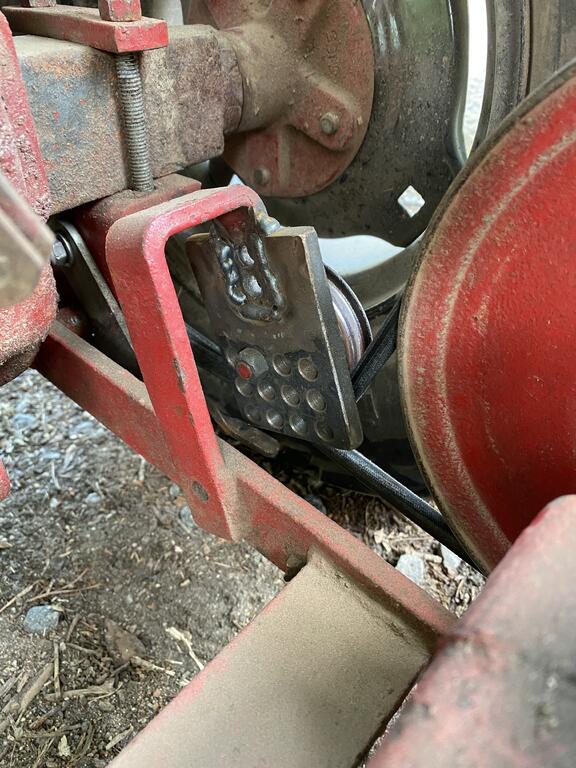

55reasons 171 #117 Posted June 10, 2020 Here is a shot looking down the barrel: The previous owner made a nice adjustment plate for the rear idler to allow infinite adjustment. I might go that route to add even more tension, but I don’t know if I’ll be able to get the belt on if it’s even 1/8 tighter. Share this post Link to post Share on other sites
55reasons 171 #118 Posted June 10, 2020 Shot of the rear idler adjusting plate: 1 Share this post Link to post Share on other sites

Pullstart 71,482 #122 Posted June 11, 2020 Huh. I just went through the process of tossing my tiller on my 502... the little shot in EB’s link above. A couple notes. My tiller setup is not like yours. Mine’s jerry rigged. If you haven:t yet drilled the mount for pins, you’ll need to. I’m not sure why they aren’t there already but you need those pins. Here’s a few things to try, unless the manual says different. Run the belt on the outside bell on the PTO. It should slow the tiller down and the belt too. You might have too much tension. Try finding a spot closer to hook up the tensioner. I can almost yank the belt right off and it isn’t even aligned very well, but it doesn’t throw it. It has been years since I ran my tiller on the appropriate Horse, but it seems like the pulley setup should have a straight bar between the two pulleys and the tensioner spring. I seem to believe it sprung back? 1 1 Share this post Link to post Share on other sites

55reasons 171 #125 Posted June 11, 2020 (edited) 1 hour ago, pullstart said: Huh. I just went through the process of tossing my tiller on my 502... the little shot in EB’s link above. A couple notes. My tiller setup is not like yours. Mine’s jerry rigged. If you haven:t yet drilled the mount for pins, you’ll need to. I’m not sure why they aren’t there already but you need those pins. Here’s a few things to try, unless the manual says different. Run the belt on the outside bell on the PTO. It should slow the tiller down and the belt too. It has been years since I ran my tiller on the appropriate Horse, but it seems like the pulley setup should have a straight bar between the two pulleys and the tensioner spring. I seem to believe it sprung back? Thanks for the ideas! Your comment about being sprung “back” made me dig deeper into some manuals. I can’t run the belt on the outside PTO bell because there would be too much belt deflection down to the mid-mount idler assembly. I see that it originally called for a bolt to be installed through the frame just ahead of the footrest to use as a spring anchor point. That clears up some of my head-scratching! I’m going to try that and search around for an appropriate spring for that setup, as I think that might provide more constant tension and more idler movement for getting belts on when they hop off. You can see the bolt in the photo below. 3/8-16 x 2 3/4 bolt and two nuts to match. Edited June 11, 2020 by 55reasons 1 Share this post Link to post Share on other sites
