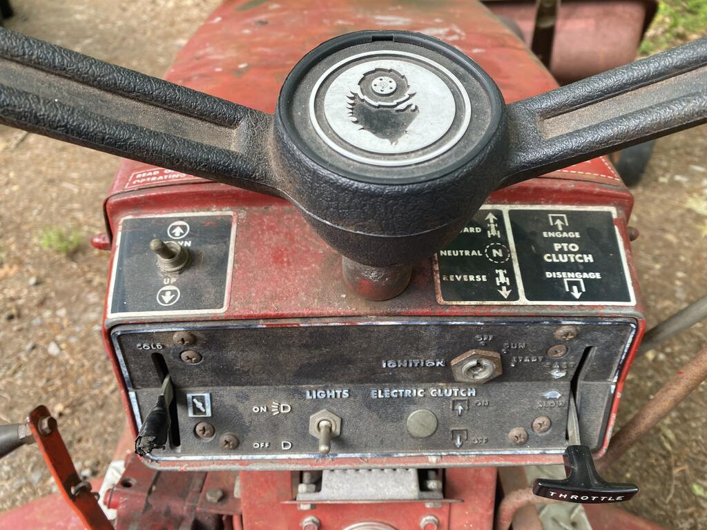

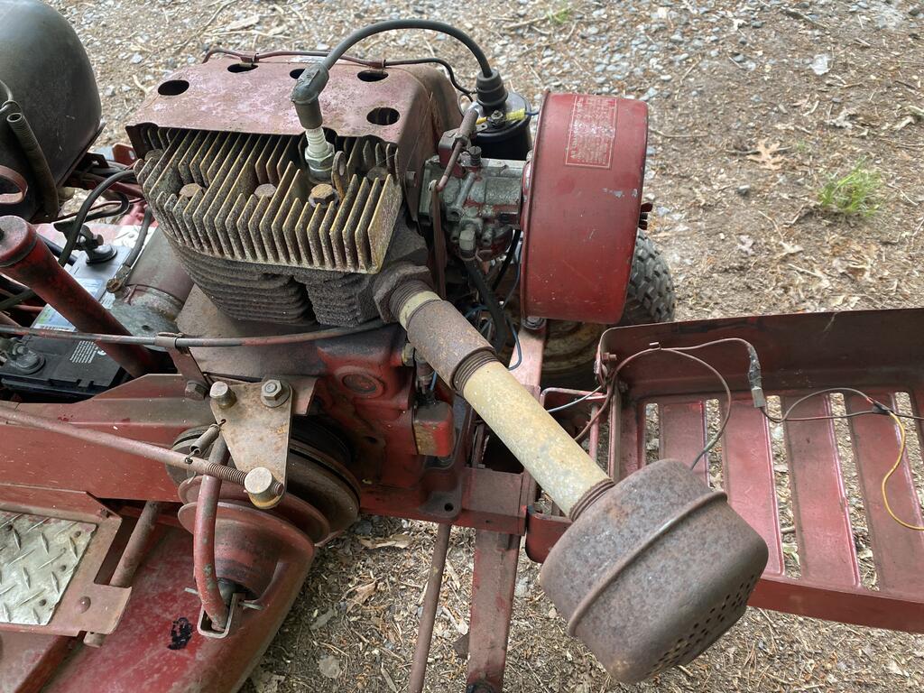

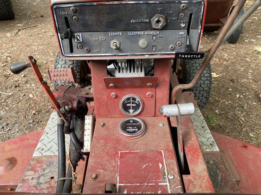

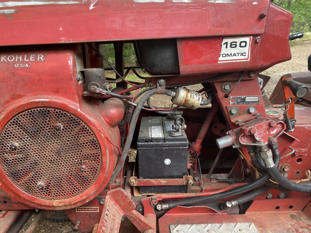

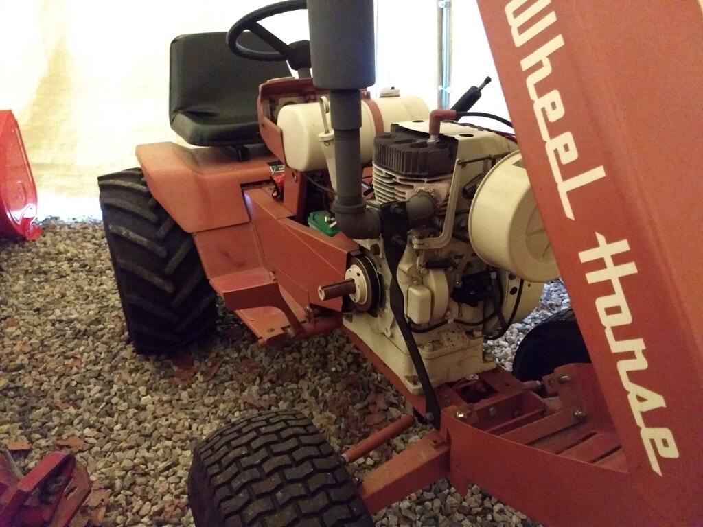

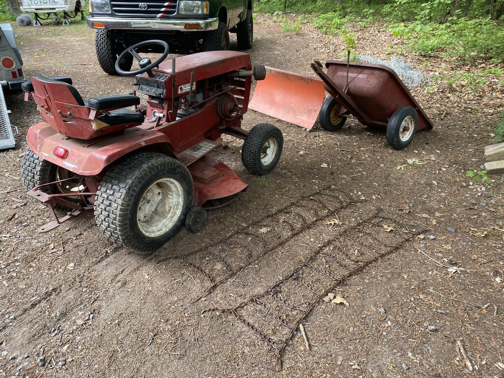

55reasons 171 #1 Posted May 19, 2020 First things first, I need to get it up and running as soon as possible. A restoration is in the plans for the next year or two, but for right now I just need it to do what it’s supposed to do, regardless of how it looks. I bought the whole lot yesterday. The seller lost the keys. He says he just spent $400 at a repair shop getting it up and running, but I don’t have any idea where that money was spent other than a battery. Need an ignition. Need the front attachamatic pulley support. Apparently needs a starter. I should just get the K series rebuild kit probably, but I was told “isavetractors” is not shipping out parts. What’s going on with the exhaust? That can’t be right, can it? It needs tires, should I change from factory size (it has the original chains), so I’m not sure if I should get an aggressive tread, or just use the chains when that’s necessary. Meanwhile, it came with the original manual and the switch all the way to the left of the dash that says “Up and Down” does not appear anywhere in the manual. What’s it for? Please take a look at the photos and pick it apart. I will not be offended at all. I want to put it to work on a lawn project ASAP, then I’ll dust it off and go back through and make it pretty later. 1 Share this post Link to post Share on other sites
55reasons 171 #3 Posted May 19, 2020 Dash. what’s the switch in the top left for? Share this post Link to post Share on other sites
stevasaurus 23,861 #6 Posted May 19, 2020 The switch is for your hydrolic lift for attachments like mower and snow blade. 1 1 Share this post Link to post Share on other sites
55reasons 171 #7 Posted May 19, 2020 9 minutes ago, stevasaurus said: The switch is for your hydrolic lift for attachments like mower and snow blade. If the little switch is for the hydraulics, then what is the lever connected to the hydraulics for? Share this post Link to post Share on other sites

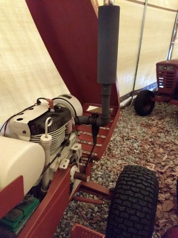

ebinmaine 81,048 #9 Posted May 19, 2020 I put a reminder in my phone calendar to check on that ignition switch for you later today. Why do you think you need a starter? Po info? That muffler is most certainly not original. It really should have a 45-degree bend in it to get it away from the hood. Other than that, nothing wrong with using that muffler other than it maybe a touch loud. 2 Share this post Link to post Share on other sites
ebinmaine 81,048 #10 Posted May 19, 2020 Has two tires, the biggest key to traction is actually weight. The more weight you have, the more traction you're going to have. I've tried AG tires and also turfs with chains and I can honestly say I do not know which one is best for traction. There are quite a few threads on this site with lots of good information about tires. Traction. Weights. No weights. Many various opinions and experiences. All of them are correct on all sides because the needs of individuals are variable. Share this post Link to post Share on other sites
55reasons 171 #11 Posted May 19, 2020 4 minutes ago, ebinmaine said: I put a reminder in my phone calendar to check on that ignition switch for you later today. Why do you think you need a starter? Po info? That muffler is most certainly not original. It really should have a 45-degree bend in it to get it away from the hood. Other than that, nothing wrong with using that muffler other than it maybe a touch loud. Thanks. Yes, the PO told me the starter went out. I have seen other photos of similar exhaust profiles, so I asked. were the original exhaust setups also threaded into the head like this one, or was there some sort of flange/gasket ? Share this post Link to post Share on other sites
ebinmaine 81,048 #12 Posted May 19, 2020 2 minutes ago, 55reasons said: Thanks. Yes, the PO told me the starter went out. I have seen other photos of similar exhaust profiles, so I asked. were the original exhaust setups also threaded into the head like this one, or was there some sort of flange/gasket ? This particular engine they were threaded. That's regular NPT pipe. the original would have bent down between the engine and the hood and exited the opposite side. Here's what I did on my cinnamon horse which is a 1974 C160 - 8 1 1 Share this post Link to post Share on other sites

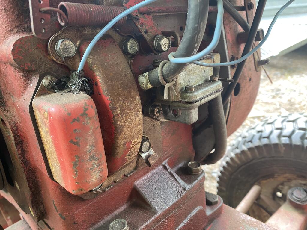

Pullstart 71,482 #13 Posted May 19, 2020 @55reasons! Most all indak brand keys are the same. My 2018 Scag ZTR key works for a 1960’s Wheelhorse. Start with getting power to the starter, then see if you need to replace it. Do you have a volt meter? If you turn the key and nothing happens, please don’t start replacing stuff at random, trace your power. As EB mentioned, weight will likely be your best traction aid. I am a fan of the Deestone 23x10.5-12 tires. They help give great traction for the price and look good doing it. Their size is less than advertised, the 10.5’s are more like 9” wide. 8.5’s... more like 7 or so. As for the exhaust... same thing here. Get it running and reliable then make it your own. 1 1 Share this post Link to post Share on other sites

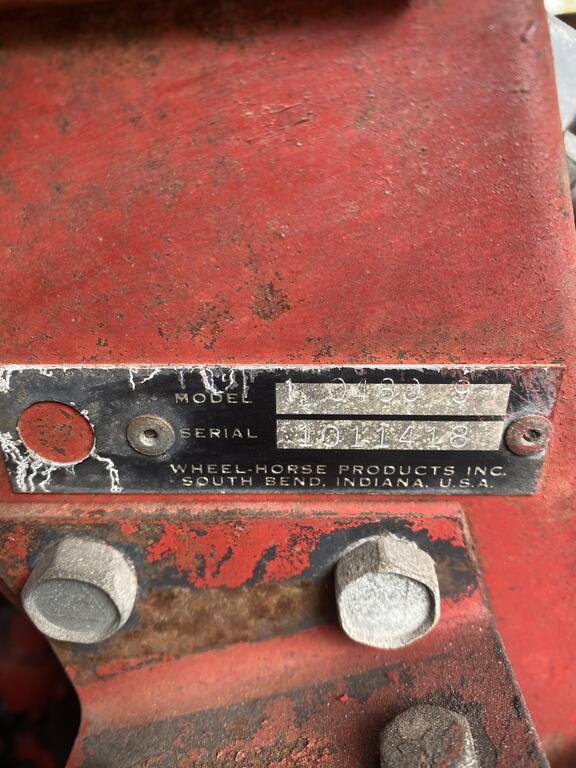

gwest_ca-(File Mod) 12,522 #14 Posted May 19, 2020 Your tractor is a 1974 model. Here are 2 pages of info on the model. https://www.wheelhorseforum.com/search/?q=1-0480&quick=1 Garry Share this post Link to post Share on other sites
55reasons 171 #15 Posted May 19, 2020 50 minutes ago, gwest_ca said: Your tractor is a 1974 model. Here are 2 pages of info on the model. https://www.wheelhorseforum.com/search/?q=1-0480&quick=1 Garry Interesting. The manual the dealer gave the PO when he bought it is a 75 manual with the sale date, etc. Share this post Link to post Share on other sites

Trouty56 568 #18 Posted May 19, 2020 put power to the coil from the battery and jump pack to the starter...start using it 1 Share this post Link to post Share on other sites

55reasons 171 #20 Posted May 19, 2020 24 minutes ago, ebinmaine said: @Sparky runs an interesting tire on the back of one of his machines. Let's see if he will chime in. If you want to try just a key I'd be happy to mail you one. I've got a spare or two somewhere. But if you're wanting to get it running as soon as possible an ignition switch won't be a huge investment... Even if it turns out not to be what you needed. Do you have a half decent old-time parts store near you? I’d like a key, but I think I can get those online. An ignition with keys appears to be about $20. I’m not worried about cost, really. I haven’t looked around for any old-time parts stores. I’m a metric guy. Blasphemy, I know, but I have a huge garage and not a single wrench with a fraction on it. I’m gonna have to go Harbor Freight and buy this thing it’s own tool box set. lol... 2 2 3 Share this post Link to post Share on other sites

55reasons 171 #24 Posted May 19, 2020 This is what the dealer gave him. Apparently it was for the wrong year, but note they circled the model and deck, and his wife’s name is scribed on the front, as she bought it for him as a gift. I imagine they wrote it there when they set it all aside for pickup. 2 2 Share this post Link to post Share on other sites
