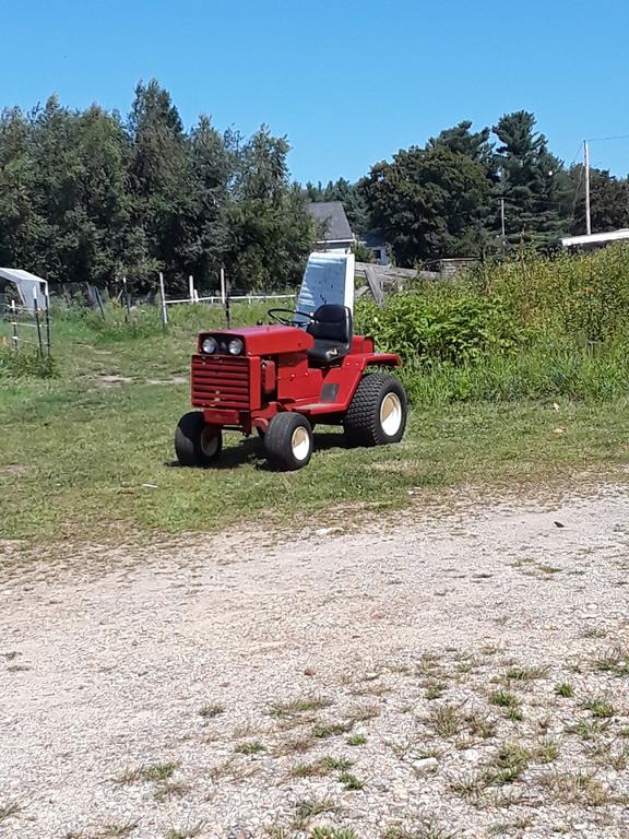

Shannon 5 #1 Posted October 4, 2019 Please help! We're having carb issues with my son's Wheel Horse D160. We've found that if we put a new fuel pump on it, it runs great for a while, then it starts sputtering and acting like the carb needs cleaning. Which has been done. We're hoping to find one of two things. first off, does anyone know a part number for this carb? it's the odd square style one, and everytime I do a search for one, ones that look very different come up. Does anyone know a good site to get one? I also read another thread where someone said that the float could be the problem and they said that they ordered just the float on ebay. I cant find one of those either. We're willing to give anything a try at this point. My son wants to use this tractor so badly, and we just cant seem to get it running right. Any help at all will be greatly appreciated. 1 Share this post Link to post Share on other sites

Shannon 5 #7 Posted October 6, 2019 Thank you all so much for the reply's. @Crazywheelhorseman, that would be great! @pacer, i had seen a couple of those kits, but I don't see the float in them? Shouldn't it come with a float? I've also heard some say that switching to a better made float can help, but again, I cant find the floats anywhere, even in those kits. I'll check into the vent for the gas cap @bcgold. Again, I want to thank you all for the quick responses. Really hoping to get this D running good. My son (13) is a wheel horse fanatic. Started with a B80 last year. He has a small farmstand that he pulls around the neighborhood with it. He was very excited to upgrade to the D, both for pulling the wagon, as well as to do some of the garden work next year. He is so anxious to have it running right. He also plowed some driveways in the neighborhood with the B80 and he hopes to be able to do that with the D once it's running right. 1 1 2 Share this post Link to post Share on other sites
