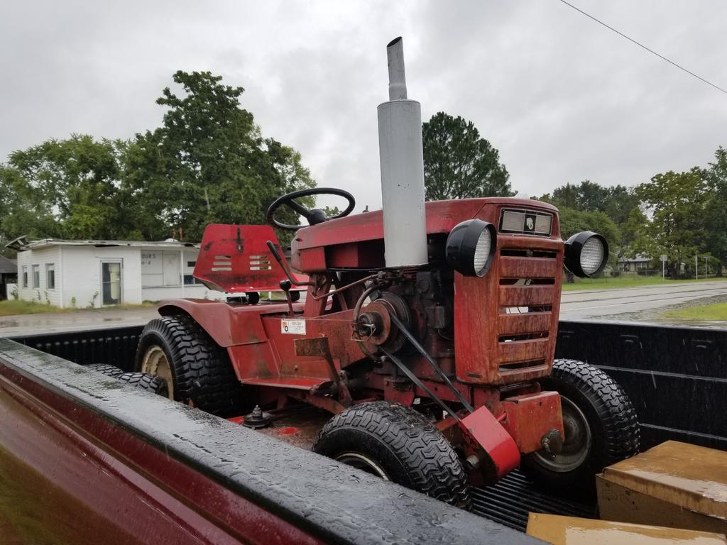

Nat Faust 46 #1 Posted October 13, 2018 Hey guys! Just picked up my first horse, it's a C-100. I think it's a '75, paid $300 for it. Has a mowing deck but I don't know what size. I'm on my way home with it so I'll have to find out more in a bit! 9 6 Share this post Link to post Share on other sites

pfrederi 20,226 #3 Posted October 13, 2018 Welcome!! Nice tractor and good deal...Make sure you put a tin can over that stack if she is ouside. 1 Share this post Link to post Share on other sites
JAinVA 4,638 #4 Posted October 13, 2018 Hope you didn't get to much rain with that open stack. Share this post Link to post Share on other sites
Nat Faust 46 #5 Posted October 13, 2018 I've got a can over it right now I plan on putting a flapper on there once I can get down to tractor supply. 2 Share this post Link to post Share on other sites

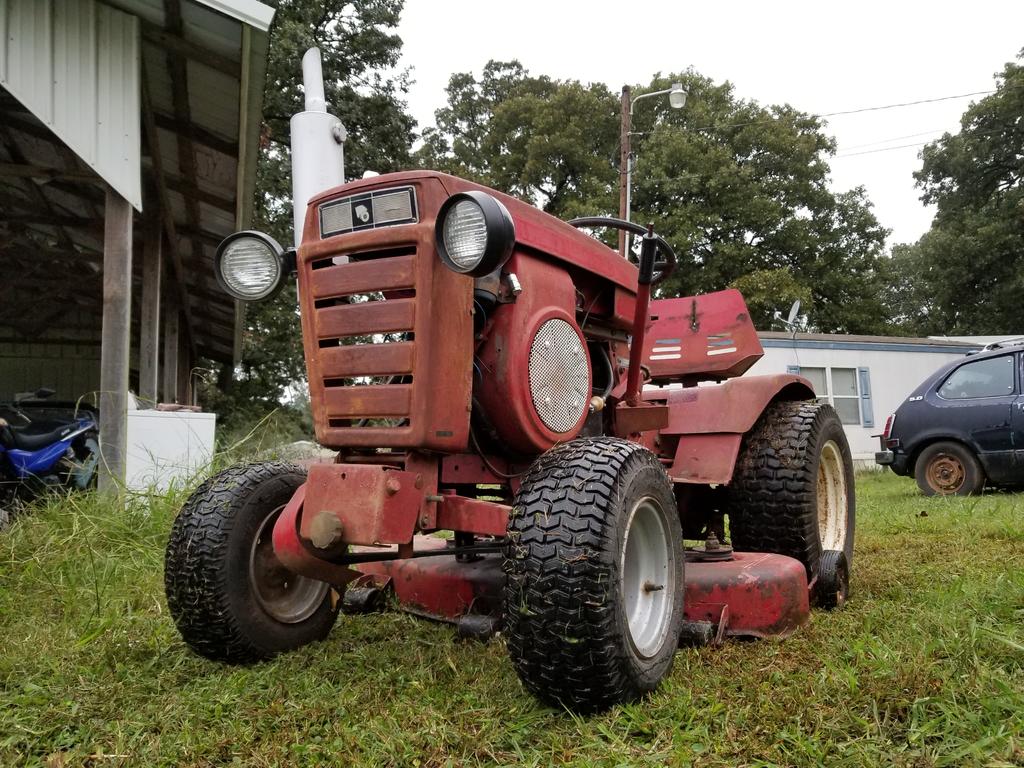

Ed Kennell 45,662 #6 Posted October 13, 2018 to the The Cs are great tractors....one of my favorites. Looks like a twist in the deck belt between the PTO and mule drive. Better fix that before engaging the PTO. 2 Share this post Link to post Share on other sites
Nat Faust 46 #7 Posted October 13, 2018 Yeah she needs a new belt on there altogether. Probably twist it around to test the deck, but it's got some fraying on it. I'm just about home with it, had to make a 3 hour trip to get it. Going to unload it into my carport and get it fired up and whatnot. Guy said he mower with it this summer but bought a Toro zero turn and has had it parked. We will see what effect that has had on it. 1 Share this post Link to post Share on other sites

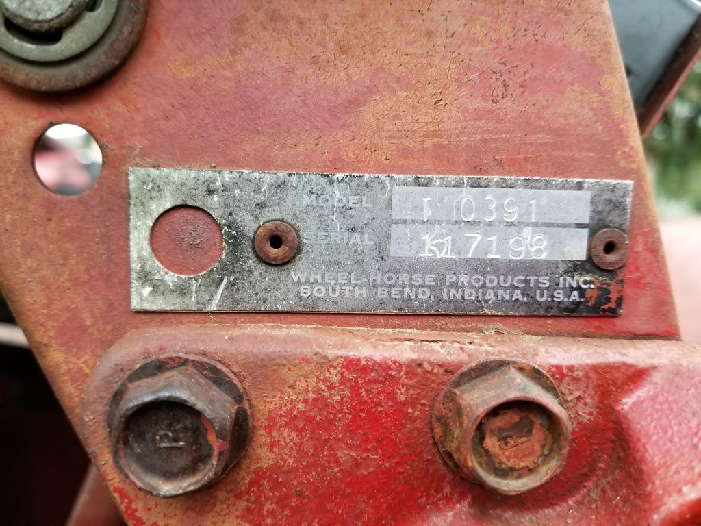

pfrederi 20,226 #8 Posted October 13, 2018 Find the model number on plate probably just below the instrument panel ad post it here we can guide you to manuals and other things here that will be helpful If it is a 75 C-100 it should show 1-0391 Share this post Link to post Share on other sites

Nat Faust 46 #14 Posted October 14, 2018 Alright, sorry for the much later than expected update. I'm a little under the weather, but I couldn't resist at least finding out what parts I need to order. I got it running (barely) and sscooted it around the yard very briefly. The fuel pump seems real weak, and the needle and seat in the carb are shot. Tried removing and cleaning everything but she still just barely runs. No big deal, replacing those is cheap and in still happy with my investment. @pfrederi it does in fact have that number, will include pic. @Tankman Creek County area, near Tulsa though. I frequent the "big city" a lot! Sounds like you've had some adventures yourself! @The Tool Crib I already want more! I love this thing. @Daddy Don thanks Don! Glad you see there is some other Wheel Horse love in OK! She's going to sit under the carport for this week while I wait on some bits, hoping to go have a pass on my yard with this deck next weekend. Brand new, sharp blades on it! 2 Share this post Link to post Share on other sites
