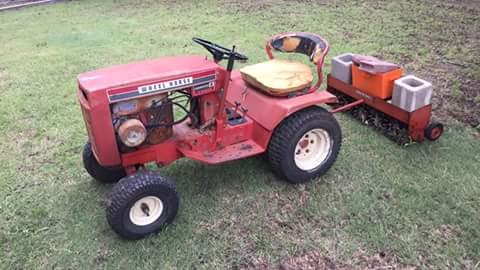

ClassicTractorProfessor 5,455 #28 Posted October 10, 2018 @Lengerich8 you have definitely found the best place on the web for anything Wheel Horse related. Nice tractor you have there, good luck with whatever path you decide to go down with it. I'm attaching a picture of my Commando V8, note the vertical shaft Tecumseh engine. 1 1 Share this post Link to post Share on other sites

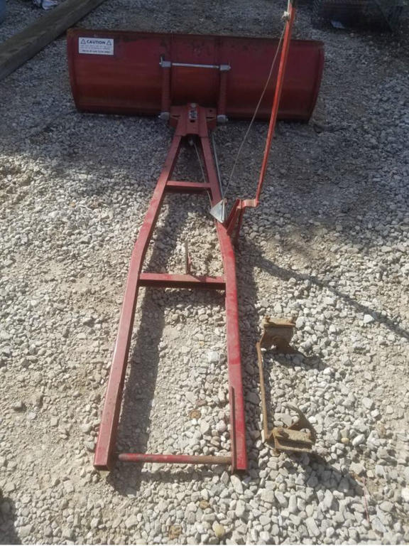

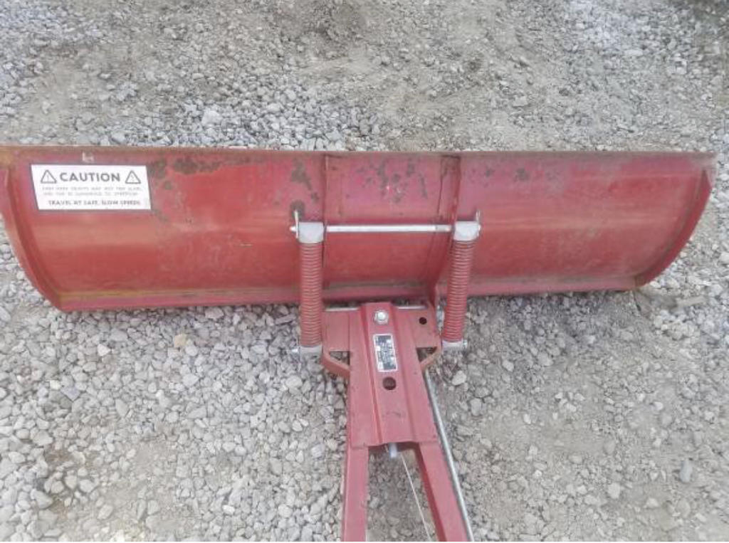

LengerichKA88 1,885 #35 Posted October 10, 2018 @953 nut, @gwest_ca thanks guys! i just went back to the listing to see if I’d missed anything, and now it doesn’t say anything about “short frame”, so I screen grabbed the pictures. 😂 I’m still waiting on him to get back to me, but I’m glad I asked first. 1 Share this post Link to post Share on other sites
953 nut 70,344 #36 Posted October 11, 2018 That appears to be the long frame unit. Having the axle bracket with it is a big plus. 1 1 Share this post Link to post Share on other sites
LengerichKA88 1,885 #37 Posted October 11, 2018 54 minutes ago, 953 nut said: That appears to be the long frame unit. Having the axle bracket with it is a big plus. A big plus for someone else... it’s sold 😩 ill find another one eventually im sure 2 Share this post Link to post Share on other sites

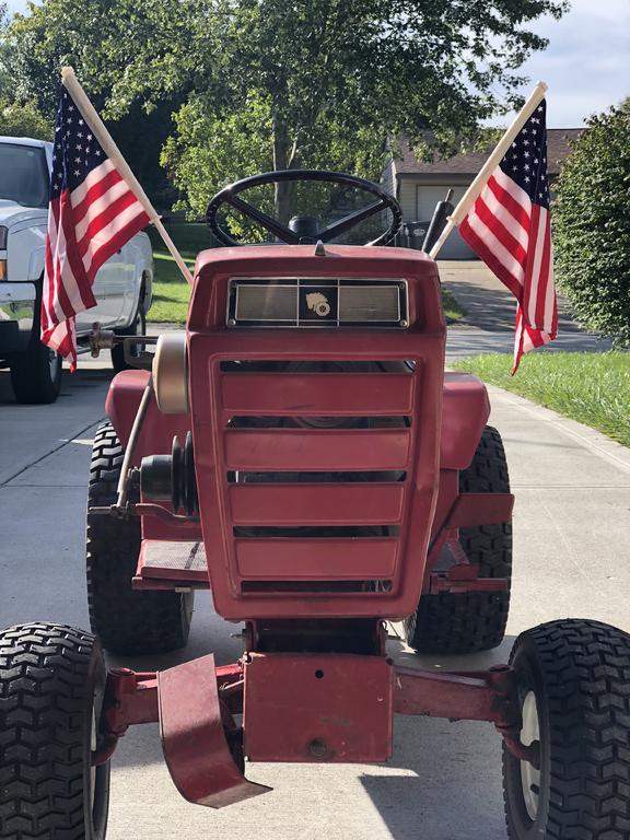

LengerichKA88 1,885 #46 Posted October 16, 2018 (edited) So, figured you guys would get a kick outta this: Decided on a name for the tractor last night: America. Because, it’s a Horse with no name 😂 Appearance updated😂 Edited October 16, 2018 by Lengerich8 1 Share this post Link to post Share on other sites
Pullstart 71,520 #47 Posted October 16, 2018 Suits it well! 1 Share this post Link to post Share on other sites
