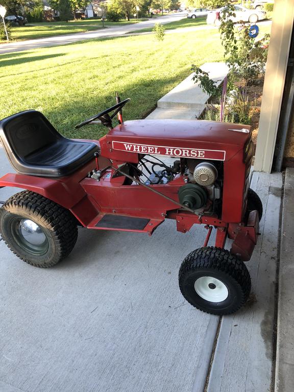

LengerichKA88 1,885 #1 Posted October 9, 2018 I couldn’t find a thread that really fit my question, so I started my own. If it’s in the wrong spot please advise and I’ll remove/move it. We recently came into a tractor that all we were told is that it was a “68 Wheel horse”. After doing some digging on the engine serial number, I figured out that it’s a 69, but some places I’ve looked say it’s a Commando 8, some say Commando V8. I’m new to these, so I don’t know how to tell, definitively, which one it is. Any suggestions? Also, what’s the difference between the two? I haven’t really found a straight answer on that either, which I’m sure would end up answering my first question. Thanks I’m advance for any and all help! 3 Share this post Link to post Share on other sites
Sparky-(Admin) 26,689 #2 Posted October 9, 2018 The "V" signifies a vertical shaft engine, which is not what you have. Looks like a Commando 800 or a 1973 8/4speed. 4 1 Share this post Link to post Share on other sites

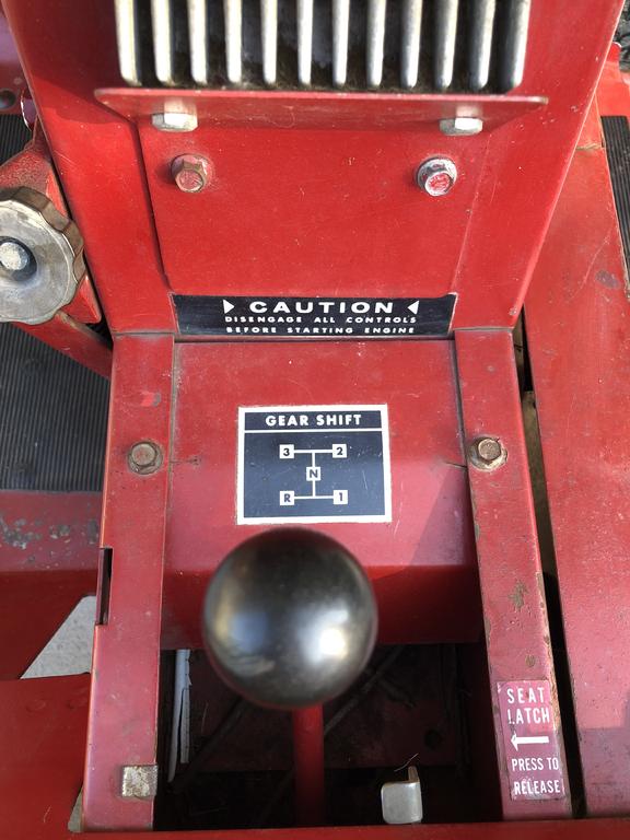

LengerichKA88 1,885 #3 Posted October 9, 2018 15 minutes ago, Sparky said: The "V" signifies a vertical shaft engine, which is not what you have. Looks like a Commando 800 or a 1973 8/4speed. Thank you! This is completely foreign territory for me. I’m guessing that being a 3-Speed narrows it down to an 800. These are such cool little tractors, especially being made in Indiana (Hoosier), that’s what really drew me into them is their “Home grown” origin haha. I’d like to eventually make it look factory fresh, but needed to make sure I was looking for the correct parts. Thank you again! 2 Share this post Link to post Share on other sites

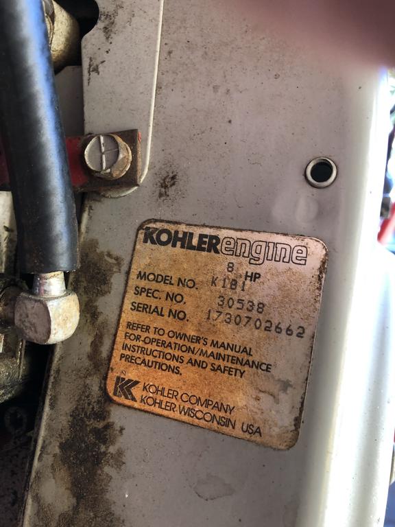

LengerichKA88 1,885 #5 Posted October 9, 2018 9 minutes ago, posifour11 said: A picture of the model/serial number plate could help narrow it down. Should be on the left side of the hoodstand. Looks to be a good candidate for restoration. Either mines missing, or I need my prescription checked 😂 The only thing I can find on it is the sticker on the engine (below). Aside from that and “Wheel Horse” on the hood, I haven’t found any other identification plates or numbers anywhere. I know I’m not making it easy lol, but I greatly appreciate the help guys! Share this post Link to post Share on other sites
pfrederi 21,308 #6 Posted October 9, 2018 Engine is a service engine replacement can't use it to Id the model of tractor.... 3 Share this post Link to post Share on other sites

Racinbob 13,286 #8 Posted October 9, 2018 1 hour ago, Sparky said: The "V" signifies a vertical shaft engine, which is not what you have. Looks like a Commando 800 or a 1973 8/4speed. The Commando 800 would be a 72 1 Share this post Link to post Share on other sites

elcamino/wheelhorse 9,363 #15 Posted October 9, 2018 Welcome to Red Square , I don't think it is a Commando 800 , the finned regulator was hidden behind the tower. It was not exposed like the photo you sent. My guess would be a 73 no name. 2 1 Share this post Link to post Share on other sites
LengerichKA88 1,885 #16 Posted October 9, 2018 1 hour ago, gwest_ca said: VIN plate may be up tight to the bottom of the dash panel above the finned voltage regulator. Garry I just went and looked, nothing but red paint. I’m 0-2 😂 31 minutes ago, elcamino/wheelhorse said: Welcome to Red Square , I don't think it is a Commando 800 , the finned regulator was hidden behind the tower. It was not exposed like the photo you sent. My guess would be a 73 no name. That would explain why the branding on mine doesn’t look like any others I’ve seen 🤔(800s I mean). They all have what looks like a metallic decal, where “Wheel Horse” is painted on mine. Would that make it more/less desirable? Would I just have to look through parts (for cosmetic stuff like the Throttle knob) to see what matches instead of looking by model specifically? Was it a common thing for them to put out “No names”? and thank you all for the welcome!! Share this post Link to post Share on other sites
Achto 32,927 #17 Posted October 9, 2018 I believe that '73 was the only year for no names. 3 Share this post Link to post Share on other sites
posifour11 723 #18 Posted October 9, 2018 (edited) 4 hours ago, Lengerich8 said: I told the wife that instead of looking at it as a head ache and a money pit, to look at it as a blessing: If I’m working on and putting money into this, I don’t have money to buy an old Cutlass or Nova to restore 😂 Nope! You need a dozen wheel horses and an AMAZING G-body! Then, you can bring me a 72 Nova to make her feel better. 😀 Edited October 9, 2018 by posifour11 Speeling 😀 2 Share this post Link to post Share on other sites
Racinbob 13,286 #19 Posted October 9, 2018 4 hours ago, elcamino/wheelhorse said: Welcome to Red Square , I don't think it is a Commando 800 , the finned regulator was hidden behind the tower. It was not exposed like the photo you sent. My guess would be a 73 no name. Not necessarily so Jim. Here's a 1972 Commando 800 (1-0110). Don't let the rear tires and seat setup throw you. I made those changes when I restored it for our grandson. You can see the regulator mounted like @Lengerich8's. Now that's not saying they all came like that. But....the decals on Len's would say 1973. The decals on this 72 are original. 2 Share this post Link to post Share on other sites

elcamino/wheelhorse 9,363 #22 Posted October 9, 2018 @Racinbob That is strange about the regulator mounting. I have my Dad's Commando 800 and the regulator is hidden in the tower. I know that the Commando 800 came with 10 inch rear rims and 6 inch front rims. Not sure about the 73 8 hp no name. 1 1 Share this post Link to post Share on other sites
Racinbob 13,286 #23 Posted October 9, 2018 (edited) That doesn't surprise me Jim. That's why I added the disclaimer. This one was all original when I purchased it in the early 80's and it had the 10" rears. I left the 6" fronts and put the 12" from a 76 B-80 on the back. The 73 8 4-speed had 6" and 10" but the 8 8-speed had 8" and 12"...…….... I think Edited October 9, 2018 by Racinbob 1 1 Share this post Link to post Share on other sites
