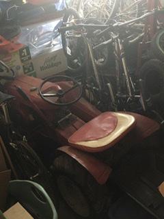

tom2p 2,396 #3777 Posted December 24, 2019 what I did today ... moved a bunch of stuff to uncover a tractor ... my fav - the 704 2 3 Share this post Link to post Share on other sites

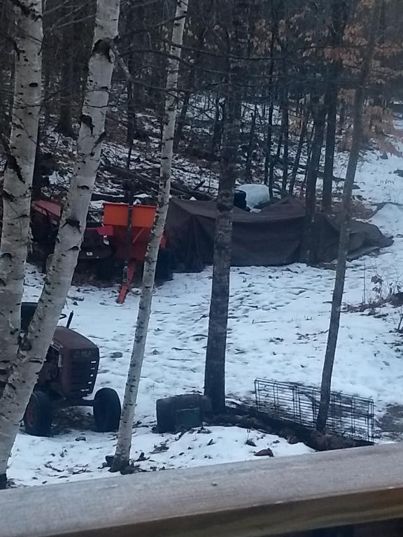

ebinmaine 81,000 #3786 Posted December 28, 2019 Bought a couple inexpensive tarps off the jungle site to cover the "parts department". Did a little reorganizing out there and snugged the stuff in for a long winters nap under a blanket of snow. Finally took a few minutes to finish up the carb from when @JCM Jim was over and we learned how to add spacers to the top of the shaft. I had spilled just a touch of blue loctite on the pivot point. I used a q-tip to drip a few drops of acetone in there. Let it sit. Blew it out. Repeat a couple times. Works perfectly. So that'll get tossed on the Cinnamon Horse sometime. I've got 2 more carbs to freshen up and put bushings in. 3 Share this post Link to post Share on other sites

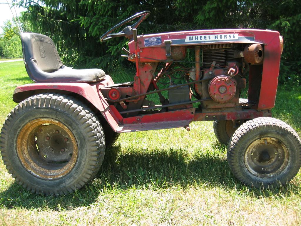

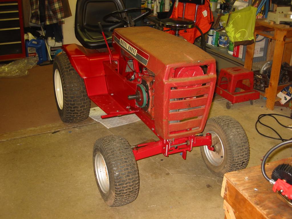

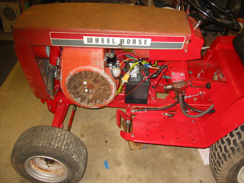

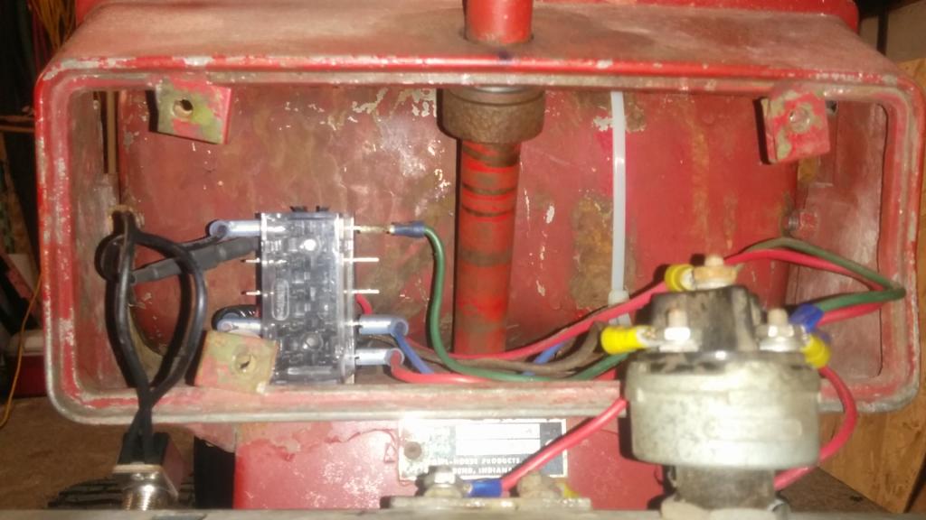

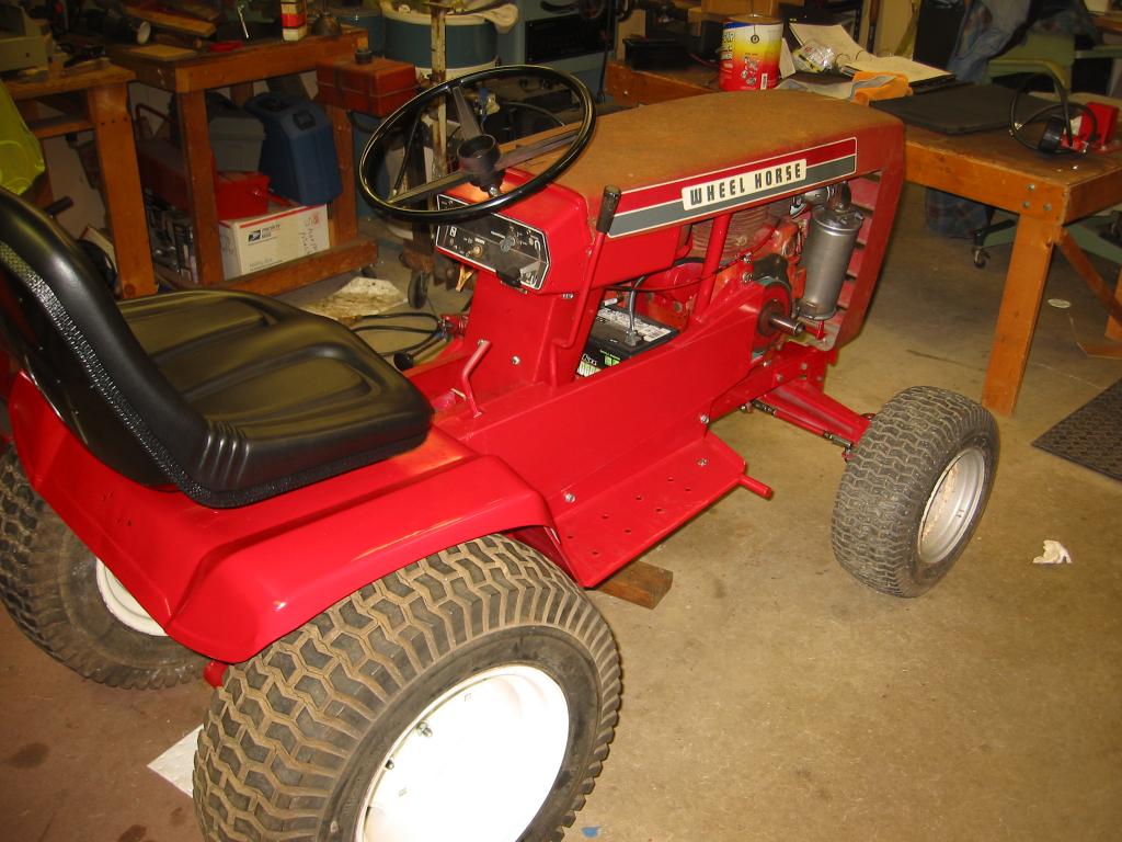

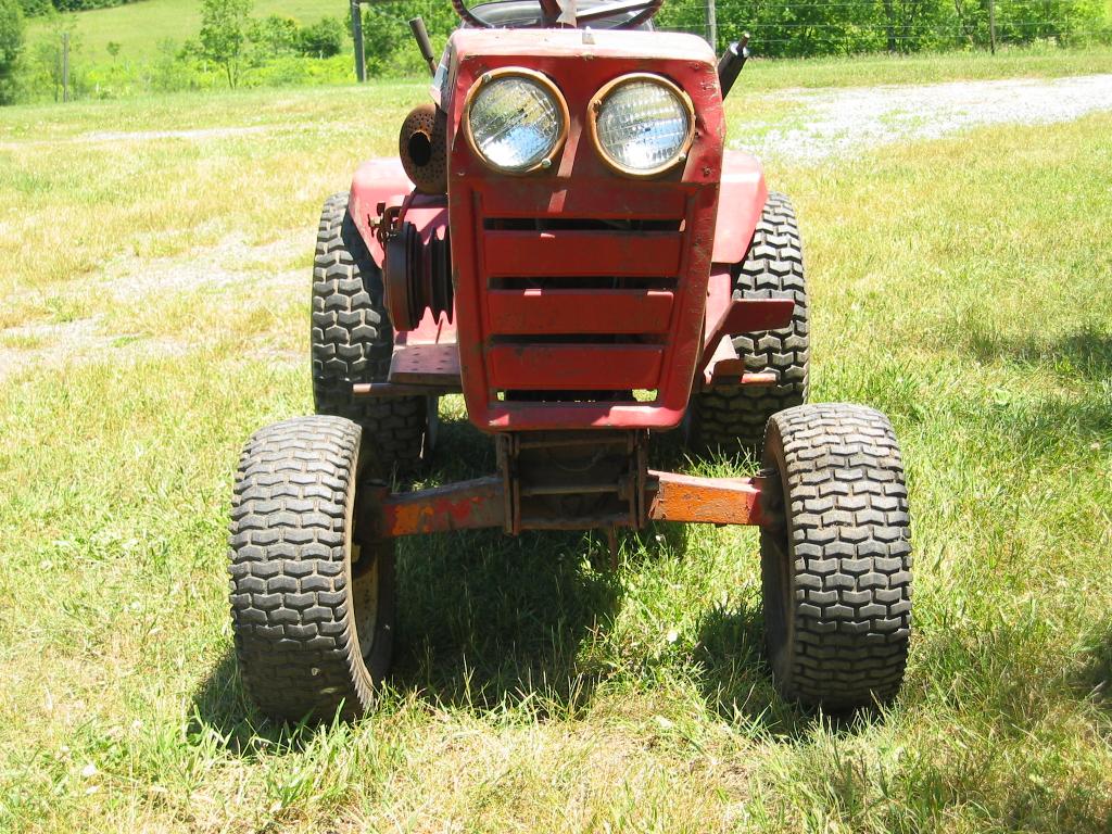

pfrederi 21,246 #3790 Posted December 28, 2019 Been getting some work done on "Ugly Charger" Just picked up a hood from AtoZ but this is not painting weather it will have to wait until spring. Came with a K341 which I had overhauled .010 over and .010 under on crank. Added Hydro lift. Haven't decided what her duties will be yet so i haven't decided to go manual or electric PTO. Before and now 2 6 Share this post Link to post Share on other sites
Pullstart 71,451 #3791 Posted December 28, 2019 Paul that looks fantastic, but the second picture should have come with warning! 3 Share this post Link to post Share on other sites
MikMacMike 494 #3792 Posted December 28, 2019 3 hours ago, pfrederi said: Been getting some work done on "Ugly Charger" Just picked up a hood from AtoZ but this is not painting weather it will have to wait until spring. Came with a K341 which I had overhauled .010 over and .010 under on crank. Added Hydro lift. Haven't decided what her duties will be yet so i haven't decided to go manual or electric PTO. Before and now Hahahah your right the second pic should be on the calender but specifically the holloweeny month hehehehh..... Its sure lookin good thopugh.....I sure would luv to get me hands on one of those electric clutches though dag nabber! 2 Share this post Link to post Share on other sites

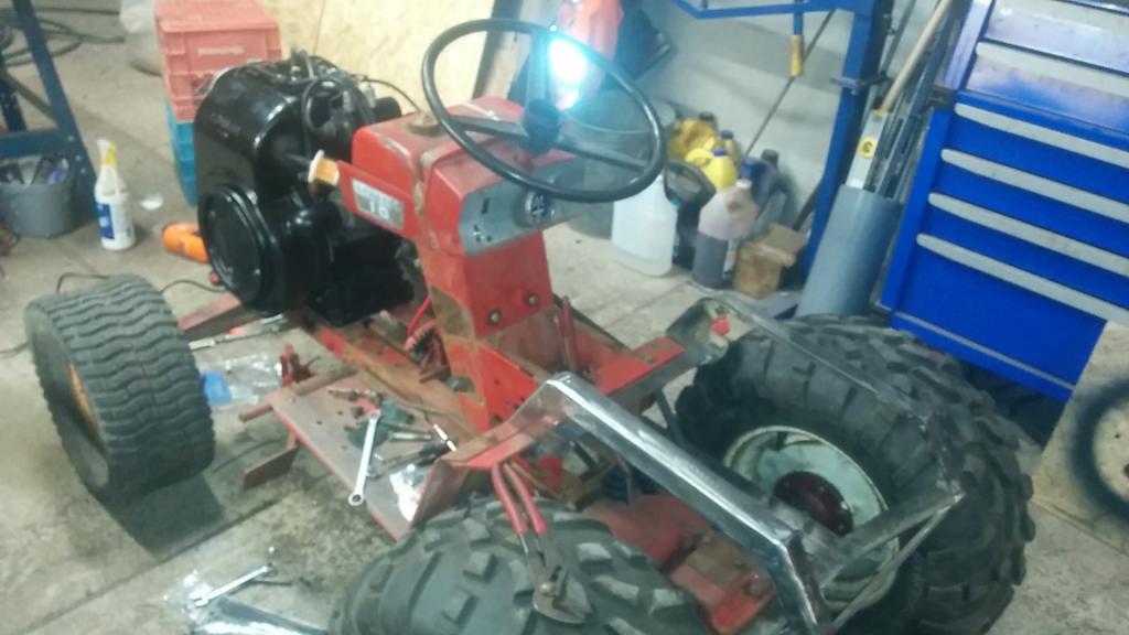

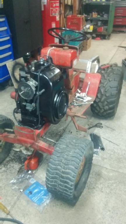

MikMacMike 494 #3793 Posted December 29, 2019 I think its slower working on the Wheel Horse then on my 4x4 hahahah, Got everything on the engine, painted it, redid all the wireing except headlights, they will be when I get the bonnet back on. I pulled 1 whole cup of flacky rust out of the gas tank, threw a pound of nuts n washers in her and filled 3 times with vinager. So it'll be I hope ok till Ebinmaines tank gets here. Hi 5 Ebinmaine for the tank brother. I also I hope got the stator, rectifier, and fuse panel installed, I hope its all good or we may have quite the smoke show hahahaha, It was a bit challenging getting the fuse panel behind the dash too, but now if I blow a fuse I dont have to remove the gas tank, 4 screws and off the sah panel comes. Almost everything was soldered,heat shrinked, and covered with GM wireing harnes covers left over from previouse jobs. I grounded the battery in 2 places, right to the head near the coil, and a;so right under the gas tank to the tower part of the body. Rebuilt the carb, it was solid shelac from sitting all those years. I did notice that the intake runner on the block was smaller then the #30 carb. Just a bit concerned about that, Down the road Ill have to match port them together so there is a smooth transmission and good flow, besides Im going to add a 3 inch runner between the carb and block for more heat isolation and also for better atomization, should be good for an extra persentage of Tork and well ya harsepower even though I dont concern myself with HP usually. Cleaned out the combuston chamber, torked the head and will retork after I do a 1st run. At least now I can get back to the sheet metal work on the back, closing it in for the future roughly 5.8 gallon gas tank. Im hoping to weld that up in stainless, will see?? The snows all melted from a week of fall weather so I havnt had the snow pressuring, thank you mother nature, but I know its coming and no doupt this year we will prob get seriousely dumped on even though maw natures been holding off. Its slow butits all coming together. 3 Share this post Link to post Share on other sites

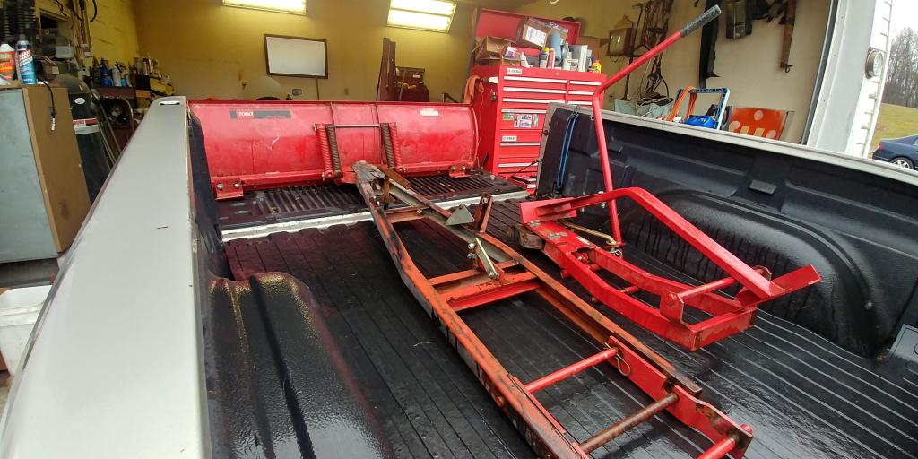

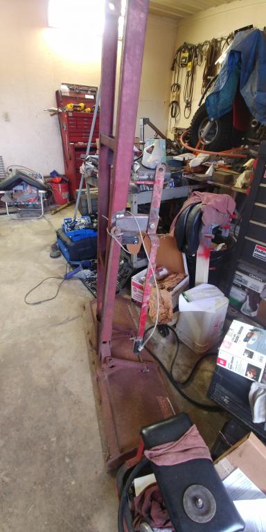

WVHillbilly520H 10,379 #3794 Posted December 29, 2019 Got 2 snow plows (42" for the 315-8 and a 56" for the 520H) nearly ready for winter weather if it actually ever shows up here. 3 1 Share this post Link to post Share on other sites

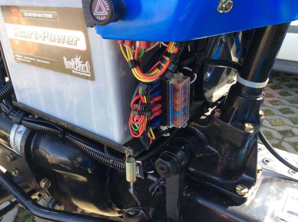

Tractorhead 9,217 #3795 Posted December 29, 2019 (edited) Lookin good 47 minutes ago, MikMacMike said: Lookin good so far Mike, but i would like to suggest, if your cabeling works, get a piece of wellflex pipe cut it on one side and put it arround at the cables close to the Steering shaft, to protect the cables a bit more against scratching. at least few ziptie‘s does also the trick, but mice or martens didn‘t like the Wellflex pipe, it‘s a good trick to protect your cabeling. My fail on the last car was, i forgotten to protect the Engine Controller Wires with that, so the Martens can „kill“ my Car. On the actual i did it immediately and the result seems to be right. you ain‘t buy it, if a scrapyard is near you, you can find in an robbed car, just a piece you can reuse. with few tiezip‘s it will be fixed and you‘ll be fine. In the lower pic aside the Starter And under Fuseholder left side you can see what i mean. behind the Steering hitch i also put them together into wellflex to protect. Edited December 29, 2019 by Tractorhead 1 Share this post Link to post Share on other sites
MikMacMike 494 #3796 Posted December 29, 2019 I didnt know what it was called, but I do have that wellflex through out everywhere else. Once the fuel tank is in the back under the seat, every bit of wire will be rerouted into a sealed box where the old gas tank sits....This is just temp for right now, not only because tank is being moved but I still have a ton of sheet metak work to do, both front..left and right side getting closed in and around where the gas tanks final resting place in the back, I plan on also making a sheet metal cab so there will be alot of over head wireing to be dun in the cab too, all guages are being reouted over the windshield, plus a wiper front and back. For now though it needs to be running for snow removal .......ahhhhhhh pressure hahahaha, You did an excellent job on your beasty there, eventually I hope to have mine far neater then it is. What tractor is that one? Looks so clean bruther. 2 Share this post Link to post Share on other sites
