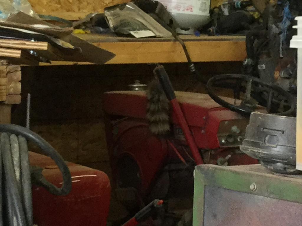

ACman 7,738 #11 Posted August 13, 2017 2 hours ago, Big_Red_Fred said: I need sum Fuzzy Dice above steering wheel Me being a true red neck I use a raccoon tail . 3 2 2 Share this post Link to post Share on other sites

Big_Red_Fred 1,548 #14 Posted August 16, 2017 @ACman Your work bench looks like mine at my shop, Hmmm, how did Clint Eastwood put it in Heart Break Ridge ? Cluster WHAT, did i just think that, i didnt think that ? LOL Share this post Link to post Share on other sites
ACman 7,738 #15 Posted August 16, 2017 The sad thing is this quadriplegic didn't do any of it but it seems that I'm the only one who knows where things are . Figure that one out ? 3 Share this post Link to post Share on other sites
WHX?? 57,470 #16 Posted August 16, 2017 @Achto any comments on the coon tail? 3 Share this post Link to post Share on other sites
Achto 32,124 #17 Posted August 16, 2017 Coon tail looks great @ACman. I need to get another one for my rat rod, mine fell a part.😞 Might try to get a big whip antenna to mount the new one on.😀 3 Share this post Link to post Share on other sites
