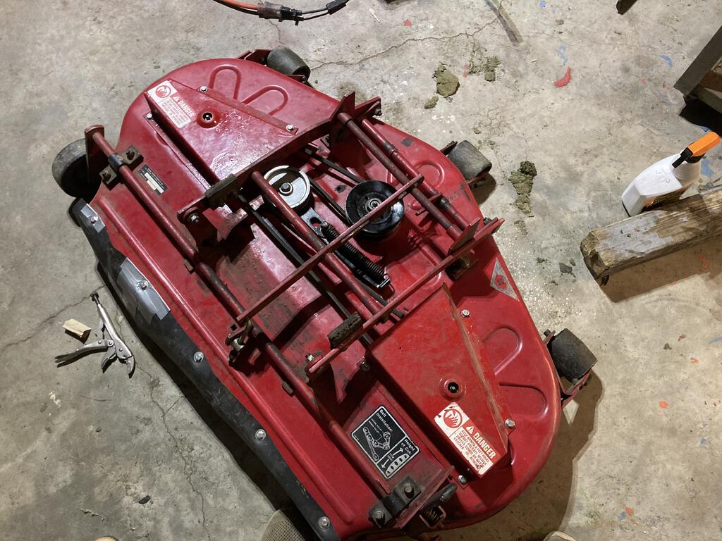

MainelyWheelhorse 3,208 #1 Posted May 23 Hi guys, I got my 42”RD back together and as stumped about how to adjust the belt tension. I assume the spring and plate that the idler rides on since it slides left and right, is the tensioner. Is it left somewhat loose to ride and slide with the belt or is it secured after sliding it over to tension it? It was tight before I took the idler and tensioner off but I assumed it was the PO possibly putting it together wrong. Currently there isn’t enough tension to have all three blades turn at once. I confirmed that with my father when he mentioned after seeing it working that the mule drive belt was going but the deck belt was not. Thanks! 1 Share this post Link to post Share on other sites

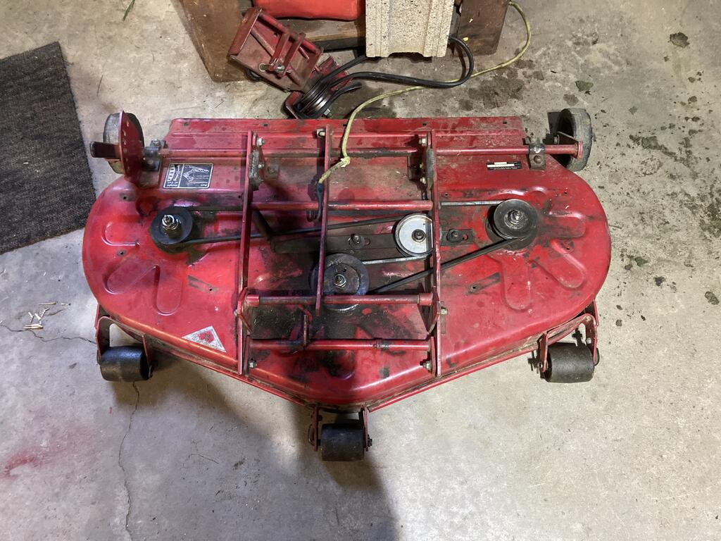

MainelyWheelhorse 3,208 #9 Posted May 23 1 hour ago, Bill D said: 89"x 1/2" belt. Please take a picture with the belt guards off. 11 hours ago, ineedanother said: I've never owned that deck but your routing looks correct. Are you sure you're using the correct belt and that it's riding in the pulleys under the guards correctly? The belt that’s on it is the one that was on it before I rebuilt it. It seemed to workfine then besides the spindles needing attention. It seems to be good pulley wise, as I spun it around before I put it back together. The belt didn’t come off or ride oddly in the pulleys. it just seemed a bit too loose. The routing is off the routing decal on the right of the deck. Share this post Link to post Share on other sites

ineedanother 2,885 #16 Posted May 23 16 minutes ago, MainelyWheelhorse said: @Handy Don Ok, it looked like it could slide, thanks for the confirmation. In the first pic the slide looks to be installed correctly and all the way to the tightest position which is why I suspected either the wrong belt length or it not being on one of the outer pulleys. I'm still leaning toward belt length being the issue. 2 Share this post Link to post Share on other sites

oldlineman 1,821 #18 Posted May 23 (edited) In your #9 post picture it looks like the slide has a little space for more movement tighter. I would clean area up good and check the plastic washer-spacers for condition and replace if necessary. Sellers on here have them . Not sure who I bought from,someone will chime in and refresh my memory. Glenn Petti had them # 107675 and # 107674 Edited May 23 by oldlineman 1 Share this post Link to post Share on other sites
sqrlgtr 4,224 #19 Posted May 23 3 hours ago, ineedanother said: In the first pic the slide looks to be installed correctly and all the way to the tightest position which is why I suspected either the wrong belt length or it not being on one of the outer pulleys. I'm still leaning toward belt length being the issue. I concur spring looks to not have any tension on it and slide looks to be in the tightest position. Belt to long looks to be problem. 1 Share this post Link to post Share on other sites
MainelyWheelhorse 3,208 #20 Posted May 23 (edited) @953 nut @ineedanother @ICONN @squonk @Bill D @peter lena @sqrlgtr@midpack @Handy Don @oldlineman Thanks for the help guys. Now I know how the tensioner is supposed to work. It was too tight so the spring wasn’t engaged and it couldn’t slide to tension up the belt. I went back to re tighten and check the tensioner to make sure it worked. I also redid the routing and the belt tightened right up. It seems to mow great now just like it did before. Now, with an eighth of the noise. The forum came through again! Edited May 23 by MainelyWheelhorse 1 7 Share this post Link to post Share on other sites
