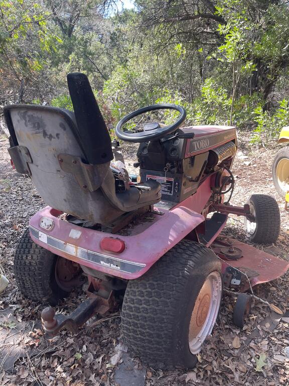

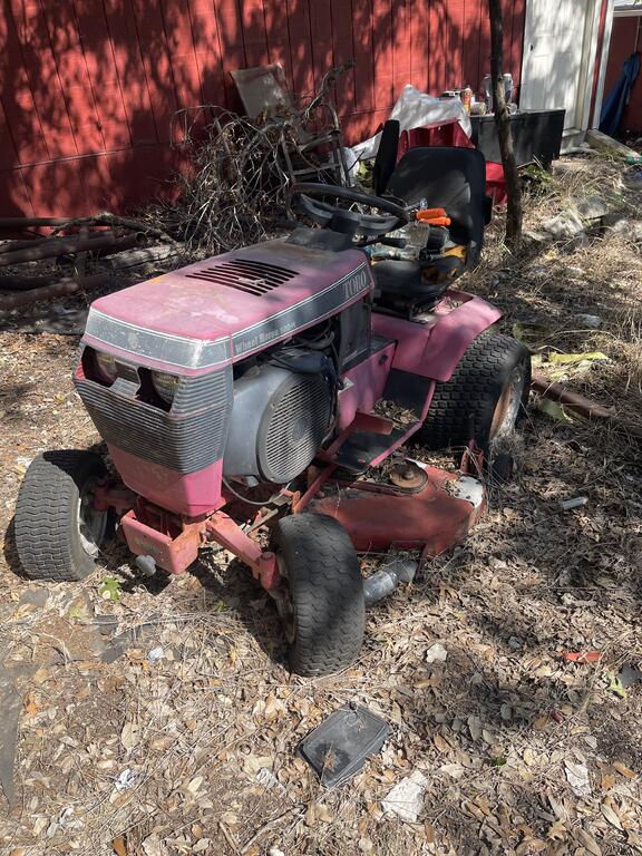

oliver2-44 11,750 #1 Posted October 15, 2025 So I know how much yall like these “what’s it worth threads 2 weeks ago at a tractor show I was talking with a fella on a WH B80. He said he had this 520H that he hadn’t done anything with since about the same time he got a running Cub. It sat 5 years before he got it and it has sat another year for him. Of course I had to ask if it was for sale or trade for something. I’ve been looking for something with an Eaton Hydro. This is the first one I’ve come across within a few hours from me. Not sure this is the one or not, appreciate yalls comments. Notice front hood at lights bent, hole patched in deck and shot seat. What else do yall see? This comes up as a 1993 model, so it would have the forward swept front axle and the gear reduction steering which I want. (I was lazy and used ChatGPT to look it up for me) If the engine is toast I would put a 16 hp Kohler K341 in it. Rear axles don’t look like they are leaking in this picture. Does the 520 have a mechanical hour meter that can be read anytime, or a digital electronic one? Tractor doesn’t look to to rusty, even has 4 rusty hubcaps. But I suspect it would get worker painted over time. 5 Share this post Link to post Share on other sites
Easton Rich 1,260 #2 Posted October 15, 2025 I love my 520. They have mechanical hour meters, but I wouldn’t gets your hopes too high on that one working… If the engine is good that P220 Onan is a great strong motor. Check spark, the have a little module that commonly goes bad. Share this post Link to post Share on other sites
kpinnc 18,960 #3 Posted October 15, 2025 The 520-H is a beast. If the engine requires any major work, then a K341 repower would be a great idea. My last 3 builds are derivatives of a 520 in some form. Two are 8 speeds but all three have the swept axle and anything I could shoe horn into it. My last 520-H is in a sad state with the Onan having electrical issues but otherwise solid. It will likely get a repower and another foot control, but retain it's worker status. Even if that Onan is junk the rest of the machine has alot to offer. Of course it's current state plays advantage to a buyer. I can't speak for your area, but $200-300 would be all it is currently worth to my wallet. At least then even if you had a bad engine and a bad tranny the parts could still recoup your money. 2 Share this post Link to post Share on other sites
ebinmaine 80,695 #4 Posted October 15, 2025 I look at a non runner as a "parts" value. That way even if the machine doesn't work for me I can recoup. Splayed forward front axles & gear reduced steering setups are getting $400 - $450. The wiiiiide rear wheels are worth another $150 or so. IMHO that's a $600 value in parts MINIMUM. 4 Share this post Link to post Share on other sites
ri702bill 13,060 #5 Posted October 15, 2025 38 minutes ago, ebinmaine said: that's a $600 value in parts MINIMUM. To the right buyer. Still have to factor in the true cost of ownership - transportation, disassembly, shipping, etc. Time is money - I agree with Eric that a non-runner is just a parts machine, nothing more. Go with a lowball offer or walk away. 7 Share this post Link to post Share on other sites
953 nut 69,299 #6 Posted October 15, 2025 2 hours ago, ri702bill said: Go with a lowball offer or walk away. 9 hours ago, oliver2-44 said: he hadn’t done anything with since about the same time he got a running Cub. It sat 5 years before he got it and it has sat another year for him. The fact that it is, and probably has been, sitting outside would tell me to avoid it unless my intention was to part it out. Engine and Eaton could both have water in them and the wiring has probably been chewed up. The seller probably attempted to get it running and let it sit because he figured out it was a money pit. If you want a 520 you would probably be ahead of the game to take a long road trip to pick up a good one. The time and money you would dump into this one will be more than the cost of the round trip and a good runner. 5 Share this post Link to post Share on other sites
Ed Kennell 47,322 #7 Posted October 15, 2025 Looks like a $200 parts machine to me. 5 Share this post Link to post Share on other sites
ebinmaine 80,695 #8 Posted October 15, 2025 19 minutes ago, Ed Kennell said: Looks like a $200 parts machine to me. Times like this I get a little envious of you guys down in Pennsylvania and surrounding areas. I've never seen a machine with gear reduction and a forward swept axle for less than $400 and I can honestly say that was several hundred miles away and had no engine. Share this post Link to post Share on other sites
MainelyWheelhorse 3,133 #9 Posted October 15, 2025 (edited) 6 hours ago, ebinmaine said: I look at a non runner as a "parts" value. That way even if the machine doesn't work for me I can recoup. @oliver2-44 Same here, unless I get ambitious and bring it back from the dead. right @ebinmaine 😁 It helps too to have more than one of the same model (ex 3/4/500’s) then there’s a good reason to buy it as the parts can be put to good use. Edited October 15, 2025 by MainelyWheelhorse 1 Share this post Link to post Share on other sites
ri702bill 13,060 #10 Posted October 15, 2025 32 minutes ago, MainelyWheelhorse said: It helps too to have more than one of the same model (ex 3/4/500’s) then there’s a good reason to buy it as the parts can be put to good use. The C81 I bought from @Sparky this summer is just an example.I got it at a fair price knowing there were missing parts and numerous issues from the neglect / hack fixes of the previous owner. I already had its identical twin, a roller that I have had apart for years. That one gave up some parts for the new one.... 4 Share this post Link to post Share on other sites
oliver2-44 11,750 #11 Posted October 15, 2025 (edited) Seller just text me it has 405 hours on meter. Of course has the meter worked in its later years. Im leaning towards trying to trade him some implements I have multiples of and treat it as a parts machine. If he bites he’s would actually be helping me get stuff out of the barn. Edited October 15, 2025 by oliver2-44 3 2 Share this post Link to post Share on other sites
ebinmaine 80,695 #12 Posted October 15, 2025 1 hour ago, oliver2-44 said: Seller just text me it has 405 hours on meter. Of course has the meter worked in its later years. Im leaning towards trying to trade him some implements I have multiples of and treat it as a parts machine. If he bites he’s would actually be helping me get stuff out of the barn. That's a "no lose" situation for you 1 Share this post Link to post Share on other sites
MainelyWheelhorse 3,133 #13 Posted October 15, 2025 4 hours ago, ri702bill said: The C81 I bought from @Sparky this summer is just an example.I got it at a fair price knowing there were missing parts and numerous issues from the neglect / hack fixes of the previous owner. I already had its identical twin, a roller that I have had apart for years. That one gave up some parts for the new one.... I did kinda the same with the C-85 I bought from @JCM at the M&G this year. I liked the look of the black hoods An added plus too is it’s mechanically similar enough to what I already have, that if I don't make it a runner. The majority of the parts on it can be donated to any of the others. So far it’s more complete than the C-141 was so it would make a good runner. 4 Share this post Link to post Share on other sites
sqrlgtr 3,930 #14 Posted October 16, 2025 I wouldn't give over $10 for it. PM me his name address and number and I will talk to him about it for you no charge.... On 10/15/2025 at 8:21 AM, ebinmaine said: Times like this I get a little envious of you guys down in Pennsylvania and surrounding areas. I've never seen a machine with gear reduction and a forward swept axle for less than $400 and I can honestly say that was several hundred miles away and had no engine. I know how you feel eb, guess that's why i went a little over board at the Big Show in PA. 1 1 Share this post Link to post Share on other sites
cheesegrader 436 #15 Posted October 18, 2025 He should pay you to haul that out of his yard! What has value here? Engine is 0 Electrical components are 0 Transmission is?. Has not run in 6 years, and was left outside. Tins look bad. Tires look bad. Deck is bad. Running 520's can be had for $500. Nice, well kept 520's are $8-900. This thing is a money pit. The salvageable pieces-frame, axle, steering components-are the easy to find parts off any old abused roller. 2 Share this post Link to post Share on other sites

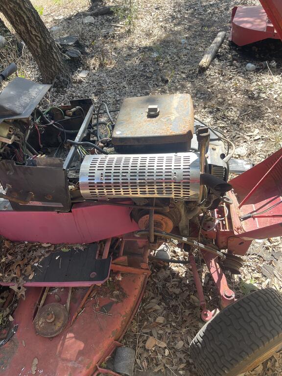

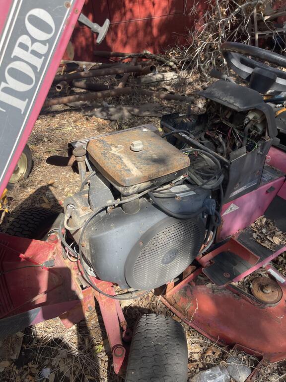

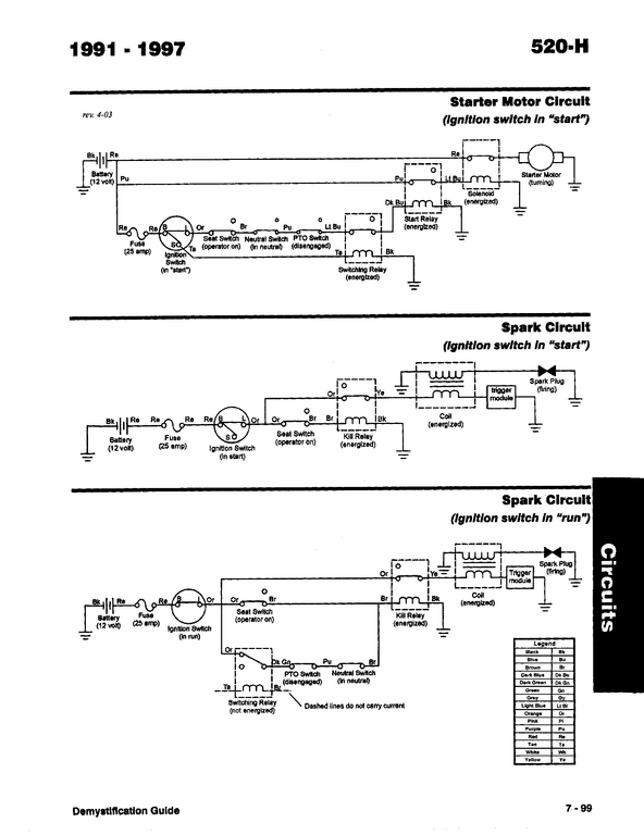

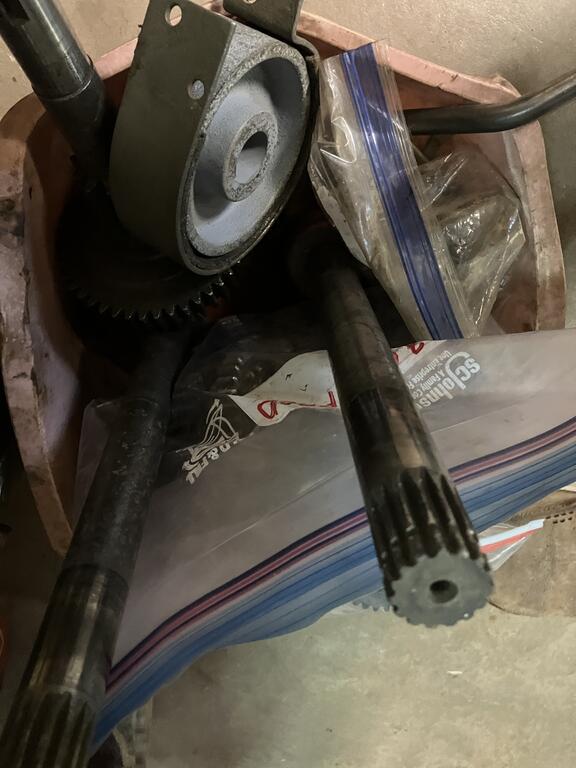

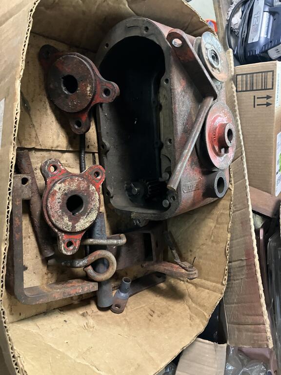

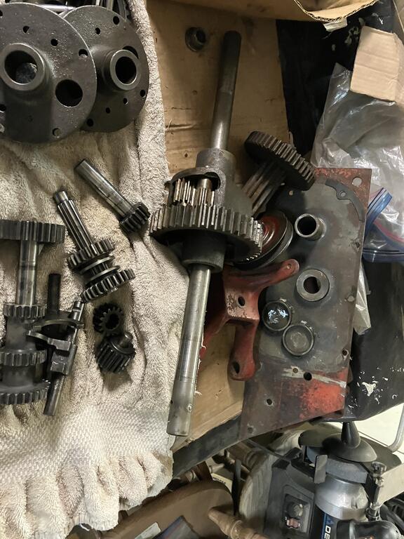

oliver2-44 11,750 #16 Posted April 17 He was looking for a tiller, of which I have 2. So previously, I had offered him a tiller with everything to hook it up including a new belt and he add a little cash to the deal. He didn't bite at that time. He called last night and really wants the tiller. Said he would throw in a disassemble 3 speed and a disassembled 3 piece transmission. Said "Most" of the gears and shafts are good???? Pictures coming!!! He's passing through the area where the farm is in a few days and would leave it there on a trailer for a few days for me to check it out until he returns. I certainly could use some transmission parts if they check out OK, and Im thinking of the tractor as a parts machine, (sweep axle, gear reduction steering, foot rest, and seat pan) so were moving forward with that plan. I've never worked on or even seen a 520H so I need some help from the 520 experts. @953 nut @kpinnc others? I would like to jumper the electrical to the basic's to see if it will run and move. (if it will run and move deal, if not, add cash) I've downloaded the Electrical Demystification guide and am still a little "Mistified" I think the page below are the basic circuits I need to jumper to make it run. On a K-Kohler I would just jumper power directly to the coil and to the solenoid. Since thinks are buried on this engine help me with what wires I need to jumper to. 1 Share this post Link to post Share on other sites
kpinnc 18,960 #17 Posted April 17 2 hours ago, oliver2-44 said: would like to jumper the electrical to the basic's to see if it will run and move. There may be a way to bypass certain things to get there, but I must admit the 520-H electrical "mystifies" me as well. The starter solenoid is on the starter body itself. Not sure if you could go to it directly or not. The coil also has to be energized. My last 520 is about to become a donor machine as I believe the stator is cooked and I am tired of working on Onans. My apologies for having no better option for you. 1 1 1 Share this post Link to post Share on other sites
lynnmor 9,040 #18 Posted April 17 Quick and dirty: Make up two jumpers preferably with 30 amp fuses. Connect one from battery + terminal to coil + terminal Connect the other from the battery + terminal and touch the starter small connector with the blue wire to crank the engine. Do not leave either on for any approachable time. 2 1 Share this post Link to post Share on other sites
sqrlgtr 3,930 #19 Posted April 17 56 minutes ago, lynnmor said: Quick and dirty: Make up two jumpers preferably with 30 amp fuses. Connect one from battery + terminal to coil + terminal Connect the other from the battery + terminal and touch the starter small connector with the blue wire to crank the engine. Do not leave either on for any approachable time. This is great info, I've never tried this but good to know you can bypass everything just to see if one will run. 1 1 Share this post Link to post Share on other sites
oliver2-44 11,750 #20 Posted April 18 6 hours ago, lynnmor said: Quick and dirty: Make up two jumpers preferably with 30 amp fuses. Connect one from battery + terminal to coil + terminal Connect the other from the battery + terminal and touch the starter small connector with the blue wire to crank the engine. Do not leave either on for any approachable time. Thank You Can I leave the coil jumper connected if engine if the engine starts and is running 1 Share this post Link to post Share on other sites
lynnmor 9,040 #21 Posted April 19 22 hours ago, oliver2-44 said: Thank You Can I leave the coil jumper connected if engine if the engine starts and is running You could, just be prepared to remove it when the engine stops. 1 1 Share this post Link to post Share on other sites
oliver2-44 11,750 #22 Posted June 13 (edited) On 4/17/2026 at 3:44 PM, lynnmor said: Quick and dirty: Make up two jumpers preferably with 30 amp fuses. Connect one from battery + terminal to coil + terminal Connect the other from the battery + terminal and touch the starter small connector with the blue wire to crank the engine. Do not leave either on for any approachable time. After a few cranks, it fired up on carb cleaner sprayed in the carb and rad good (for a rough check) I had it jacked up to change the rear tires, so kept spraying/running and moved the hydro control lever forward and backwards and hub rotates as they should. So theirs signs of life, maybe, just maybe the 400 hrs on the meter is real. A part of the deal I got a pile of 3 piece and 2 piece 3 speed transmission parts. #/4 of them are good, some are pitted or chipped . The complete 3 piece transmission has interesting damage, if only it could talk! Who knowns what went through it to break this bearing holding ring The case and hubs and pullies are good. This other side plate was good. This is a "newer style diff that I guess was in the 3 piece transmission. There are also parts to another 2 piece 3 speed. some good, some pitted. Here a close up of that diff with a corner chippe dout The axles need to be flipped, they have heavy wear in the bushing area. More parts and more parts. So for trading a tiller that I had 2 of sitting in the barn I feel I make out great. I really needed some transmission parts for various projects. I thing I can build a really good 3 piece transmission if i repair or replace that side plate, and a really good 2 piece 3 speed with another transmission I have that needed parts. There probable another so/so 2 piece transmission in the pile of parts. While the 520H is rough in some aspects, It give me one to learn on since it is the first 520h I've seen down here in 10 years. Its 48" deck has a rust hole near the discharge but turns free. If nothing else, as @ebinmaine said, If it becomes parts, the gear reduction steering, seat pan, wide rear rims, and some other parts have value to me. Edited June 13 by oliver2-44 4 Share this post Link to post Share on other sites
953 nut 69,299 #24 Posted June 13 On 4/17/2026 at 11:40 AM, oliver2-44 said: I've never worked on or even seen a 520H so I need some help from the 520 experts. @953 nut @kpinnc others? I would like to jumper the electrical to the basic's to see if it will run and move. Sorry I missed this tag earlier but the guidance that @lynnmor gave you was right on the money. Sounds like you came out of this deal smelling like a rose If you think the 520-H wiring is confusing you need to look at the Lxi and XT versions with a Kawasaki engine and the "NO-MOW in REVERSE" wiring. On second thought, don't do it, that would ruin your day. 1 1 Share this post Link to post Share on other sites
