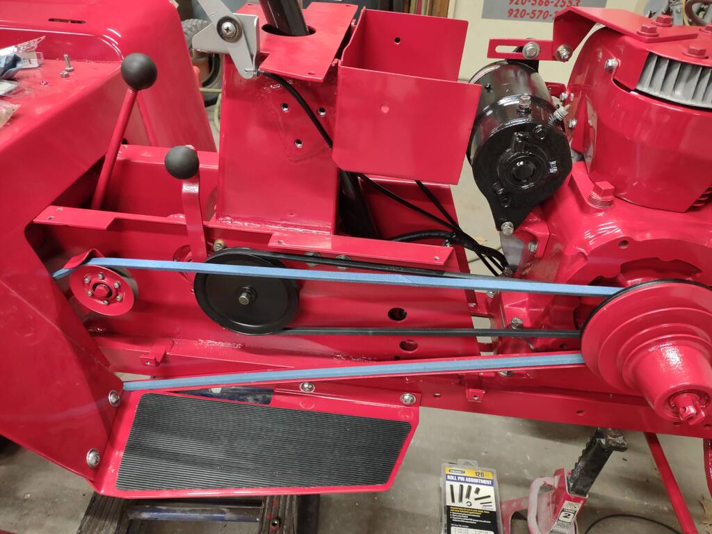

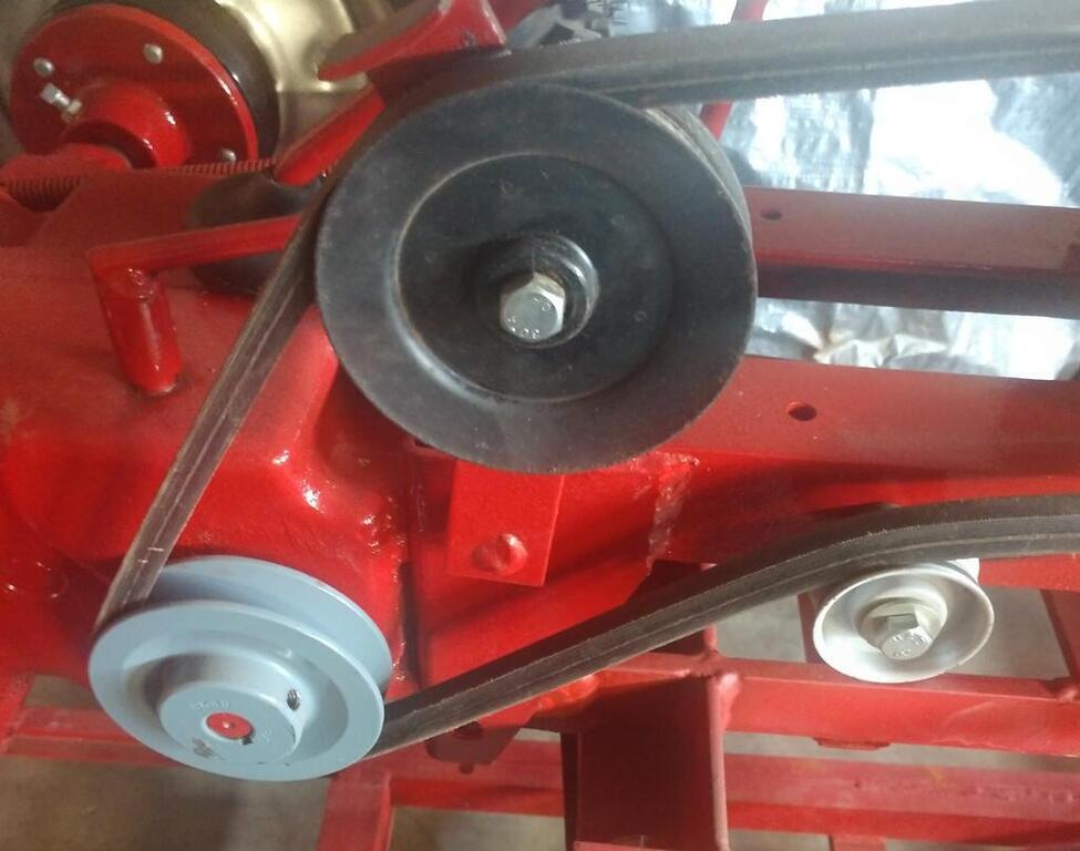

SylvanLakeWH 32,532 #52 Posted April 14, 2025 @Ed Kennell and @953 nut either of you have a picture of how the "stop" bar above the clutch pulley attaches to the pulley arm? I ran it tonight and I will definitely need either that bar or something like it to stop the belt to change gears... Other ideas welcome... Dan was this your thinking on this comment?: On 4/10/2025 at 7:03 AM, Achto said: How about throwing out a request for clutch / brake shaft & ends for a square hood. Should turn this into a bolt on application. @Achto @Pullstart @oliver2-44 @ebinmaine @WHX?? ? 2 Share this post Link to post Share on other sites

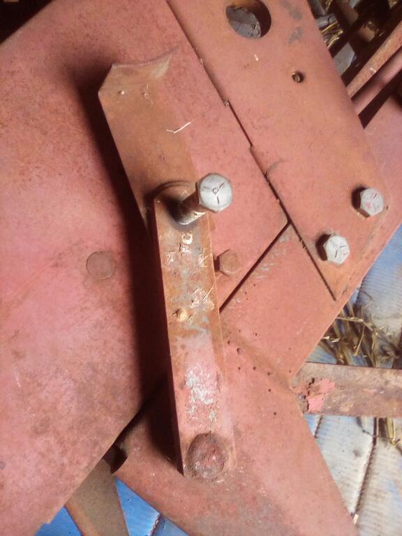

Easton Rich 1,260 #56 Posted April 14, 2025 If you pay shipping its yours 2 1 Share this post Link to post Share on other sites

Achto 32,725 #58 Posted April 14, 2025 (edited) 12 hours ago, SylvanLakeWH said: how the "stop" bar above the clutch pulley attaches to the pulley arm? A recipe to make 1 belt brake for the idle pulley: 1 piece of 16g sheet metal about 1" to 1 1/2" x 4" 1 drill & 3/8" drill bit 1 vise 1 hammer 1 metal cutting devise Cut, drill & bend to fit your application. A pic of the one on my 953 Edited April 14, 2025 by Achto 2 2 1 Share this post Link to post Share on other sites
SylvanLakeWH 32,532 #59 Posted April 14, 2025 Thanks Dan! I'll get my apron on and get cooking... Is yours attached with just the pulley bolt for easy adjustment or did you add another bolt to the pulley arm? 2 Share this post Link to post Share on other sites
Achto 32,725 #60 Posted April 14, 2025 7 minutes ago, SylvanLakeWH said: Is yours attached with just the pulley bolt for easy adjustment or did you add another bolt to the pulley arm? I do believe that one is welded to the arm. Using the pulley mounting bolt will work well too. 1 1 Share this post Link to post Share on other sites

Easton Rich 1,260 #63 Posted April 14, 2025 Since its welded on there from stock I could cut it very low if you wanted or if anyone knows how to get it off?? The picture isn't great but really all it needs is sand primer paint 1 1 Share this post Link to post Share on other sites
SylvanLakeWH 32,532 #64 Posted April 14, 2025 3 minutes ago, Easton Rich said: Since its welded on there from stock I could cut it very low if you wanted or if anyone knows how to get it off?? The picture isn't great but really all it needs is sand primer paint Thanks! Very helpful to see angle and curve... Im going to try to make one, based on yours and others pictures and Achto's recipe... Ill keep you posted on how it goes... And Happy Birthday!!! 3 Share this post Link to post Share on other sites

Ed Kennell 47,368 #66 Posted April 14, 2025 I couldn't find mine Jim. You have a good pic of the welded one. The adjustable style just had a drilled hole for the bolt and was on the other side of the lever. I think there was a spacer between the pulley and the belt brake piece. 1 1 Share this post Link to post Share on other sites
SylvanLakeWH 32,532 #67 Posted April 14, 2025 37 minutes ago, Ed Kennell said: I couldn't find mine Jim. You have a good pic of the welded one. The adjustable style just had a drilled hole for the bolt and was on the other side of the lever. I think there was a spacer between the pulley and the belt brake piece. Thanks for checking and the feedback. I think I have enough to go on... I'll be searching the "parts department" tonight and see what I come up with. 1 Share this post Link to post Share on other sites

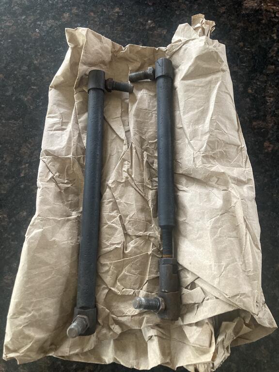

SylvanLakeWH 32,532 #70 Posted April 16, 2025 Tie rods on... Thanks @ebinmaine!!! Kinda stuck on the belt brake idea... mulling it over... Bit of thinking about the brake connector... might have that figured out... 3 1 Share this post Link to post Share on other sites

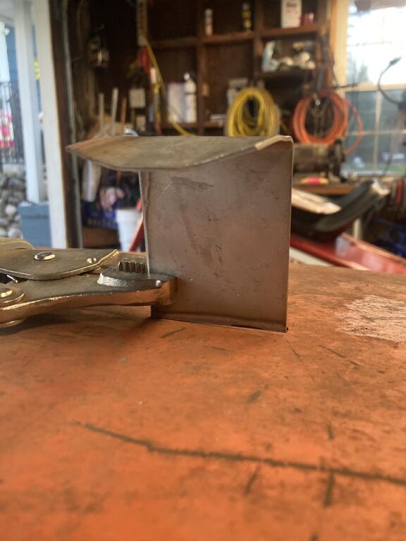

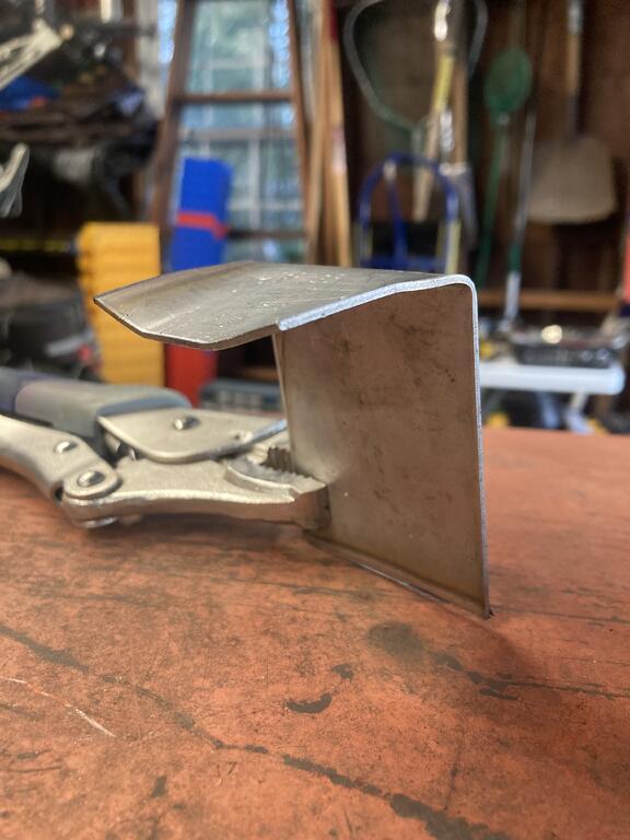

SylvanLakeWH 32,532 #73 Posted April 17, 2025 Started fab work on a belt brake... used Dan's recipe. Belt jumps right off if clutch depressed all the way, so I'll need something for that as well... thinking idler and / or guides on the belt guards... 4 2 Share this post Link to post Share on other sites
953 nut 69,345 #74 Posted April 17, 2025 11 hours ago, SylvanLakeWH said: Belt jumps right off if clutch depressed all the way, Is there a runner of some sort under the lower half of the belt to catch the slack when the clutch is depressed? 1 Share this post Link to post Share on other sites
SylvanLakeWH 32,532 #75 Posted April 17, 2025 12 minutes ago, 953 nut said: Is there a runner of some sort under the lower half of the belt to catch the slack when the clutch is depressed? That's next... either incorporated into the belt guard or a idler pulley... kinda like @kpinnc suggested in post 23: I know Kevin would have already had this on the road and then put up on the shelf by now, but I am taking the more Colossus approach, routed in Maine's deep woods philosophical WH Guru @ebinmaine - "No Tractor before it's time..." now, where did I put that clock? 1 4 1 Share this post Link to post Share on other sites
