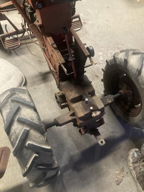

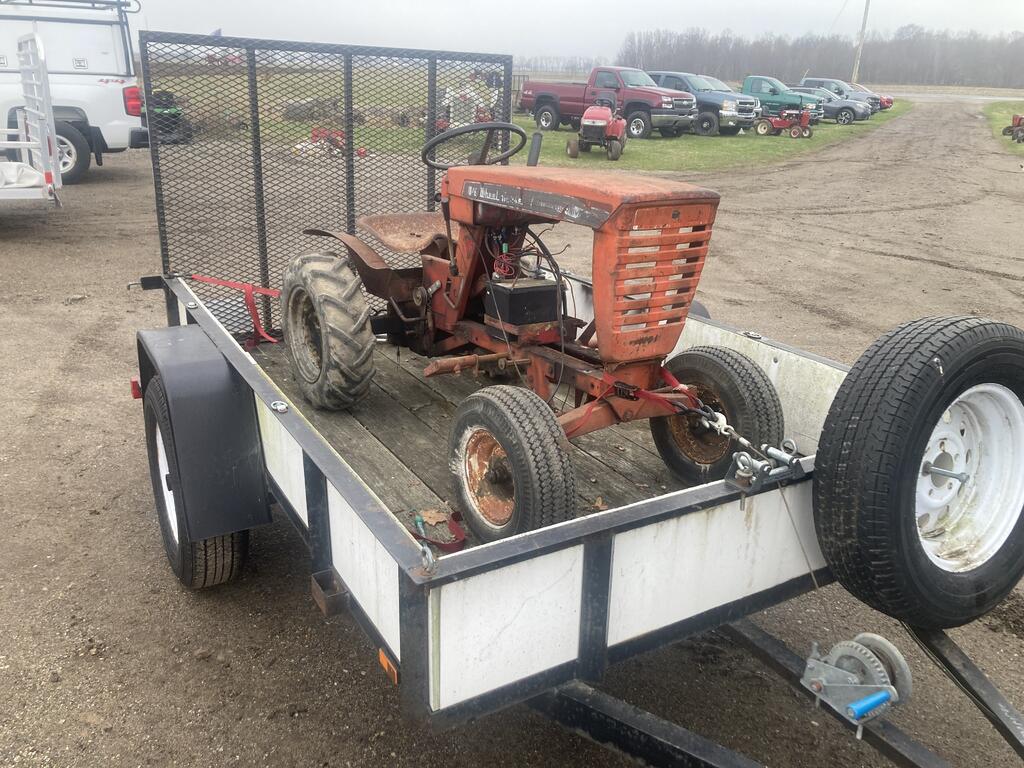

SylvanLakeWH 32,921 #1 Posted March 31, 2025 (edited) So, I stop by @Pullstart's Plow Day Saturday to get one of his tractors dirty and stuck, and this jumps into my trailer with a bunch of extra tie rods that don't fit, belt guards that don't fit (imported from Wisconsin by @WHX?? with a more than able assist from @Achto who, more importantly, brought cheese curds!) hand tight lug bolts and a slew of inappropriate cuss words about the virtues of my new little filly from said belt guard guy... Seems this was once a fine young , fully intact and owned by @Lil’ Pullstart, who for reasons unknown, sold it to pullstart, who proceeded to disembowel it for other projects... It was restored to roller status with a manual 3speed of unknown origins, seat fender tool box from an unsuspecting that thought pullstart was taking it on a date, and a swift kick in the rear end... Here's where I enter the picture... looking for a fine roller specimen to repower for fun, this is the best to be had north of the big show, apparently... So I get her on consignment to "have fun" and then "at some point" it goes back to pullstart stables for an unknown future... only rules: save all the parts and NO PAINT... The name? Thought you'd never ask... WHAMMC3PO_ - Wheel Horse Auto Manual Mutant Consignment 3 PO_. 3 is for the manual transmission and PO_ is what @WHX?? named it...with ample additional edited descriptive verbiage , edited of course for little ears... No relation to any droid in Star Wars and yes Luke, Kevin is it's father... More to come, maybe... Oh, this was the used tractor salesman I got it from... Edited March 31, 2025 by SylvanLakeWH 1 15 1 Share this post Link to post Share on other sites

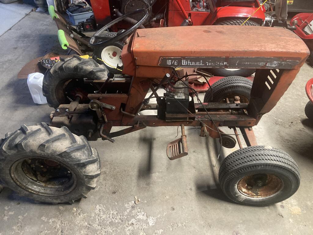

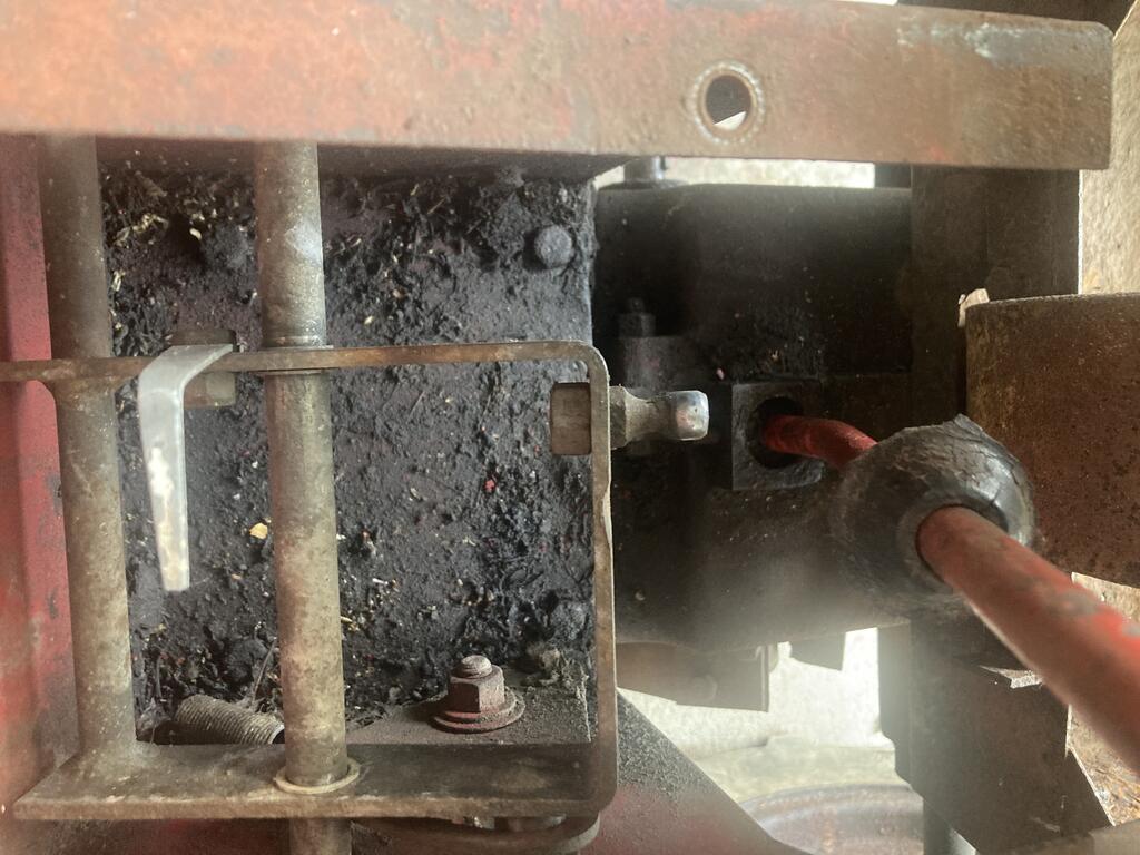

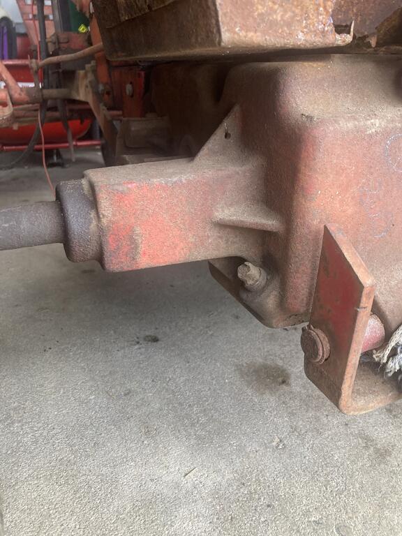

SylvanLakeWH 32,921 #16 Posted April 2, 2025 (edited) Little progress tonight. Verified transmission goes into all 4 gears and is pretty darn quiet. Have not drained / flushed yet. Work / family stuff limiting my priorities... From what I could see through the shifter hole the gears look pretty good. I am keeping good to my promise not to disturb the ruggedly handsome good looks of this ... nothing cleaned or primped... Regarding power: I am not going electric. Decision now is gas or diesel and diesel sounds (pun intended) like a better plan in keeping with the overall look and feel I'm aiming for... more to come on that... The auto linkage will be interesting to address with the 3 speed manual... I'm either going to use it as a hand clutch or swap out with what's on the Suburban yard art... input welcome. Pic of yard art last... All for now! Yard Art: Edited April 2, 2025 by SylvanLakeWH 3 2 Share this post Link to post Share on other sites
Pullstart 71,561 #17 Posted April 2, 2025 I do believe that clutch setup should work. Maybe a little creative work to get the throw correct, but they are very similar in design to the later model3 speeds. 4 Share this post Link to post Share on other sites
953 nut 70,654 #18 Posted April 2, 2025 11 hours ago, SylvanLakeWH said: auto linkage will be interesting to address with the 3 speed manual... I'm either going to use it as a hand clutch or swap out with what's on the Suburban yard art... input welcome. I have seen a few built with a safety clutch using the implement lift lever to actuate the clutch and spring loaded to disengage when released. Those grandkids are getting older so you need to build this so they can learn to drive. 2 2 Share this post Link to post Share on other sites
SylvanLakeWH 32,921 #19 Posted April 2, 2025 Not sure this one will be kid friendly yet... I have C series floor boards from Kevin's magic shed, but they look pretty funky with the round fenders... if I can't totally isolate little feet and hands from the rear tires and belt they won't be driving this one... 4 Share this post Link to post Share on other sites

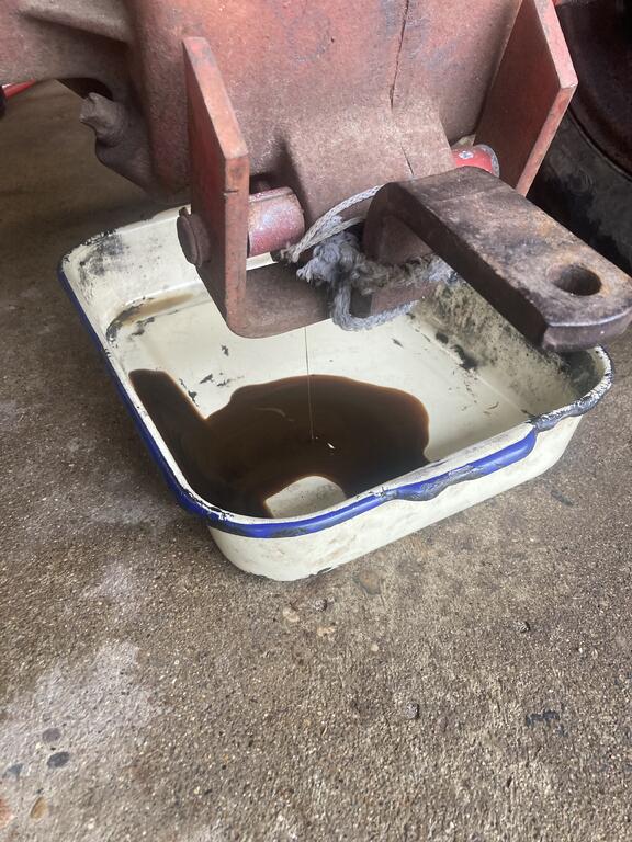

SylvanLakeWH 32,921 #20 Posted April 3, 2025 (edited) Drained trans... not much oil and no water... and no metal shavings!!! Flushed once... letting it drain overnight. Then will refill with oil... Whats the capacity on this thing? Just go till it comes out fill plug? If so, that's about 1 quart based on flush. Edited April 3, 2025 by SylvanLakeWH 3 Share this post Link to post Share on other sites
Pullstart 71,561 #21 Posted April 3, 2025 I either jack up the left side a bit to stuff 2 quarts in, or fill it through the shifter hole. I like more oil than less (generally speaking, however I never ran this transmission). 2 1 Share this post Link to post Share on other sites

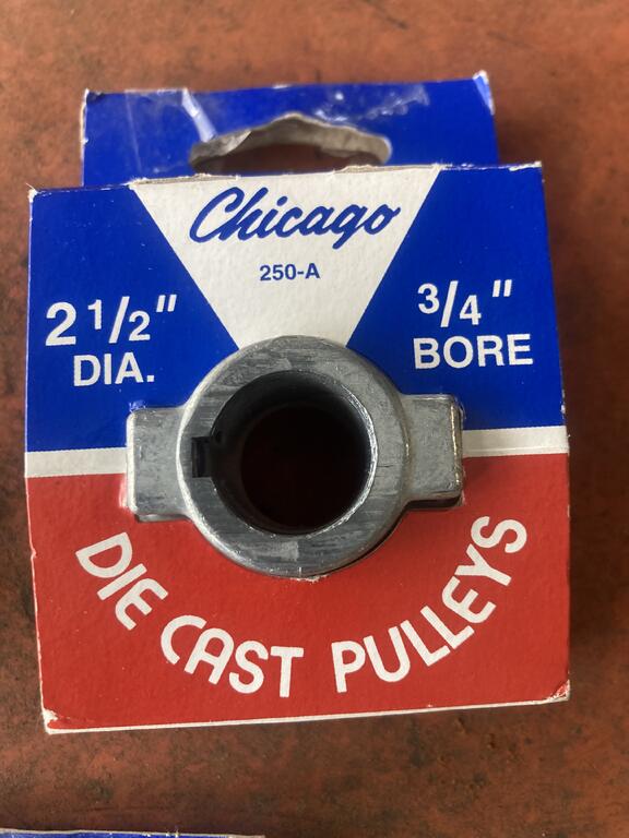

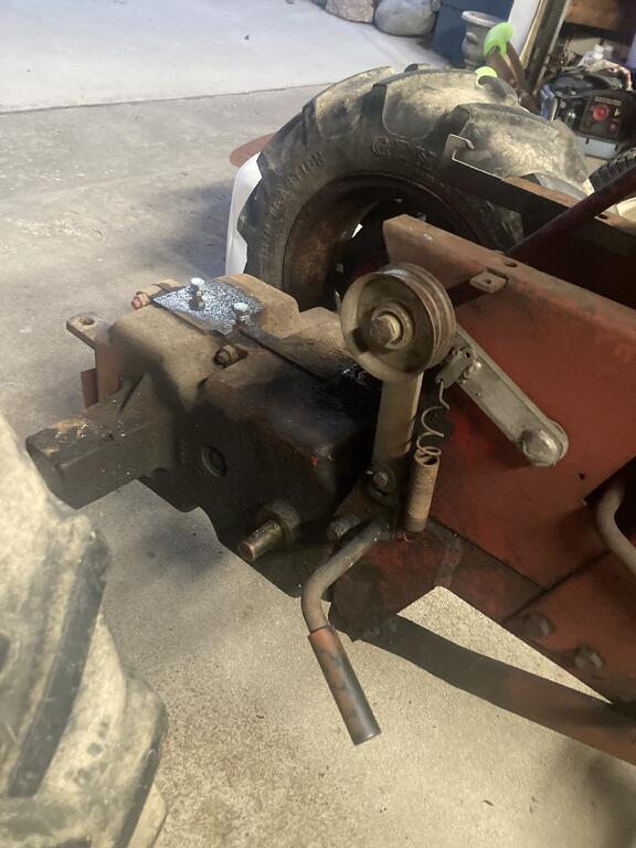

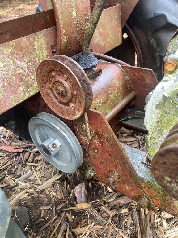

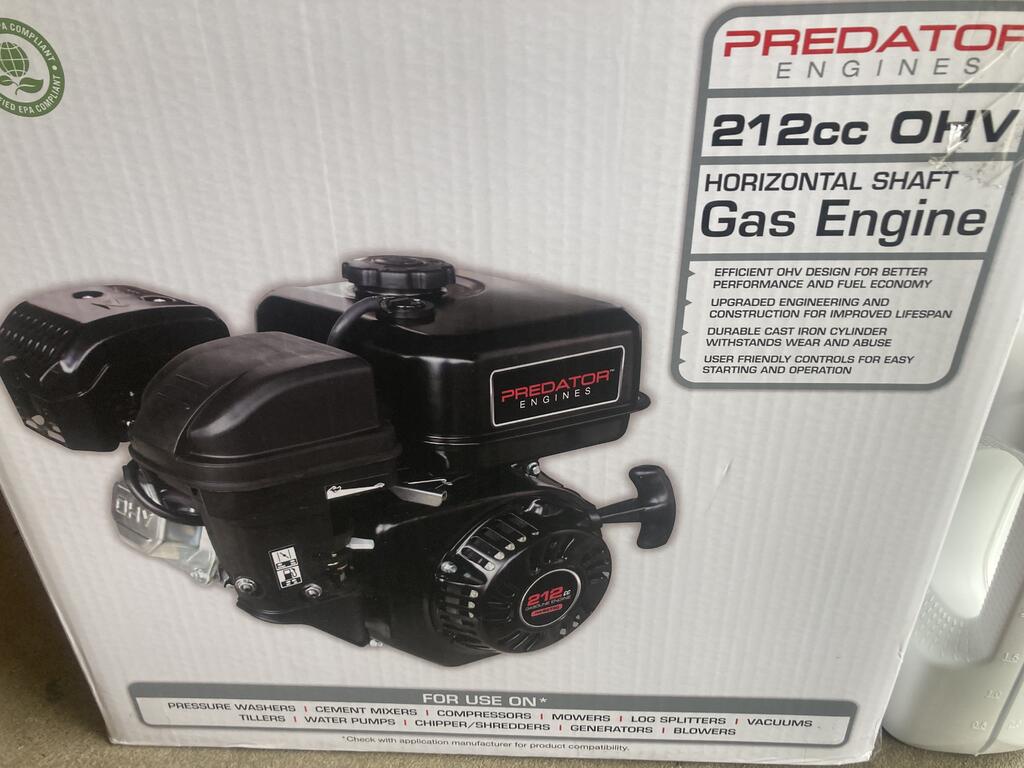

SylvanLakeWH 32,921 #22 Posted April 5, 2025 More progress today: filled trans with a secret recipe derived of 30 wght and Lucas oil treatment... only the Baldwin sisters on Walton's Mountain know the true "Recipe"... Predator 212 is the power plant. Done 2 previous and I know what to expect... TSC pulleys ( Made in USA!) and belt from Tractor Supply. Fitment and clutch figurementation next... still working out hand vs foot pedal clutch system due to auto to manual swap... right now, hand lever is the leading concept... All for now... 3 2 Share this post Link to post Share on other sites

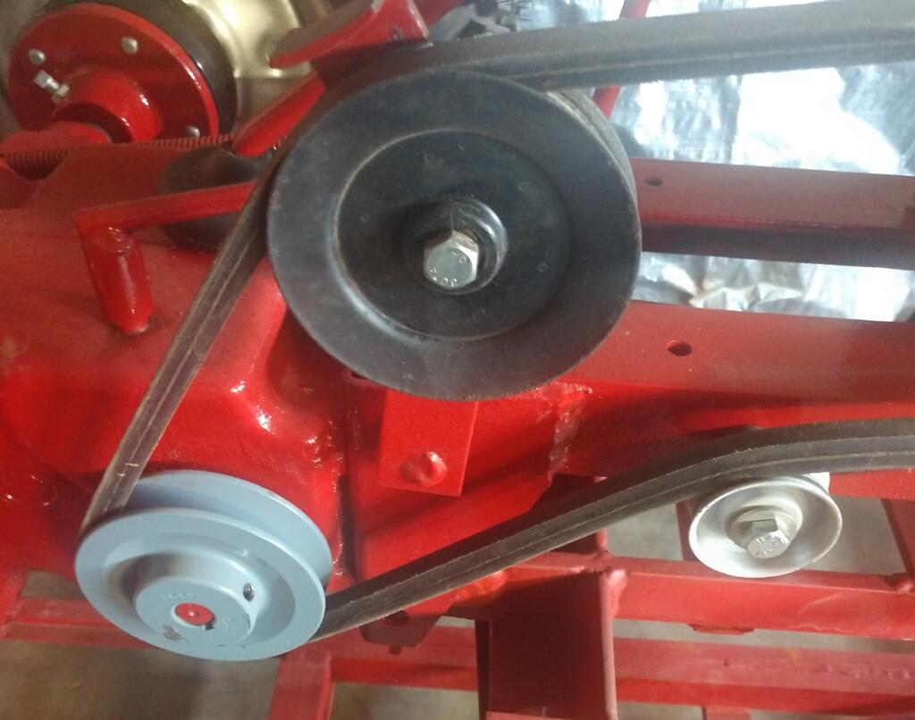

kpinnc 19,107 #23 Posted April 5, 2025 (edited) 2 hours ago, SylvanLakeWH said: TSC pulleys ( Made in USA!) and belt from Tractor Supply. 2.5 inch transmission pulley will add a bit of ground speed. Your problem will be the amount of belt contact you get with the smaller pulley. You may have to add an idler back there. Here's an old trick I learned from @TT back around 2008. It forces just a little more belt contact without negative clearance issues on the belt guard. The holes are already in the frame. You can use a bit larger flat idler than I did for additional grip. I just used what I had. Just a 3/8 bolt and standoff. Easy fix... Edited April 5, 2025 by kpinnc 5 1 Share this post Link to post Share on other sites
ebinmaine 81,282 #24 Posted April 5, 2025 On 4/2/2025 at 8:27 PM, SylvanLakeWH said: Whats the capacity on this thing? OE was 1.5 quarts. I agree with @Pullstart that adding a little more is beneficial. We put 2 quarts in all our manual transmissions regardless of gear count. ⚙️ @kpinnc has an excellent point on the belt contact area. Use a 1/2" wide belt. That'll make it set deeper thereby adding contact surface. I have other videos that show even more interesting ways to route the belt. @Greentored and his offroading clan have some awesome tricks. 3 1 Share this post Link to post Share on other sites
953 nut 70,654 #25 Posted April 5, 2025 9 hours ago, SylvanLakeWH said: TSC pulleys ( Made in USA!) The are made in the USA but die-cast pulleys wouldn't be suitable for most drive train applications. Since this will just be a play toy you will probably be OK. 3 1 Share this post Link to post Share on other sites
