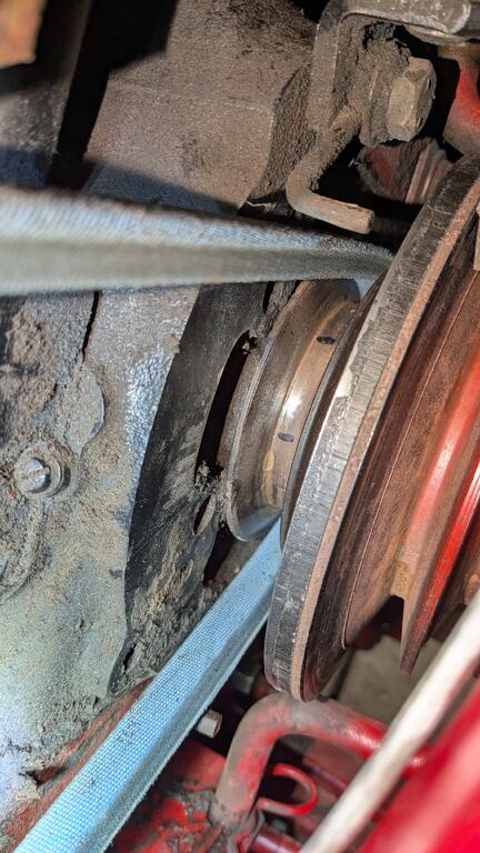

Alrashid2 476 #30 Posted December 20, 2024 Can't get in there with a caliper to measure the crack, so I used a Sharpie industrial to mark the top and bottom of the crack position on the bottom of the V. Hopefully since the belt doesn't go that deep, the marks will last! Share this post Link to post Share on other sites

oliver2-44 11,694 #39 Posted December 20, 2024 (edited) Over 40 years of working with 1930 to 1950 Cast Iron and Cast Steel industrial parts, we came across many “indications”. In the inspection world they were all “indications” until you proved depth or they truly broke. When cast metal cools it shrinks and leaves behind shrinkage flaws. Think of an inward wrinkle on the surface of the cast metal. When the surface of these shrinkage lines is machined they may go away or appear like a crack. Dye check and mag particle inspection will usually highlight them as an indication. Ultrasonic inspection with an angle transducer may help tell if it actually has some depth. In many case after the high tech inspections we would finally take a file or flapper disc and removed a 1/32 of metal to see if they would go away. I say all this because what I see in these pictures 7 hours ago, Alrashid2 said: is a rusty or dirty indication line not a shiny new indication line. I’m guessing this picture is after you ran it for a while. So yes it could have gotten rust or dirt wiped into it. You’ve shown that you can inspect it with your bore scope. If it were me, I would put a dot of paint on the top edge of the pulley at each end of the indication. Then I would run it and go back and know I was looking at the exact same spot. The other thing you could do is take a file and remove a good filings worth of metal from the area. Then sand it smooth and see if you still see the indication. Yes you will be very very slightly distorting the pulley. But since it’s inward (creating a hole) it’s so slight the belt will ever know it’s there. Edited December 20, 2024 by oliver2-44 3 Share this post Link to post Share on other sites

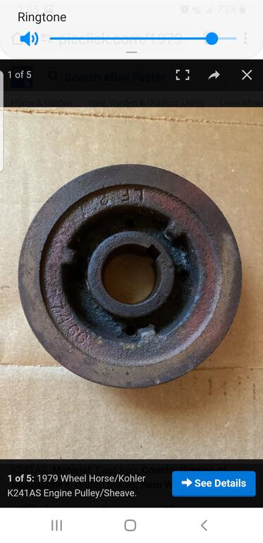

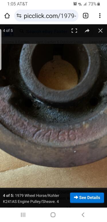

gt14rider 1,278 #48 Posted December 20, 2024 Just typed (wheelhorse 7466 for sale ) found 4 or 5, also A/Z tractor one of are vendors says he has 17 in stock. $ 40- $135. You want a 4" pulley, for a manual transmission. Nothing to think about. 1 1 1 Share this post Link to post Share on other sites
gt14rider 1,278 #49 Posted December 20, 2024 @Alrashid2 if you go looking for a pulley look for a cast # on back of pulley 7466 . Look at the pulley not what it came off, a lot of different models used that pulley. Might find a cheaper one. Good luck. 4 Share this post Link to post Share on other sites
