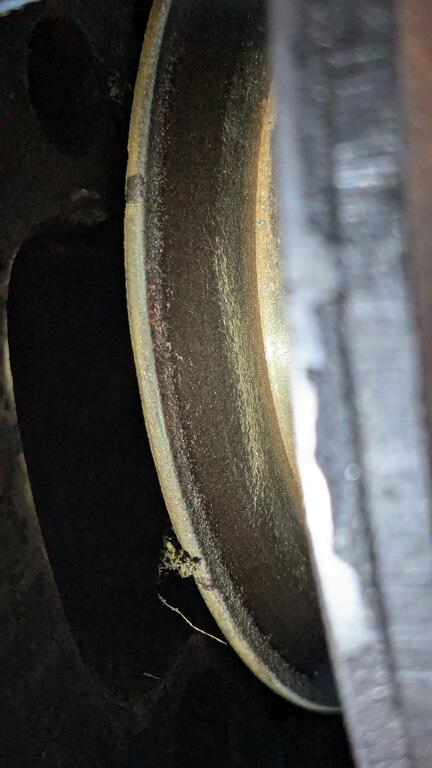

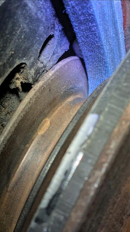

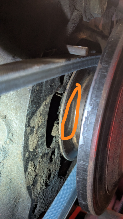

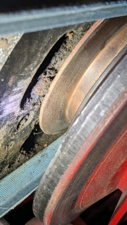

Alrashid2 476 #1 Posted December 19, 2024 (edited) Ugh... feel like an idiot. Quick backstory: I noticed that my drive belt was ever so slightly rubbing the brake rod on my 1985 312-8 with a Kohler K301 engine. Looking at the engine belt from above, I could see that the drive pulley was just a hair too close to the engine, skewing the belt inward and thus pushing the belt into the brake rod. I was originally thinking I could just dremel off a bit of the brake rod surface to give some clearance, but then I was looking over the parts diagrams and saw that the drive pulley on the engine had a set screw! Sweet, I should be able to just pull it out a hair and that would move the belt away from the brake rod. Or so I thought... Well, I take off the PTO and clutch assemblies and get to the pulley. Parts diagram says 2 set screws. Take out both. Pulley won't budge. Heated and sprayed PB Blaster. Still not moving. I eventually took a pry by behind it and slowly tried to shift it off the crankshaft... I thought I was making progress and then saw I was bending the pulley V from the engine side... ugh!! Looking at it from 45 degrees (as close as I could get my head in to the engine) I could see it was slightly bent. Freaking out, I took a block of wood and a dead blow hammer, and put it into the V to bend the V back toward the engine. Hit it with a few blows, and it appeared straight again.... Straight enough at least that after I turned the pulley a few times I forgot where I had bent it... I then ran the tractor for 10 minutes and she ran fine, then I watched it idle from the front and I couldn't see any bumping or inconsistency in the blur of the pulley spinning... My thought was that if the pulley was bent the "blur" of it moving at thousands of RPMs would look inconsistent, or the belt would be bumping up and down, but I couldn't see anything. She seems to be running fine. Think I am in the clear? Any issue with just running her? That's what I get for tinkering... Thanks guys. Edited December 19, 2024 by Alrashid2 1 Share this post Link to post Share on other sites
ri702bill 12,815 #2 Posted December 19, 2024 Pictures from several angles of the part would be of help to assist you in fixing it...... 2 Share this post Link to post Share on other sites
Alrashid2 476 #3 Posted December 19, 2024 Hey @ri702bill. I assembled everything together again and test ran it to check for any issues. I'd take pictures but they won't show anything to you guys. Like I said, I couldn't even tell where the bend was after hammering it back down 1 Share this post Link to post Share on other sites

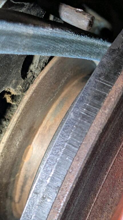

Alrashid2 476 #4 Posted December 19, 2024 (edited) Scratch that - I found the spot. With a bright light I can see the stress mark on the inside of the V where i bent it outward. I'll admit, looking at the edge and feeling it, the pulley doesnt feel out of alignment. Maybe I can just lightly sand down the stress mark? Edited December 19, 2024 by Alrashid2 1 Share this post Link to post Share on other sites
Alrashid2 476 #5 Posted December 19, 2024 (edited) Update. Sanded it down with 400 and 600 grit sand paper. Feels smooth to the finger. Also checked and it doesn't seem to be affecting the position/seat of the V belt. However, now its starting to look very crack like to me... Seems like a stress fracture. I'm hoping I can just keep running her. In nearly 50 years I'd think this isn't the only little crack on the horse... What do you guys think? Really hoping I don't need to replace the pulley as #1, I can't get it off and don't have the tools or skill to do so, and #2 it seems like it's very difficult to find an exact match pulley... So upset with myself now. I need to learn my lesson that sometimes trying to be overly proactive can just cause more problems. Hoping to get your opinions one way or another... Thanks guys P.S. @ebinmaine @SylvanLakeWH@Ed Kennell @peter lena @Bar Nuthin @oliver2-44 Sorry if I'm being a nuisance but calling out a few of you who have really helped me with some sage advice so far. Ive really appreciated your input so far and would love to hear from you on this as I'm real stressed out about it... thanks guys. Edited December 19, 2024 by Alrashid2 1 Share this post Link to post Share on other sites
SylvanLakeWH 32,140 #6 Posted December 19, 2024 Run it for a while and see if it changes... hard to say from the pictures... Again, these things are 40+ years old and well used... they will run under a lot less then ideal conditions... 3 1 Share this post Link to post Share on other sites
Alrashid2 476 #7 Posted December 19, 2024 Thanks @SylvanLakeWH. Will make a note of it's location in relation to the set screws so I know where it is. Thanks again for a bit of peace of mind... 2 Share this post Link to post Share on other sites
Bar Nuthin 3,040 #8 Posted December 19, 2024 (edited) Another case where if it's a problem, it will make itself known at some point. I must say, I feel like you've taken my signature quote to a whole new level! Edited December 19, 2024 by Bar Nuthin 5 Share this post Link to post Share on other sites
Alrashid2 476 #9 Posted December 19, 2024 (edited) @Bar Nuthin so funny you said that - when I first saw your sig, I said to myself, "Wow, that's the story of my life right there!" Another one that I'm infamous for regretting soon later is "What's the worst that could happen?" Edited December 19, 2024 by Alrashid2 2 1 Share this post Link to post Share on other sites
Alrashid2 476 #10 Posted December 19, 2024 Tried to get a little pocket mirror behind the pulley, though hard to get behind it (hence why I was trying to pull it!) but from what I could see, no damage or crack there. I also took a straight edge to the little 2" section I could fit it on and it sat flush. So I think the pulley shape is fine - just a question if the crack will eventually break. I wouldn't think the pressure of the belt would be enough force to break it outward, but who knows? Honestly, if I bought it like this I would have never noticed if it was cracked. There could very well be other cracks on my pulleys I haven't even noticed! 1 Share this post Link to post Share on other sites

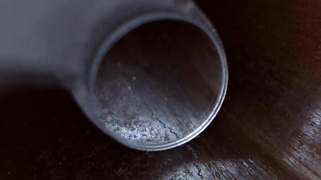

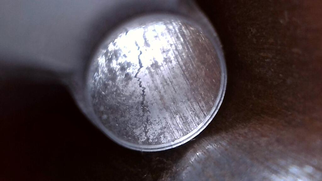

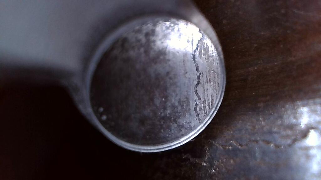

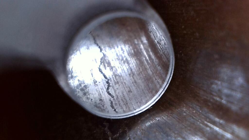

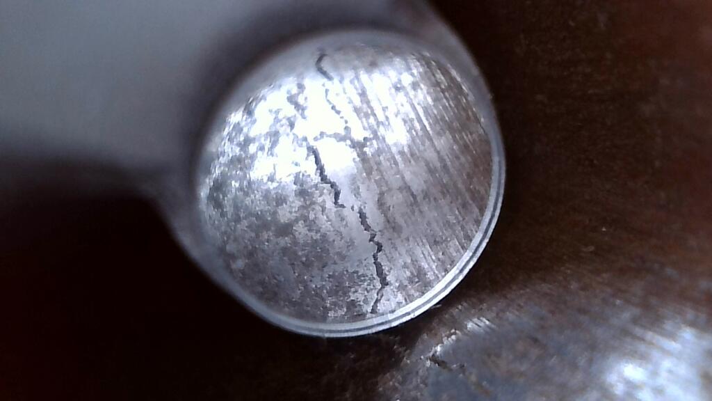

Alrashid2 476 #22 Posted December 20, 2024 Had an idea just to get a better view of the pulley installed. Grabbed my rifle bore scope camera and slipped it in there! I'm not super knowledgable (and maybe just being hopeful here) but it looks more like a "stress fracture" in the metal than a full on crack through. I put the bore scope on the back end of the pulley between the pulley and engine block - couldn't get in there quite well but from what I could see, no crack on the back side, so that makes me hopeful it's just a small fissure on the V side of the pulley only. Photos attached if youre curious and want to weigh in 1 Share this post Link to post Share on other sites
953 nut 68,508 #23 Posted December 20, 2024 16 minutes ago, Alrashid2 said: torches and such to remove it DO NOT USE A TORCH or you will end up needing to replace the crankshaft seal or worse. If you don't have the proper puller for this job your local auto parts store probably loans this type of tool for free, just have to leave a refundable deposit. Call Lincoln at A-Z for a good used pulley. https://www.a-ztractor.com/ 1 1 1 Share this post Link to post Share on other sites
8ntruck 9,216 #24 Posted December 20, 2024 Yup. That does look like a crack. Might be OK, might not. The only way to tell is to keep track of the size of the crack - both length and width. Being a cast pulley, I'd expect that the crack will grow. A co worker was a helicopter pilot in the Air Calvary in the middle east. Before each flight, he would look at the maintenance log of whatever machine he was going to fly. The entry he really hated to see was "Unable to recreate reported problem. Fly and watch." One option for you is to "fly and watch". Just keep in mind that you will be seated in the rotation plane of a damaged pulley with a rim speed of around 3000 feet per minute. 3 1 Share this post Link to post Share on other sites
