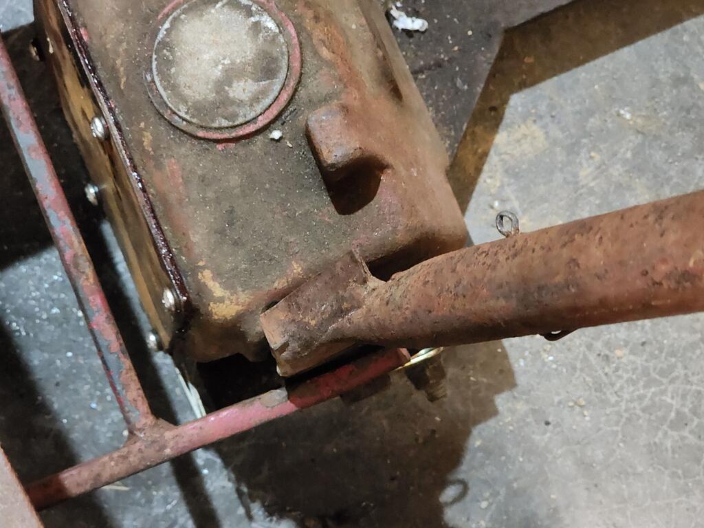

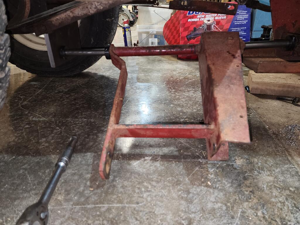

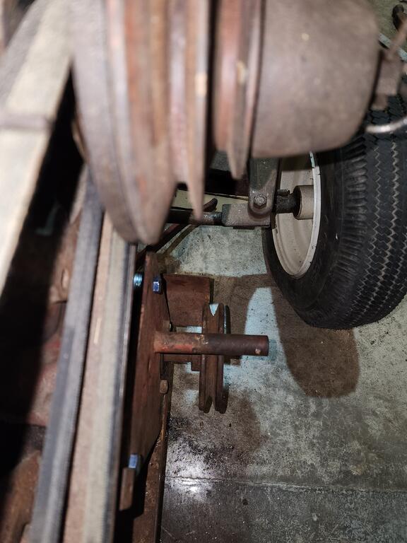

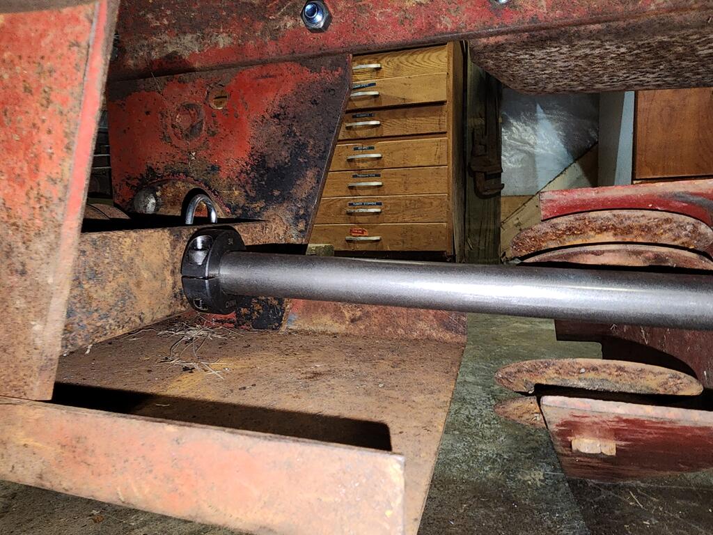

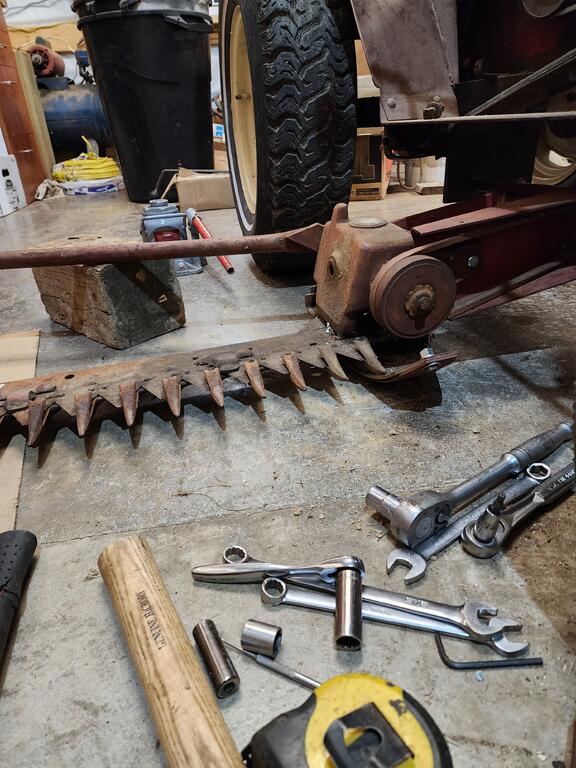

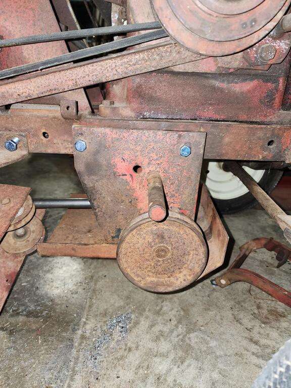

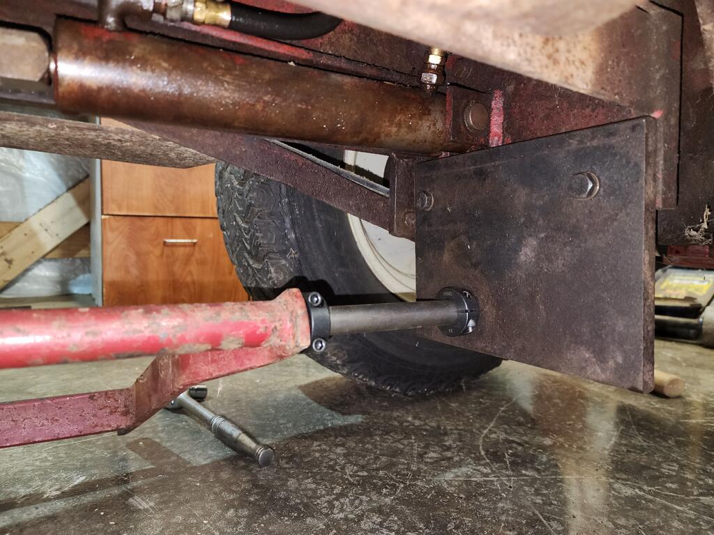

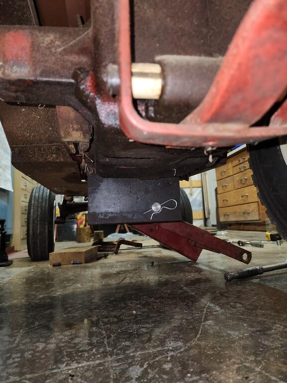

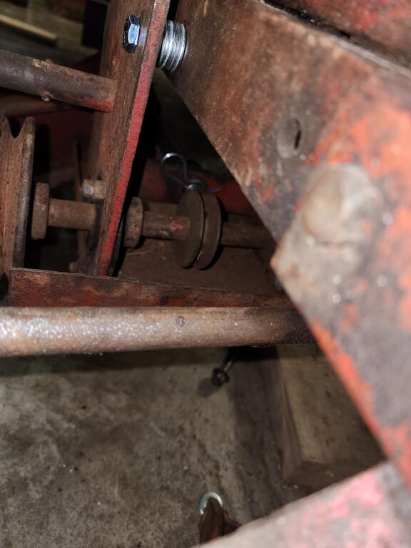

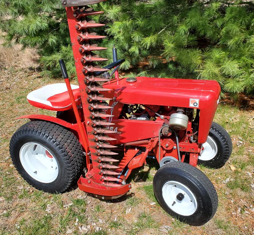

cafoose 3,853 #1 Posted May 20, 2024 I'm making a lot of progress installing my SMS-50 sickle bar on my 953 I still need to figure out how to hook up the lift I used a 1/2 inch steel plate for the rear support and a 3/4 inch steel axle I found on amazon. I also used 3/4 inch locking collars on the axle at the front and rear and also on either side of the sickle bar frame. Am I doing okay so far? I'm open to comments and suggestions good or bad. I'm using the outer pulley on the PTO because that is the slowest speed and I read in another post if it runs too fast I can blow out the wobble box. 4 Share this post Link to post Share on other sites
Pullstart 71,259 #2 Posted May 20, 2024 It looks like you’re doing a fine job! I have always been ignorant/confused on how the whole system works. Being the soon owner of a couple different sickle mowers, I’m taking my time learning and figuring out. I think it’s a matter of getting my hands on them to see how they really go. Keep it up! I need all the reference I can get! 1 Share this post Link to post Share on other sites
953 nut 69,407 #3 Posted May 20, 2024 I think your headed it the right direction, @Lane Ranger has done a few of these and shold be able to give more information. 1 Share this post Link to post Share on other sites
Pullstart 71,259 #4 Posted May 20, 2024 Do you have the manual for this? It looks like it’s a manual lift lever that goes on the wobble box casting. Part 82 in the IPL. 1 Share this post Link to post Share on other sites

cafoose 3,853 #7 Posted May 20, 2024 6 hours ago, Pullstart said: It looks like you’re doing a fine job! I have always been ignorant/confused on how the whole system works. Being the soon owner of a couple different sickle mowers, I’m taking my time learning and figuring out. I think it’s a matter of getting my hands on them to see how they really go. Keep it up! I need all the reference I can get! Thanks Kevin, I'll keep updating this thread as I make more progress with plenty of If anyone needs any additional I'll be happy to take some 5 hours ago, 953 nut said: I think your headed it the right direction, @Lane Ranger has done a few of these and shold be able to give more information. I've already been talking to @Lane Ranger about this project and he told me eventually he would get some of his 953 sickle for me. 4 hours ago, Pullstart said: Do you have the manual for this? It looks like it’s a manual lift lever that goes on the wobble box casting. Part 82 in the IPL I have the manual for the 953/1054 SMS-50 but I don't think I saw that one for the SMS-506. Here are the axle and locking collars I used: https://www.amazon.com/dp/B00FMXDK3O?psc=1&ref=ppx_yo2ov_dt_b_product_details https://www.amazon.com/dp/B01CH3DSXS?psc=1&ref=ppx_yo2ov_dt_b_product_details 3 1 Share this post Link to post Share on other sites

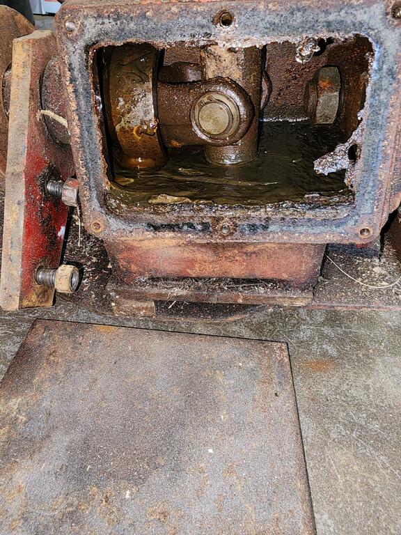

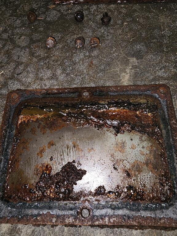

cafoose 3,853 #8 Posted May 20, 2024 Took the cover plate off the wobble box and looked inside. Had to cut slots in the lower screws with the dremel because they were missing Everything seems to be operating correctly 1 Share this post Link to post Share on other sites

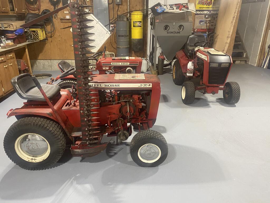

c-series don 12,474 #9 Posted May 21, 2024 (edited) I have an SMS-50 that I adapted to a C-121. When I got it the yoke in the wobble box was broken, however I was able to weld it back together and get it working again. Now I’m no sickle bar expert, but I quickly figured out that it doesn’t like to run fast. I ran it a little slower and it cut just fine. I’ve said this here before, I don’t even have anything to cut now. I have it because I’m a collector, but when I see a field of tall grass or wheat I want to cut it with my sickle bar!! @cafoose good luck with yours!! Edited May 21, 2024 by c-series don 2 2 1 Share this post Link to post Share on other sites

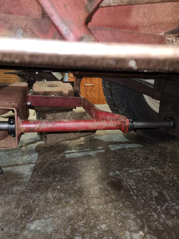

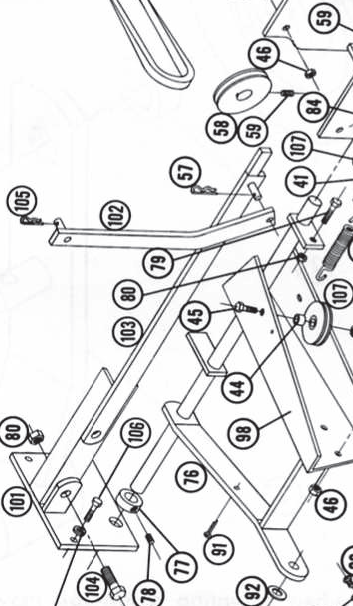

cafoose 3,853 #10 Posted May 21, 2024 Does anyone know how long bar 103 and lift bar 102 attaches onto the frame 98 to lift the frame 98? Also at the end of the 103 long bar right by where 102 lift bar attaches the end of the long bar 103 is narrower. What is the purpose of narrowing the end of long bar 103 and where does it fit into? I'm trying to understand how the hydraulic lift of the 953 raises the frame of the sickle bar. I know the long lever that attaches to the sickle bar raises and lowers the cutting bar itself. Share this post Link to post Share on other sites

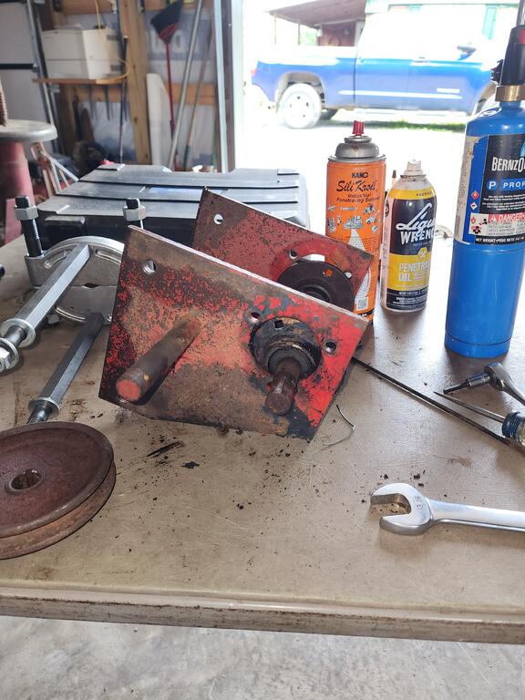

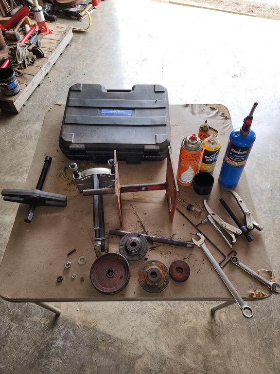

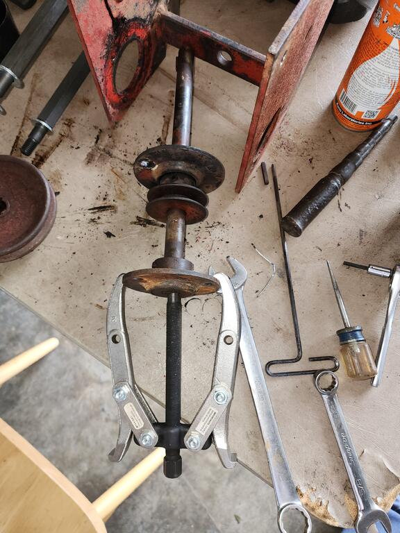

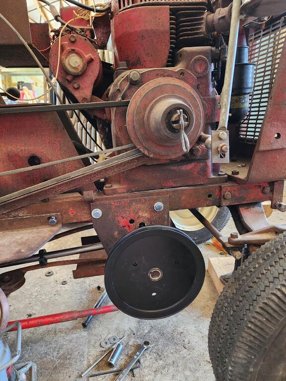

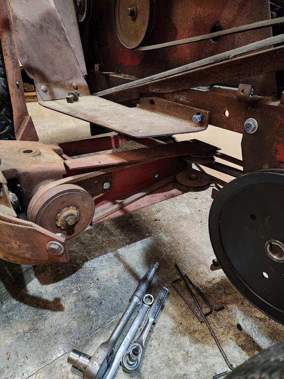

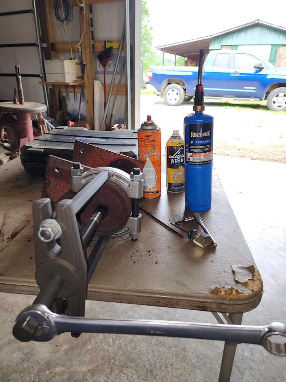

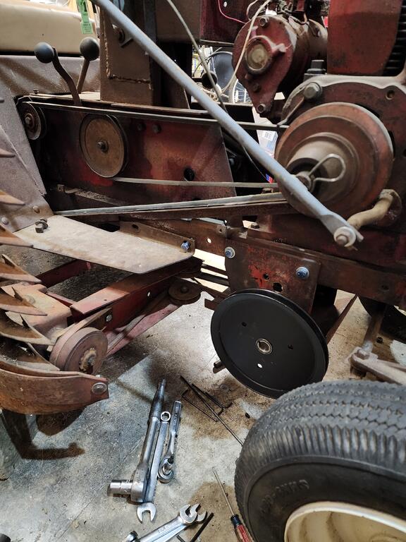

cafoose 3,853 #22 Posted May 25, 2024 Success after soaking the set screws for several days and applying some heat I got the pulleys off It's definitely made for a narrower frame. It fits a narrow C frame perfectly. I'm thinking if I put a longer piece between the plates I can make it fit my 953. I also need to remove the idler shaft to use a larger drive pulley to slow it down since I'm running off the PTO clutch. 4 Share this post Link to post Share on other sites

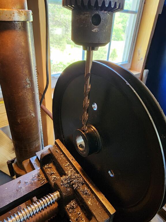

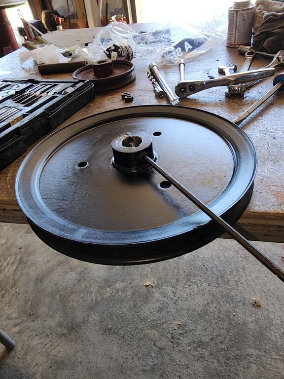

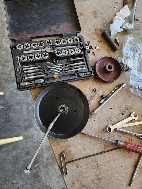

cafoose 3,853 #23 Posted June 7, 2024 @Racinbob @c-series don @Lane Ranger How's this for slowing it down? 3.25 inches on the PTO and 8.5 inches on the driven shaft The pulley I got from amazon didn't have set screws so I had to get a longer bit from amazon to drill and tap for set screws. The belt I need measured to be 43 inches and that's coming Tuesday. 3 1 Share this post Link to post Share on other sites

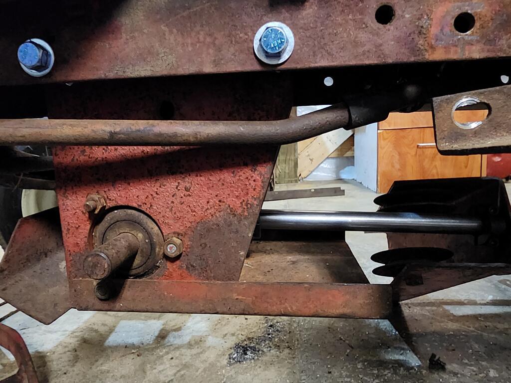

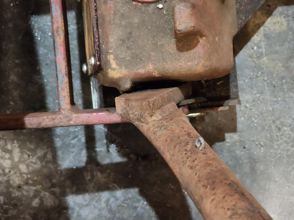

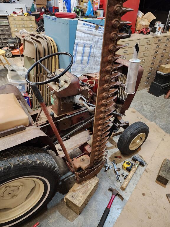

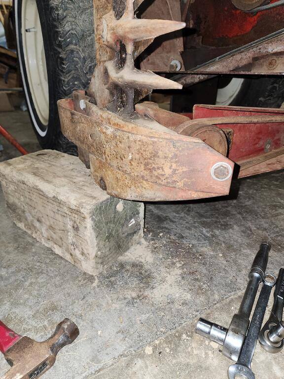

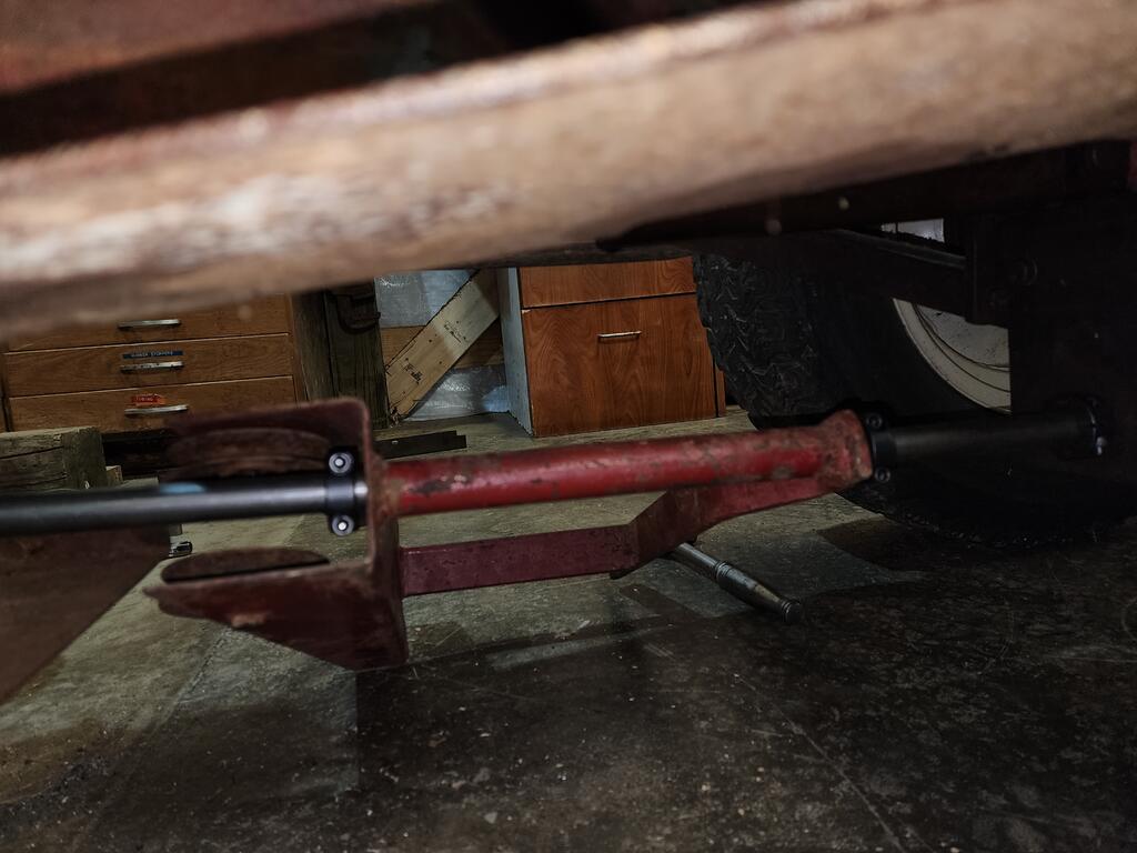

cafoose 3,853 #25 Posted June 8, 2024 I got the sickle mounted on the tractor It looks good to me so far Looks like the lift lever mounted to the sickle is too sloppy to lift the bar in the last two pictures. Any suggestions how to fix it? Also, do I need to hook up the hydraulic lift to it? If so, how can I do it? Is it supposed to ride on the ground or do I need to somehow hold the frame up a little? 2 Share this post Link to post Share on other sites
