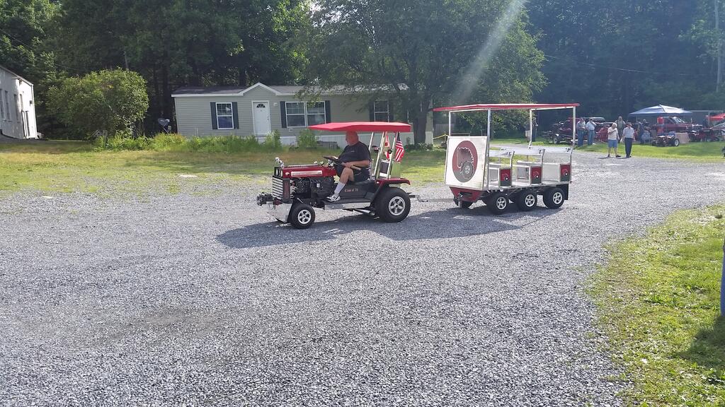

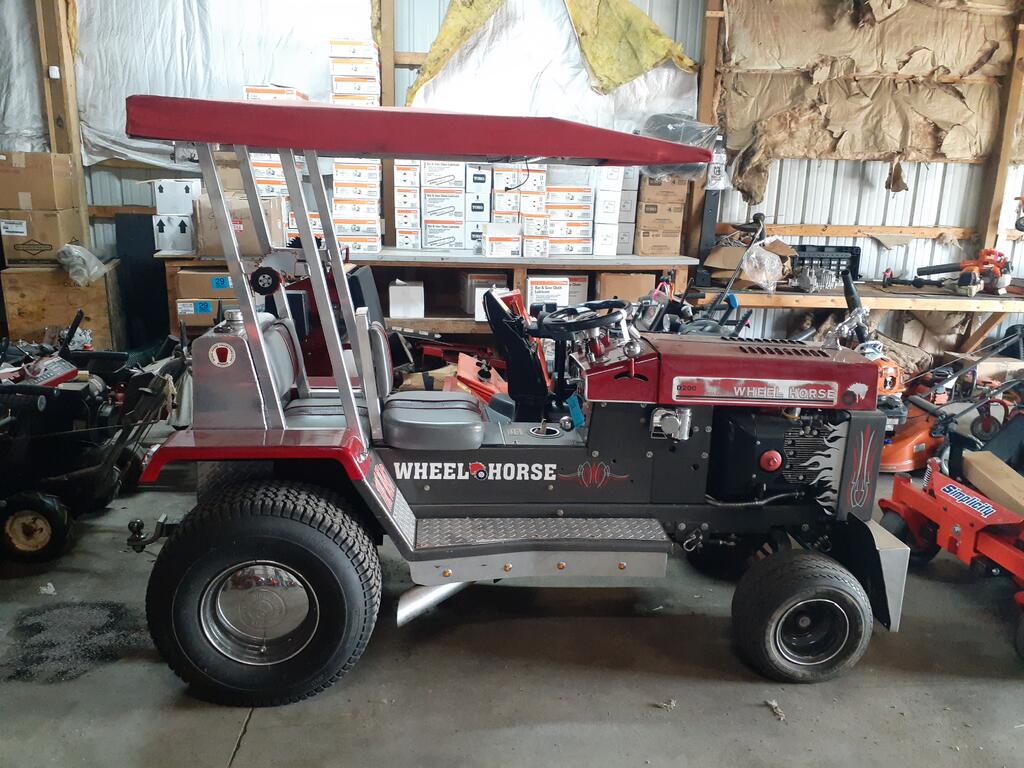

Yard-N-Gard 5 #1 Posted June 30, 2023 I am a service manager at an outdoor power equipment store in Elkhart Indiana. I have a long time and good customer with a modified Wheel Horse, picture attached to post. The unit needs a transmission and I am at a loss :( He has built his own railroad system at a campground and uses it to give kids free rides on the train. The following information is what my technician was able to get off the transmission; Sundstrand hydro transmission 90-1173 L.H. 3102910-04 04-UD 16702 If there is anyone that can help point me in the right direction I would be very grateful. I should add that we are a Toro dealer and Toro has not been able to help me. 4 1 Share this post Link to post Share on other sites
wallfish 20,744 #2 Posted June 30, 2023 The original tractor it was made from is a D series. Like D160 D180 D200. Some of the transmission guys should be a long to better help you. Maybe rebuilding the pump is an option too 3 Share this post Link to post Share on other sites
WHX?? 58,388 #3 Posted June 30, 2023 (edited) 1 hour ago, Yard-N-Gard said: should add that we are a Toro dealer and Toro has not been able to help me. Yah Toro is gonna laugh at you. That machine has gone thru a few hands since your guy and it's good to see it is making kids smile. Far as I know The Bear... @Bear G was the last PO. As far as the transmission goes couple guys we know can help you out. Notably @pfrederi or ? Help me out fellas brain fart the Hydro pro... Dave? We do have manuals here for it your tech to study. Other guys can link them up I'm dumb phone challenged What is the tranny doing or not doing? We need to keep this tractor running. The orginal builder with people hauler. Big show 2016 Edited June 30, 2023 by WHX?? My bad welcome 7 Share this post Link to post Share on other sites
