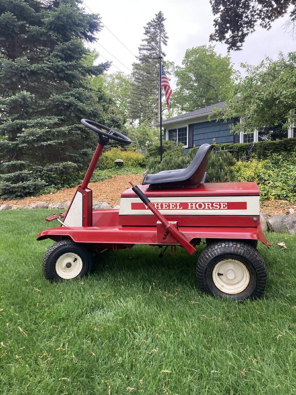

SylvanLakeWH 32,722 #1 Posted May 20, 2023 So last fall I put a want ad for an . Either an E-141 or an A-60. Crickets... Then I get a lead, text this guy in Minnesota, who I don't know and is not on RS... He says ya I have a NOS A-60, but it's in Iowa. Ok I says, can you get it to Minnesota and then we'll see what happens... Yup... couple months go by... it's in Minnesota. Now what? So i put out some feelers to some Wisconsin and Minnesota boys - @WHX??, @Achto, @wheelhorseman, @Shynon, @prondzy as well as my Michigan buddy @Pullstart who is well known for short jaunts to pick up wayward 's... Thank you gents. Would not have happened without your help!!! Long story short, achto and whxx pick it up in a late season blizzard (covered trailer thank you!) on the way back from their own wrangling mission. So now it's in whxx's shed, which is a sketchy place to be if your a young filly far away from home... But all is well, as whxx begins lookin it over he notices flat tire, missing ignition coupler, etc. and proceeds to fix said items!!! Now I'm waiting on pullstart to go west to North Dakota to pick up a herd he bought last fall. Snug in her temporary home, A-60 waits... Then, long winter over, Mrs Pullstart insists, i am told, that she spend Mother's Day in Norman on the way to North Dakota to get some more Wheel Horses... Couple days later and voila... A-60 is home!!! The first pick up by an unknown assailant from Wisconsin. Note the cheese curd stains on the jacket... The second pick up (note the signature shorts and safety boots): The third and final pick up: And home: Done so far: Cleaned up. lubed 3 new deep cycle batteries from Costco. Saving the WH branded, never seen acid still in shrink wrap, for garage decorations. New spring for clutch Lubed chain Penetrol on all sheet metal. 2 coats. And she floats!!! More to come as I fine tune things and look over belts etc. Here's some pics and a video of first known ride on this tub in 47 years... IMG_2256.mov 1 15 4 Share this post Link to post Share on other sites
Pullstart 71,413 #2 Posted May 20, 2023 So cool that it’s a runner! 3 1 Share this post Link to post Share on other sites
squonk 48,241 #3 Posted May 20, 2023 27 minutes ago, SylvanLakeWH said: The first pick up by an unknown assailant from Wisconsin. Note the cheese curd stains on the jacket... That was a white lab coat until Jim stopped at a local Greasy Spoon! And what's up with the stain in the shorts or was that a really long trip? 5 Share this post Link to post Share on other sites
ri702bill 13,229 #4 Posted May 20, 2023 Ride it wearing Flippity-Flops and use the built in foot soaker pockets !!!!! 3 Share this post Link to post Share on other sites

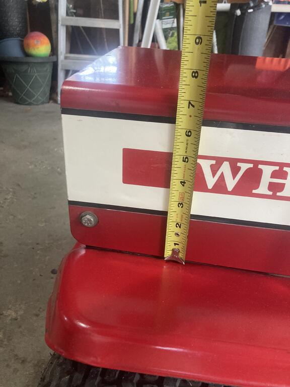

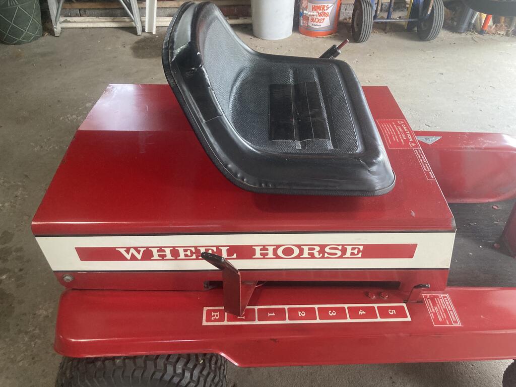

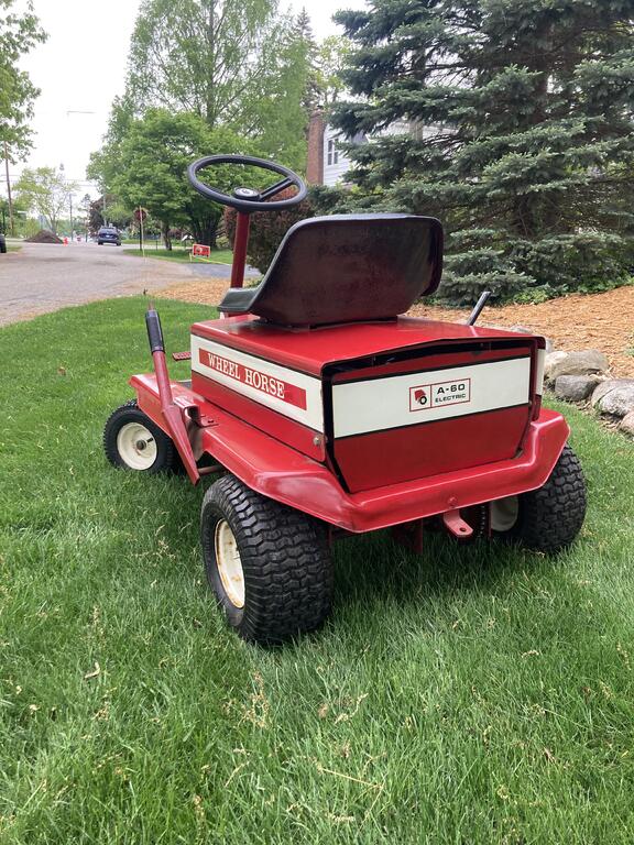

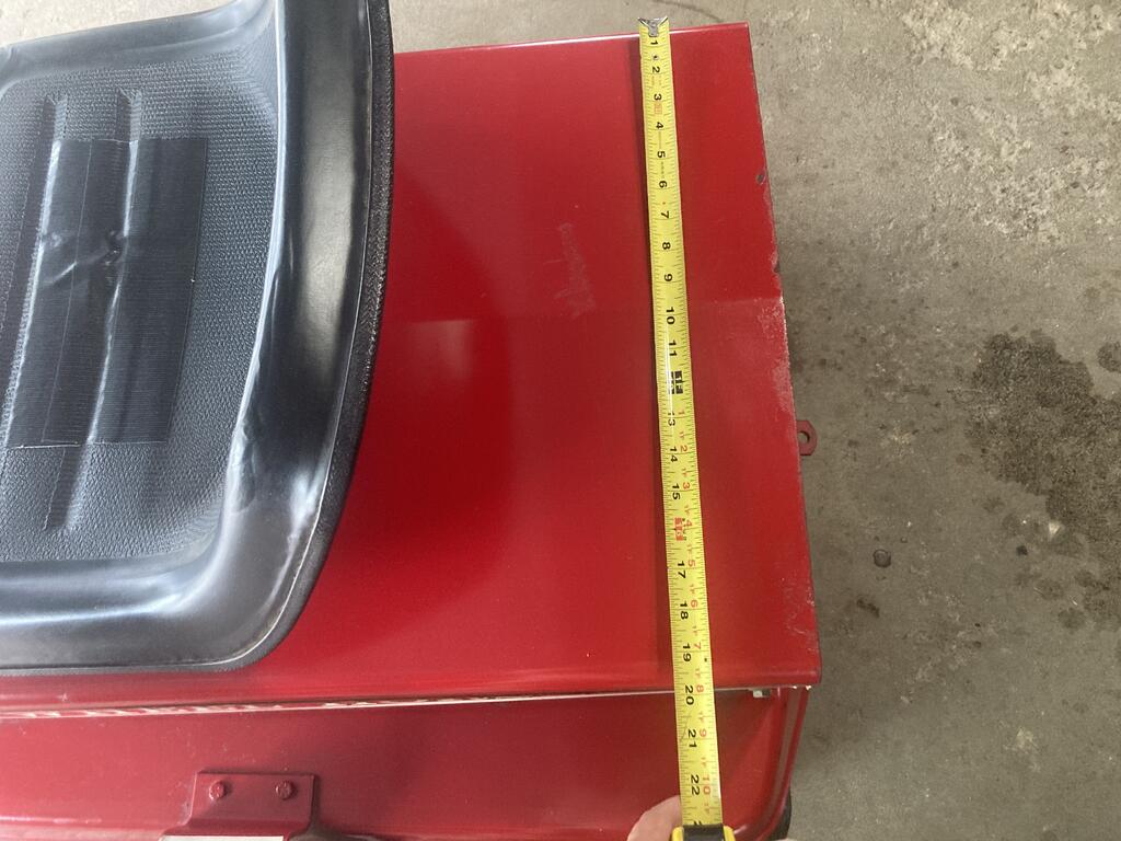

Desko 686 #5 Posted May 20, 2023 Would my eyes deceive me to say wheel horse used a modified D series hood? Very cool find! 3 1 Share this post Link to post Share on other sites
SylvanLakeWH 32,722 #6 Posted May 20, 2023 @gwest_ca For your records / list. Share this post Link to post Share on other sites
c-series don 12,561 #7 Posted May 20, 2023 2 hours ago, Desko said: Would my eyes deceive me to say wheel horse used a modified D series hood? Very cool find! Good eye! I didn’t notice that but now that I look at it, it does look like it! 1 Share this post Link to post Share on other sites

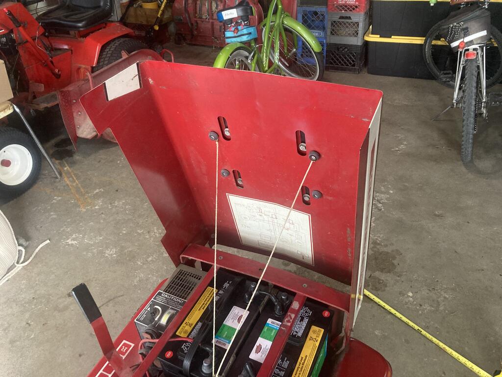

SylvanLakeWH 32,722 #8 Posted May 20, 2023 2 hours ago, Desko said: Would my eyes deceive me to say wheel horse used a modified D series hood? Very cool find! 4 minutes ago, c-series don said: Good eye! I didn’t notice that but now that I look at it, it does look like it! No idea - I've never seen a D hood in person. Wouldn't surprise me though given the Pond's legendary frugality. Here's a couple more pics of just the hood. 6 Share this post Link to post Share on other sites
Desko 686 #9 Posted May 20, 2023 I'll have to go and measure the D160 hood but with the center line in it it sure looks like! 1 Share this post Link to post Share on other sites

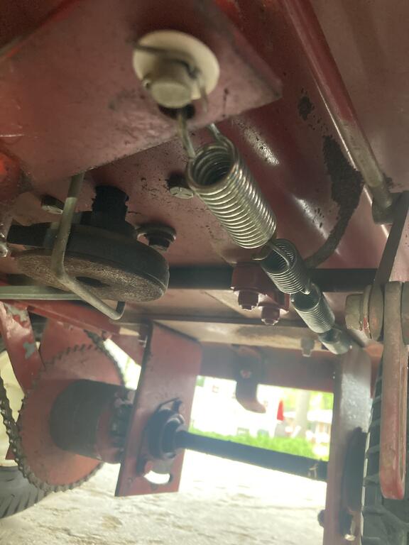

SylvanLakeWH 32,722 #17 Posted May 23, 2023 (edited) Adjusted chain drive and more lube. Amazing how quiet this thing is now that it's greased up... Added a spring to the brake pedal (went missing along with clutch spring some time in the last 47 years sitting on the shelf). I used 4 trampoline springs for the clutch and 1 plus an s hook for the brake. Both now functioning properly. While it was NOS, it came with some birth defects... ignition connector missing, no springs on clutch pedal or brake, chain was super tight, seat has hole in it, flat tire. Actually not bad for 47 years old... @WHX?? fixed the ignition and flat tire before I even saw it , trampoline springs work very well, gorilla tape keeps seat together and tacky red keeps things smooth... Edited May 23, 2023 by SylvanLakeWH 4 1 Share this post Link to post Share on other sites

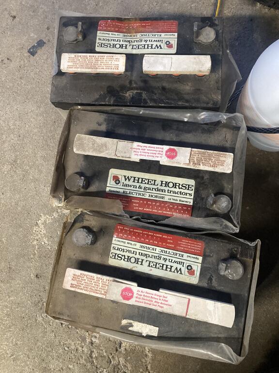

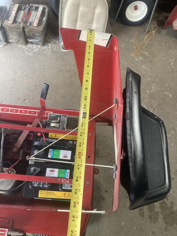

SylvanLakeWH 32,722 #18 Posted May 24, 2023 Opinions please... Three NOS WH batteries. Still in plastic. Never seen acid. They are nothing but 47 year old deep cells with a WH sticker... Keep or turn in for the $15 each core charge refund??? Im leaning towards keeping the stickers (they are all coming off already) and getting my $45... Thoughts from the brain trust? 2 Share this post Link to post Share on other sites
WHX?? 58,308 #19 Posted May 24, 2023 (edited) It's a real dilemma Sylvia... are they worth anything without acid in them? Personally I would have put acid in them and run them figuring even the most hard core collectors wouldn't want them. Then again with the sealed covers? Just don't know. They say they should be good batts if they where never filled right guys??? I think you did the right thing for now on getting replacement batteries till we can finger things out but yet you can still run it as meant and use it for your tubs. Thinking with replacement batts you covered yer @$$ on value of originals anyway. Edit... Hindsight ... Shoulda sent some core charge batts back with Pullhosen ... I got plenty. Edited May 24, 2023 by WHX?? 1 1 Share this post Link to post Share on other sites
SylvanLakeWH 32,722 #20 Posted May 24, 2023 Appreciate the feedback! Should also mention top one in pic had caved top... holder was cranked down to hard. Damaged??? Who knows... Share this post Link to post Share on other sites
953 nut 69,899 #21 Posted May 24, 2023 10 hours ago, SylvanLakeWH said: Three NOS WH batteries. Still in plastic. Never seen acid. They are nothing but 47 year old deep cells with a WH sticker... Keep or turn in for the $15 each core charge refund??? Hypothetically since I don't have one; If they were in my NOS A-60 I would have gotten the acid and brought the 47 year old batteries to life. Considering the fact that they don't take up a lot of space and $ 45 is not a life altering amount of money I would suggest you keep them. 3 1 Share this post Link to post Share on other sites
peter lena 10,095 #22 Posted May 30, 2023 @SylvanLakeWH like your comment " amazing how quiet it is now that its greased up " , found corrected function detailing / lubrication makes things very easy to use . regularly use round solid rod , 1/8 or more as a go to pull point on a spring , bend it into a long S shape . I can also see your collective spring pull as the problem solver . note lucas MARINE GREASE , thats redadily available , has a very hi temp / stress rating . that sprocket shaft bearing / chain drive spot . watch out , once you go , corrective set up change , and lubrication , expect a , YOU CAN,T DO THAT , reply . personally give that a GOOD CHANGE RATING , greasy pete 1 Share this post Link to post Share on other sites

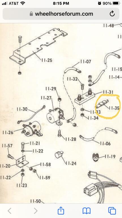

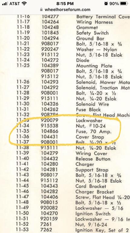

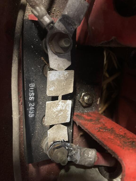

SylvanLakeWH 32,722 #23 Posted August 20, 2023 White smoke... Went for a ride first gear no issues. 3rd gear start out and poof... Stopped dead. Blown 70 amp fuse. Here's the buss and the part info... Very odd as I have not done anything different... Gonna start looking for the fuse... hope it's readily available... @Pullstart @Achto @WHX?? @Evguy 3 Share this post Link to post Share on other sites
Achto 32,847 #24 Posted August 20, 2023 10 minutes ago, SylvanLakeWH said: hope it's readily available. Possible alternative. https://www.amazon.com/Tocas-Surface-Mount-Circuit-Breakers-Waterproof/dp/B07D7S2VBY/ref=sr_1_5?keywords=70%2Bamp%2Bcircuit%2Bbreaker&qid=1692491449&sr=8-5&th=1 1 1 Share this post Link to post Share on other sites
wallfish 20,699 #25 Posted August 20, 2023 It looks like the fuse is in tact as it should've burnt open at that little thin spot in the middle. Could it have been heating up at that connection because of corrosion causing an arc fault? Maybe clean those connections up? If it's cooked then I'm with Dan and would go with a modern type of fuse replacement. Or, just use "tin foil" like the old one basically was for nostalgia purposes. 2 2 Share this post Link to post Share on other sites
